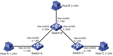

Network requirements
As shown in Figure 1, configure IPv6 static routes so that hosts can reach one another.
Figure 1 Network diagram
Configuration procedure
1.     Configure the IPv6 addresses for all VLAN interfaces. (Details not shown.)
2.     Configure IPv6 static routes:
# Configure a default IPv6 static route on Switch A.
<SwitchA> system-view
[SwitchA] ipv6 route-static :: 0 4::2
# Configure two IPv6 static routes on Switch B.
<SwitchB> system-view
[SwitchB] ipv6 route-static 1:: 64 4::1
[SwitchB] ipv6 route-static 3:: 64 5::1
# Configure a default IPv6 static route on Switch C.
<SwitchC> system-view
[SwitchC] ipv6 route-static :: 0 5::2
3.     Configure the IPv6 addresses for all the hosts and configure the default gateway of Host A, Host B, and Host C as 1::1, 2::1, and 3::1.
# Display the IPv6 static route information on Switch A.
[SwitchA] display ipv6 routing-table protocol static
Summary Count : 1
Static Routing table Status : <Active>
Summary Count : 1
Destination: ::                                          Protocol  : Static
NextHop    : 4::2                                        Preference: 60
Interface  : Vlan-interface200                           Cost      : 0
Static Routing table Status : <Inactive>
Summary Count : 0
# Display the IPv6 static route information on Switch B.
[SwitchB] display ipv6 routing-table protocol static
Summary Count : 2
Summary Count : 2
Destination: 1::/64                                      Protocol  : Static
NextHop    : 4::1                                        Preference: 60
Destination: 3::/64                                      Protocol  : Static
NextHop    : 5::1                                        Preference: 60
Interface  : Vlan-interface300                           Cost      : 0
Summary Count : 0
# Use the ping command to test the reachability.
[SwitchA] ping ipv6 3::1
Ping6(56 data bytes) 4::1 --> 3::1, press CTRL_C to break
56 bytes from 3::1, icmp_seq=0 hlim=62 time=0.700 ms
56 bytes from 3::1, icmp_seq=1 hlim=62 time=0.351 ms
56 bytes from 3::1, icmp_seq=2 hlim=62 time=0.338 ms
56 bytes from 3::1, icmp_seq=3 hlim=62 time=0.373 ms
56 bytes from 3::1, icmp_seq=4 hlim=62 time=0.316 ms
--- Ping6 statistics for 3::1 ---
round-trip min/avg/max/std-dev = 0.316/0.416/0.700/0.143 ms

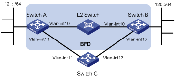

BFD for IPv6 static routes configuration example (direct next hop)
As shown in Figure 2:
·     Configure an IPv6 static route to subnet 120::/64 on Switch A.
·     Configure an IPv6 static route to subnet 121::/64 on Switch B.
·     Enable BFD for both routes.
·     Configure an IPv6 static route to subnet 120::/64 and an IPv6 static route to subnet 121::/64 on Switch C.
When the link between Switch A and Switch B through the Layer 2 switch fails, BFD can detect the failure immediately, and Switch A and Switch B can communicate through Switch C.
Figure 2 Network diagram
Device
Interface
IPv6 address
Switch A
Vlan-int10
12::1/64
Switch A
Vlan-int11
10::102/64
Switch B
Vlan-int10
12::2/64
Switch B
Vlan-int13
13::1/64
Switch C
Vlan-int11
10::100/64
Switch C
Vlan-int13
13::2/64
1.     Configure IPv6 addresses for interfaces. (Details not shown.)
2.     Configure IPv6 static routes and BFD:
# Configure IPv6 static routes on Switch A and enable BFD control mode for the static route that traverses the Layer 2 switch.
[SwitchA-vlan-interface10] bfd min-transmit-interval 500
[SwitchA-vlan-interface10] bfd min-receive-interval 500
[SwitchA-vlan-interface10] bfd detect-multiplier 9
[SwitchA-vlan-interface10] quit
[SwitchA] ipv6 route-static 120:: 64 vlan-interface 10 12::2 bfd control-packet
[SwitchA] ipv6 route-static 120:: 64 10::100 preference 65
[SwitchA] quit
# Configure IPv6 static routes on Switch B and enable BFD control mode for the static route that traverses the Layer 2 switch.
[SwitchB] interface vlan-interface 10
[SwitchB-vlan-interface10] bfd min-transmit-interval 500
[SwitchB-vlan-interface10] bfd min-receive-interval 500
[SwitchB-vlan-interface10] bfd detect-multiplier 9
[SwitchB-vlan-interface10] quit
[SwitchB] ipv6 route-static 121:: 64 vlan-interface 10 12::1 bfd control-packet
[SwitchB] ipv6 route-static 121:: 64 vlan-interface 13 13::2 preference 65
[SwitchB] quit
# Configure IPv6 static routes on Switch C.
[SwitchC] ipv6 route-static 120:: 64 13::1
[SwitchC] ipv6 route-static 121:: 64 10::102
# Display the BFD sessions on Switch A.
<SwitchA> display bfd session
 Total Session Num: 1     Up Session Num: 1     Init Mode: Active
 IPv6 Session Working Under Ctrl Mode:
       Local Discr: 513                 Remote Discr: 33
         Source IP: 12::1
    Destination IP: 12::2
     Session State: Up                      Interface: Vlan10
         Hold Time: 2012ms
The output shows that the BFD session has been created.
# Display IPv6 static routes on Switch A.
<SwitchA> display ipv6 routing-table protocol static
Summary Count : 1
Summary Count : 1
Destination: 120::/64                                    Protocol  : Static
NextHop    : 12::2                                       Preference: 60
Interface  : Vlan10                                      Cost      : 0
Direct Routing table Status : <Inactive>
Summary Count : 0
The output shows that Switch A communicates with Switch B through VLAN-interface 10. The link over VLAN-interface 10 fails.
# Display IPv6 static routes on Switch A again.
Summary Count : 1
Summary Count : 1
NextHop    : 10::100                                     Preference: 65
Interface  : Vlan11                                      Cost      : 0
Static Routing table Status : < Inactive>
Summary Count : 0
The output shows that Switch A communicates with Switch B through VLAN-interface 11.

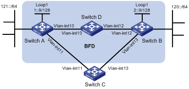

BFD for IPv6 static routes configuration example (indirect next hop)
As shown in Figure 3:
·     Switch A has a route to interface Loopback 1 (2::9/128) on Switch B, and the output interface is VLAN-interface 10.
·     Switch B has a route to interface Loopback 1 (1::9/128) on Switch A, and the output interface is VLAN-interface 12.
·     Switch D has a route to 1::9/128, and the output interface is VLAN-interface 10. It also has a route to 2::9/128, and the output interface is VLAN-interface 12.
Configure the following:
·     Configure an IPv6 static route to subnet 120::/64 and an IPv6 static route to subnet 121::/64 on both Switch C and Switch D.
When the link between Switch A and Switch B through Switch D fails, BFD can detect the failure immediately and Switch A and Switch B can communicate through Switch C.
Figure 3 Network diagram
Device
Interface
IPv6 address
Switch A
Vlan-int10
12::1/64
Switch A
Vlan-int11
10::102/64
Switch A
Loop1
1::9/128
Switch B
Vlan-int12
11::2/64
Switch B
Vlan-int13
13::1/64
Switch B
Loop1
2::9/128
Switch C
Vlan-int11
10::100/64
Switch C
Vlan-int13
13::2/64
Switch D
Vlan-int10
12::2/64
Switch D
Vlan-int12
11::1/64
# Configure IPv6 static routes on Switch A and enable BFD control packet mode for the IPv6 static route that traverses Switch D.
[SwitchA] bfd multi-hop min-transmit-interval 500
[SwitchA] bfd multi-hop min-receive-interval 500
[SwitchA] bfd multi-hop detect-multiplier 9
[SwitchA] ipv6 route-static 120:: 64 2::9 bfd control-packet bfd-source 1::9
[SwitchA] ipv6 route-static 2::9 128 12::2
[SwitchA] quit
# Configure IPv6 static routes on Switch B and enable BFD control packet mode for the static route that traverses Switch D.
[SwitchB] bfd multi-hop min-transmit-interval 500
[SwitchB] bfd multi-hop min-receive-interval 500
[SwitchB] bfd multi-hop detect-multiplier 9
[SwitchB] ipv6 route-static 121:: 64 1::9 bfd control-packet bfd-source 2::9
[SwitchB] ipv6 route-static 121:: 64 13::2 preference 65
[SwitchB] ipv6 route-static 1::9 128 11::1
[SwitchB] quit
# Configure IPv6 static routes on Switch D.
<SwitchD> system-view
[SwitchD] ipv6 route-static 120:: 64 11::2
[SwitchD] ipv6 route-static 121:: 64 12::1
[SwitchD] ipv6 route-static 2::9 128 11::2
[SwitchD] ipv6 route-static 1::9 128 12::1
         Source IP: 1::9
    Destination IP: 2::9
     Session State: Up                      Interface: N/A
         Hold Time: 2012ms
# Display the IPv6 static routes on Switch A.
Summary Count : 1
Summary Count : 1
NextHop    : 2::9                                        Preference: 60
Summary Count : 0
The output shows that Switch A communicates Switch B through VLAN-interface 10. The link over VLAN-interface 10 fails.
Summary Count : 1
Summary Count : 1
Summary Count : 0
