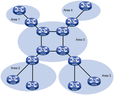

OSPF areas
In large OSPF routing domains, SPF route computations consume too many storage and CPU resources, and enormous OSPF packets generated for route synchronization occupy excessive bandwidth.
To resolve these issues, OSPF splits an AS into multiple areas. Each area is identified by an area ID. The boundaries between areas are routers rather than links. A network segment (or a link) can only reside in one area as shown in Figure 1.
You can configure route summarization on ABRs to reduce the number of LSAs advertised to other areas and minimize the effect of topology changes.
Figure 1 Area-based OSPF network partition

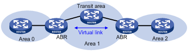

In practice, these requirements might not be met due to lack of physical links. OSPF virtual links can solve this issue.
A virtual link is established between two ABRs through a non-backbone area. It must be configured on both ABRs to take effect. The non-backbone area is called a transit area.
As shown in Figure 2, Area 2 has no direct physical link to the backbone Area 0. You can configure a virtual link between the two ABRs to connect Area 2 to the backbone area.
Figure 2 Virtual link application 1
Virtual links can also be used as redundant links. If a physical link failure breaks the internal connectivity of the backbone area, you can configure a virtual link to replace the failed physical link, as shown in Figure 3.

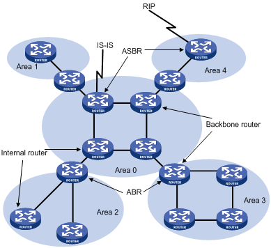

Router types
OSPF routers are classified into the following types based on their positions in the AS:
·     Internal router—All interfaces on an internal router belong to one OSPF area.
·     ABR—Belongs to more than two areas, one of which must be the backbone area. ABR connects the backbone area to a non-backbone area. An ABR and the backbone area can be connected through a physical or logical link.
·     Backbone router—No less than one interface of a backbone router must reside in the backbone area. All ABRs and internal routers in Area 0 are backbone routers.
·     ASBR—Exchanges routing information with another AS is an ASBR. An ASBR might not reside on the border of the AS. It can be an internal router or an ABR.
Figure 5 OSPF router types

Configuring a virtual link
Virtual links are configured for connecting backbone area routers that have no direct physical links.
To configure a virtual link:
Step
Remarks
N/A
2.     Enter OSPF view.
ospf [ process-id | router-id router-id | vpn-instance vpn-instance-name ] *
N/A
3.     Enter area view.
area area-id
N/A
4.     Configure a virtual link.
vlink-peer router-id [ dead seconds | hello seconds | { { hmac-md5 | md5 } key-id { cipher | plain } string | keychain keychain-name | simple { cipher | plain } string } | retransmit seconds | trans-delay seconds ] *
By default, no virtual links exist.
Configure this command on both ends of a virtual link. The hello and dead intervals must be identical on both ends of the virtual link.

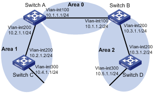

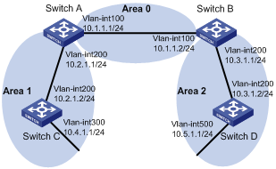

OSPF configuration examples
Basic OSPF configuration example
Network requirements
As shown in Figure 8:
·     Enable OSPF on all switches, and split the AS into three areas.
·     Configure Switch A and Switch B as ABRs.
Figure 8 Network diagram
Configuration procedure
1.     Configure IP addresses for interfaces. (Details not shown.)
2.     Enable OSPF:
# Configure Switch A.
<SwitchA> system-view
[SwitchA] router id 10.2.1.1
[SwitchA] ospf
[SwitchA-ospf-1] area 0
[SwitchA-ospf-1-area-0.0.0.0] network 10.1.1.0 0.0.0.255
[SwitchA-ospf-1-area-0.0.0.0] quit
[SwitchA-ospf-1] area 1
[SwitchA-ospf-1-area-0.0.0.1] network 10.2.1.0 0.0.0.255
[SwitchA-ospf-1-area-0.0.0.1] quit
[SwitchA-ospf-1] quit
# Configure Switch B.
<SwitchB> system-view
[SwitchB] router id 10.3.1.1
[SwitchB] ospf
[SwitchB-ospf-1] area 0
[SwitchB-ospf-1-area-0.0.0.0] network 10.1.1.0 0.0.0.255
[SwitchB-ospf-1-area-0.0.0.0] quit
[SwitchB-ospf-1] area 2
[SwitchB-ospf-1-area-0.0.0.2] network 10.3.1.0 0.0.0.255
[SwitchB-ospf-1-area-0.0.0.2] quit
[SwitchB-ospf-1] quit
# Configure Switch C.
<SwitchC> system-view
[SwitchC] router id 10.4.1.1
[SwitchC] ospf
[SwitchC-ospf-1] area 1
[SwitchC-ospf-1-area-0.0.0.1] network 10.2.1.0 0.0.0.255
[SwitchC-ospf-1-area-0.0.0.1] network 10.4.1.0 0.0.0.255
[SwitchC-ospf-1-area-0.0.0.1] quit
[SwitchC-ospf-1] quit
# Configure Switch D.
<SwitchD> system-view
[SwitchD] router id 10.5.1.1
[SwitchD] ospf
[SwitchD-ospf-1] area 2
[SwitchD-ospf-1-area-0.0.0.2] network 10.3.1.0 0.0.0.255
[SwitchD-ospf-1-area-0.0.0.2] network 10.5.1.0 0.0.0.255
[SwitchD-ospf-1-area-0.0.0.2] quit
[SwitchD-ospf-1] quit
# Display information about neighbors on Switch A.
[SwitchA] display ospf peer verbose
          OSPF Process 1 with Router ID 10.2.1.1
                  Neighbors
 Area 0.0.0.0 interface 10.1.1.1(Vlan-interface100)'s neighbors
 Router ID: 10.3.1.1         Address: 10.1.1.2         GR State: Normal
   State: Full  Mode: Nbr is master  Priority: 1
   DR: 10.1.1.1  BDR: 10.1.1.2  MTU: 0
   Options is 0x02 (-|-|-|-|-|-|E|-)
   Dead timer due in 37  sec
   Neighbor is up for 06:03:59
   Authentication Sequence: [ 0 ]
   Neighbor state change count: 5
 Area 0.0.0.1 interface 10.2.1.1(Vlan-interface200)'s neighbors
 Router ID: 10.4.1.1         Address: 10.2.1.2         GR State: Normal
   DR: 10.2.1.1  BDR: 10.2.1.2  MTU: 0
   Dead timer due in 32  sec
   Neighbor is up for 06:03:12
# Display OSPF routing information on Switch A.
[SwitchA] display ospf routing
                   Routing Table
 Routing for network
 Destination        Cost     Type    NextHop         AdvRouter       Area
 10.2.1.0/24        1        Transit 10.2.1.1        10.2.1.1        0.0.0.1

OSPF route redistribution configuration example
As shown in Figure 9:
·     Enable OSPF on all the switches.
·     Split the AS into three areas.
·     Configure Switch C as an ASBR to redistribute external routes (static routes).
Figure 9 Network diagram
2.     Enable OSPF (see "Basic OSPF configuration example").
3.     Configure OSPF to redistribute routes:

# Display the ABR/ASBR information on Switch D.
<SwitchD> display ospf abr-asbr
          OSPF Process 1 with Router ID 10.5.1.1
                  Routing Table to ABR and ASBR
 Type        Destination     Area            Cost  Nexthop         RtType
 Intra       10.3.1.1        0.0.0.2         10    10.3.1.1        ABR
 Inter       10.4.1.1        0.0.0.2         22    10.3.1.1        ASBR
# Display the OSPF routing table on Switch D.
<SwitchD> display ospf routing
                   Routing Table
 Routing for network
 10.2.1.0/24        22       Inter   10.3.1.1        10.3.1.1        0.0.0.2
 10.3.1.0/24        10       Transit 10.3.1.2        10.3.1.1        0.0.0.2
 10.4.1.0/24        25       Inter   10.3.1.1        10.3.1.1        0.0.0.2
 10.5.1.0/24        10       Stub    10.5.1.1        10.5.1.1        0.0.0.2
 10.1.1.0/24        12       Inter   10.3.1.1        10.3.1.1        0.0.0.2
 Routing for ASEs
 Destination        Cost     Type    Tag         NextHop         AdvRouter
 3.1.2.0/24         1        Type2   1           10.3.1.1        10.4.1.1
 Total nets: 6
 Intra area: 2  Inter area: 3  ASE: 1  NSSA: 0

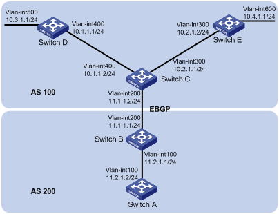

OSPF route summarization configuration example
As shown in Figure 10:
·     Configure OSPF on Switch A and Switch B in AS 200.
·     Configure OSPF on Switch C, Switch D, and Switch E in AS 100.
·     Configure an EBGP connection between Switch B and Switch C. Configure Switch B and Switch C to redistribute OSPF routes and direct routes into BGP and BGP routes into OSPF.
·     Configure Switch B to advertise only summary route 10.0.0.0/8 to Switch A.
Figure 10 Network diagram
2.     Enable OSPF:
[SwitchA] router id 11.2.1.2
[SwitchA] ospf
[SwitchA-ospf-1-area-0.0.0.0] network 11.2.1.0 0.0.0.255
[SwitchB] router id 11.2.1.1
[SwitchB] ospf
[SwitchB-ospf-1-area-0.0.0.0] network 11.2.1.0 0.0.0.255
[SwitchC] router id 11.1.1.2
[SwitchC] ospf
[SwitchC-ospf-1] area 0
[SwitchC-ospf-1-area-0.0.0.0] network 10.1.1.0 0.0.0.255
[SwitchC-ospf-1-area-0.0.0.0] network 10.2.1.0 0.0.0.255
[SwitchC-ospf-1-area-0.0.0.0] quit
[SwitchD] router id 10.3.1.1
[SwitchD] ospf
[SwitchD-ospf-1] area 0
[SwitchD-ospf-1-area-0.0.0.0] network 10.1.1.0 0.0.0.255
[SwitchD-ospf-1-area-0.0.0.0] network 10.3.1.0 0.0.0.255
[SwitchD-ospf-1-area-0.0.0.0] quit
# Configure Switch E.
<SwitchE> system-view
[SwitchE] router id 10.4.1.1
[SwitchE] ospf
[SwitchE-ospf-1] area 0
[SwitchE-ospf-1-area-0.0.0.0] network 10.2.1.0 0.0.0.255
[SwitchE-ospf-1-area-0.0.0.0] network 10.4.1.0 0.0.0.255
[SwitchE-ospf-1-area-0.0.0.0] quit
[SwitchE-ospf-1] quit
3.     Configure BGP to redistribute OSPF routes and direct routes:
[SwitchB] bgp 200
[SwitchB-bgp] peer 11.1.1.2 as 100
[SwitchB-bgp] address-family ipv4 unicast
[SwitchB-bgp-ipv4] import-route ospf
[SwitchB-bgp-ipv4] import-route direct
[SwitchB-bgp ipv4] quit
[SwitchB-bgp] quit
[SwitchC] bgp 100
[SwitchC-bgp] peer 11.1.1.1 as 200
[SwitchC-bgp] address-family ipv4 unicast
[SwitchC-bgp-ipv4] import-route ospf
[SwitchC-bgp-ipv4]import-route direct
[SwitchC-bgp-ipv4] quit
[SwitchC-bgp] quit
4.     Configure Switch B and Switch C to redistribute BGP routes into OSPF:
# Configure OSPF to redistribute routes from BGP on Switch B.
[SwitchB] ospf
[SwitchB-ospf-1] import-route bgp
# Configure OSPF to redistribute routes from BGP on Switch C.
[SwitchC] ospf
[SwitchC-ospf-1] import-route bgp
# Display the OSPF routing table on Switch A.
[SwitchA] display ip routing-table
         Destinations : 16        Routes : 16
0.0.0.0/32          Direct 0    0            127.0.0.1       InLoop0
10.1.1.0/24         O_ASE2 150  1            11.2.1.1        Vlan100
10.2.1.0/24         O_ASE2 150  1            11.2.1.1        Vlan100
10.3.1.0/24         O_ASE2 150  1            11.2.1.1        Vlan100
10.4.1.0/24         O_ASE2 150  1            11.2.1.1        Vlan100
11.2.1.0/24         Direct 0    0            11.2.1.2        Vlan100
11.2.1.0/32         Direct 0    0            11.2.1.2        Vlan100
11.2.1.2/32         Direct 0    0            127.0.0.1       InLoop0
11.2.1.255/32       Direct 0    0            11.2.1.2        Vlan100
127.0.0.0/8         Direct 0    0            127.0.0.1       InLoop0
127.0.0.0/32        Direct 0    0            127.0.0.1       InLoop0
127.0.0.1/32        Direct 0    0            127.0.0.1       InLoop0
127.255.255.255/32  Direct 0    0            127.0.0.1       InLoop0
224.0.0.0/4         Direct 0    0            0.0.0.0         NULL0
224.0.0.0/24        Direct 0    0            0.0.0.0         NULL0
255.255.255.255/32  Direct 0    0            127.0.0.1       InLoop0
5.     Configure route summarization:
# Configure route summarization on Switch B to advertise a summary route 10.0.0.0/8.
[SwitchB-ospf-1] asbr-summary 10.0.0.0 8
# Display the IP routing table on Switch A.
         Destinations : 13        Routes : 13
10.0.0.0/8          O_ASE2 150  2            11.2.1.1        Vlan100
The output shows that routes 10.1.1.0/24, 10.2.1.0/24, 10.3.1.0/24 and 10.4.1.0/24 are summarized into a single route 10.0.0.0/8.

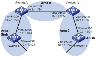

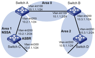

OSPF stub area configuration example
As shown in Figure 11:
·     Configure Switch A and Switch B as ABRs to forward routing information between areas.
·     Configure Switch D as the ASBR to redistribute static routes.
·     Configure Area 1 as a stub area to reduce advertised LSAs without influencing reachability.
Figure 11 Network diagram
3.     Configure route redistribution:
# Configure Switch D to redistribute static routes.
[SwitchD] ip route-static 3.1.2.1 24 10.5.1.2
[SwitchD] ospf
[SwitchD-ospf-1] import-route static
# Display ABR/ASBR information on Switch C.
<SwitchC> display ospf abr-asbr
          OSPF Process 1 with Router ID 10.4.1.1
 Intra       10.2.1.1        0.0.0.1         3     10.2.1.1        ABR
 Inter       10.5.1.1        0.0.0.1         7     10.2.1.1        ASBR
# Display OSPF routing table on Switch C.
<SwitchC> display ospf routing
                   Routing Table
 Routing for network
 10.2.1.0/24        3        Transit 0.0.0.0         10.2.1.1        0.0.0.1
 10.3.1.0/24        7        Inter   10.2.1.1        10.2.1.1        0.0.0.1
 10.4.1.0/24        3        Stub    10.4.1.1        10.4.1.1        0.0.0.1
 10.5.1.0/24        17       Inter   10.2.1.1        10.2.1.1        0.0.0.1
 10.1.1.0/24        5        Inter   10.2.1.1        10.2.1.1        0.0.0.1
 Routing for ASEs
 3.1.2.0/24         1        Type2   1           10.2.1.1        10.5.1.1
 Total nets: 6
The output shows that Switch C's routing table contains an AS external route.
4.     Configure Area 1 as a stub area:
[SwitchA] ospf
[SwitchA-ospf-1-area-0.0.0.1] stub
[SwitchC] ospf
[SwitchC-ospf-1-area-0.0.0.1] stub
# Display OSPF routing information on Switch C
[SwitchC] display ospf routing
                   Routing Table
 Routing for network
 0.0.0.0/0          4        Inter   10.2.1.1        10.2.1.1        0.0.0.1
 Total nets: 6
 Intra area: 2  Inter area: 4  ASE: 0  NSSA: 0
The output shows that a default route replaces the AS external route.
# Configure Area 1 as a totally stub area.
[SwitchA] ospf
[SwitchA-ospf-1-area-0.0.0.1] stub no-summary
# Display OSPF routing information on Switch C.
                   Routing Table
 Routing for network
 10.2.1.0/24        3        Transit 0.0.0.0         10.4.1.1        0.0.0.1
 Total nets: 3
 Intra area: 2  Inter area: 1  ASE: 0  NSSA: 0

OSPF NSSA area configuration example
As shown in Figure 12:
·     Configure OSPF on all switches and split AS into three areas.
·     Configure Area 1 as an NSSA area and configure Switch C as an ASBR to redistribute static routes into the AS.
Figure 12 Network diagram
3.     Configure Area 1 as an NSSA area:
[SwitchA] ospf
[SwitchA-ospf-1-area-0.0.0.1] nssa
[SwitchC] ospf
[SwitchC-ospf-1-area-0.0.0.1] nssa
                   Routing Table
 Routing for network
 10.2.1.0/24        3        Transit 10.2.1.2        10.4.1.1        0.0.0.1
 Total nets: 5
 Intra area: 2  Inter area: 3  ASE: 0  NSSA: 0
4.     Configure route redistribution:
# Configure Switch C to redistribute static routes.
[SwitchC] ip route-static 3.1.3.1 24 10.4.1.2
[SwitchC] ospf
[SwitchC-ospf-1] import-route static
# Display OSPF routing information on Switch D.
                   Routing Table
 Routing for network
 Routing for ASEs
 3.1.3.0/24         1        Type2   1           10.3.1.1        10.2.1.1
 Total nets: 6
The output shows that an external route imported from the NSSA area exists on Switch D.
