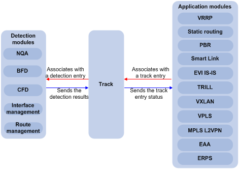

The Track module works between application modules and detection modules, as shown in Figure 1. It shields the differences between various detection modules from application modules.
Collaboration is enabled when you associate the Track module with a detection module and an application module, and it operates as follows:
1.     The detection module probes specific objects such as interface status, link status, network reachability, and network performance, and informs the Track module of detection results.
2.     The Track module sends the detection results to the application module.
3.     When notified of changes for the tracked object, the application modules can react to avoid communication interruption and network performance degradation.
Figure 1 Collaboration through the Track module

The Track module collaborates with detection modules and application modules.
Collaboration between the Track module and a detection module
The detection module sends the detection result of the tracked object to the Track module. The Track module changes the status of the track entry as follows:
·     If the tracked object operates correctly, the state of the track entry is Positive. For example, the track entry state is Positive in one of the following conditions:
¡     The target interface is up.
¡     The target network is reachable.
·     If the tracked object does not operate correctly, the state of the track entry is Negative. For example, the track entry state is Negative in one of the following conditions:
¡     The target interface is down.
¡     The target network is unreachable.
·     If the detection result is invalid, the state of the track entry is NotReady. For example, the track entry state is NotReady if its associated NQA operation does not exist.
The following detection modules can be associated with the Track module:
·     NQA.
·     BFD.
·     CFD.
·     Interface management.
·     Route management.
Collaboration between the Track module and an application module
The following application modules can be associated with the Track module:
·     VRRP.
·     Static routing.
·     PBR.
·     Smart Link.
·     EVI IS-IS.
·     TRILL.
·     VPLS.
·     VXLAN.
·     MPLS L2VPN.
·     EAA.
·     ERPS.
When configuring a track entry for an application module, you can set a notification delay to avoid immediate notification of status changes.
When the delay is not configured and the route convergence is slower than the link state change notification, communication failures occur. For example, when the master in a VRRP group detects an uplink interface failure through Track, Track immediately notifies the master to decrease its priority. A backup with a higher priority then preempts as the new master. When the failed uplink interface recovers, the Track module immediately notifies the original master to restore its priority. If the uplink route has not recovered, forwarding failure will occur.

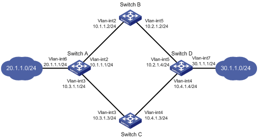

Collaboration application example
The following is an example of collaboration between NQA, Track, and static routing.
Configure a static route with the next hop 192.168.0.88 on the device. If the next hop is reachable, the static route is valid. If the next hop becomes unreachable, the static route is invalid. For this purpose, configure NQA-Track-static routing collaboration as follows:
1.     Create an NQA operation to monitor the accessibility of IP address 192.168.0.88.
2.     Create a track entry and associate it with the NQA operation.
¡     When the next hop 192.168.0.88 is reachable, NQA sends the result to the Track module. The Track module sets the track entry to Positive state.
¡     When the next hop becomes unreachable, NQA sends the result to the Track module. The Track module sets the track entry to Negative state.
3.     Associate the track entry with the static route.
¡     When the track entry is in Positive state, the static routing module considers the static route to be valid.
¡     When the track entry is in Negative state, the static routing module considers the static route to be invalid.

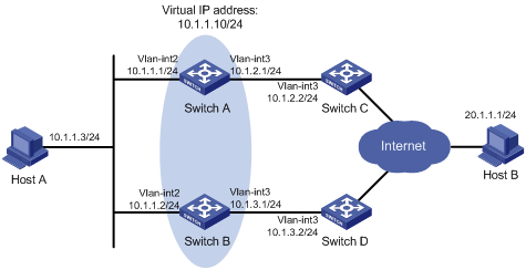

Associating Track with VRRP
When VRRP is operating in standard mode or load balancing mode, associate the Track module with the VRRP group to implement the following actions:
·     Change the priority of a router according to the status of the uplink. If a fault occurs on the uplink of the router, the VRRP group is not aware of the uplink failure. If the router is the master, hosts in the LAN cannot access the external network. To resolve this problem, configure a detection module-Track-VRRP collaboration. The detection module monitors the status of the uplink of the router and notifies the Track module of the detection result.
When the uplink fails, the detection module notifies the Track module to change the status of the monitored track entry to Negative. The priority of the master decreases by a user-specified value. A router with a higher priority in the VRRP group becomes the master.

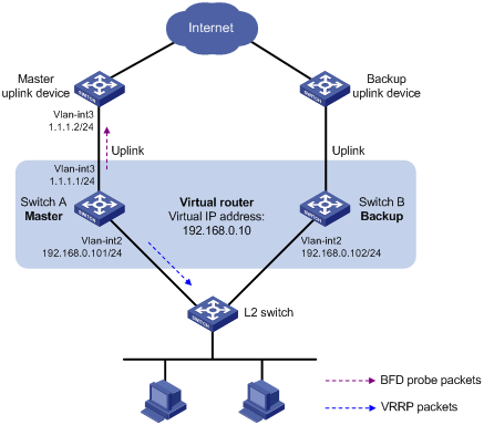

·     Monitor the master on a backup. If a fault occurs on the master, the backup operating in switchover mode will switch to the master immediately to maintain normal communication.
When VRRP is operating in load balancing mode, associate the Track module with the VRRP VF to implement the following functions:
·     Change the priority of the AVF according to its uplink state. When the uplink of the AVF fails, the track entry changes to Negative state. The weight of the AVF decreases by a user-specified value. The VF with a higher priority becomes the new AVF to forward packets.
·     Monitor the AVF status from the LVF. When the AVF fails, the LVF that is operating in switchover mode becomes the new AVF to ensure continuous forwarding.
When you associate Track with VRRP, follow these restrictions and guidelines:
·     VRRP tracking does not take effect on an IP address owner. The configuration takes effect when the router does not act as the IP address owner.
An IP address owner is the router with its interface IP address used as the virtual IP address of the VRRP group.
·     When the status of the track entry changes from Negative to Positive or NotReady, the associated router or VF restores its priority automatically.
Associating Track with a VRRP group

Associating Track with static routing
A static route is a manually configured route to route packets. For more information about static route configuration, see Layer 3—IP Routing Configuration Guide.
Static routes cannot adapt to network topology changes. Link failures or network topological changes can make the routes unreachable and cause communication interruption.
To resolve this problem, configure another route to back up the static route. When the static route is reachable, packets are forwarded through the static route. When the static route is unreachable, packets are forwarded through the backup route.
To check the accessibility of a static route in real time, associate the Track module with the static route.
If you specify the next hop but not the output interface when configuring a static route, you can configure the static routing-Track-detection module collaboration. This collaboration enables you to verify the accessibility of the static route based on the track entry state.
·     If the track entry is in Positive state, the following conditions exist:
¡     The next hop of the static route is reachable.
¡     The configured static route is valid.
·     If the track entry is in Negative state, the following conditions exist:
¡     The next hop of the static route is not reachable.
¡     The configured static route is invalid.
·     If the track entry is in NotReady state, the following conditions exist:

VRRP-Track-NQA collaboration configuration example
Network requirements
As shown in Figure 2:
·     Host A requires access to Host B. The default gateway of Host A is 10.1.1.10/24.
·     Switch A and Switch B belong to VRRP group 1. The virtual IP address of VRRP group 1 is 10.1.1.10.
Configure VRRP-Track-NQA collaboration to monitor the uplink on the master and meet the following requirements:
·     When Switch A operates correctly, Switch A forwards packets from Host A to Host B.
·     When NQA detects a fault on the uplink of Switch A, Switch B forwards packets from Host A to Host B.
Figure 2 Network diagram
Configuration procedure
1.     Create VLANs and assign ports to them. Configure the IP address of each VLAN interface, as shown in Figure 2. (Details not shown.)
2.     Configure an NQA operation on Switch A:
# Create an NQA operation with administrator name admin and operation tag test.
<SwitchA> system-view
[SwitchA] nqa entry admin test
# Configure the operation type as ICMP echo.
[SwitchA-nqa-admin-test] type icmp-echo
# Specify 10.1.2.2 as the destination address of ICMP echo requests.
[SwitchA-nqa-admin-test-icmp-echo] destination ip 10.1.2.2
# Configure the ICMP echo operation to repeat every 100 milliseconds.
[SwitchA-nqa-admin-test-icmp-echo] frequency 100
# Configure reaction entry 1, specifying that five consecutive probe failures trigger the Track module.
[SwitchA-nqa-admin-test-icmp-echo] reaction 1 checked-element probe-fail threshold-type consecutive 5 action-type trigger-only
[SwitchA-nqa-admin-test-icmp-echo] quit
# Start the NQA operation.
[SwitchA] nqa schedule admin test start-time now lifetime forever
3.     On Switch A, configure track entry 1, and associate it with reaction entry 1 of the NQA operation.
[SwitchA] track 1 nqa entry admin test reaction 1
4.     Configure VRRP on Switch A:
# Specify VRRPv2 to run on the interface VLAN-interface 2.
[SwitchA-Vlan-interface2] vrrp version 2
# Create VRRP group 1, and configure the virtual IP address 10.1.1.10 for the group.
[SwitchA-Vlan-interface2] vrrp vrid 1 virtual-ip 10.1.1.10
# Set the priority of Switch A to 110 in VRRP group 1.
[SwitchA-Vlan-interface2] vrrp vrid 1 priority 110
# Set the authentication mode of VRRP group 1 to simple, and the authentication key to hello.
[SwitchA-Vlan-interface2] vrrp vrid 1 authentication-mode simple hello
# Configure the master to send VRRP packets every 500 centiseconds.
[SwitchA-Vlan-interface2] vrrp vrid 1 timer advertise 500
# Configure Switch A to operate in preemptive mode and set the preemption delay to 5000 centiseconds.
[SwitchA-Vlan-interface2] vrrp vrid 1 preempt-mode timer delay 5000
# Associate VRRP group 1 with track entry 1 and decrease the router priority by 30 when the state of track entry 1 changes to negative.
[SwitchA-Vlan-interface2] vrrp vrid 1 track 1 priority reduced 30
5.     Configure VRRP on Switch B:
<SwitchB> system-view
[SwitchB-Vlan-interface2] vrrp version 2
[SwitchB-Vlan-interface2] vrrp vrid 1 virtual-ip 10.1.1.10
[SwitchB-Vlan-interface2] vrrp vrid 1 authentication-mode simple hello
[SwitchB-Vlan-interface2] vrrp vrid 1 timer advertise 500
# Configure Switch B to operate in preemptive mode and set the preemption delay to 5000 centiseconds.
[SwitchB-Vlan-interface2] vrrp vrid 1 preempt-mode timer delay 5000
# Ping Host B from Host A to verify that Host B is reachable. (Details not shown.)
# Display detailed information about VRRP group 1 on Switch A.
[SwitchA-Vlan-interface2] display vrrp verbose
IPv4 Virtual Router Information:
 Running Mode      : Standard
 Total number of virtual routers : 1
   Interface Vlan-interface2
     VRID           : 1               Adver Timer  : 500
     Admin Status   : Up              State        : Master
     Config Pri     : 110             Running Pri  : 110
     Preempt Mode   : Yes             Delay Time   : 5000
     Auth Type      : Simple          Key          : ******
     Virtual IP     : 10.1.1.10
     Virtual MAC    : 0000-5e00-0101
     Master IP      : 10.1.1.1
   VRRP Track Information:
     Track Object   : 1              State : Positive          Pri Reduced : 30
# Display detailed information about VRRP group 1 on Switch B.
[SwitchB-Vlan-interface2] display vrrp verbose
     Admin Status   : Up              State        : Backup
     Config Pri     : 100             Running Pri  : 100
     Become Master  : 2200ms left
The output shows that in VRRP group 1, Switch A is the master, and Switch B is a backup. Switch A forwards packets from Host A to Host B.
# Disconnect the link between Switch A and Switch C, and verify that Host A can still ping Host B. (Details not shown.)
     Config Pri     : 110             Running Pri  : 80
     Master IP      : 10.1.1.2
     Track Object   : 1              State : Negative          Pri Reduced : 30
The output shows that Switch A becomes the backup, and Switch B becomes the master. Switch B forwards packets from Host A to Host B.

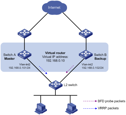

Configuring BFD for a VRRP backup to monitor the master
As shown in Figure 3:
·     Switch A and Switch B belong to VRRP group 1. The virtual IP address of VRRP group 1 is 192.168.0.10.
·     The default gateway of the hosts in the LAN is 192.168.0.10.
Configure VRRP-Track-BFD collaboration to monitor the master on the backup and meet the following requirements:
·     When Switch A operates correctly, the hosts in the LAN access the Internet through Switch A.
·     When Switch A fails, the backup (Switch B) can detect the state change of the master through BFD and become the new master. The hosts in the LAN access the Internet through Switch B.
Figure 3 Network diagram
1.     Create VLANs and assign ports to them. Configure the IP address of each VLAN interface, as shown in Figure 3. (Details not shown.)
2.     Configure Switch A:
# Create VRRP group 1, and configure the virtual IP address 192.168.0.10 for the group.
[SwitchA-Vlan-interface2] vrrp vrid 1 virtual-ip 192.168.0.10
[SwitchA-Vlan-interface2] return
3.     Configure Switch B:
# Specify 10.10.10.10 as the source address of BFD echo packets.
[SwitchB] bfd echo-source-ip 10.10.10.10
# Create track entry 1, and associate it with the BFD session to verify the reachability of Switch A.
[SwitchB] track 1 bfd echo interface vlan-interface 2 remote ip 192.168.0.101 local ip 192.168.0.102
[SwitchB-Vlan-interface2] vrrp vrid 1 virtual-ip 192.168.0.10
# Configure VRRP group 1 to monitor the status of track entry 1.
[SwitchB-Vlan-interface2] vrrp vrid 1 track 1 switchover
[SwitchB-Vlan-interface2] return
<SwitchA> display vrrp verbose
     VRID           : 1               Adver Timer  : 100
     Preempt Mode   : Yes             Delay Time   : 0
     Auth Type      : None
     Virtual IP     : 192.168.0.10
     Master IP      : 192.168.0.101
<SwitchB> display vrrp verbose
     Auth Type      : None
     Track Object   : 1              State : Positive          Switchover
# Display information about track entry 1 on Switch B.
<SwitchB> display track 1
Track ID: 1
  State: Positive
  Duration: 0 days 0 hours 0 minutes 32 seconds
  Notification delay: Positive 0, Negative 0 (in seconds)
  Tracked object:
    BFD session mode: Echo
Outgoing interface: Vlan-interface2
VPN instance name: -
    Remote IP: 192.168.0.101
    Local IP: 192.168.0.102
The output shows that when the status of the track entry becomes Positive, Switch A is the master and Switch B is the backup.
# Enable VRRP state debugging and BFD event notification debugging on Switch B.
<SwitchB> terminal debugging
<SwitchB> terminal monitor
<SwitchB> debugging vrrp fsm
<SwitchB> debugging bfd ntfy
# When Switch A fails, the following output is displayed on Switch B.
*Dec 17 14:44:34:142 2008 SwitchB BFD/7/DEBUG: Notify application:TRACK State:DOWN
*Dec 17 14:44:34:144 2008 SwitchB VRRP4/7/FSM:
 IPv4 Vlan-interface2 | Virtual Router 1 : Backup --> Master   reason: The status of the tracked object changed
# Display detailed information about the VRRP group on Switch B.
     Auth Type      : None
     Master IP      : 192.168.0.102
     Track Object   : 1              State : Negative          Switchover
The output shows that when BFD detects that Switch A fails, the Track module notifies VRRP to change the status of Switch B to master. The backup can quickly preempt as the master without waiting for a period three times the advertisement interval plus the Skew_Time.
Configuring BFD for the VRRP master to monitor the uplinks
As shown in Figure 4:
Configure VRRP-Track-BFD collaboration to monitor the uplink on the master and meet the following requirements:
·     When Switch A detects that the uplink is down through BFD, Switch B can preempt as the master. The hosts in the LAN can access the Internet through Switch B.
Figure 4 Network diagram
1.     Create VLANs and assign ports to them. Configure the IP address of each VLAN interface, as shown in Figure 4. (Details not shown.)
[SwitchA] bfd echo-source-ip 10.10.10.10
# Create track entry 1 for the BFD session to verify the reachability of the uplink device (1.1.1.2 ).
[SwitchA] track 1 bfd echo interface vlan-interface 3 remote ip 1.1.1.2 local ip 1.1.1.1
# Create VRRP group 1, and specify 192.168.0.10 as the virtual IP address of the group.
# Associate VRRP group 1 with track entry 1 and decrease the router priority by 20 when the state of track entry 1 changes to negative.
[SwitchA-Vlan-interface2] vrrp vrid 1 track 1 priority reduced 20
3.     On Switch B, create VRRP group 1, and specify 192.168.0.10 as the virtual IP address of the group.
# Display detailed information about the VRRP group on Switch A.
     Auth Type      : None
     Track Object   : 1               State : Positive   Pri Reduced : 20
# Display information about track entry 1 on Switch A.
<SwitchA> display track 1
Track ID: 1
  State: Positive
  Tracked object:
    Remote IP: 1.1.1.2
    Local IP: 1.1.1.1
     Auth Type      : None
The output shows that when the status of track entry 1 becomes Positive, Switch A is the master and Switch B is the backup.
# Display information about track entry 1 when the uplink of Switch A goes down.
Track ID: 1
  State: Negative
  Tracked object:
    Remote IP: 1.1.1.2
    Local IP: 1.1.1.1
     Config Pri     : 110             Running Pri  : 90
     Auth Type      : None
     Track Object   : 1               State : Negative   Pri Reduced : 20
     Auth Type      : None
The output shows that when Switch A detects that the uplink fails through BFD, it decreases its priority by 20. Switch B then preempts as the master.
Static routing-Track-NQA collaboration configuration example
As shown in Figure 5:
·     Switch A is the default gateway of the hosts in network 20.1.1.0/24.
·     Switch D is the default gateway of the hosts in network 30.1.1.0/24.
·     Hosts in the two networks communicate with each other through static routes.
To ensure network availability, configure route backup and static routing-Track-NQA collaboration on Switch A and Switch D as follows:
·     On Switch A, assign a higher priority to the static route to 30.1.1.0/24 with the next hop Switch B. This route is the master route. The static route to 30.1.1.0/24 with the next hop Switch C acts as the backup route. When the master route is unavailable, the backup route takes effect. Switch A forwards packets to 30.1.1.0/24 through Switch C.
·     On Switch D, assign a higher priority to the static route to 20.1.1.0/24 with the next hop Switch B. This route is the master route. The static route to 20.1.1.0/24 with the next hop Switch C acts as the backup route. When the master route is unavailable, the backup route takes effect. Switch D forwards packets to 20.1.1.0/24 through Switch C.
Figure 5 Network diagram
1.     Create VLANs and assign ports to them. Configure the IP address of each VLAN interface, as shown in Figure 5. (Details not shown.)
# Configure a static route to 30.1.1.0/24 with the next hop 10.1.1.2 and the default priority 60. Associate this static route with track entry 1.
[SwitchA] ip route-static 30.1.1.0 24 10.1.1.2 track 1
# Configure a static route to 30.1.1.0/24 with the next hop 10.3.1.3 and the priority 80.
[SwitchA] ip route-static 30.1.1.0 24 10.3.1.3 preference 80
# Configure a static route to 10.2.1.4 with the next hop 10.1.1.2.
[SwitchA] ip route-static 10.2.1.4 24 10.1.1.2
# Create an NQA operation with administrator admin and operation tag test.
# Specify 10.2.1.4 as the destination address of the operation.
[SwitchA-nqa-admin-test-icmp-echo] destination ip 10.2.1.4
# Specify 10.1.1.2 as the next hop of the operation.
[SwitchA-nqa-admin-test-icmp-echo] next-hop ip 10.1.1.2
# Configure track entry 1, and associate it with reaction entry 1 of the NQA operation.
# Configure a static route to 30.1.1.0/24 with the next hop 10.2.1.4.
[SwitchB] ip route-static 30.1.1.0 24 10.2.1.4
# Configure a static route to 20.1.1.0/24 with the next hop 10.1.1.1.
[SwitchB] ip route-static 20.1.1.0 24 10.1.1.1
4.     Configure Switch C:
# Configure a static route to 30.1.1.0/24 with the next hop 10.4.1.4.
<SwitchC> system-view
[SwitchC] ip route-static 30.1.1.0 24 10.4.1.4
# Configure a static route to 20.1.1.0/24 with the next hop 10.3.1.1.
[SwitchC] ip route-static 20.1.1.0 24 10.3.1.1
5.     Configure Switch D:
# Configure a static route to 20.1.1.0/24 with the next hop 10.2.1.2 and the default priority 60. Associate this static route with track entry 1.
<SwitchD> system-view
[SwitchD] ip route-static 20.1.1.0 24 10.2.1.2 track 1
# Configure a static route to 20.1.1.0/24 with the next hop 10.4.1.3 and the priority 80.
[SwitchD] ip route-static 20.1.1.0 24 10.4.1.3 preference 80
# Configure a static route to 10.1.1.1 with the next hop 10.2.1.2.
[SwitchD] ip route-static 10.1.1.1 24 10.2.1.2
[SwitchD] nqa entry admin test
# Specify the ICMP echo operation type.
[SwitchD-nqa-admin-test] type icmp-echo
# Specify 10.1.1.1 as the destination address of the operation.
[SwitchD-nqa-admin-test-icmp-echo] destination ip 10.1.1.1
# Specify 10.2.1.2 as the next hop of the operation.
[SwitchD-nqa-admin-test-icmp-echo] next-hop ip 10.2.1.2
[SwitchD-nqa-admin-test-icmp-echo] frequency 100
[SwitchD-nqa-admin-test-icmp-echo] reaction 1 checked-element probe-fail threshold-type consecutive 5 action-type trigger-only
[SwitchD-nqa-admin-test-icmp-echo] quit
[SwitchD] nqa schedule admin test start-time now lifetime forever
[SwitchD] track 1 nqa entry admin test reaction 1
# Display information about the track entry on Switch A.
[SwitchA] display track all
Track ID: 1
  State: Positive
  Tracked object:
    NQA entry: admin test
    Reaction: 1
    Remote IP/URL: --
    Local IP: --
    Interface: --
The output shows that the status of the track entry is Positive, indicating that the NQA operation has succeeded and the master route is available.
# Display the routing table of Switch A.
[SwitchA] display ip routing-table
Destinations : 10       Routes : 10
10.1.1.0/24         Direct 0    0            10.1.1.1        Vlan2
10.1.1.1/32         Direct 0    0            127.0.0.1       InLoop0
10.2.1.0/24         Static 60   0            10.1.1.2        Vlan2
10.3.1.0/24         Direct 0    0            10.3.1.1        Vlan3
10.3.1.1/32         Direct 0    0            127.0.0.1       InLoop0
20.1.1.0/24         Direct 0    0            20.1.1.1        Vlan6
20.1.1.1/32         Direct 0    0            127.0.0.1       InLoop0
30.1.1.0/24         Static 60   0            10.1.1.2        Vlan2
127.0.0.0/8         Direct 0    0            127.0.0.1       InLoop0
127.0.0.1/32        Direct 0    0            127.0.0.1       InLoop0
The output shows that Switch A forwards packets to 30.1.1.0/24 through Switch B.
# Remove the IP address of interface VLAN-interface 2 on Switch B.
[SwitchB-Vlan-interface2] undo ip address
Track ID: 1
  State: Negative
  Tracked object:
    Reaction: 1
    Remote IP/URL: --
    Local IP: --
    Interface: --
The output shows that the status of the track entry is Negative, indicating that the NQA operation has failed and the master route is unavailable.
30.1.1.0/24         Static 80   0            10.3.1.3        Vlan3
The output shows that Switch A forwards packets to 30.1.1.0/24 through Switch C. The backup static route has taken effect.
# Verify that hosts in 20.1.1.0/24 can communicate with the hosts in 30.1.1.0/24 when the master route fails.
[SwitchA] ping -a 20.1.1.1 30.1.1.1
Ping 30.1.1.1: 56  data bytes, press CTRL_C to break
Reply from 30.1.1.1: bytes=56 Sequence=1 ttl=254 time=2 ms
Reply from 30.1.1.1: bytes=56 Sequence=2 ttl=254 time=1 ms
Reply from 30.1.1.1: bytes=56 Sequence=3 ttl=254 time=1 ms
Reply from 30.1.1.1: bytes=56 Sequence=4 ttl=254 time=2 ms
Reply from 30.1.1.1: bytes=56 Sequence=5 ttl=254 time=1 ms
--- Ping statistics for 30.1.1.1 ---
5 packet(s) transmitted, 5 packet(s) received, 0.00% packet loss
round-trip min/avg/max/std-dev = 1/1/2/1 ms
# Verify that the hosts in 30.1.1.0/24 can communicate with the hosts in 20.1.1.0/24 when the master route fails.
[SwitchB] ping -a 30.1.1.1 20.1.1.1
Ping 20.1.1.1: 56  data bytes, press CTRL_C to break
Reply from 20.1.1.1: bytes=56 Sequence=1 ttl=254 time=2 ms
Reply from 20.1.1.1: bytes=56 Sequence=2 ttl=254 time=1 ms
Reply from 20.1.1.1: bytes=56 Sequence=3 ttl=254 time=1 ms
Reply from 20.1.1.1: bytes=56 Sequence=4 ttl=254 time=1 ms
Reply from 20.1.1.1: bytes=56 Sequence=5 ttl=254 time=1 ms
--- Ping statistics for 20.1.1.1 ---
Static routing-Track-BFD collaboration configuration example
As shown in Figure 6:
·     Switch B is the default gateway of the hosts in network 30.1.1.0/24.
To ensure network availability, configure route backup and static routing-Track-BFD collaboration on Switch A and Switch B as follows:
·     On Switch A, assign a higher priority to the static route to 30.1.1.0/24 with the next hop Switch B. This route is the master route. The static route to 30.1.1.0/24 with the next hop Switch C acts as the backup route. When the master route is unavailable, BFD can quickly detect the route failure to make the backup route take effect.
·     On Switch B, assign a higher priority to the static route to 20.1.1.0/24 with the next hop Switch A. This route is the master route. The static route to 20.1.1.0/24 with the next hop Switch C acts as the backup route. When the master route is unavailable, BFD can quickly detect the route failure to make the backup route take effect.
Figure 6 Network diagram
1.     Create VLANs and assign ports to them. Configure the IP address of each VLAN interface, as shown in Figure 6. (Details not shown.)
# Configure a static route to 30.1.1.0/24 with the next hop 10.2.1.2 and the default priority 60. Associate this static route with track entry 1.
[SwitchA] ip route-static 30.1.1.0 24 10.2.1.2 track 1
# Configure track entry 1, and associate it with the BFD session to verify the connectivity between Switch A and Switch B.
[SwitchA] track 1 bfd echo interface vlan-interface 2 remote ip 10.2.1.2 local ip 10.2.1.1
# Configure a static route to 20.1.1.0/24 with the next hop 10.2.1.1 and the default priority 60. Associate this static route with track entry 1.
[SwitchB] ip route-static 20.1.1.0 24 10.2.1.1 track 1
[SwitchB] ip route-static 20.1.1.0 24 10.4.1.3 preference 80
# Specify 1.1.1.1 as the source address of BFD echo packets.
[SwitchB] bfd echo-source-ip 1.1.1.1
# Configure track entry 1, and associate it with the BFD session to verify the connectivity between Switch B and Switch A.
[SwitchB] track 1 bfd echo interface vlan-interface 2 remote ip 10.2.1.1 local ip 10.2.1.2
# Configure a static route to 30.1.1.0/24 with the next hop 10.4.1.2.
[SwitchC] ip route-static 30.1.1.0 24 10.4.1.2
[SwitchB] ip route-static 20.1.1.0 24 10.3.1.1
Track ID: 1
  State: Positive
  Tracked object:
    Remote IP: 10.2.1.2
    Local IP: 10.2.1.1
The output shows that the status of the track entry is Positive, indicating that the next hop 10.2.1.2 is reachable.
Destinations : 9        Routes : 9
Destination/Mask    Proto  Pre  Cost         NextHop         Interface
10.2.1.0/24         Direct 0    0            10.2.1.1        Vlan2
10.2.1.1/32         Direct 0    0            127.0.0.1       InLoop0
20.1.1.0/24         Direct 0    0            20.1.1.1        Vlan5
30.1.1.0/24         Static 60   0            10.2.1.2        Vlan2
The output shows that Switch A forwards packets to 30.1.1.0/24 through Switch B. The master static route has taken effect.
# Remove the IP address of VLAN-interface 2 on Switch B.
Track ID: 1
  State: Negative
  Tracked object:
    Remote IP: 10.2.1.2
    Local IP: 10.2.1.1
The output shows that the status of the track entry is Negative, indicating that the next hop 10.2.1.2 is unreachable.
# Verify that the hosts in 20.1.1.0/24 can communicate with the hosts in 30.1.1.0/24 when the master route fails.

VRRP-Track-route management collaboration configuration example
As shown in Figure 8:
·     BGP peer relationships are established between Switch A and Switch C and between Switch B and Switch D. Switch C and Switch D advertise the default route 0.0.0.0/0 to Switch A and Switch B.
Configure VRRP-Track-route management collaboration to meet the following requirements:
·     When VRRP detects the removal of the default route from the routing table of Switch A through route management, Switch B forwards packets from Host A to Host B.
Figure 8 Network diagram

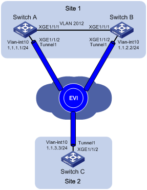

[SwitchA] interface tunnel 1 mode evi
# Specify the IP address of VLAN-interface 10 as the source IP of the EVI tunnel.
[SwitchA-Tunnel1] source 1.1.1.1
# Set the network ID to 1 for the EVI tunnel interface.
[SwitchA-Tunnel1] evi network-id 1
# Specify extended VLANs on the EVI tunnel interface.
[SwitchA-Tunnel1] evi extend-vlan 21 to 100
# Configure Switch A as an ENDC of Switch B.
[SwitchA-Tunnel1] evi neighbor-discovery client enable 1.1.2.2
[SwitchA-Tunnel1] quit
# Associate track entry 1 with BFD to monitor the link between Switch A and Switch C.
[SwitchA] bfd echo-source-ip 8.8.8.81
[SwitchA] track 1 bfd echo interface vlan-interface 10 remote ip 1.1.3.3 local ip 1.1.1.1
# Associate the EVI tunnel interface with track entry 1.
[SwitchA-Tunnel1] evi isis track 1
# Configure VLAN 2012 as the designated EVI IS-IS site VLAN, and assign Ten-GigabitEthernet 1/1/1 to the VLAN.
[SwitchA] vlan 2012
[SwitchA-vlan2012] port ten-gigabitethernet 1/1/1
[SwitchA-vlan2012] quit
[SwitchA] evi designated-vlan 2012
# Enable EVI on the transport-facing port Ten-GigabitEthernet 1/1/2.
[SwitchA] interface ten-gigabitethernet 1/1/2
[SwitchA-Ten-GigabitEthernet1/1/2] evi enable
[SwitchA-Ten-GigabitEthernet1/1/2] quit
# Configure the site ID.
[SwitchB] evi site-id 1
# Create VLAN 10, and assign the transport-facing physical interface Ten-GigabitEthernet 1/1/2 to VLAN 10.
[SwitchB] vlan 10
[SwitchB-vlan10] port ten-gigabitethernet 1/1/2
[SwitchB-vlan10] quit
# Create VLAN-interface 10, and assign an IP address to it.
[SwitchB] interface vlan-interface 10
[SwitchB-Vlan-interface10] ip address 1.1.2.2 24
[SwitchB-Vlan-interface10] quit
# Create an IPv4 EVI tunnel interface.
[SwitchB] interface tunnel 1 mode evi
[SwitchB-Tunnel1] source 1.1.2.2
[SwitchB-Tunnel1] evi network-id 1
[SwitchB-Tunnel1] evi extend-vlan 21 to 100
# Configure Switch B as an ENDS on the EVI tunnel interface.
[SwitchB-Tunnel1] evi neighbor-discovery server enable
# Set a DED priority of 100 on the EVI tunnel interface.
[SwitchB-Tunnel1] evi isis ded-priority 100
[SwitchB-Tunnel1] quit
# Associate track entry 1 with BFD to monitor the link between Switch B and Switch C.
[SwitchB] bfd echo-source-ip 8.8.8.82
[SwitchB] track 1 bfd echo interface vlan-interface 10 remote ip 1.1.3.3 local ip 1.1.2.2
[SwitchB-Tunnel1] evi isis track 1
[SwitchB] vlan 2012
[SwitchB-vlan2012] port ten-gigabitethernet 1/1/1
[SwitchB-vlan2012] quit
[SwitchB] evi designated-vlan 2012
[SwitchB] interface ten-gigabitethernet 1/1/2
[SwitchB-Ten-GigabitEthernet1/1/2] evi enable
[SwitchB-Ten-GigabitEthernet1/1/2] quit
[SwitchC] evi site-id 2
[SwitchC] vlan 10
[SwitchC-vlan10] port ten-gigabitethernet 1/1/2
[SwitchC-vlan10] quit
[SwitchC] interface vlan-interface 10
[SwitchC-Vlan-interface10] ip address 1.1.3.3 24
[SwitchC-Vlan-interface10] quit
[SwitchC] interface tunnel 1 mode evi
[SwitchC-Tunnel1] source 1.1.3.3
[SwitchC-Tunnel1] evi network-id 1
[SwitchC-Tunnel1] evi extend-vlan 21 to 100
# Configure Switch C as an ENDC of Switch B.
[SwitchC-Tunnel1] evi neighbor-discovery client enable 1.1.2.2
[SwitchC-Tunnel1] quit
[SwitchC] interface ten-gigabitethernet 1/1/2
[SwitchC-Ten-GigabitEthernet1/1/2] evi enable
[SwitchC-Ten-GigabitEthernet1/1/2] quit
1.     Verify the configuration on Switch A:
# Display neighbor entries that Switch A has learned.
[SwitchA] display evi neighbor-discovery client member
Interface: Tunnel1    Network ID: 1
Local Address: 1.1.1.1
Server Address: 1.1.2.2
Neighbor        System ID         Created Time           Expire    Status
1.1.2.2         c4ca-d94d-1385    2016/01/06 09:40:26    64        Up
1.1.3.3         c4ca-d94d-138d    2016/01/06 09:40:26    64        Up
# Display information about EVI-Link interfaces.
[SwitchA] display evi link interface tunnel 1
Interface     Status Source          Destination
EVI-Link0     UP     1.1.1.1         1.1.2.2
EVI-Link1     UP     1.1.1.1         1.1.3.3
# Display BFD session information.
[SwitchA] display bfd session
 Total Session Num: 1     Up Session Num: 1     Init Mode: Active
 IPv4 Session Working Under Echo Mode:
 LD             SourceAddr      DestAddr        State    Holdtime    Interface
 1025           1.1.1.1         1.1.3.3         Up       2331ms      Vlan10
The output shows that the BFD session on Switch A is up. This state indicates that the EVI link from Switch A to Switch C is operating correctly.
# Display EVI IS-IS information for the EVI tunnel interface. Check the DED field and the LAV field to verify the DED role and active extended VLANs on Switch A. Check the AEF field to verify the qualification of Switch A as an appointed edge forwarder.
[SwitchA] display evi isis tunnel 1
Tunnel1
MTU: 1400
DED: No
DED priority: 64
Hello timer: 10s
Hello multiplier: 3
CSNP timer: 10s
LSP timer: 100ms
LSP transmit-throttle count: 5
AEF: Yes
EVI-Link0    DED: Yes
EVI-Link1    DED: No
LAV:
  61-100
The output shows that Switch A is not elected the DED for site 1 because of its low DED priority. Switch A can be an appointed edge forwarder for extended VLANs. VLAN 61 to VLAN 100 are active on Switch A.
2.     Verify the configuration on Switch B:
# Display neighbor entries that Switch B has learned.
[SwitchB] display evi neighbor-discovery client member interface tunnel 1
Local Address: 1.1.2.2
1.1.1.1         c4ca-d94d-1200    2016/01/06 09:40:30    74        Up
1.1.3.3         c4ca-d94d-138d    2016/01/06 09:40:15    74        Up
# Display EVI neighbors registered with the ENDS.
[SwitchB] display evi neighbor-discovery server member interface tunnel 1
IP Address: 1.1.2.2
Client Address  System ID         Expire    Created Time
1.1.1.1         c4ca-d94d-1200    64        2016/01/06 09:40:16
1.1.2.2         c4ca-d94d-1385    68        2016/01/06 09:32:00
1.1.3.3         c4ca-d94d-138d    67        2016/01/06 09:40:14
[SwitchB] display evi link interface tunnel 1
EVI-Link0     UP     1.1.2.2         1.1.1.1
EVI-Link1     UP     1.1.2.2         1.1.3.3
[SwitchB] display bfd session
 1025           1.1.2.2         1.1.3.3         Up       2055ms      Vlan10
The output shows that the BFD session on Switch B is up. This state indicates that the EVI link from Switch B to Switch C is operating correctly.
# Display EVI IS-IS information for the EVI tunnel interface. Check the DED field and the LAV field to verify the DED role and active extended VLANs on Switch B. Check the AEF field to verify the qualification of Switch B as an appointed edge forwarder.
[SwitchB] display evi isis tunnel 1
Tunnel1
MTU: 1400
DED: Yes
DED priority: 100
Hello timer: 10s
Hello multiplier: 3
CSNP timer: 10s
LSP timer: 100ms
AEF: Yes
EVI-Link0    DED: Yes
EVI-Link1    DED: Yes
LAV:
  21-60
The output shows that Switch B is elected the DED for site 1 because of its high DED priority. Switch B can be an appointed edge forwarder for extended VLANs. VLAN 21 to VLAN 60 are active on Switch B.
3.     Verify the configuration on Switch C:
# Display neighbor entries that Switch C has learned.
[SwitchC] display evi neighbor-discovery client member
Local Address: 1.1.3.3
1.1.1.1         c4ca-d94d-1200    2016/01/06 09:40:29    64        Up
1.1.2.2         c4ca-d94d-1385    2016/01/06 09:40:29    64        Up
[SwitchC] display evi link interface tunnel 1
EVI-Link0     UP     1.1.3.3         1.1.1.1
EVI-Link1     UP     1.1.3.3         1.1.2.2
4.     Verify that hosts in different sites can ping one another in the same extended VLAN.
5.     Verify that a failover occurs immediately after BFD detects an EVI link failure on Switch B.
# Display BFD session information on Switch A.
 1025           1.1.1.1         1.1.3.3         Up       2330ms      Vlan10
The output shows that the BFD session on the EVI link between Switch A and Switch C is up. The EVI link on Switch A is operating correctly.
# Display BFD session information on Switch B.
 Total Session Num: 1     Up Session Num: 0     Init Mode: Active
 1025           1.1.2.2         1.1.3.3         Down        /        Vlan10
The output shows that the BFD session on the EVI link between Switch B and Switch C is down. This state indicates that the EVI link has failed.
# On Switch A, verify that all active VLANs on Switch B have been moved to Switch A after the EVI link on Switch B fails.
Tunnel1
MTU: 1400
DED: No
DED priority: 64
Hello timer: 10s
Hello multiplier: 3
CSNP timer: 10s
LSP timer: 100ms
AEF: Yes
EVI-Link0    DED: Yes
EVI-Link1    DED: No
LAV:
  21-100
# Verify that the appointed edge forwarder role of Switch B has been removed because it is down, and the switch does not have any active VLANs.
Tunnel1
MTU: 1400
DED: Yes
DED priority: 100
Hello timer: 10s
Hello multiplier: 3
CSNP timer: 10s
LSP timer: 100ms
AEF: No
EVI-Link0    DED: Yes
LAV:
  None
