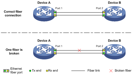

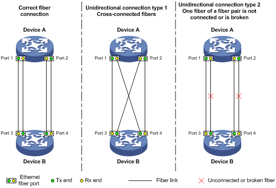

A link becomes unidirectional when only one end of the link can receive packets from the other end.
Unidirectional fiber links occur in the following cases:
·     Fibers are cross-connected.
·     A fiber is not connected at one end or one fiber of a fiber pair is broken.
Figure 1 shows a correct fiber connection and two types of unidirectional fiber connections.
Figure 1 Correct and incorrect fiber connections

Figure 2 Cross-connected fibers
As shown in Figure 2, before you enable DLDP, the optical fibers between Device A and Device B are cross-connected. After you enable DLDP, the four ports are all up and in Unidirectional state, and they send RecoverProbe packets. Take Port 1 as an example to illustrate the unidirectional link detection process.

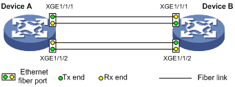

Figure 4 Network diagram
As shown in Figure 4, Device A through Device D are connected through a hub, and enabled with DLDP. When Ports 1, 2, and 3 detect that the link to Port 4 fails, they delete the neighborship with Port 4, but stay in Bidirectional state.

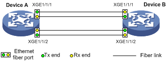

As shown in Figure 5, Device A and Device B are connected through two fiber pairs.
Configure DLDP to automatically shut down the faulty port upon detecting a unidirectional link, and automatically bring up the port after you clear the fault.
Figure 5 Network diagram

Configuring the manual port shutdown mode
Network requirements
As shown in Figure 6, Device A and Device B are connected through two fiber pairs.
Configure DLDP to detect unidirectional links. When a unidirectional link is detected, the administrator must manually shut down the port.
Figure 6 Network diagram
Configuration procedure

Configuring the hybrid port shutdown mode
As shown in Figure 7, Device A and Device B are connected through two fiber pairs.
Configure DLDP to detect unidirectional links. When a unidirectional link is detected, DLDP automatically shuts down the unidirectional port. The administrator needs to bring up the port after clearing the fault.
Figure 7 Network diagram

 DLDP port state: Bidirectional
 Number of the port’s neighbors: 1
  Neighbor MAC address: 0023-8956-3600
  Neighbor port index: 2
  Neighbor state: Confirmed
  Neighbor aged time: 12s
The output shows that both Ten-GigabitEthernet 1/1/1 and Ten-GigabitEthernet 1/1/2 are in Bidirectional state, which means both links are bidirectional.
# Enable the monitoring of logs on the current terminal on Device A. Set the lowest level of the logs that can be output to the current terminal to 6.
[DeviceA] quit
<DeviceA> terminal monitor
<DeviceA> terminal logging level 6
The following log information is displayed on Device A:
  <DeviceA>%Jan  4 07:16:06:556 2011 DeviceA DLDP/5/DLDP_NEIGHBOR_AGED: A neighbor on interface
Ten-GigabitEthernet1/1/1 was deleted because the neighbor was aged. The neighbor's system MAC is 0023-8956-3600, and the port index is 162.
%Jan  4 07:16:06:560 2011 DeviceA DLDP/5/DLDP_NEIGHBOR_AGED: A neighbor on interface
Ten-GigabitEthernet1/1/2 was deleted because the neighbor was aged. The neighbor's system MAC is 0023-8956-3600, and the port index is 165.
%Jan  4 07:16:06:724 2011 DeviceA IFNET/3/PHY_UPDOWN: Physical state on the interface Ten-GigabitEthernet1/1/1 changed to down.
%Jan  4 07:16:06:730 2011 DeviceA IFNET/3/PHY_UPDOWN: Physical state on the interface Ten-GigabitEthernet1/1/2 changed to down.
%Jan  4 07:16:06:736 2011 DeviceA IFNET/5/LINK_UPDOWN: Line protocol state on the interface Ten-GigabitEthernet1/1/1 changed to down.
%Jan  4 07:16:06:738 2011 DeviceA IFNET/5/LINK_UPDOWN: Line protocol state on the interface Ten-GigabitEthernet1/1/2 changed to down.
%Jan  4 07:16:07:152 2011 DeviceA DLDP/3/DLDP_LINK_UNIDIRECTIONAL: DLDP detected a unidirectional link on interface Ten-GigabitEthernet1/1/1. DLDP automatically shut down the interface. Please manually bring up the interface.
%Jan  4 07:16:07:156 2011 DeviceA DLDP/3/DLDP_LINK_UNIDIRECTIONAL: DLDP detected a unidirectional link on interface Ten-GigabitEthernet1/1/2. DLDP automatically shut down the interface. Please manually bring up the interface.
The output shows that the port status and link status of both Ten-GigabitEthernet 1/1/1 and Ten-GigabitEthernet 1/1/2 are down.
# Display the DLDP configuration globally and of all the DLDP-enabled ports.
<DeviceA> display dldp
 DLDP global status: Enabled
 DLDP advertisement interval: 5s
 DLDP authentication-mode: None
 DLDP unidirectional-shutdown mode: Hybrid
 DLDP delaydown-timer value: 1s
 Number of enabled ports: 2
Interface Ten-GigabitEthernet1/1/1
 DLDP port state: Inactive
 Number of the port's neighbors: 0 (Maximum number ever detected: 1)
Interface Ten-GigabitEthernet1/1/2
The output shows that DLDP detects a unidirectional link and shuts down Ten-GigabitEthernet 1/1/1 and Ten-GigabitEthernet 1/1/2.
The unidirectional links are caused by cross-connected fibers. Bring up the two ports after correct the fiber connection:
# Bring up Ten-GigabitEthernet 1/1/1.
<DeviceA> system-view
[DeviceA] interface ten-gigabitethernet 1/1/1
[DeviceA-Ten-GigabitEthernet1/1/1] undo shutdown
[DeviceA-Ten-GigabitEthernet1/1/1]%Jan  4 07:33:26:574 2011 DeviceA IFNET/3/PHY_UPDOWN: Physical state on the interface Ten-GigabitEthernet1/1/1 changed to up.
%Jan  4 07:33:57:562 2011 DeviceA DLDP/6/DLDP_NEIGHBOR_CONFIRMED: A neighbor was confirmed on interface Ten-GigabitEthernet1/1/1. The neighbor's system MAC is 0023-8956-3600, and the port index is 162.
%Jan  4 07:33:57:563 2011 DeviceA DLDP/6/DLDP_LINK_BIDIRECTIONAL: DLDP detected a bidirectional link on interface Ten-GigabitEthernet1/1/1.
%Jan  4 07:33:57:590 2011 DeviceA IFNET/5/LINK_UPDOWN: Line protocol state on the interface Ten-GigabitEthernet1/1/1 changed to up.
%Jan  4 07:33:57:609 2011 DeviceA STP/6/STP_DETECTED_TC: Instance 0's port Ten-GigabitEthernet1/1/1 detected a topology change.
The output shows that the port status and link status of Ten-GigabitEthernet 1/1/1 are now up and its DLDP neighbors are determined.
# Bring up Ten-GigabitEthernet 1/1/2.
[DeviceA-Ten-GigabitEthernet1/1/1] quit
[DeviceA] interface ten-gigabitethernet 1/1/2
[DeviceA-Ten-GigabitEthernet1/1/2] undo shutdown
[DeviceA-Ten-GigabitEthernet1/1/2]%Jan  4 07:35:26:574 2011 DeviceA IFNET/3/PHY_UPDOWN: Physical state on the interface Ten-GigabitEthernet1/1/2 changed to up.
%Jan  4 07:35:57:562 2011 DeviceA DLDP/6/DLDP_NEIGHBOR_CONFIRMED: A neighbor was confirmed on interface Ten-GigabitEthernet1/1/2. The neighbor's system MAC is 0023-8956-3600, and the port index is 162.
%Jan  4 07:35:57:563 2011 DeviceA DLDP/6/DLDP_LINK_BIDIRECTIONAL: DLDP detected a bidirectional link on interface Ten-GigabitEthernet1/1/2.
%Jan  4 07:35:57:590 2011 DeviceA IFNET/5/LINK_UPDOWN: Line protocol state on the interface Ten-GigabitEthernet1/1/2 changed to up.
%Jan  4 07:35:57:609 2011 DeviceA STP/6/STP_DETECTED_TC: Instance 0's port Ten-GigabitEthernet1/1/2 detected a topology change.
The output shows that the port status and link status of Ten-GigabitEthernet 1/1/2 are now up and its DLDP neighbors are determined.
