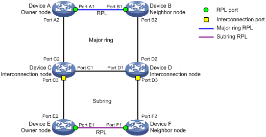

ERPS structure

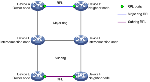

Figure 1 ERPS ring structure
Rings
ERPS rings can be divided into major rings and subrings. An ERPS network consists of one major ring or multiple major rings, and multiple subrings. By default, a ring is a major ring. You can configure a ring as a subring manually.
As shown in Figure 1, a major ring is a closed ring formed by Device A, Device B, Device C, and Device D. A subring is an open ring formed by the link Device C<—>Device E<—>Device F<—>Device D.
Nodes
ERPS nodes include owner nodes, neighbor nodes, interconnection nodes, and normal nodes.
·     The owner node and neighbor node block and unblock ports on the ring protection link (RPL) to prevent loops and switch traffic. An RPL connects an owner node and a neighbor node.
·     Interconnection nodes connect different rings. Interconnection nodes reside on subrings and forward service packets but not protocol packets.
·     Normal nodes forward both service packets and protocol packets.
As shown in Figure 1, on the major ring, Device A is the owner node and Device B is the neighbor node. On the subring, Device E is the owner node and Device F is the neighbor node. Devices C and D are interconnection nodes.
Ports
Each node consists of two ERPS ring member ports: Port 0 and port 1. ERPS ring member ports have the following types:
·     RPL port—Port on an RPL link.
·     Interconnection port—Port that connects a subring to a major ring.
·     Normal port—Default type of a port that forwards both service packets and protocol packets.
As shown in Figure 1, ports A1, B1, E1, and F1 are RPL ports. Ports C3 and D3 are interconnection ports. Other ports are normal ports.

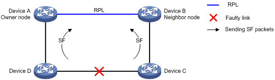

Link-down report mechanism
Figure 2 Link-down report mechanism
As shown in Figure 2, the link-down report mechanism uses the following process:
1.     Device C and Device D detect the link failure and perform the following operations:
a.     Block the ports on both side of the faulty link.
b.     Periodically send SF packets to other nodes.
2.     Device A and Device B receive the SF packets and perform the following operations:
a.     Unblock RPL ports.
b.     Update the MAC address entries.
Service packets are switched to the RPL link.

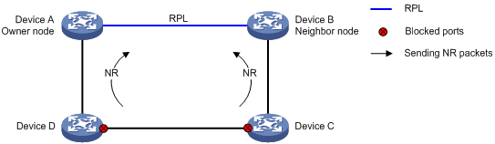

Link recovery mechanism
Figure 3 Link recovery mechanism
As shown in Figure 3, the link recovery mechanism uses the following process:
1.     Device C and Device D detect the link recovery and perform the following operations:
a.     Block the recovered ports.
b.     Start the guard timer.
c.     Send NR packets.
2.     When Device A (owner node) receives the NR packets, it does not perform any operations if it is in non-revertive mode. If Device A is in revertive mode, it performs the following operations:
a.     Starts the WTR timer.
b.     Blocks the RPL port and periodically sends NR-RB packets when the WTR timer expires.
3.     When other nodes receive the NR-RB packets, they perform the following operations:
a.     Device B (neighbor port) blocks the RPL port.
b.     Device C and Device D unblock the recovered ports.
Service packets are switched to the recovered link.

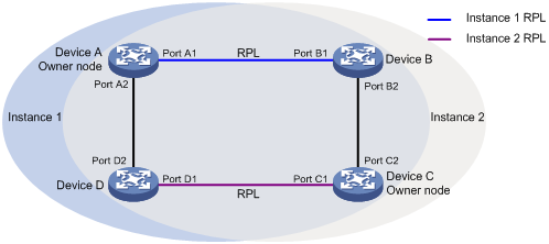

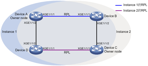

Multi-instance load balancing mechanism
Figure 4 Multi-instance load balancing mechanism
An ERPS ring topology might carry traffic from multiple VLANs. Traffic from different VLANs can be load balanced among different ERPS instances.
ERPS uses the following types of VLANs:
·     Control VLAN—Carries ERPS protocol packets. The system determines the control VLANs for ERPS ring member ports. Each ERPS instance has its own control VLAN.
·     Protected VLAN—Carries data packets. Each ERPS instance has its own protected VLAN. Protected VLANs are configured by using the mappings between VLANs and MSTIs.
As shown in Figure 4, the ERPS ring is configured with instance 1 and instance 2. For instance 1, the owner node is Device A, and the RPL is the link between Device A and Device B. For instance 2, the owner node is Device C, and the RPL is the link between Device C and Device D. Traffic from different VLANs can be load balanced among different links.

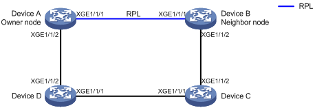

ERPS network diagrams

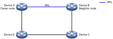

One major ring
The network has one major ring.
Figure 5 Network diagram

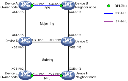

One major ring connecting one subring
The network has one major ring and one subring.
Figure 6 Network diagram

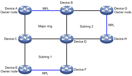

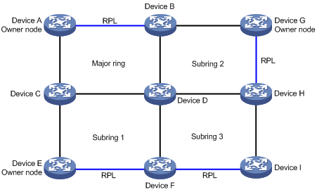

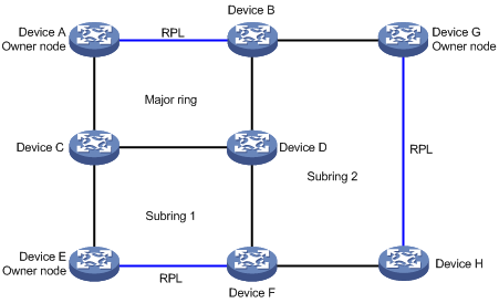

One major ring connecting multiple subrings
The network has three or more rings. Each subring is connected to the major ring by two interconnection nodes.
Figure 7 Network diagram
One subring connecting multiple subrings
The network has three or more rings. As shown in Figure 8, subring 1 is connected to the major ring. Other subrings are connected to subring 1 by two interconnection nodes.
Figure 8 Network diagram

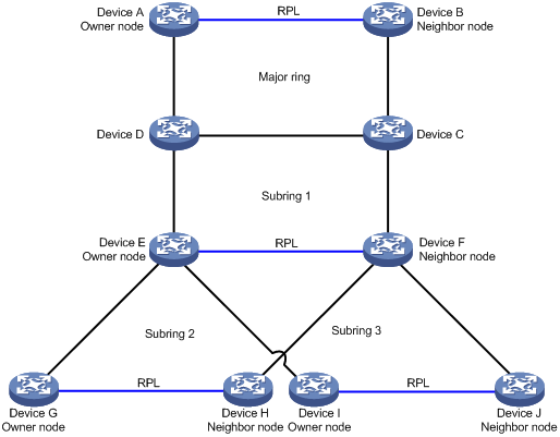

One subring connecting multiple rings
The network has three or more rings. A minimum of one subring is connected to two rings. As shown in Figure 9, one interconnection node on subring 2 is connected to the major ring; and another interconnection node is connected to subring 1. As shown in Figure 10, subring 3 is connected to subring 1 and subring 2.
Figure 9 Network diagram 1
Figure 10 Network diagram 2

One-ring configuration example
Network requirements
As shown in Figure 11, perform the following tasks to eliminate loops on the network:
·     Configure the ring as ERPS ring 1.
·     Configure VLAN 100 as the control VLAN for ERPS ring 1.
·     Configure VLANs 1 to 30 as the protected VLANs for ERPS ring 1.
·     Configure Device A as the owner node, Ten-GigabitEthernet 1/1/1 as ERPS ring member port 0 and the RPL port, and Ten-GigabitEthernet 1/1/2 as ERPS ring member port 1.
·     Configure Device B as the neighbor node, Ten-GigabitEthernet 1/1/1 as ERPS ring member port 0 and the RPL port, and Ten-GigabitEthernet 1/1/2 as ERPS ring member port 1.
·     Configure Device C and Device D as normal nodes, Ten-GigabitEthernet 1/1/1 as ERPS ring member port 0, and Ten-GigabitEthernet 1/1/2 as ERPS ring member port 1.
Figure 11 Network diagram
Configuration procedure
1.     Configure Device A.
# Create VLANs 1 to 30, map these VLANs to MSTI 1, and activate the MST region configuration.
<DeviceA> system-view
[DeviceA] vlan 1 to 30
[DeviceA] stp region-configuration
[DeviceA-mst-region] instance 1 vlan 1 to 30
[DeviceA-mst-region] active region-configuration
[DeviceA-mst-region] quit
# Set the link state change suppression interval to 0 seconds on Ten-GigabitEthernet 1/1/1.
[DeviceA] interface ten-gigabitethernet 1/1/1
[DeviceA-Ten-GigabitEthernet1/1/1] link-delay 0
# Disable the spanning tree feature on the port.
[DeviceA-Ten-GigabitEthernet1/1/1] undo stp enable
# Configure the port as a trunk port and assign it to VLANs 1 to 30.
[DeviceA-Ten-GigabitEthernet1/1/1] port link-type trunk
[DeviceA-Ten-GigabitEthernet1/1/1] port trunk permit vlan 1 to 30
[DeviceA-Ten-GigabitEthernet1/1/1] quit
# Configure Ten-GigabitEthernet 1/1/2 in the same way Ten-GigabitEthernet 1/1/1 is configured.
[DeviceA] interface ten-gigabitethernet 1/1/2
[DeviceA-Ten-GigabitEthernet1/1/2] link-delay 0
[DeviceA-Ten-GigabitEthernet1/1/2] undo stp enable
[DeviceA-Ten-GigabitEthernet1/1/2] port link-type trunk
[DeviceA-Ten-GigabitEthernet1/1/2] port trunk permit vlan 1 to 30
[DeviceA-Ten-GigabitEthernet1/1/2] quit
# Create ERPS ring 1.
[DeviceA] erps ring 1
# Configure ERPS ring member ports.
[DeviceA-erps-ring1] port0 interface ten-gigabitethernet 1/1/1
[DeviceA-erps-ring1] port1 interface ten-gigabitethernet 1/1/2
# Enable R-APS packets to carry ring ID in the destination MAC address.
[DeviceA-erps-ring1] r-aps ring-mac
# Create ERPS instance 1.
[DeviceA-erps-ring1] instance 1
# Configure the node role.
[DeviceA-erps-ring1-inst1] node-role owner rpl port0
# Configure the control VLAN.
[DeviceA-erps-ring1-inst1] control-vlan 100
# Configure the protected VLANs.
[DeviceA-erps-ring1-inst1] protected-vlan reference-instance 1
# Enable ERPS for instance 1.
[DeviceA-erps-ring1-inst1] instance enable
[DeviceA-erps-ring1-inst1] quit
[DeviceA-erps-ring1] quit

[DeviceA-Ten-GigabitEthernet1/1/2] cfd cc service-instance 2 mep 2001 enable
# Create track entry 1 and associate it with the CC function of CFD for MEP 1001 in Ethernet service instance 1.
[DeviceA] track 1 cfd cc service-instance 1 mep 1001
# Associate Ten-GigabitEthernet 1/1/1 with track entry 1 and bring up the port.
[DeviceA-Ten-GigabitEthernet1/1/1] port erps ring 1 instance 1 track 1
[DeviceA-Ten-GigabitEthernet1/1/1] undo shutdown
# Create track entry 2 and associate it with the CC function of CFD for MEP 2001 in Ethernet service instance 2.
[DeviceA] track 2 cfd cc service-instance 2 mep 2001
# Associate Ten-GigabitEthernet 1/1/2 with track entry 2 and bring up the port.
[DeviceA-Ten-GigabitEthernet1/1/2] port erps ring 1 instance 1 track 2
[DeviceA-Ten-GigabitEthernet1/1/2] undo shutdown
# Enable ERPS.
[DeviceA] erps enable
2.     Configure Device B.
<DeviceB> system-view
[DeviceB] vlan 1 to 30
[DeviceB] stp region-configuration
[DeviceB-mst-region] instance 1 vlan 1 to 30
[DeviceB-mst-region] active region-configuration
[DeviceB-mst-region] quit
[DeviceB] interface ten-gigabitethernet 1/1/1
[DeviceB-Ten-GigabitEthernet1/1/1] link-delay 0
[DeviceB-Ten-GigabitEthernet1/1/1] undo stp enable
[DeviceB-Ten-GigabitEthernet1/1/1] port link-type trunk
[DeviceB-Ten-GigabitEthernet1/1/1] port trunk permit vlan 1 to 30
[DeviceB-Ten-GigabitEthernet1/1/1] quit
[DeviceB] interface ten-gigabitethernet 1/1/2
[DeviceB-Ten-GigabitEthernet1/1/2] link-delay 0
[DeviceB-Ten-GigabitEthernet1/1/2] undo stp enable
[DeviceB-Ten-GigabitEthernet1/1/2] port link-type trunk
[DeviceB-Ten-GigabitEthernet1/1/2] port trunk permit vlan 1 to 30
[DeviceB-Ten-GigabitEthernet1/1/2] quit
[DeviceB] erps ring 1
[DeviceB-erps-ring1] port0 interface ten-gigabitethernet 1/1/1
[DeviceB-erps-ring1] port1 interface ten-gigabitethernet 1/1/2
[DeviceB-erps-ring1] r-aps ring-mac
[DeviceB-erps-ring1] instance 1
[DeviceB-erps-ring1-inst1] node-role neighbor rpl port0
[DeviceB-erps-ring1-inst1] control-vlan 100
[DeviceB-erps-ring1-inst1] protected-vlan reference-instance 1
[DeviceB-erps-ring1-inst1] instance enable
[DeviceB-erps-ring1-inst1] quit
[DeviceB-erps-ring1] quit
# Enable CFD, and create a level-5 MD named MD_A.
[DeviceB] cfd enable
[DeviceB] cfd md MD_A level 5
# Create Ethernet service instance 1, in which the MA is identified by a VLAN and serves VLAN 1.
[DeviceB] cfd service-instance 1 ma-id vlan-based md MD_A vlan 1
# Configure a MEP list in Ethernet service instance 1, create outward-facing MEP 1002 in Ethernet service instance 1, and enable CCM sending on Ten-GigabitEthernet 1/1/1.
[DeviceB] cfd meplist 1001 1002 service-instance 1
[DeviceB-Ten-GigabitEthernet1/1/1] cfd mep 1002 service-instance 1 outbound
[DeviceB-Ten-GigabitEthernet1/1/1] cfd cc service-instance 1 mep 1002 enable
# Create Ethernet service instance 3, in which the MA is identified by a VLAN and serves VLAN 3.
[DeviceB] cfd service-instance 3 ma-id vlan-based md MD_A vlan 3
# Configure a MEP list in Ethernet service instance 3, create outward-facing MEP 3002 in Ethernet service instance 1, and enable CCM sending on Ten-GigabitEthernet 1/1/2.
[DeviceB] cfd meplist 3001 3002 service-instance 3
[DeviceB-Ten-GigabitEthernet1/1/2] cfd mep 3002 service-instance 3 outbound
[DeviceB-Ten-GigabitEthernet1/1/2] cfd cc service-instance 3 mep 3002 enable
# Create track entry 1 and associate it with the CC function of CFD for MEP 1002 in Ethernet service instance 1.
[DeviceB] track 1 cfd cc service-instance 1 mep 1002
[DeviceB-Ten-GigabitEthernet1/1/1] port erps ring 1 instance 1 track 1
[DeviceB-Ten-GigabitEthernet1/1/1] undo shutdown
# Create track entry 3 and associate it with the CC function of CFD for MEP 3002 in Ethernet service instance 3.
[DeviceB] track 3 cfd cc service-instance 3 mep 3002
# Associate Ten-GigabitEthernet 1/1/2 with track entry 3 and bring up the port.
[DeviceB-Ten-GigabitEthernet1/1/2] port erps ring 1 instance 1 track 2
[DeviceB-Ten-GigabitEthernet1/1/2] undo shutdown
# Enable ERPS.
[DeviceB] erps enable
3.     Configure Device C.
<DeviceC> system-view
[DeviceC] vlan 1 to 30
[DeviceC] stp region-configuration
[DeviceC-mst-region] instance 1 vlan 1 to 30
[DeviceC-mst-region] active region-configuration
[DeviceC-mst-region] quit
[DeviceC] interface ten-gigabitethernet 1/1/1
[DeviceC-Ten-GigabitEthernet1/1/1] link-delay 0
[DeviceC-Ten-GigabitEthernet1/1/1] undo stp enable
[DeviceC-Ten-GigabitEthernet1/1/1] port link-type trunk
[DeviceC-Ten-GigabitEthernet1/1/1] port trunk permit vlan 1 to 30
[DeviceC-Ten-GigabitEthernet1/1/1] quit
[DeviceC] interface ten-gigabitethernet 1/1/2
[DeviceC-Ten-GigabitEthernet1/1/2] link-delay 0
[DeviceC-Ten-GigabitEthernet1/1/2] undo stp enable
[DeviceC-Ten-GigabitEthernet1/1/2] port link-type trunk
[DeviceC-Ten-GigabitEthernet1/1/2] port trunk permit vlan 1 to 30
[DeviceC-Ten-GigabitEthernet1/1/2] quit
[DeviceC] erps ring 1
[DeviceC-erps-ring1] port0 interface ten-gigabitethernet 1/1/1
[DeviceC-erps-ring1] port1 interface ten-gigabitethernet 1/1/2
[DeviceC-erps-ring1] r-aps ring-mac
[DeviceC-erps-ring1] instance 1
[DeviceC-erps-ring1-inst1] control-vlan 100
[DeviceC-erps-ring1-inst1] protected-vlan reference-instance 1
[DeviceC-erps-ring1-inst1] instance enable
[DeviceC-erps-ring1-inst1] quit
[DeviceC-erps-ring1] quit
[DeviceC] cfd enable
[DeviceC] cfd md MD_A level 5
[DeviceC] cfd service-instance 3 ma-id vlan-based md MD_A vlan 3
# Configure a MEP list in Ethernet service instance 3, create outward-facing MEP 3001 in Ethernet service instance 3, and enable CCM sending on Ten-GigabitEthernet 1/1/1.
[DeviceC] cfd meplist 3001 3002 service-instance 3
[DeviceC-Ten-GigabitEthernet1/1/1] cfd mep 3001 service-instance 3 outbound
[DeviceC-Ten-GigabitEthernet1/1/1] cfd cc service-instance 3 mep 3001 enable
# Create Ethernet service instance 4, in which the MA is identified by a VLAN and serves VLAN 4.
[DeviceC] cfd service-instance 4 ma-id vlan-based md MD_A vlan 4
# Configure a MEP list in Ethernet service instance 4, create outward-facing MEP 4001 in Ethernet service instance 4, and enable CCM sending on Ten-GigabitEthernet 1/1/2.
[DeviceC] cfd meplist 4001 4002 service-instance 4
[DeviceC-Ten-GigabitEthernet1/1/2] cfd mep 4001 service-instance 4 outbound
[DeviceC-Ten-GigabitEthernet1/1/2] cfd cc service-instance 4 mep 4001 enable
# Create track entry 1 and associate it with the CC function of CFD for MEP 3001 in Ethernet service instance 3.
[DeviceC] track 1 cfd cc service-instance 3 mep 3001
# Associate Ten-GigabitEthernet 1/1/2 with track entry 1 and bring up the port.
[DeviceC-Ten-GigabitEthernet1/1/2] port erps ring 1 instance 1 track 1
[DeviceC-Ten-GigabitEthernet1/1/2] undo shutdown
# Create track entry 2 and associate it with the CC function of CFD for MEP 4001 in Ethernet service instance 4.
[DeviceC] track 2 cfd cc service-instance 4 mep 4001
# Associate Ten-GigabitEthernet 1/1/1 with track entry 3 and bring up the port.
[DeviceC-Ten-GigabitEthernet1/1/1] port erps ring 1 instance 1 track 2
[DeviceC-Ten-GigabitEthernet1/1/1] undo shutdown
# Enable ERPS.
[DeviceC] erps enable
4.     Configure Device D.
<DeviceD> system-view
[DeviceD] vlan 1 to 30
[DeviceD] stp region-configuration
[DeviceD-mst-region] instance 1 vlan 1 to 30
[DeviceD-mst-region] active region-configuration
[DeviceD-mst-region] quit
[DeviceD] interface ten-gigabitethernet 1/1/1
[DeviceD-Ten-GigabitEthernet1/1/1] link-delay 0
[DeviceD-Ten-GigabitEthernet1/1/1] undo stp enable
[DeviceD-Ten-GigabitEthernet1/1/1] port link-type trunk
[DeviceD-Ten-GigabitEthernet1/1/1] port trunk permit vlan 1 to 30
[DeviceD-Ten-GigabitEthernet1/1/1] quit
[DeviceD] interface ten-gigabitethernet 1/1/2
[DeviceD-Ten-GigabitEthernet1/1/2] link-delay 0
[DeviceD-Ten-GigabitEthernet1/1/2] undo stp enable
[DeviceD-Ten-GigabitEthernet1/1/2] port link-type trunk
[DeviceD-Ten-GigabitEthernet1/1/2] port trunk permit vlan 1 to 30
[DeviceD-Ten-GigabitEthernet1/1/2] quit
[DeviceD] erps ring 1
[DeviceD-erps-ring1] port0 interface ten-gigabitethernet 1/1/1
[DeviceD-erps-ring1] port1 interface ten-gigabitethernet 1/1/2
[DeviceD-erps-ring1] r-aps ring-mac
[DeviceD-erps-ring1] instance 1
[DeviceD-erps-ring1-inst1] control-vlan 100
[DeviceD-erps-ring1-inst1] protected-vlan reference-instance 1
[DeviceD-erps-ring1-inst1] instance enable
[DeviceD-erps-ring1-inst1] quit
[DeviceD-erps-ring1] quit
[DeviceD] cfd enable
[DeviceD] cfd md MD_A level 5
# Create Ethernet service instance 2, in which the MA is identified by a VLAN and serves VLAN 2.
[DeviceD] cfd service-instance 2 ma-id vlan-based md MD_A vlan 2
# Configure a MEP list in Ethernet service instance 2, create outward-facing MEP 2002 in Ethernet service instance 2, and enable CCM sending on Ten-GigabitEthernet 1/1/2.
[DeviceD] cfd meplist 2001 2002 service-instance 2
[DeviceD-Ten-GigabitEthernet1/1/2] cfd mep 2002 service-instance 2 outbound
[DeviceD-Ten-GigabitEthernet1/1/2] cfd cc service-instance 2 mep 2002 enable
[DeviceD] cfd service-instance 4 ma-id vlan-based md MD_A vlan 4
# Configure a MEP list in Ethernet service instance 4, create outward-facing MEP 4002 in Ethernet service instance 4, and enable CCM sending on Ten-GigabitEthernet 1/1/1.
[DeviceD] cfd meplist 4001 4002 service-instance 4
[DeviceD-Ten-GigabitEthernet1/1/1] cfd mep 4002 service-instance 4 outbound
[DeviceD-Ten-GigabitEthernet1/1/1] cfd cc service-instance 4 mep 4002 enable
# Create track entry 1 and associate it with the CC function of CFD for MEP 2002 in Ethernet service instance 2.
[DeviceD] track 1 cfd cc service-instance 2 mep 2002
[DeviceD-Ten-GigabitEthernet1/1/2] port erps ring 1 instance 1 track 1
[DeviceD-Ten-GigabitEthernet1/1/2] undo shutdown
# Create track entry 2 and associate it with the CC function of CFD for MEP 4002 in Ethernet service instance 4.
[DeviceD] track 2 cfd cc service-instance 4 mep 4002
# Associate Ten-GigabitEthernet 1/1/1 with track entry 2 and bring up the port.
[DeviceD-Ten-GigabitEthernet1/1/1] port erps ring 1 instance 1 track 2
[DeviceD-Ten-GigabitEthernet1/1/1] undo shutdown
# Enable ERPS.
[DeviceD] erps enable

One-subring configuration example
As shown in Figure 12, perform the following tasks to eliminate loops on the network:
·     Configure VLAN 100 and VLAN 200 as the control VLANs for the major ring and the subring, respectively.
·     Configure VLANs 1 to 30 as the protected VLANs for the major ring and subring.
·     Configure Device A as the owner node for the major ring, Ten-GigabitEthernet 1/1/1 as ERPS ring member port 0 and the RPL port, and Ten-GigabitEthernet 1/1/2 as ERPS ring member port 1.
·     Configure Device B as the neighbor node for the major ring, Ten-GigabitEthernet 1/1/1 as ERPS ring member port 0 and the RPL port, and Ten-GigabitEthernet 1/1/2 as ERPS ring member port 1.
·     Configure Devices C and D as interconnection nodes, Ten-GigabitEthernet 1/1/1 as ERPS ring member port 0, Ten-GigabitEthernet 1/1/2 as ERPS ring member port 1, and Ten-GigabitEthernet 1/1/3 as the interconnection port.
·     Configure Device E as the owner node for the subring, Ten-GigabitEthernet 1/1/1 as ERPS ring member port 0 and the RPL port, and Ten-GigabitEthernet 1/1/2 as ERPS ring member port 1.
·     Configure Device F as the neighbor node for the subring, Ten-GigabitEthernet 1/1/1 as ERPS ring member port 0 and the RPL port, and Ten-GigabitEthernet 1/1/2 as ERPS ring member port 1.
Figure 12 Network diagram

[DeviceC-Ten-GigabitEthernet1/1/1] cfd cc service-instance 4 mep 4001 enable
# Create ERPS ring 2.
[DeviceC] erps ring 2
[DeviceC-erps-ring2] port0 interface ten-gigabitethernet 1/1/3
# Configure ERPS ring 2 as the subring.
[DeviceC-erps-ring2] ring-type sub-ring
[DeviceC-erps-ring2] instance 1
[DeviceC-erps-ring2-inst1] node-role interconnection port0
[DeviceC-erps-ring2-inst1] control-vlan 110
[DeviceC-erps-ring2-inst1] protected-vlan reference-instance 1
[DeviceC-erps-ring2-inst1] instance enable
[DeviceC-erps-ring2-inst1] quit
[DeviceC-erps-ring2] quit
# Create Ethernet service instance 5, in which the MA is identified by a VLAN and serves VLAN 5.
[DeviceC] cfd service-instance 5 ma-id vlan-based md MD_A vlan 5
# Configure a MEP list in Ethernet service instance 5, create outward-facing MEP 5001 in Ethernet service instance 3, and enable CCM sending on Ten-GigabitEthernet 1/1/3.
[DeviceC] cfd meplist 5001 5002 service-instance 5
[DeviceC] interface ten-gigabitethernet 1/1/3
[DeviceC-Ten-GigabitEthernet1/1/3] cfd mep 5001 service-instance 5 outbound
[DeviceC-Ten-GigabitEthernet1/1/3] cfd cc service-instance 5 mep 5001 enable
[DeviceC-Ten-GigabitEthernet1/1/3] quit
# Create track entry 1 and associate it with the CC function of CFD for MEP 5001 in Ethernet service instance 3.
[DeviceC] track 1 cfd cc service-instance 5 mep 5001
# Associate Ten-GigabitEthernet 1/1/3 with track entry 1 and bring up the port.
[DeviceC-Ten-GigabitEthernet1/1/3] port erps ring 2 instance 1 track 1
[DeviceC-Ten-GigabitEthernet1/1/3] undo shutdown
# Enable ERPS.
# Configure Ten-GigabitEthernet 1/1/3 in the same way Ten-GigabitEthernet 1/1/1 is configured.
[DeviceD] interface ten-gigabitethernet 1/1/3
[DeviceD-Ten-GigabitEthernet1/1/3] link-delay 0
[DeviceD-Ten-GigabitEthernet1/1/3] undo stp enable
[DeviceD-Ten-GigabitEthernet1/1/3] port link-type trunk
[DeviceD-Ten-GigabitEthernet1/1/3] port trunk permit vlan 1 to 30
[DeviceD-Ten-GigabitEthernet1/1/3] quit
[DeviceD] erps ring 2
[DeviceD-erps-ring2] port0 interface ten-gigabitethernet 1/1/3
[DeviceD-erps-ring2] ring-type sub-ring
[DeviceD-erps-ring2] instance 1
[DeviceD-erps-ring2-inst1] node-role interconnection port0
[DeviceD-erps-ring2-inst1] control-vlan 110
[DeviceD-erps-ring2-inst1] protected-vlan reference-instance 1
[DeviceD-erps-ring2-inst1] instance enable
[DeviceD-erps-ring2-inst1] quit
[DeviceD-erps-ring2] quit
# Create Ethernet service instance 6, in which the MA is identified by a VLAN and serves VLAN 6.
[DeviceD] cfd service-instance 6 ma-id vlan-based md MD_A vlan 6
# Configure a MEP list in Ethernet service instance 6, create outward-facing MEP 6002 in Ethernet service instance 3, and enable CCM sending on Ten-GigabitEthernet 1/1/3.
[DeviceD] cfd meplist 6001 6002 service-instance 6
[DeviceD-Ten-GigabitEthernet1/1/3] cfd mep 6002 service-instance 6 outbound
[DeviceD-Ten-GigabitEthernet1/1/3] cfd cc service-instance 6 mep 6002 enable
# Create track entry 1 and associate it with the CC function of CFD for MEP 6002 in Ethernet service instance 6.
[DeviceD] track 1 cfd cc service-instance 6 mep 6002
[DeviceD-Ten-GigabitEthernet1/1/3] port erps ring 2 instance 1 track 1
[DeviceD-Ten-GigabitEthernet1/1/3] undo shutdown
# Enable ERPS.
5.     Configure Device E.
<DeviceE> system-view
[DeviceE] vlan 1 to 30
[DeviceE] stp region-configuration
[DeviceE-mst-region] instance 1 vlan 1 to 30
[DeviceE-mst-region] active region-configuration
[DeviceE-mst-region] quit
[DeviceE] interface ten-gigabitethernet 1/1/1
[DeviceE-Ten-GigabitEthernet1/1/1] link-delay 0
[DeviceE-Ten-GigabitEthernet1/1/1] undo stp enable
[DeviceE-Ten-GigabitEthernet1/1/1] port link-type trunk
[DeviceE-Ten-GigabitEthernet1/1/1] port trunk permit vlan 1 to 30
[DeviceE-Ten-GigabitEthernet1/1/1] quit
[DeviceE] interface ten-gigabitethernet 1/1/2
[DeviceE-Ten-GigabitEthernet1/1/2] link-delay 0
[DeviceE-Ten-GigabitEthernet1/1/2] undo stp enable
[DeviceE-Ten-GigabitEthernet1/1/2] port link-type trunk
[DeviceE-Ten-GigabitEthernet1/1/2] port trunk permit vlan 1 to 30
[DeviceE-Ten-GigabitEthernet1/1/2] quit
[DeviceE] erps ring 2
[DeviceE-erps-ring2] port0 interface ten-gigabitethernet 1/1/1
[DeviceE-erps-ring2] port1 interface ten-gigabitethernet 1/1/2
[DeviceE-erps-ring2] ring-type sub-ring
[DeviceE-erps-ring2] instance 1
[DeviceE-erps-ring2] node-role owner rpl port0
[DeviceE-erps-ring2-inst1] control-vlan 110
[DeviceE-erps-ring2-inst1] protected-vlan reference-instance 1
[DeviceE-erps-ring2-inst1] instance enable
[DeviceE-erps-ring2-inst1] quit
[DeviceE-erps-ring2] quit
[DeviceE] cfd enable
[DeviceE] cfd md MD_A level 5
[DeviceE] cfd service-instance 6 ma-id vlan-based md MD_A vlan 6
# Configure a MEP list in Ethernet service instance 6, create outward-facing MEP 6001 in Ethernet service instance 6, and enable CCM sending on Ten-GigabitEthernet 1/1/2.
[DeviceE] cfd meplist 6001 6002 service-instance 6
[DeviceE-Ten-GigabitEthernet1/1/2] cfd mep 6001 service-instance 6 outbound
[DeviceE-Ten-GigabitEthernet1/1/2] cfd cc service-instance 6 mep 6001 enable
# Create Ethernet service instance 7, in which the MA is identified by a VLAN and serves VLAN 7.
[DeviceE] cfd service-instance 7 ma-id vlan-based md MD_A vlan 7
# Configure a MEP list in Ethernet service instance 7, create outward-facing MEP 7001 in Ethernet service instance 7, and enable CCM sending on Ten-GigabitEthernet 1/1/1.
[DeviceE] cfd meplist 7001 7002 service-instance 7
[DeviceE-Ten-GigabitEthernet1/1/1] cfd mep 7001 service-instance 7 outbound
[DeviceE-Ten-GigabitEthernet1/1/1] cfd cc service-instance 7 mep 7001 enable
# Create track entry 1 and associate it with the CC function of CFD for MEP 6001 in Ethernet service instance 6.
[DeviceE] track 1 cfd cc service-instance 6 mep 6001
[DeviceE-Ten-GigabitEthernet1/1/2] port erps ring 2 instance 1 track 1
[DeviceE-Ten-GigabitEthernet1/1/2] undo shutdown
# Create track entry 2 and associate it with the CC function of CFD for MEP 7001 in Ethernet service instance 7.
[DeviceE] track 2 cfd cc service-instance 7 mep 7001
[DeviceE-Ten-GigabitEthernet1/1/1] port erps ring 2 instance 1 track 2
[DeviceE-Ten-GigabitEthernet1/1/1] undo shutdown
# Enable ERPS.
[DeviceE] erps enable
6.     Configure Device F.
<DeviceF> system-view
[DeviceF] vlan 1 to 30
[DeviceF] stp region-configuration
[DeviceF-mst-region] instance 1 vlan 1 to 30
[DeviceF-mst-region] active region-configuration
[DeviceF-mst-region] quit
[DeviceF] interface ten-gigabitethernet 1/1/1
[DeviceF-Ten-GigabitEthernet1/1/1] link-delay 0
[DeviceF-Ten-GigabitEthernet1/1/1] undo stp enable
[DeviceF-Ten-GigabitEthernet1/1/1] port link-type trunk
[DeviceF-Ten-GigabitEthernet1/1/1] port trunk permit vlan 1 to 30
[DeviceF-Ten-GigabitEthernet1/1/1] quit
[DeviceF] interface ten-gigabitethernet 1/1/2
[DeviceF-Ten-GigabitEthernet1/1/2] link-delay 0
[DeviceF-Ten-GigabitEthernet1/1/2] undo stp enable
[DeviceF-Ten-GigabitEthernet1/1/2] port link-type trunk
[DeviceF-Ten-GigabitEthernet1/1/2] port trunk permit vlan 1 to 30
[DeviceF-Ten-GigabitEthernet1/1/2] quit
[DeviceF] erps ring 2
[DeviceF-erps-ring2] port0 interface ten-gigabitethernet 1/1/1
[DeviceF-erps-ring2] port1 interface ten-gigabitethernet 1/1/2
[DeviceF-erps-ring2] ring-type sub-ring
[DeviceF-erps-ring2] instance 1
[DeviceF-erps-ring2] node-role neighbor rpl port0
[DeviceF-erps-ring2-inst1] control-vlan 110
[DeviceF-erps-ring2-inst1] protected-vlan reference-instance 1
[DeviceF-erps-ring2-inst1] instance enable
[DeviceF-erps-ring2-inst1] quit
[DeviceF-erps-ring2] quit
[DeviceF] cfd enable
[DeviceF] cfd md MD_A level 5
[DeviceF] cfd service-instance 5 ma-id vlan-based md MD_A vlan 5
# Configure a MEP list in Ethernet service instance 5, create outward-facing MEP 5002 in Ethernet service instance 5, and enable CCM sending on Ten-GigabitEthernet 1/1/2.
[DeviceF] cfd meplist 5001 5002 service-instance 5
[DeviceF-Ten-GigabitEthernet1/1/2] cfd mep 5002 service-instance 5 outbound
[DeviceF-Ten-GigabitEthernet1/1/2] cfd cc service-instance 5 mep 5002 enable
[DeviceF] cfd service-instance 7 ma-id vlan-based md MD_A vlan 7
# Configure a MEP list in Ethernet service instance 7, create outward-facing MEP 7002 in Ethernet service instance 7, and enable CCM sending on Ten-GigabitEthernet 1/1/1.
[DeviceF] cfd meplist 7001 7002 service-instance 7
[DeviceF-Ten-GigabitEthernet1/1/1] cfd mep 7002 service-instance 7 outbound
[DeviceF-Ten-GigabitEthernet1/1/1] cfd cc service-instance 7 mep 7002 enable
# Create track entry 1 and associate it with the CC function of CFD for MEP 5001 in Ethernet service instance 5.
[DeviceF] track 1 cfd cc service-instance 5 mep 5002
[DeviceF-Ten-GigabitEthernet1/1/2] port erps ring 2 instance 1 track 1
[DeviceF-Ten-GigabitEthernet1/1/2] undo shutdown
# Create track entry 2 and associate it with the CC function of CFD for MEP 7002 in Ethernet service instance 7.
[DeviceF] track 2 cfd cc service-instance 7 mep 7002
[DeviceF-Ten-GigabitEthernet1/1/1] port erps ring 2 instance 1 track 2
[DeviceF-Ten-GigabitEthernet1/1/1] undo shutdown
# Enable ERPS.
[DeviceF] erps enable
# Display information about ERPS instance 1 for Device A.
[Device A] display erps detail ring 1
 Ring ID               : 1
 Port0                 : Ten-GigabitEthernet1/1/1
 Port1                 : Ten-GigabitEthernet1/1/2
 Subring               : Yes
 Default MAC           : No
 Instance ID           : 1
 Node role             : Owner
 Node state            : Idle
 Connect(ring/instance): -
 Control VLAN          : 100
 Protected VLAN        : Reference-instance 1
 Guard timer           : 500 ms
 Hold-off timer        : 0 ms
 WTR timer             : 5 min
 Revertive operation   : Revertive
 Enable status         : Yes, Active status : Yes
 R-APS level           : 7
 Port                  PortRole                PortStatus
 Port0                 RPL                     Block
 Port1                 Non-RPL                 Up
The output shows the following information:
·     Device A is the owner node.
·     The ERPS ring is in idle state.
·     The RPL port is blocked.
·     The non-RPL port is unblocked.
One-ring multi-instance load balancing configuration example
As shown in Figure 13, perform the following tasks to improve network resource utilization and implement load balancing among links:
·     Configure ERPS instances 1 and 2 on the ERPS ring.
·     For ERPS instance 1, configure the following items:
¡     Configure Device A as the owner node.
¡     Configure the link between Devices A and Device B as the RPL.
¡     Configure VLAN 100 as the control VLAN.
¡     Configure VLANs 1 to 30 as the protected VLANs.
·     For ERPS instance 2, configure the following items:
¡     Configure the link between Devices C and Device D as the RPL.
¡     Configure VLANs 31 to 60 as the protected VLANs.
Figure 13 Network diagram
# Configure a MEP list in Ethernet service instance 3, create outward-facing MEP 3002 in Ethernet service instance 3, and enable CCM sending on Ten-GigabitEthernet 1/1/2.
# Associate Ten-GigabitEthernet 1/1/1 with track entry 1 and bring up the port for ERPS instances 1 and 2.
[DeviceB-Ten-GigabitEthernet1/1/1] port erps ring 1 instance 2 track 1
# Create track entry 2 and associate it with the CC function of CFD for MEP 3002 in Ethernet service instance 3.
[DeviceB] track 2 cfd cc service-instance 3 mep 3002
# Associate Ten-GigabitEthernet 1/1/2 with track entry 2 and bring up the port for ERPS instances 1 and 2.
[DeviceB-Ten-GigabitEthernet1/1/2] port erps ring 1 instance 2 track 2
# Enable ERPS.
# Create VLANs 1 to 60, map VLANs 1 to 30 to MSTI 1, map VLANs 31 to 60 to MSTI 2, and activate the MST region configuration.
[DeviceC] vlan 1 to 60
[DeviceC-mst-region] instance 2 vlan 31 to 60
# Configure the port as a trunk port and assign it to VLANs 1 to 60.
[DeviceC-Ten-GigabitEthernet1/1/1] port trunk permit vlan 1 to 60
[DeviceC-Ten-GigabitEthernet1/1/2] port trunk permit vlan 1 to 60
# Create ERPS instance 2.
[DeviceC-erps-ring1] instance 2
[DeviceC-erps-ring1-inst2] node-role owner rpl port0
[DeviceC-erps-ring1-inst2] control-vlan 110
[DeviceC-erps-ring1-inst2] protected-vlan reference-instance 2
# Enable ERPS for instance 2.
[DeviceC-erps-ring1-inst2] instance enable
[DeviceC-erps-ring1-inst2] quit
# Configure a MEP list in Ethernet service instance 3, create outward-facing MEP 3001 in Ethernet service instance 3, and enable CCM sending on Ten-GigabitEthernet 1/1/2.
[DeviceC-Ten-GigabitEthernet1/1/2] cfd mep 3001 service-instance 3 outbound
[DeviceC-Ten-GigabitEthernet1/1/2] cfd cc service-instance 3 mep 3001 enable
# Configure a MEP list in Ethernet service instance 4, create outward-facing MEP 4001 in Ethernet service instance 4, and enable CCM sending on Ten-GigabitEthernet 1/1/1.
[DeviceC-Ten-GigabitEthernet1/1/1] cfd mep 4001 service-instance 4 outbound
# Associate Ten-GigabitEthernet 1/1/2 with track entry 1 and bring up the port for ERPS instances 1 and 2.
[DeviceC-Ten-GigabitEthernet1/1/2] port erps ring 1 instance 2 track 1
# Associate Ten-GigabitEthernet 1/1/1 with track entry 2 and bring up the port for ERPS instances 1 and 2.
[DeviceC-Ten-GigabitEthernet1/1/1] port erps ring 1 instance 2 track 2
# Enable ERPS.
[DeviceD] vlan 1 to 60
[DeviceD-mst-region] instance 2 vlan 31 to 60
[DeviceD-Ten-GigabitEthernet1/1/1] port trunk permit vlan 1 to 60
[DeviceD-Ten-GigabitEthernet1/1/2] port trunk permit vlan 1 to 60
[DeviceD-erps-ring1] instance 2
[DeviceD-erps-ring1-inst2] node-role neighbor rpl port0
[DeviceD-erps-ring1-inst2] control-vlan 110
[DeviceD-erps-ring1-inst2] protected-vlan reference-instance 2
[DeviceD-erps-ring1-inst2] instance enable
[DeviceD-erps-ring1-inst2] quit
[DeviceD-Ten-GigabitEthernet1/1/2] port erps ring 1 instance 2 track 1
[DeviceD-Ten-GigabitEthernet1/1/1] port erps ring 1 instance 2 track 2
# Enable ERPS.
 Ring ID               : 1
 Subring               : No
 Default MAC           : No
 Instance ID           : 1
 Node role             : Owner
 Node state            : Idle
 Control VLAN          : 100
 WTR timer             : 5 min
 R-APS level           : 7
 Port0                 RPL                     Block
 Port1                 Non-RPL                 Up
 Instance ID           : 2
 Node role             : Normal
 Node state            : Idle
 Control VLAN          : 100
 Protected VLAN        : Reference-instance 2
 WTR timer             : 5 min
 R-APS level           : 7
 Port0                 Non-RPL                 Up
 Port1                 Non-RPL                 Up
·     For ERPS instance 1:
¡     Device A is the owner node.
¡     The ERPS ring is in idle state.
¡     The RPL port is blocked.
¡     The non-RPL port is unblocked.
·     For ERPS instance 2:
¡     Device A is a normal node.
