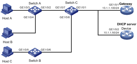

As shown in Figure 1, hosts are connected to Switch C through Switch A and Switch B, which are called Ethernet access nodes (EANs). The MFF-enabled EANs forward packets from hosts to the gateway for further forwarding. The hosts are isolated at Layer 2, but they can communicate at Layer 3.
An MFF-enabled device and a host cannot ping each other.
Figure 1 Network diagram for MFF

Auto-mode MFF configuration example in a tree network
Network requirements
As shown in Figure 2, all the devices are in VLAN 100. Hosts A, B, and C obtain IP addresses from the DHCP server.
Configure MFF to isolate the hosts at Layer 2 and allow them to communicate with each other through Gateway at Layer 3.
Figure 2 Network diagram
Configuration procedure
1.     Configure the IP address of GigabitEthernet 1/0/1 on Gateway.
<Gateway> system-view
[Gateway] interface gigabitethernet 1/0/1
[Gateway-GigabitEthernet1/0/1] ip address 10.1.1.100 24
2.     Configure the DHCP server:
# Enable DHCP and configure DHCP address pool 1.
<Device> system-view
[Device] dhcp enable
[Device] dhcp server ip-pool 1
[Device-dhcp-pool-1] network 10.1.1.0 mask 255.255.255.0
# Add the gateway's IP address to DHCP address pool 1.
[Device-dhcp-pool-1] gateway-list 10.1.1.100
[Device-dhcp-pool-1] quit
# Configure the IP address of GigabitEthernet 1/0/2.
[Device] interface gigabitethernet 1/0/2
[Device-GigabitEthernet1/0/2] ip address 10.1.1.50 24
3.     Configure Switch A:
# Enable DHCP snooping.
<SwitchA> system-view
[SwitchA] dhcp snooping enable
# Enable MFF in automatic mode on VLAN 100.
[SwitchA] vlan 100
[SwitchA-vlan100] mac-forced-forwarding auto
[SwitchA-vlan100] quit
# Configure IP address 10.1.1.50 for the DHCP server.
[SwitchA-vlan100] mac-forced-forwarding server 10.1.1.50
# Configure GigabitEthernet 1/0/2 as a network port.
[SwitchA] interface gigabitethernet 1/0/2
[SwitchA-GigabitEthernet1/0/2] mac-forced-forwarding network-port
# Configure GigabitEthernet 1/0/2 as a DHCP snooping trusted port.
[SwitchA-GigabitEthernet1/0/2] dhcp snooping trust

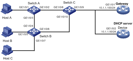

Auto-mode MFF configuration example in a ring network
As shown in Figure 3, all the devices are in VLAN 100, and the switches form a ring. Hosts A, B, and C obtain IP addresses from the DHCP server.
Figure 3 Network diagram
# Add gateway's IP address to DHCP address pool 1.
# Enable STP globally to make sure STP is enabled on interfaces.
[SwitchA] stp global enable
[SwitchA] vlan 100

[SwitchA-GigabitEthernet1/0/3] dhcp snooping trust
4.     Configure Switch B:
<SwitchB> system-view
[SwitchB] dhcp-snooping
[SwitchB] stp global enable
[SwitchB] vlan 100
[SwitchB-vlan100] mac-forced-forwarding auto
[SwitchB-vlan100] quit
[SwitchB-vlan100] mac-forced-forwarding server 10.1.1.50
# Configure GigabitEthernet 1/0/4 as a network port.
[SwitchB] interface gigabitethernet 1/0/4
[SwitchB-GigabitEthernet1/0/4] mac-forced-forwarding network-port
# Configure GigabitEthernet 1/0/4 as a DHCP snooping trusted port.
[SwitchB-GigabitEthernet1/0/4] dhcp snooping trust
[SwitchB-GigabitEthernet1/0/4] quit
# Configure GigabitEthernet 1/0/6 as a network port.
[SwitchB] interface gigabitethernet 1/0/6
[SwitchB-GigabitEthernet1/0/6] mac-forced-forwarding network-port
# Configure GigabitEthernet 1/0/6 as a DHCP snooping trusted port.
[SwitchB-GigabitEthernet1/0/6] dhcp snooping trust
5.     Enable STP on Switch C globally to make sure STP is enabled on interfaces.
<SwitchC> system-view
[SwitchC] stp global enable

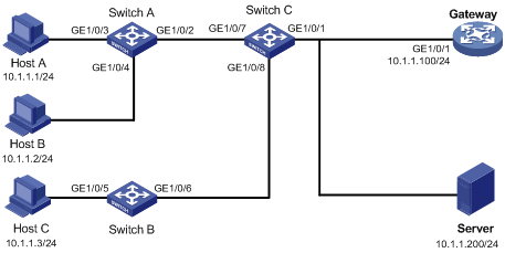

Manual-mode MFF configuration example in a tree network
As shown in Figure 4, all the devices are in VLAN 100. Hosts A, B, and C are assigned IP addresses manually.
Figure 4 Network diagram
1.     Configure IP addresses of the hosts as shown in Figure 4.
2.     Configure the IP address of GigabitEthernet 1/0/1 on Gateway.
# Configure manual-mode MFF on VLAN 100.
[SwitchA] vlan 100
[SwitchA-vlan100] mac-forced-forwarding default-gateway 10.1.1.100
# Specify the IP address of the server.
[SwitchA-vlan100] mac-forced-forwarding server 10.1.1.200
# Enable ARP snooping on VLAN 100.
[SwitchA-vlan100] arp snooping enable
[SwitchB] vlan 100
[SwitchB-vlan100] mac-forced-forwarding default-gateway 10.1.1.100
[SwitchB-vlan100] mac-forced-forwarding server 10.1.1.200
[SwitchB-vlan100] arp snooping enable

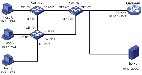

Manual-mode MFF configuration example in a ring network
As shown in Figure 5, all the devices are in VLAN 100, and the switches form a ring. Hosts A, B, and C are assigned IP addresses manually.
Figure 5 Network diagram
1.     Configure IP addresses of the hosts as in shown in Figure 5.
[SwitchA] vlan 100
# Configure GigabitEthernet 1/0/2 and GigabitEthernet 1/0/3 as network ports.
[SwitchA-GigabitEthernet1/0/2] quit
[SwitchA] interface gigabitethernet 1/0/3
[SwitchA-GigabitEthernet1/0/3] mac-forced-forwarding network-port
[SwitchB] vlan 100
# Configure GigabitEthernet 1/0/4 and GigabitEthernet 1/0/6 as network ports.
