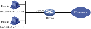

MAC authentication configuration examples
Local MAC authentication configuration example
Network requirements
As shown in Figure 1, the device performs local MAC authentication on GigabitEthernet 1/0/1 to control Internet access of users.
Configure the device to meet the following requirements:
·     Detect whether a user has gone offline every 180 seconds.
·     Deny a user for 180 seconds if the user fails MAC authentication.
·     Authenticate all users in ISP domain bbb.
·     Use the MAC address of each user as the username and password for authentication. A MAC address is in the hexadecimal notation with hyphens, and letters are in lower case.
Figure 1 Network diagram
Configuration procedure
# Add a network access local user. In this example, configure both the username and password as Host A's MAC address 00-e0-fc-12-34-56.
<Device> system-view
[Device] local-user 00-e0-fc-12-34-56 class network
[Device-luser-network-00-e0-fc-12-34-56] password simple 00-e0-fc-12-34-56
# Specify the LAN access service for the user.
[Device-luser-network-00-e0-fc-12-34-56] service-type lan-access
[Device-luser-network-00-e0-fc-12-34-56] quit
# Configure ISP domain bbb to perform local authentication for LAN users.
[Device] domain bbb
[Device-isp-bbb] authentication lan-access local
[Device-isp-bbb] quit
# Enable MAC authentication on GigabitEthernet 1/0/1.
[Device-GigabitEthernet1/0/1] mac-authentication
# Specify the MAC authentication domain as the ISP domain bbb.
[Device] mac-authentication domain bbb
# Configure MAC authentication timers.
[Device] mac-authentication timer offline-detect 180
[Device] mac-authentication timer quiet 180
# Configure MAC authentication to use MAC-based accounts. Each MAC address is in the hexadecimal notation with hyphens, and letters are in lower case.
[Device] mac-authentication user-name-format mac-address with-hyphen lowercase
# Enable MAC authentication globally.
# Display MAC authentication settings and statistics to verify your configuration.
[Device] display mac-authentication
Global MAC authentication parameters:
   MAC authentication     : Enabled
   User name format       : MAC address in lowercase(xx-xx-xx-xx-xx-xx)
           Username       : mac
           Password       : Not configured
   Offline detect period  : 180 s
   Quiet period           : 180 s
   Server timeout         : 100 s
   Authentication domain  : bbb
 Max MAC-auth users       : 4294967295 per slot
 Online MAC-auth users    : 1
 Silent MAC users:
          MAC address       VLAN ID  From port               Port index
          00e0-fc11-1111    8        GigabitEthernet1/0/1    1
 GigabitEthernet1/0/1 is link-up
   Carry User-IP              : Disabled
   Authentication domain      : Not configured
   Auth-delay timer           : Disabled
   Re-auth server-unreachable : Logoff
   Guest VLAN                 : Not configured
   Guest VLAN auth-period     : 30 s
   Critical VLAN              : Not configured
   Critical voice VLAN        : Disabled
   Host mode                  : Single VLAN
   Offline detection          : Enabled
   Authentication order       : Default
   Max online users           : 4294967295
   Authentication attempts    : successful 1, failed 0
   Current online users       : 1
          MAC address       Auth state
          00e0-fc12-3456    Authenticated
The output shows that Host A has passed MAC authentication and has come online. Host B failed MAC authentication and its MAC address is marked as a silent MAC address.

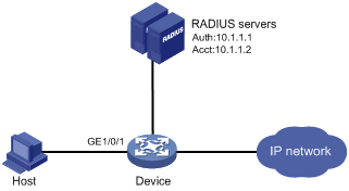

RADIUS-based MAC authentication configuration example
As shown in Figure 2, the device uses RADIUS servers to perform authentication, authorization, and accounting for users.
To control user access to the Internet by MAC authentication, perform the following tasks:
·     Enable MAC authentication globally and on GigabitEthernet 1/0/1.
·     Configure the device to detect whether a user has gone offline every 180 seconds.
·     Configure the device to deny a user for 180 seconds if the user fails MAC authentication.
·     Configure all users to belong to the ISP domain bbb.
·     Use a shared user account for all users, with the username aaa and password 123456.
Figure 2 Network diagram
1.     Make sure the RADIUS server and the access device can reach each other. (Details not shown.)
2.     Configure the RADIUS servers:
# Create a shared account for MAC authentication users. (Details not shown.)
# Set the username aaa and password 123456 for the account. (Details not shown.)
3.     Configure RADIUS-based MAC authentication on the device:
# Configure a RADIUS scheme.
[Device] radius scheme 2000
[Device-radius-2000] primary authentication 10.1.1.1 1812
[Device-radius-2000] primary accounting 10.1.1.2 1813
[Device-radius-2000] key authentication simple abc
[Device-radius-2000] key accounting simple abc
[Device-radius-2000] user-name-format without-domain
[Device-radius-2000] quit
# Apply the RADIUS scheme to ISP domain bbb for authentication, authorization, and accounting.
[Device] domain bbb
[Device-isp-bbb] authentication default radius-scheme 2000
[Device-isp-bbb] authorization default radius-scheme 2000
[Device-isp-bbb] accounting default radius-scheme 2000
# Set MAC authentication timers.
# Specify username aaa and password 123456 in plain text for the account shared by MAC authentication users.
[Device] mac-authentication user-name-format fixed account aaa password simple 123456
# Verify the MAC authentication configuration.
   User name format       : Fixed account
           Username       : aaa
           Password       : ******
 Silent MAC users:
   Current online users       : 0

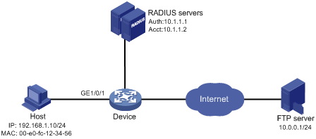

ACL assignment configuration example
As shown in Figure 3, configure the device to meet the following requirements:
·     Use RADIUS servers to perform authentication, authorization, and accounting for users.
·     Perform MAC authentication on GigabitEthernet 1/0/1 to control Internet access.
·     Use MAC-based user accounts for MAC authentication users. Each MAC address is in the hexadecimal notation with hyphens, and letters are in lower case.
·     Use an ACL to deny authenticated users to access the FTP server at 10.0.0.1.
Figure 3 Network diagram
Make sure the RADIUS servers and the access device can reach each other.
1.     Configure ACL 3000 to deny packets destined for 10.0.0.1.
[Device] acl number 3000
[Device-acl-adv-3000] rule 0 deny ip destination 10.0.0.1 0
[Device-acl-adv-3000] quit
2.     Configure RADIUS-based MAC authentication on the device:
# Apply the RADIUS scheme to an ISP domain for authentication, authorization, and accounting.
[Device] domain bbb
# Specify the ISP domain for MAC authentication.
# Configure the device to use MAC-based user accounts. Each MAC address is in the hexadecimal notation with hyphens, and letters are in lower case.
3.     Configure the RADIUS servers:
# Add a user account with 00-e0-fc-12-34-56 as both the username and password on each RADIUS server. (Details not shown.)
# Specify ACL 3000 as the authorization ACL for the user account. (Details not shown.)
           Username       : mac
   Offline detect period  : 300 s
   Quiet period           : 60 s
 Silent MAC users:
# Verify that you cannot ping the FTP server from the host.
C:\>ping 10.0.0.1
Pinging 10.0.0.1 with 32 bytes of data:
Request timed out.
Request timed out.
Request timed out.
Request timed out.
Ping statistics for 10.0.0.1:
   Packets: Sent = 4, Received = 0, Lost = 4 (100% loss),
The output shows that ACL 3000 has been assigned to GigabitEthernet 1/0/1 to deny access to the FTP server.
