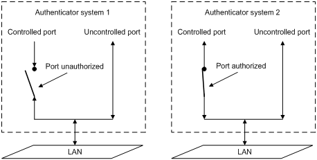

Controlled/uncontrolled port and port authorization status
802.1X defines two logical ports for the network access port: controlled port and uncontrolled port. Any packet arriving at the network access port is visible to both logical ports.
·     Uncontrolled port—Is always open to receive and transmit authentication packets.
·     Controlled port—Filters packets depending on the port state.
¡     Authorized stateThe controlled port is in authorized state when the client has passed authentication. The port allows traffic to pass through.
¡     Unauthorized state—The port is in unauthorized state when the client has failed authentication. The port controls traffic by using one of the following methods:
-     Performs bidirectional traffic control to deny traffic to and from the client.
-     Performs unidirectional traffic control to deny traffic from the client. The H3C devices support only unidirectional traffic control.
Figure 2 Authorization state of a controlled port

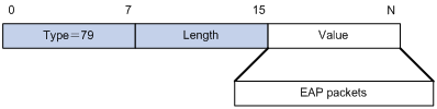

EAP-Message
RADIUS encapsulates EAP packets in the EAP-Message attribute, as shown in Figure 5. The Type field takes 79, and the Value field can be up to 253 bytes. If an EAP packet is longer than 253 bytes, RADIUS encapsulates it in multiple EAP-Message attributes.
Figure 5 EAP-Message attribute format

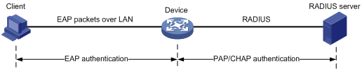

·     EAP termination mode.
As shown in Figure 8, the access device performs the following operations in EAP termination mode:
a.     Terminates the EAP packets received from the client.
b.     Encapsulates the client authentication information in standard RADIUS packets.
c.     Uses PAP or CHAP to authenticate to the RADIUS server.
Figure 8 EAP termination

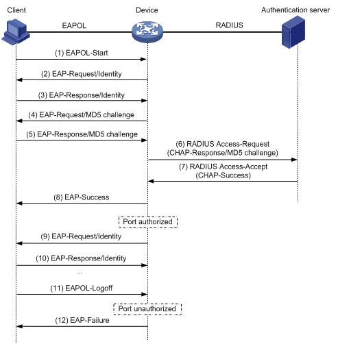

EAP relay
Figure 9 shows the basic 802.1X authentication procedure in EAP relay mode, assuming that EAP-MD5 is used.
Figure 9 802.1X authentication procedure in EAP relay mode
The following steps describe the 802.1X authentication procedure:
1.     When a user launches the 802.1X client and enters a registered username and password, the 802.1X client sends an EAPOL-Start packet to the access device.
2.     The access device responds with an Identity EAP-Request packet to ask for the client username.
3.     In response to the Identity EAP-Request packet, the client sends the username in an Identity EAP-Response packet to the access device.
4.     The access device relays the Identity EAP-Response packet in a RADIUS Access-Request packet to the authentication server.
5.     The authentication server uses the identity information in the RADIUS Access-Request to search its user database. If a matching entry is found, the server uses a randomly generated challenge (EAP-Request/MD5 challenge) to encrypt the password in the entry. Then, the server sends the challenge in a RADIUS Access-Challenge packet to the access device.
6.     The access device transmits the EAP-Request/MD5 Challenge packet to the client.
7.     The client uses the received challenge to encrypt the password, and sends the encrypted password in an EAP-Response/MD5 Challenge packet to the access device.
8.     The access device relays the EAP-Response/MD5 Challenge packet in a RADIUS Access-Request packet to the authentication server.
9.     The authentication server compares the received encrypted password with the encrypted password it generated at step 5. If the two passwords are identical, the server considers the client valid and sends a RADIUS Access-Accept packet to the access device.
10.     Upon receiving the RADIUS Access-Accept packet, the access device performs the following operations:
a.     Sends an EAP-Success packet to the client.
b.     Sets the controlled port in authorized state.
The client can access the network.
11.     After the client comes online, the access device periodically sends handshake requests to check whether the client is still online. By default, if two consecutive handshake attempts fail, the device logs off the client.
12.     Upon receiving a handshake request, the client returns a response. If the client fails to return a response after a number of consecutive handshake attempts (two by default), the access device logs off the client. This handshake mechanism enables timely release of the network resources used by 802.1X users who have abnormally gone offline.
13.     The client can also send an EAPOL-Logoff packet to ask the access device for a logoff.
14.     In response to the EAPOL-Logoff packet, the access device changes the status of the controlled port from authorized to unauthorized. Then, the access device sends an EAP-Failure packet to the client.

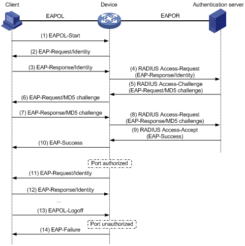

EAP termination
Figure 10 shows the basic 802.1X authentication procedure in EAP termination mode, assuming that CHAP authentication is used.
Figure 10 802.1X authentication procedure in EAP termination mode
In EAP termination mode, the access device rather than the authentication server generates an MD5 challenge for password encryption. The access device then sends the MD5 challenge together with the username and encrypted password in a standard RADIUS packet to the RADIUS server.

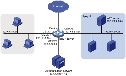

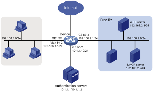

EAD assistant
Endpoint Admission Defense (EAD) is an H3C integrated endpoint access control solution to improve the threat defensive capability of a network. The solution enables the security client, security policy server, access device, and third-party server to operate together. If a terminal device seeks to access an EAD network, it must have an EAD client, which performs 802.1X authentication.
The EAD assistant feature enables the access device to redirect a user who is seeking to access the network to download and install an EAD client. This feature eliminates the administrative task to deploy EAD clients.
EAD assistant is implemented by the following functionality:
·     Free IP.
A free IP is a freely accessible network segment, which has a limited set of network resources such as software and DHCP servers. To ensure security strategy compliance, an unauthenticated user can access only this segment to perform operations. For example, the user can download EAD client from a software server or obtain a dynamic IP address from a DHCP server.
·     Redirect URL.
If an unauthenticated 802.1X user is using a Web browser to access the network, the EAD assistant feature redirects the user to a specific URL. For example, you can use this feature to redirect the user to the EAD client software download page.
The EAD assistant feature creates an ACL-based EAD rule automatically to open access to the redirect URL for each redirected user.
EAD rules are implemented by using ACL resources. When the EAD rule timer expires or the user passes authentication, the rule is removed. If users fail to download EAD client or fail to pass authentication before the timer expires, they must reconnect to the network to access the free IP.

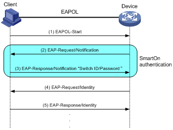

SmartOn
The SmartOn feature was developed to support the NEC 802.1X client.
As shown in Figure 11, the access device performs SmartOn authentication before 802.1X authentication. The following shows the authentication process:
1.     When a SmartOn-enabled port receives an EAPOL-Start packet from an 802.1X client, it sends a unicast EAP-Request/Notification packet to the client for SmartOn authentication.
2.     Upon receiving an EAP-Response/Notification from the client, the device compares the switch ID and password in the packet with the switch ID and password configured on the device.
¡     If they are the same, 802.1X authentication can continue.
¡     If they do not match, SmartOn authentication fails. The access device stops 802.1X authentication for the client.
Figure 11 802.1X authentication process with the SmartOn feature
If the user attempts to use another 802.1X client for authentication, it will fail SmartOn authentication. The access device stops 802.1X authentication for the user.
After you install the SmartOn client software, add two values QX_ID and QX_PASSWORD to the Windows registry key [HKEY_LOCAL_MACHINE\SOFTWARE\Soliton Systems K.K.\SmartOn Client\Clients\1XGate]. Specify the switch ID and password for the QX_ID and QX_PASSWORD, respectively. The switch ID and password must be the same as the switch ID and password configured on the device.

Configuring the EAD assistant feature
When you configure the EAD assistant feature, follow these restrictions and guidelines:
·     You must disable MAC authentication and port security globally before you enable the EAD assistant feature.
·     To make the EAD assistant feature take effect on an 802.1X-enabled port, you must set the port authorization mode to auto.
·     When global MAC authentication or port security is enabled, the free IP does not take effect.
·     If you use free IP, guest VLAN, and Auth-Fail VLAN features together, make sure the free IP segments are in both guest VLAN and Auth-Fail VLAN.
·     To allow a user to obtain a dynamic IP address before it passes 802.1X authentication, make sure the DHCP server is on the free IP segment.
·     The server that provides the redirect URL must be on the free IP accessible to unauthenticated users.
·     To avoid using up ACL resources when a large number of EAD users exist, you can shorten the EAD rule timer.
To configure the EAD assistant feature:
Step
Remarks
N/A
2.     Enable EAD assistant.
dot1x ead-assistant enable
By default, this feature is disabled.
3.     Configure a free IP.
dot1x ead-assistant free-ip ip-address { mask-length | mask-address }
By default, no free IP is configured.
4.     (Optional.) Configure the redirect URL.
dot1x ead-assistant url url-string
By default, no redirect URL is configured.
Configure the redirect URL if users will use Web browsers to access the network.
5.     (Optional.) Set the EAD rule timer.
dot1x timer ead-timeout ead-timeout-value
The default setting is 30 minutes.
Configuring 802.1X SmartOn
The SmartOn feature is mutually exclusive with the 802.1X online user handshake feature.
When the device sends a unicast EAP-Request/Notification packet to the client, it starts the SmartOn client timeout timer (set by using the dot1x smarton timer supp-timeout command).
·     If the device does not receive any EAP-Response/Notification packets from the client within the timeout timer, it retransmits the EAP-Request/Notification packet to the client. After the device has made the maximum retransmission attempts but received no response, it stops the 802.1X authentication process for the client.
·     If the device receives an EAP-Response/Notification packet within the timer or before the maximum retransmission attempts have been made, it starts the SmartOn authentication. If the SmartOn switch ID and the MD5 digest of the SmartOn password in the packet match those on the device, 802.1X authentication continues for the client. Otherwise, the device denies the client's 802.1X authentication request.
To configure 802.1X SmartOn:
Step
Remarks
N/A
2.     Enter Layer 2 Ethernet interface view.
N/A
3.     Enable the SmartOn feature on the port.
dot1x smarton
4.     Return to system view.
N/A
5.     Configure the SmartOn switch ID.
dot1x smarton switchid switch-string
By default, no SmartOn switch ID is configured.
6.     Configure the SmartOn password.
dot1x smarton password { cipher cipher-string | simple plain-string }
By default, no SmartOn password is configured.
7.     (Optional.) Set the SmartOn client timeout timer.
The default timer is 30 seconds.
8.     (Optional.) Configure the maximum attempts for retransmitting an EAP-Request/Notification packet to a client.
dot1x smarton retry retries
By default, the device allows a maximum of 3 attempts for retransmitting an EAP-Request/Notification packet to a client.

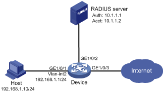

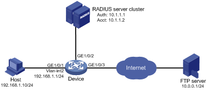

802.1X authentication configuration examples
Basic 802.1X authentication configuration example
Network requirements
As shown in Figure 12, the access device performs 802.1X authentication for users who connect to port GigabitEthernet 1/0/1. Implement MAC-based access control on the port, so the logoff of one user does not affect other online 802.1X users.
Use RADIUS servers to perform authentication, authorization, and accounting for the 802.1X users. If RADIUS authentication fails, perform local authentication on the access device.
Configure the host at 10.1.1.1/24 as the primary authentication and accounting servers, and the host at 10.1.1.2/24 as the secondary authentication and accounting servers. Assign all users to the ISP domain bbb.
Configure the shared key as name for packets between the access device and the authentication server. Configure the shared key as money for packets between the access device and the accounting server.
Figure 12 Network diagram
Configuration procedure
1.     Configure the 802.1X client. If H3C iNode is used, do not select the Carry version info option in the client configuration. (Details not shown.)
2.     Configure the RADIUS servers and add user accounts for the 802.1X users. (Details not shown.)
For information about the RADIUS commands used on the access device in this example, see Security Command Reference.
3.     Assign an IP address for each interface on the access device. (Details not shown.)
4.     Configure user accounts for the 802.1X users on the access device:
# Add a local network access user with the username localuser, and password localpass in plaintext. (Make sure the username and password are the same as those configured on the RADIUS servers.)
<Device> system-view
[Device] local-user localuser class network
[Device-luser-network-localuser] password simple localpass

802.1X with ACL assignment configuration example
As shown in Figure 14, the host that connects to GigabitEthernet 1/0/1 must pass 802.1X authentication to access the Internet.
Perform 802.1X authentication on GigabitEthernet 1/0/1. Use the RADIUS server at 10.1.1.1 as the authentication and authorization server, and the RADIUS server at 10.1.1.2 as the accounting server.
Configure ACL assignment on GigabitEthernet 1/0/1 to deny access of 802.1X users to the FTP server from 8:00 to 18:00 on weekdays.
Figure 14 Network diagram
1.     Configure the 802.1X client. Make sure the client is able to update its IP address after the access port is assigned to the 802.1X guest VLAN or an authorization VLAN. (Details not shown.)
2.     Configure the RADIUS servers to provide authentication, authorization, and accounting services. Add user accounts and specify the ACL (ACL 3000 in this example) for the users. (Details not shown.)
3.     Assign an IP address to each interface, as shown in Figure 14. (Details not shown.)

802.1X with EAD assistant configuration example (with DHCP relay agent)
As shown in Figure 15:
·     The intranet 192.168.1.0/24 is attached to GigabitEthernet 1/0/1 of the access device.
·     The hosts use DHCP to obtain IP addresses.
·     A DHCP server and a Web server are deployed on the 192.168.2.0/24 subnet for users to obtain IP addresses and download client software.
Deploy an EAD solution for the intranet to meet the following requirements:
·     Allow unauthenticated users and users who have failed 802.1X authentication to access 192.168.2.0/24. The users can obtain IP addresses and download software.
·     If these users use a Web browser to access a network other than 192.168.2.0/24, redirect them to the Web server for 802.1X client downloading.
·     Allow authenticated 802.1X users to access the network.
Figure 15 Network diagram
1.     Make sure the DHCP server, the Web server, and the authentication servers have been configured correctly. (Details not shown.)
2.     Configure an IP address for each interface. (Details not shown.)
3.     Configure DHCP relay:
# Enable DHCP.
[Device] dhcp enable
# Enable the DHCP relay agent on VLAN-interface 2.
[Device] interface vlan-interface 2
[Device-Vlan-interface2] dhcp select relay
# Specify the DHCP server 192.168.2.2 on the relay agent interface VLAN-interface 2.
[Device-Vlan-interface2] dhcp relay server-address 192.168.2.2
[Device-Vlan-interface2] quit
4.     Configure a RADIUS scheme:
# Create RADIUS scheme 2000 and enter RADIUS scheme view.
[Device] radius scheme 2000
# Specify the server at 10.1.1.1 as the primary authentication server, and set the authentication port to 1812.
[Device-radius-2000] primary authentication 10.1.1.1 1812
# Specify the server at 10.1.1.2 as the primary accounting server, and set the accounting port to 1813.
[Device-radius-2000] primary accounting 10.1.1.2 1813
# Set the shared key to abc in plain text for secure communication between the authentication server and the device.
[Device-radius-2000] key authentication simple abc
# Set the shared key to abc in plain text for secure communication between the accounting server and the device.
[Device-radius-2000] key accounting simple abc
# Exclude the ISP domain names from the usernames sent to the RADIUS server.
[Device-radius-2000] user-name-format without-domain
[Device-radius-2000] quit
5.     Configure an ISP domain:
# Create ISP domain bbb and enter ISP domain view.
[Device] domain bbb
# Apply RADIUS scheme 2000 to the ISP domain for authentication, authorization, and accounting.
[Device-isp-bbb] authentication lan-access radius-scheme 2000
[Device-isp-bbb] authorization lan-access radius-scheme 2000
[Device-isp-bbb] accounting lan-access radius-scheme 2000
[Device-isp-bbb] quit
6.     Configure 802.1X:
# Configure the free IP.
[Device] dot1x ead-assistant free-ip 192.168.2.0 24
# Configure the redirect URL for client software download.
[Device] dot1x ead-assistant url http://192.168.2.3
# Enable the EAD assistant feature.
[Device] dot1x ead-assistant enable
# Enable 802.1X on GigabitEthernet 1/0/1.
[Device-GigabitEthernet1/0/1] dot1x
# Enable 802.1X globally.
[Device] dot1x
# Verify the 802.1X configuration.
[Device] display dot1x
# Verify that you can ping an IP address on the free IP subnet from a host.
C:\>ping 192.168.2.3
Pinging 192.168.2.3 with 32 bytes of data:
Reply from 192.168.2.3: bytes=32 time<1ms TTL=128
Ping statistics for 192.168.2.3:
    Minimum = 0ms, Maximum = 0ms, Average = 0ms
The output shows that you can access the free IP subnet before passing 802.1X authentication.
# Verify that you are redirected to the Web server when you enter in your Web browser an IP address not on the free IP. (Details not shown.)
802.1X with EAD assistant configuration example (with DHCP server)
As shown in Figure 16:
·     A Web server is deployed on the 192.168.2.0/24 subnet for users to download client software.
·     Allow unauthenticated users and users who have failed 802.1X authentication to access 192.168.2.0/24. The users can download software.
Figure 16 Network diagram
1.     Make sure the Web server and the authentication servers have been configured correctly. (Details not shown.)

# Enable DHCP.
# Enable the DHCP server on VLAN-interface 2.
[Device-Vlan-interface2] dhcp select server
# Create DHCP address pool 0.
[Device] dhcp server ip-pool 0
# Specify subnet 192.168.1.0/24 in DHCP address pool 0.
[Device-dhcp-pool-0] network 192.168.1.0 mask 255.255.255.0
# Specify the gateway address 192.168.1.1 in DHCP address pool 0.
[Device-dhcp-pool-0] gateway-list 192.168.1.1
[Device-dhcp-pool-0] quit
[Device] domain bbb
[Device] dot1x
802.1X SmartOn configuration example
As shown in Figure 17, configure the SmartOn feature on GigabitEthernet 1/0/1 so that the host must pass SmartOn authentication before 802.1X authentication.
Set the SmartOn password to 1234 in plain text and switch ID to XYZ. Set the SmartOn client timeout timer to 40 seconds.
Figure 17 Network diagram
1.     Configure a RADIUS scheme:
2.     Configure an ISP domain:
[Device] domain bbb
3.     Configure 802.1X and SmartOn:
# Enable SmartOn on GigabitEthernet 1/0/1.
[Device-GigabitEthernet1/0/1] dot1x smarton
# Set the SmartOn password to 1234 in plain text and the switch ID to XYZ.
[Device] dot1x smarton password simple 1234
[Device] dot1x smarton switchid XYZ
# Set the SmartOn client timeout timer to 40 seconds.
[Device] smarton timer supp-timeout 40
[Device] dot1x
