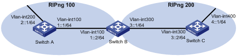

Network requirements
As shown in Figure 2, Switch B communicates with Switch A through RIPng 100 and with Switch C through RIPng 200.
Configure route redistribution on Switch B, so the two RIPng processes can redistribute routes from each other.
Figure 2 Network diagram
Configuration procedure

3.     Configure RIPng route redistribution:
# Configure route redistribution between the two RIPng processes on Switch B.
[SwitchB] ripng 100
[SwitchB-ripng-100] import-route ripng 200
[SwitchB-ripng-100] quit
[SwitchB] ripng 200
[SwitchB-ripng-200] import-route ripng 100
[SwitchB-ripng-200] quit
