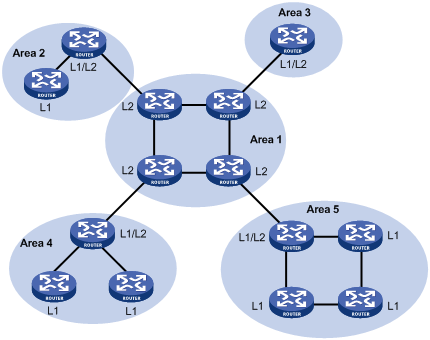

IS-IS area
IS-IS has a 2-level hierarchy to support large-scale networks. A large-scale routing domain is divided into multiple areas. Typically, a Level-1 router is deployed within an area. A Level-2 router is deployed between areas. A Level-1-2 router is deployed between Level-1 and Level-2 routers.
Level-1 and Level-2
·     Level-1 router—A Level-1 router establishes neighbor relationships with Level-1 and Level-1-2 routers in the same area. It maintains an LSDB comprising intra-area routing information. A Level-1 router forwards packets destined for external areas to the nearest Level-1-2 router. Level-1 routers in different areas cannot establish neighbor relationships.
·     Level-2 router—A Level-2 router establishes neighbor relationships with Level-2 and Level-1-2 routers in the same area or in different areas. It maintains a Level-2 LSDB containing inter-area routing information. All the Level-2 and Level-1-2 routers must be contiguous to form the backbone of the IS-IS routing domain. Level-2 routers can establish neighbor relationships even if they are in different areas.
·     Level-1-2 router—A router with both Level-1 and Level-2 router functions is a Level-1-2 router. It can establish Level-1 neighbor relationships with Level-1 and Level-1-2 routers in the same area. It can establish Level-2 neighbor relationships with Level-2 and Level-1-2 routers in different areas. A Level-1 router can reach other areas only through a Level-1-2 router. The Level-1-2 router maintains two LSDBs, a Level-1 LSDB for intra-area routing and a Level-2 LSDB for inter-area routing.
Figure 2 shows one IS-IS network topology. Area 1 is the backbone that comprises a set of Level-2 routers. The other four areas are non-backbone areas connected to the backbone through Level-1-2 routers.
Figure 2 IS-IS topology 1
Figure 3 shows another IS-IS topology. The Level-1-2 routers connect to the Level-1 and Level-2 routers, and form the IS-IS backbone together with the Level-2 routers. No area is defined as the backbone in this topology. The backbone comprises all contiguous Level-2 and Level-1-2 routers in different areas. The IS-IS backbone does not need to be a specific area.
Figure 3 IS-IS topology 2
Both the Level-1 and Level-2 routers use the SPF algorithm to generate the shortest path tree.

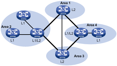

Route leaking
Level-2 and Level-1-2 routers form a Level-2 area. An IS-IS routing domain comprises only one Level-2 area and multiple Level-1 areas. A Level-1 area must connect to the Level-2 area rather than another Level-1 area.
Level-1-2 routers send the routing information of Level-1 areas to the Level-2 area. Level-2 routers know the routing information of the entire IS-IS routing domain. By default, a Level-2 router does not advertise the routing information of other areas to a Level-1 area. A Level-1 router simply sends packets destined for other areas to the nearest Level-1-2 router. The path passing through the Level-1-2 router might not be the best. To solve this problem, IS-IS provides the route leaking feature.
Route leaking enables a Level-1-2 router to advertise the routes of other areas to the connected Level-1 area so that the Level-1 routers can select the optimal routes.

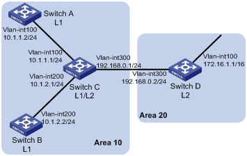

IS-IS configuration examples
Basic IS-IS configuration example
Network requirements
As shown in Figure 9, Switch A, Switch B, Switch C, and Switch D reside in an IS-IS AS.
Switch A and B are Level-1 switches, Switch D is a Level-2 switch, and Switch C is a Level-1-2 switch. Switch A, Switch B, and Switch C are in Area 10, and Switch D is in Area 20.
Figure 9 Network diagram
Configuration procedure
1.     Configure IP addresses for interfaces. (Details not shown.)
2.     Configure IS-IS:
# Configure Switch A.
<SwitchA> system-view
[SwitchA] isis 1
[SwitchA-isis-1] is-level level-1
[SwitchA-isis-1] network-entity 10.0000.0000.0001.00
[SwitchA-isis-1] quit
[SwitchA-Vlan-interface100] isis enable 1
# Configure Switch B.
<SwitchB> system-view
[SwitchB] isis 1
[SwitchB-isis-1] is-level level-1
[SwitchB-isis-1] network-entity 10.0000.0000.0002.00
[SwitchB-isis-1] quit
[SwitchB] interface vlan-interface 200
[SwitchB-Vlan-interface200] isis enable 1
[SwitchB-Vlan-interface200] quit
# Configure Switch C.
<SwitchC> system-view
[SwitchC] isis 1
[SwitchC-isis-1] network-entity 10.0000.0000.0003.00
[SwitchC-isis-1] quit
[SwitchC] interface vlan-interface 100
[SwitchC-Vlan-interface100] isis enable 1
[SwitchC-Vlan-interface100] quit
[SwitchC] interface vlan-interface 200
[SwitchC-Vlan-interface200] isis enable 1
[SwitchC-Vlan-interface200] quit
[SwitchC] interface vlan-interface 300
[SwitchC-Vlan-interface300] isis enable 1
[SwitchC-Vlan-interface300] quit
# Configure Switch D.
<SwitchD> system-view
[SwitchD] isis 1
[SwitchD-isis-1] is-level level-2
[SwitchD-isis-1] network-entity 20.0000.0000.0004.00
[SwitchD-isis-1] quit
[SwitchD] interface vlan-interface 100
[SwitchD-Vlan-interface100] isis enable 1
[SwitchD-Vlan-interface100] quit
[SwitchD] interface vlan-interface 300
[SwitchD-Vlan-interface300] isis enable 1
[SwitchD-Vlan-interface300] quit
# Display the IS-IS LSDB on each switch to verify the LSPs.
[SwitchA] display isis lsdb
                       Database information for IS-IS(1)
                          Level-1 Link State Database
LSPID                 Seq Num      Checksum   Holdtime   Length  ATT/P/OL
0000.0000.0001.00-00* 0x00000004   0xdf5e     1096       68      0/0/0
0000.0000.0002.00-00  0x00000004   0xee4d     1102       68      0/0/0
0000.0000.0002.01-00  0x00000001   0xdaaf     1102       55      0/0/0
0000.0000.0003.00-00  0x00000009   0xcaa3     1161       111     1/0/0
0000.0000.0003.01-00  0x00000001   0xadda     1112       55      0/0/0
    *-Self LSP, +-Self LSP(Extended), ATT-Attached, P-Partition, OL-Overload
[SwitchB] display isis lsdb
0000.0000.0001.00-00  0x00000006   0xdb60     988         68      0/0/0
0000.0000.0002.00-00* 0x00000008   0xe651     1189        68      0/0/0
0000.0000.0002.01-00* 0x00000005   0xd2b3     1188        55      0/0/0
0000.0000.0003.00-00  0x00000014   0x194a     1190        111     1/0/0
0000.0000.0003.01-00  0x00000002   0xabdb     995         55      0/0/0
[SwitchC] display isis lsdb
0000.0000.0001.00-00  0x00000006   0xdb60     847         68      0/0/0
0000.0000.0002.00-00  0x00000008   0xe651     1053        68      0/0/0
0000.0000.0002.01-00  0x00000005   0xd2b3     1052        55      0/0/0
0000.0000.0003.00-00* 0x00000014   0x194a     1051        111     1/0/0
0000.0000.0003.01-00* 0x00000002   0xabdb     854         55      0/0/0
                          Level-2 Link State Database
0000.0000.0003.00-00* 0x00000012   0xc93c     842         100     0/0/0
0000.0000.0004.00-00  0x00000026   0x331      1173        84      0/0/0
0000.0000.0004.01-00  0x00000001   0xee95     668         55      0/0/0
[SwitchD] display isis lsdb
0000.0000.0003.00-00  0x00000013   0xc73d        1003          100     0/0/0
0000.0000.0004.00-00* 0x0000003c   0xd647        1194          84      0/0/0
0000.0000.0004.01-00* 0x00000002   0xec96        1007          55      0/0/0
# Display the IS-IS routing information on each switch.
[SwitchA] display isis route
                         Route information for IS-IS(1)
                         Level-1 IPv4 Forwarding Table
 IPv4 Destination     IntCost    ExtCost ExitInterface   NextHop         Flags
 10.1.1.0/24          10         NULL    Vlan100         Direct          D/L/-
 10.1.2.0/24          20         NULL    Vlan100         10.1.1.1        R/-/-
 192.168.0.0/24       20         NULL    Vlan100         10.1.1.1        R/-/-
 0.0.0.0/0            10         NULL    Vlan100         10.1.1.1        R/-/-
      Flags: D-Direct, R-Added to Rib, L-Advertised in LSPs, U-Up/Down Bit Set
[SwitchC] display isis route
 192.168.0.0/24       10         NULL    Vlan300         Direct          D/L/-
 10.1.2.0/24          10         NULL    Vlan200         Direct          D/L/-
                         Level-2 IPv4 Forwarding Table
 192.168.0.0/24       10         NULL                                    D/L/-
 10.1.1.0/24          10         NULL                                    D/L/-
 10.1.2.0/24          10         NULL                                    D/L/-
 172.16.0.0/16        20         NULL    Vlan300         192.168.0.2     R/-/-
[SwitchD] display isis route
 10.1.1.0/24          20         NULL    Vlan300         192.168.0.1     R/-/-
 10.1.2.0/24          20         NULL    Vlan300         192.168.0.1     R/-/-
 172.16.0.0/16        10         NULL    Vlan100         Direct          D/L/-

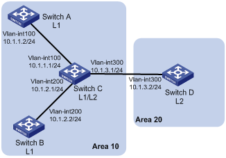

DIS election configuration example
As shown in Figure 10, Switches A, B, C, and D reside in IS-IS area 10 on a broadcast network (Ethernet). Switch A and Switch B are Level-1-2 switches, Switch C is a Level-1 switch, and Switch D is a Level-2 switch.
Change the DIS priority of Switch A to make it elected as the Level-1-2 DIS router.
Figure 10 Network diagram
2.     Enable IS-IS:
[SwitchA] isis 1
[SwitchB] isis 1
[SwitchB-Vlan-interface100] isis enable 1
[SwitchC] isis 1
[SwitchC-isis-1] is-level level-1
[SwitchD] isis 1
[SwitchD-isis-1] network-entity 10.0000.0000.0004.00
# Display information about IS-IS neighbors on Switch A.
[SwitchA] display isis peer
                          Peer information for IS-IS(1)
  System Id: 0000.0000.0002
  Interface: Vlan-interface100       Circuit Id: 0000.0000.0003.01
  State: Up     HoldTime: 21s        Type: L1(L1L2)     PRI: 64
  System Id: 0000.0000.0003
  State: Up     HoldTime: 27s        Type: L1           PRI: 64
  Interface: Vlan-interface100       Circuit Id: 0000.0000.0004.01
  State: Up     HoldTime: 28s        Type: L2(L1L2)     PRI: 64
  System Id: 0000.0000.0004
  State: Up     HoldTime: 30s        Type: L2          PRI: 64
# Display information about IS-IS interfaces on Switch A.
[SwitchA] display isis interface
                       Interface information for IS-IS(1)
  Index     IPv4.State      IPv6.State     CircuitID   MTU   Type   DIS
  00001     Up              Down           1           1497  L1/L2  No/No
# Display information about IS-IS interfaces on Switch C.
[SwitchC] display isis interface
  00001     Up              Down           1           1497  L1/L2  Yes/No
# Display information about IS-IS interfaces on Switch D.
[SwitchD] display isis interface
  00001     Up              Down           1           1497  L1/L2  No/Yes
The output shows that when the default DIS priority is used, Switch C is the DIS for Level-1, and Switch D is the DIS for Level-2. The pseudonodes of Level-1 and Level-2 are 0000.0000.0003.01 and 0000.0000.0004.01.
#Configure the DIS priority of Switch A.
[SwitchA-Vlan-interface100] isis dis-priority 100
# Display IS-IS neighbors on Switch A.
  Interface: Vlan-interface100       Circuit Id: 0000.0000.0001.01
  00001     Up              Down           1           1497  L1/L2  Yes/Yes
The output shows that after the DIS priority configuration, Switch A becomes the DIS for Level-1-2, and the pseudonode is 0000.0000.0001.01.
# Display information about IS-IS neighbors and interfaces on Switch C.
[SwitchC] display isis peer
  State: Up     HoldTime: 25s        Type: L1           PRI: 64
  System Id: 0000.0000.0001
  State: Up     HoldTime: 7s         Type: L1           PRI: 100
# Display information about IS-IS neighbors and interfaces on Switch D.
[SwitchD] display isis peer
  State: Up     HoldTime: 9s         Type: L2           PRI: 100
  State: Up     HoldTime: 28s        Type: L2           PRI: 64

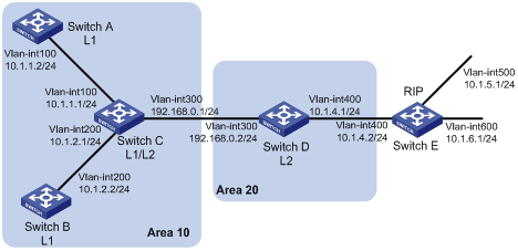

IS-IS route redistribution configuration example
As shown in Figure 11, Switch A, Switch B, Switch C, and Switch D reside in the same AS. They use IS-IS to interconnect. Switch A and Switch B are Level-1 routers, Switch D is a Level-2 router, and Switch C is a Level-1-2 router.
Redistribute RIP routes into IS-IS on Switch D.
Figure 11 Network diagram
2.     Configure basic IS-IS:
[SwitchA] isis 1
[SwitchB] isis 1
[SwitchC] isis 1

3.     Run RIPv2 between Switch D and Switch E, and configure IS-IS to redistribute RIP routes on Switch D:
# Configure RIPv2 on Switch D.
[SwitchD] rip 1
[SwitchD-rip-1] network 10.0.0.0
[SwitchD-rip-1] version 2
[SwitchD-rip-1] undo summary
# Configure RIPv2 on Switch E.
[SwitchE] rip 1
[SwitchE-rip-1] network 10.0.0.0
[SwitchE-rip-1] version 2
[SwitchE-rip-1] undo summary
# Configure IS-IS to redistribute RIP routes on Switch D.
[SwitchD-rip-1] quit
[SwitchD] isis 1
[SwitchD–isis-1] import-route rip level-2
# Display IS-IS routing information on Switch C.
 10.1.1.0/24          10         NULL    VLAN100         Direct          D/L/-
 10.1.2.0/24          10         NULL    VLAN200         Direct          D/L/-
 192.168.0.0/24       10         NULL    VLAN300         Direct          D/L/-
 10.1.4.0/24          10         NULL    VLAN300         192.168.0.2     R/L/-
 10.1.5.0/24          20         NULL    VLAN300         192.168.0.2     R/L/-
 10.1.6.0/24          20         NULL    VLAN300         192.168.0.2     R/L/-
