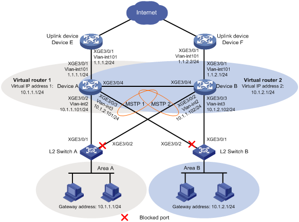

Network requirements
As shown in Figure 1:
·     Two distribution layer devices, Device A and Device B, are deployed at the egress of area A and area B.
·     Device A and Device B belong to VRRP group 1 and VRRP group 2.
·     Device A is the master in VRRP group 1. Device B is the master in VRRP group 2.
·     The default gateway is VRRP group 1 for users in area A and VRRP group 2 for users in area B.
Configure VRRP-Track-BFD collaboration to meet the following requirements:
·     When Device A and Device B are operating correctly, they forward traffic for users in area A and area B, respectively.
·     When one gateway device or the uplink of the device fails, BFD can detect the failure and the other device takes over to implement link switchover.
·     When the downlink of a gateway device fails, L2 Switch A or L2 Switch B forwards user traffic to the gateway through interface Ten-GigabitEthernet 3/0/2. When the fault is cleared, L2 Switch A or L2 Switch B forwards user traffic to the gateway through interface Ten-GigabitEthernet 3/0/1.

Requirements analysis
To meet the network requirements, you must perform the following tasks:
·     For Device A to become the master in VRRP group 1, configure a higher priority (110) for Device A in VRRP group 1 (Device B uses the default priority 100). For Device B to become the master in VRRP group 2, configure a higher priority (110) for Device B in VRRP group 2 (Device A uses the default priority 100).
·     To enable the failed master to forward traffic when it recovers, configure both VRRP groups to operate in preemptive mode.
·     To enable Device A to communicate with Device B by using VRRP advertisement packets and BFD packets of different VLANs, configure the ports connecting Device A and Device B to allow packets from VLAN 2 and VLAN 3 to pass through.
·     To eliminate Layer 2 loops, configure MSTP. Map VLAN 2 to MSTI 1 and map VLAN 3 to MSTI 2. The configuration traffic in MSTI 1 and MSTI 2 is forwarded through Ten-GigabitEthernet 3/0/1 of L2 Switch A and Ten-GigabitEthernet 3/0/1 of L2 Switch B, respectively.
·     To prevent MSTP from blocking uplink interface Ten-GigabitEthernet 3/0/1 of Device A and Device B, disable the spanning tree feature on the interfaces.

Configuring VRRP groups
1.     Configure Device A:
# Configure the virtual IP address for VRRP group 1, set the preemption delay, and configure the priority of Device A in VRRP group 1.
[DeviceA] interface vlan-interface 2
[DeviceA-Vlan-interface2] vrrp vrid 1 virtual-ip 10.1.1.1
[DeviceA-Vlan-interface2] vrrp vrid 1 priority 110
[DeviceA-Vlan-interface2] vrrp vrid 1 preempt-mode delay 500
[DeviceA-Vlan-interface2] quit
# Configure the virtual IP address for VRRP group 2, and set the preemption delay.
[DeviceA] interface vlan-interface 3
[DeviceA-Vlan-interface3] vrrp vrid 2 virtual-ip 10.1.2.1
[DeviceA-Vlan-interface3] vrrp vrid 2 preempt-mode delay 500
[DeviceA–Vlan-interface3] quit
2.     Configure Device B:
# Configure the virtual IP address for VRRP group 1, and set the preemption delay.
[DeviceB] interface vlan-interface 2
[DeviceB-Vlan-interface2] vrrp vrid 1 virtual-ip 10.1.1.1
[DeviceB-Vlan-interface2] vrrp vrid 1 preempt-mode delay 500
[DeviceB-Vlan-interface2] quit
# Configure the virtual IP address for VRRP group 2, set the preemption delay, and configure the priority of Device B in VRRP group 2.
[DeviceB] interface vlan-interface 3
[DeviceB-Vlan-interface3] vrrp vrid 2 virtual-ip 10.1.2.1
[DeviceB-Vlan-interface3] vrrp vrid 2 priority 110
[DeviceB-Vlan-interface3] vrrp vrid 2 preempt-mode delay 500
[DeviceB–Vlan-interface3] quit
Configuring BFD
# Configure the source IP address for BFD echo packets.
[DeviceA] bfd echo-source-ip 10.10.10.10
[DeviceB] bfd echo-source-ip 11.11.11.11
Configuring Track
# Create track entry 1, and associate it with the BFD session to verify the reachability of Device E.
[DeviceA] track 1 bfd echo interface vlan-interface 101 remote ip 1.1.1.2 local ip 1.1.1.1
# Associate VRRP group 1 with track entry 1 and decrease the router priority by 20 when the state of track entry 1 changes to negative.
[DeviceA-Vlan-interface2] vrrp vrid 1 track 1 priority reduced 20
Configure Device B:
# Create track entry 1, and associate it with the BFD session to verify the reachability of Device F.
[DeviceB] track 1 bfd echo interface vlan-interface 101 remote ip 1.1.2.2 local ip 1.1.2.1
# Associate VRRP group 2 with track entry 1 and decrease the router priority by 20 when the state of track entry 1 changes to negative.
[DeviceB-Vlan-interface3] vrrp vrid 2 track 1 priority reduced 20
[DeviceB-Vlan-interface3] quit
[DeviceA] stp region-configuration
[DeviceA-mst-region] region-name vrrp
[DeviceA-mst-region] instance 1 vlan 2
[DeviceA-mst-region] instance 2 vlan 3
[DeviceA-mst-region] active region-configuration
[DeviceA-mst-region] quit
[DeviceA] stp instance 1 root primary
[DeviceA] stp instance 2 root secondary
[DeviceA] stp global enable
[DeviceB] stp region-configuration
[DeviceB-mst-region] region-name vrrp
[DeviceB-mst-region] instance 1 vlan 2
[DeviceB-mst-region] instance 2 vlan 3
[DeviceB-mst-region] active region-configuration
[DeviceB-mst-region] quit
[DeviceB] stp instance 2 root primary
[DeviceB] stp instance 1 root secondary
[DeviceB] stp global enable
3.     Configure L2 Switch A:
<SwitchA> system-view
[SwitchA] stp region-configuration
[SwitchA-mst-region] region-name vrrp
[SwitchA-mst-region] instance 1 vlan 2
[SwitchA-mst-region] active region-configuration
[SwitchA-mst-region] quit
[SwitchA] stp global enable
4.     Configure L2 Switch B:
<SwitchB> system-view
[SwitchB] stp region-configuration
[SwitchB-mst-region] region-name vrrp
[SwitchB-mst-region] instance 2 vlan 3
[SwitchB-mst-region] active region-configuration
[SwitchB-mst-region] quit
[SwitchB] stp global enable

# Display BFD session information on Device A.
[DeviceA] display bfd session
 Total Session Num: 1     Up Session Num: 1     Init Mode: Active
 IPv4 Session Working Under Echo Mode:
 LD             SourceAddr      DestAddr        State    Holdtime    Interface
 65             1.1.1.1         1.1.1.2         Up       500ms       Vlan101
The output shows that a BFD session has been established.
# Display detailed VRRP group information on Device A.
[DeviceA] display vrrp verbose
IPv4 Virtual Router Information:
 Running Mode      : Standard
 Total number of virtual routers : 2
   Interface Vlan-interface2
     VRID           : 1                    Adver Timer  : 100
     Admin Status   : Up                   State        : Master
     Config Pri     : 110                  Running Pri  : 110
     Preempt Mode   : Yes                  Delay Time   : 500
     Auth Type      : None
     Virtual IP     : 10.1.1.1
     Virtual MAC    : 0000-5e00-0101
     Master IP      : 10.1.1.101
   VRRP Track Information:
     Track Object   : 1                    State : Positive   Pri Reduced : 20
   Interface Vlan-interface3
     VRID           : 2                    Adver Timer  : 100
     Admin Status   : Up                   State        : Backup
     Config Pri     : 100                  Running Pri  : 100
     Become Master  : 3600ms left
     Auth Type      : None
     Virtual IP     : 10.1.2.1
     Master IP      : 10.1.2.102
# Display detailed VRRP group information on Device B.
[DeviceB] display vrrp verbose
     Become Master  : 3100ms left
     Auth Type      : None
     Auth Type      : None
     Virtual MAC    : 0000-5e00-0102
The output shows the following information:
¡     In VRRP group 1, Device A is the master, and Device B is the backup. Hosts that use default gateway 10.1.1.1/24 access the Internet through Device A.
¡     In VRRP group 2, Device B is the master, and Device A is the backup. Hosts that use default gateway 10.1.2.1/24 access the Internet through Device B.
 Total Session Num: 1     Up Session Num: 0     Init Mode: Active
 65             1.1.1.1         1.1.1.2         Down        /        Vlan101
The output shows that the BFD session has been terminated.

The output shows that Device B becomes the master in VRRP group 1. Hosts in area A access the external network through Device B.
# When the fault is cleared, display BFD session information on Device A.
 65             1.1.1.1         1.1.1.2         Up       1000ms      Vlan101
The output shows that the BFD session is resumed.

The output shows that Device A resumes its priority and becomes the master in VRRP group 1 again. Hosts in area B access the external network through Device A.

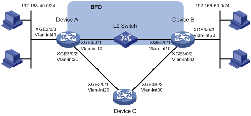

·     A Layer 2 switch connects Device A and Device B.
Because Device B does not support BFD, enable BFD echo packet mode on Device A. When the link between Device B and the Layer 2 switch fails, Device A switches the path over Device C to reach Device B.
Figure 2 Network diagram
Device
Interface
IP address
Device A
Vlan-int10
192.168.10.101/24
Device A
Vlan-int20
192.168.20.101/24
Device A
Vlan-int40
192.168.40.101/24
Device B
Vlan-int10
192.168.10.102/24
Device B
Vlan-int30
192.168.30.101/24
Device B
Vlan-int50
192.168.50.101/24
Device C
Vlan-int20
192.168.20.102/24
Device C
Vlan-int30
192.168.30.102/24
Software version used
This configuration example was created and verified on S7500EX-CMW710-R7168.
The source IP address for BFD echo packets cannot be on the same network segment as any local interface's IP address. Otherwise, a large number of ICMP redirect packets might be sent from the peer, resulting in link congestion.

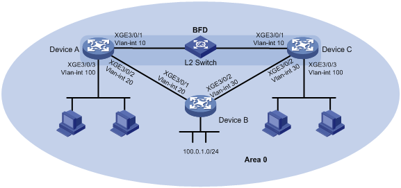

Example: Configuring BFD for OSPF
As shown in Figure 4, Device A, Device B, and Device C run OSPF. Device A and Device C are connected through a Layer 2 switch.
Enable BFD control packet mode on Device A and Device C to monitor the path over the Layer 2 switch. When BFD detects a link failure, it notifies OSPF to switch to the path over Device B.
Figure 4 Network diagram
Table 3 Interface and IP address assignment
Device
Interface
IP address
Device A
Vlan-int10
10.1.0.101/24
Device A
Vlan-int20
192.168.0.101/24
Device A
Vlan-int100
120.1.1.1/24
Device B
Vlan-int20
192.168.0.102/24
Device B
Vlan-int30
13.1.1.101/24
Device C
Vlan-int10
10.1.0.102/24
Device C
Vlan-int30
13.1.1.102/24
Device C
Vlan-int100
121.1.1.1/24
In BFD control packet mode, a minimum of one end must operate in active mode for a BFD session to be established.
Configuration procedures
Configuring interface IP addresses
<DeviceA> system-view
[DeviceA] interface ten-gigabitethernet 3/0/1
[DeviceA-Ten-GigabitEthernet3/0/1] undo shutdown
[DeviceA-Ten-GigabitEthernet3/0/1] quit
[DeviceA] vlan 10
[DeviceA-vlan10] port ten-gigabitethernet 3/0/1
[DeviceA-vlan10] quit
[DeviceA] interface vlan-interface10
[DeviceA-Vlan-interface10] ip address 10.1.0.101 24
[DeviceA-Vlan-interface10] undo shutdown
[DeviceA-Vlan-interface10] quit
2.     Configure other devices in the same way Device A is configured. (Details not shown.)

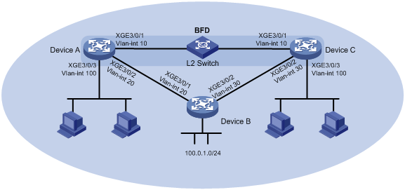

As shown in Figure 5, Device A, Device B, and Device C run IS-IS. Device A and Device C are connected through a Layer 2 switch.
Enable BFD control packet mode on Device A and Device C to monitor the path over the Layer 2 switch. When BFD detects a link failure, it notifies IS-IS to switch to the path over Device B.
Figure 5 Network diagram
Table 4 Interface and IP address assignment
Device
Interface
IP address
Device A
Vlan-int10
10.1.0.101/24
Device A
Vlan-int20
192.168.0.101/24
Device A
Vlan-int100
120.1.1.1/24
Device B
Vlan-int20
192.168.0.102/24
Device B
Vlan-int30
13.1.1.101/24
Device C
Vlan-int10
10.1.0.102/24
Device C
Vlan-int30
13.1.1.102/24
Device C
Vlan-int100
121.1.1.1/24

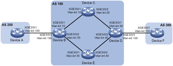

As shown in Figure 6, the devices in AS 100 run OSPF to reach each other. There are two paths between Device B and Device D:
·     Path A—Path over Device C.
·     Path B—Path over Device E.
When both paths are available, BGP uses the path over Device C to forward traffic between Device A and Device F.
Enable BFD control packet mode on Device B and Device D to monitor the path over Device C. When BFD detects a link failure, it notifies BGP to switch to the path over Device E.
Figure 6 Network diagram
Table 5 Interface and IP address assignment
Device
For Path A to become the primary path, use a routing policy to set a lower cost for Path A than Path B.

Ping 120.1.0.1 (120.2.0.1): 56 data bytes, press CTRL_C to break
56 bytes from 120.2.0.1: icmp_seq=0 ttl=252 time=0.680 ms
56 bytes from 120.2.0.1: icmp_seq=1 ttl=252 time=0.295 ms
56 bytes from 120.2.0.1: icmp_seq=2 ttl=252 time=0.423 ms
56 bytes from 120.2.0.1: icmp_seq=3 ttl=252 time=0.464 ms
56 bytes from 120.2.0.1: icmp_seq=4 ttl=252 time=0.445 ms
--- Ping statistics for 120.2.0.1 ---
5 packets transmitted, 5 packets received, 0.0% packet loss
round-trip min/avg/max/std-dev = 0.295/0.461/0.680/0.124 ms
The output shows that Device F can be pinged successfully.
# Display information about the routes to network 120.2.0.0/24 on Device B.
<DeviceB> display ip routing-table 120.2.0.0 24 verbose
Summary Count : 2
Destination: 120.2.0.0/24
   Protocol: BGP             Process ID: 0
  SubProtID: 0x1                    Age: 00h00m18s
       Cost: 0               Preference: 100
        Tag: 0                    State: Active Adv
  OrigTblID: 0x0                OrigVrf: default-vrf
    TableID: 0x2                 OrigAs: 300
      NibID: 0x15000001          LastAs: 300
     AttrID: 0x1               Neighbor: 10.2.0.101
      Flags: 0x10060        OrigNextHop: 10.2.0.101
      Label: NULL           RealNextHop: 192.168.0.102
    BkLabel: NULL             BkNextHop: N/A
  Tunnel ID: Invalid          Interface: Vlan-interface30
  Tunnel ID: Invalid          Interface: Ten-GigabitEthernet3/0/2
BkTunnel ID: Invalid        BkInterface: N/A
   Protocol: OSPF            Process ID: 1
  SubProtID: 0x8                    Age: 00h00m18s
       Cost: 1               Preference: 150
        Tag: 1                    State: Inactive Adv
    TableID: 0x2                 OrigAs: 0
      NibID: 0x13000001          LastAs: 0
     AttrID: 0xffffffff        Neighbor: 0.0.0.0
      Flags: 0x41           OrigNextHop: 192.168.0.102
The output shows that Device B communicates with Device D through path over Device E.
Configuration files
·     Device A:
vlan 100
interface Vlan-interface100
 ip address 120.1.0.1 255.255.255.0
interface Ten-GigabitEthernet3/0/1
port link-mode bridge
 port access vlan 100
bgp 200
 router-id 1.1.1.1
 peer 120.1.0.2 as-number 100
 address-family ipv4 unicast
  network 120.1.0.0 255.255.255.0
  peer 120.1.0.2 enable
·     Device B:
ospf 1
import-route direct
 area 0.0.0.0
  network 10.1.0.0 0.0.0.255
  network 192.168.0.0 0.0.0.255
vlan 10
vlan 30
vlan 100
 ip address 10.1.0.101 255.255.255.0
interface Vlan-interface30
 ip address 192.168.0.101 255.255.255.0
 ip address 120.1.0.2 255.255.255.0
 port access vlan 10
interface Ten-GigabitEthernet3/0/2
 port access vlan 30
interface Ten-GigabitEthernet3/0/3
bgp 100
 router-id 2.2.2.2
 peer 10.2.0.101 as-number 100
 peer 10.2.0.101 bfd
 peer 13.1.1.101 as-number 100
 peer 120.1.0.1 as-number 200
  preference 255 100 130
  peer 10.2.0.101 enable
  peer 10.2.0.101 next-hop-local
  peer 10.2.0.101 route-policy local-pre export
  peer 13.1.1.101 enable
  peer 13.1.1.101 next-hop-local
  peer 120.1.0.1 enable
route-policy local-pre permit node 10
 if-match ip address acl 2000
 apply local-preference 200
acl number 2000
 rule 0 permit source 120.1.0.0 0.0.0.255
·     Device C:
ospf 1
 area 0.0.0.0
  network 10.2.0.0 0.0.0.255
vlan 10
vlan 20
 ip address 10.1.0.102 255.255.255.0
interface Vlan-interface20
 ip address 10.2.0.102 255.255.255.0
 port access vlan 10
 port access vlan 20
·     Device D:
ospf 1
 import-route direct
 area 0.0.0.0
  network 13.1.1.0 0.0.0.255
vlan 20
vlan 40
vlan 100
ip address 10.2.0.101 255.255.255.0
interface Vlan-interface40
 ip address 13.1.1.101 255.255.255.0
 port access vlan 20
 port access vlan 40
bgp 100
 router-id 4.4.4.4
 peer 10.1.0.101 as-number 100
 peer 10.1.0.101 bfd
 peer 120.2.0.1 as-number 300
 peer 192.168.0.101 as-number 100
  peer 10.1.0.101 enable
  peer 10.1.0.101 next-hop-local
  peer 10.1.0.101 route-policy local-pre export
  peer 192.168.0.101 enable
  peer 192.168.0.101 next-hop-local
  peer 120.2.0.1 enable
acl number 2000
 rule 0 permit source 120.2.0.0 0.0.0.255
·     Device E:
ospf 1
 area 0.0.0.0
vlan 30
vlan 40
 ip address 192.168.0.102 255.255.255.0
 ip address 13.1.1.102 255.255.255.0
 port access vlan 30
 port access vlan 40
·     Device F:
vlan 100
 ip address 120.2.0.1 255.255.255.0
bgp 300
 router-id 6.6.6.6
 peer 120.2.0.2 as-number 100
  network 120.2.0.0 255.255.255.0
  peer 120.2.0.2 enable

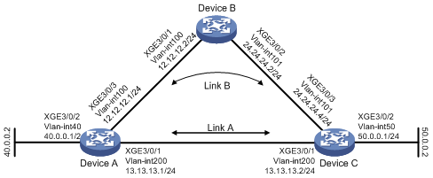

Example: Configuring BFD for PBR
As shown in Figure 7, Device A has two paths to reach Device C:
·     Link A.
·     Link B.
Configure PBR to enable Device A to forward traffic with source IP address 40.0.0.2 over Link B.
Enable BFD echo packet mode on Device A (Device C does not support BFD) to monitor Link B. When BFD detects a link failure, Device A switches the path to Link A.
Figure 7 Network diagram
[DeviceA] vlan 40
[DeviceA-vlan40] port Ten-GigabitEthernet 3/0/2
[DeviceA-vlan40] quit
[DeviceA] interface Ten-GigabitEthernet 3/0/2
[DeviceA-Ten-GigabitEthernet3/0/2] undo shutdown
[DeviceA-Ten-GigabitEthernet3/0/2] quit
[DeviceA] int vlan-interface 40
[DeviceA-Vlan-interface40] undo shutdown
[DeviceA-Vlan-interface40] ip address 40.0.0.1 24
[DeviceA-Vlan-interface40] quit
Configuring static routes
# Configure a static route to reach network 50.0.0.0.
[DeviceA] ip route-static 50.0.0.0 24 vlan-interface 200 13.13.13.2
[DeviceB] ip route-static 50.0.0.0 24 vlan-interface 101 24.24.24.4
Configuring routing policies on Device A
# Create ACL 3010 to permit packets sourced from 40.0.0.2.
[DeviceA] acl number 3010
[DeviceA-acl-adv-3010] rule 0 permit ip source 40.0.0.2 0
[DeviceA-acl-adv-3010] quit
# Create routing policy aaa to set next hop 12.12.12.2 for packets matching ACL 3010, and associate the next hop with track entry 11.
[DeviceA] policy-based-route aaa permit node 5
[DeviceA-pbr-aaa-5] if-match acl 3010
[DeviceA-pbr-aaa-5] apply next-hop 12.12.12.2 track 11
[DeviceA-pbr-aaa-5] quit
# Apply routing policy aaa to VLAN-interface 40.
[DeviceA] interface vlan-interface 40
[DeviceA-Vlan-interface40] ip policy-based-route aaa
Configuring BFD parameters on Device A
[DeviceA] bfd echo-source-ip 3.3.3.3
# Configure the minimum interval for receiving BFD echo packets and the single-hop detection time multiplier, and associate track entry 11 with BFD.
[DeviceA] interface vlan-interface 100
[DeviceA-Vlan-interface100] bfd min-echo-receive-interval 100
[DeviceA-Vlan-interface100] bfd detect-multiplier 3
[DeviceA-Vlan-interface100] quit
[DeviceA] track 11 bfd echo interface vlan-interface100 remote ip 12.12.12.2 local ip 12.12.12.1
# Display outbound traffic statistics for all interfaces on Device A.
<DeviceA> reset counters interface
<DeviceA> display counters outbound interface
Interface         Total (pkts)   Broadcast (pkts)   Multicast (pkts)  Err (pkts)
XGE3/0/1                     0                  0                  0           0
XGE3/0/2                     0                  0                  0           0
XGE3/0/3                585414                  0                  0           0
XGE3/0/4                     0                  0                  0           0
XGE3/0/5                     0                  0                  0           0
XGE3/0/6                     0                  0                  0           0
The output shows that the traffic sourced from 40.0.0.0 is forwarded through VLAN-interface 100 (Link B).
[DeviceA] display bfd session verbose
       Local Discr: 2049
         Source IP: 12.12.12.1         Destination IP: 12.12.12.2
     Session State: Up                      Interface: Vlan-interface100
      Min Tx Inter: 100ms                Act Tx Inter: 100ms
      Min Rx Inter: 100ms                Detect Inter: 300ms
          Rx Count: 128234                   Tx Count: 371950
      Connect Type: Direct             Running Up for: 00:01:04
       Detect Mode: Async                Chassis/Slot: 1/0
          Protocol: TRACK
         Diag Info: No Diagnostic
The output shows that a BFD session has been established and is up.
# When the link between Device A and Device B fails, view BFD log information.
%Dec 10 16:39:46:210 2013 DeviceA BFD/5/BFD_CHANGE_FSM: -MDC=1; Sess[12.12.12.1/
12.12.12.2, LD/RD:2049/2049, Interface:Vlan100, SessType:Echo, LinkType:INET] , S
ta: UP-> DOWN, Diag: 1
%Dec 10 16:39:47:342 2013 DeviceA IFNET/3/PHY_UPDOWN: -MDC=1; Ten-GigabitEtherne
t6/0/5 link status is down.
%Dec 10 16:39:47:343 2013 DeviceA IFNET/5/LINK_UPDOWN: -MDC=1; Line protocol on
the interface Ten-GigabitEthernet3/0/3 is down.
%Dec 10 16:39:47:343 2013 DeviceA IFNET/3/PHY_UPDOWN: -MDC=1; Vlan-interface100
The output shows that the BFD session is down.
# Clear the interface statistics, and display outbound traffic statistics for all interfaces on Device A again.
XGE3/0/1                863764                  0                  0           0
XGE3/0/2                     0                  0                  0           0
XGE3/0/3                     0                  0                  0           0
XGE3/0/4                     0                  0                  0           0
XGE3/0/5                     0                  0                  0           0
XGE3/0/6                     0                  0                  0           0
The output shows that the traffic sourced from 40.0.0.0 is forwarded through VLAN-interface 200 (Link A).
Configuration files
·     Device A:
vlan 40
vlan 100
vlan 200
 if-match acl 3010
 ip address 40.0.0.1 255.255.255.0
 ip address 12.12.12.1 255.255.255.0
interface Vlan-interface200
 ip address 13.13.13.1 255.255.255.0
 port access vlan 200
 port access vlan 40
 ip route-static 50.0.0.0 24 Vlan-interface200 13.13.13.2
 ip local policy-based-route aaa
acl number 3010
 track 11 bfd echo interface Vlan-interface100 remote ip 12.12.12.2 local ip 12.
12.12.1
·     Device B:
vlan 100 to 101
interface NULL0
 ip address 12.12.12.2 255.255.255.0
interface Vlan-interface101
 ip address 24.24.24.2 255.255.255.0
 port access vlan 101
 ip route-static 50.0.0.0 24 Vlan-interface101 24.24.24.4
·     Device C:
vlan 50
vlan 101
vlan 200
interface NULL0
interface Vlan-interface50
 ip address 50.0.0.1 255.255.255.0
 ip address 24.24.24.4 255.255.255.0
 ip address 13.13.13.2 255.255.255.0
 port access vlan 50
