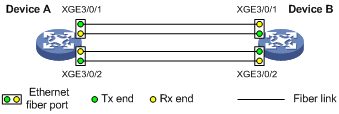

As shown in Figure 1, Device A and Device B are connected through two fiber pairs.
Configure DLDP on the devices so each device performs the following tasks:
·     Detects unidirectional links caused by cross-connected fibers or a disconnected fiber.
·     Automatically shuts down the faulty interface when detecting a unidirectional link.
·     Automatically brings up the interface after the administrator clears the fault.
Figure 1 Network diagram

As shown in Figure 2, the two pairs of fibers between Device A and Device B are cross-connected.
Figure 2 Cross-connected fibers

As shown in Figure 4, the two pairs of fibers between Device A and Device B are cross-connected.
Figure 4 Cross-connected fibers
The following log information is displayed on Device A:
<DeviceA>%Jul 12 08:29:17:786 2014 DeviceA IFNET/3/PHY_UPDOWN: Ten-GigabitEthernet3/0/1 link status is DOWN.
