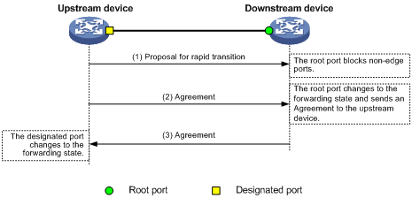

RSTP achieves rapid network convergence by allowing a newly elected root port or designated port to enter the forwarding state much faster than STP.
A newly elected RSTP root port rapidly enters the forwarding state when the following conditions exist:
·     The old root port on the device has stopped forwarding data.
·     The upstream designated port has started forwarding data.
A newly elected RSTP designated port rapidly enters the forwarding state if it is an edge port or it connects to a point-to-point link.
·     A port that directly connects to a user terminal can be configured as an edge port. Edge ports directly enter the forwarding state.
·     When a designated port connects to a point-to-point link, it enters the forwarding state immediately after the device receives a handshake response from the directly connected device.

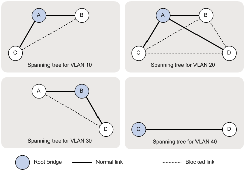

In an STP- or RSTP-enabled LAN, all bridges share one spanning tree. Traffic from all VLANs is forwarded along the spanning tree, and ports cannot be blocked on a per-VLAN basis to prune loops.
PVST allows every VLAN to have its own spanning tree, which increases usage of links and bandwidth. Because each VLAN runs STP or RSTP independently, a spanning tree only serves its VLAN.

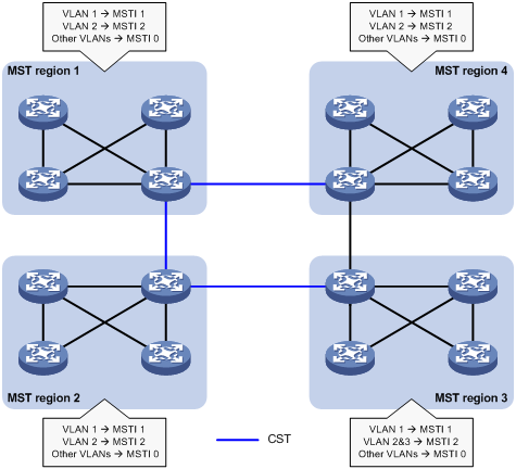

Figure 4 shows a switched network that contains four MST regions, each MST region containing four MSTP devices. Figure 5 shows the networking topology of MST region 3.
Figure 4 Basic concepts in MSTP

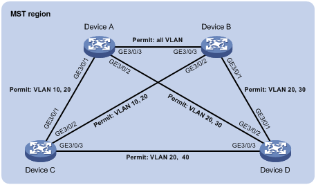

Figure 5 Network diagram and topology of MST region 3
MST region
A multiple spanning tree region (MST region) consists of multiple devices in a switched network and the network segments among them. All these devices have the following characteristics:
·     A spanning tree protocol enabled
·     Same region name
·     Same VLAN-to-instance mapping configuration
·     Same MSTP revision level
·     Physically linked together
Multiple MST regions can exist in a switched network. You can assign multiple devices to the same MST region, as shown in Figure 4.
·     The switched network contains four MST regions, MST region 1 through MST region 4.
·     All devices in each MST region have the same MST region configuration.

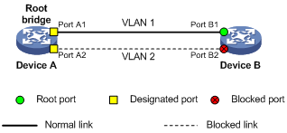

MSTI
MSTP can generate multiple independent spanning trees in an MST region, and each spanning tree is mapped to the specific VLANs. Each spanning tree is referred to as a multiple spanning tree instance (MSTI).
In Figure 5, MST region 3 contains three MSTIs, MSTI 1, MSTI 2, and MSTI 0.
VLAN-to-instance mapping table
As an attribute of an MST region, the VLAN-to-instance mapping table describes the mapping relationships between VLANs and MSTIs.
In Figure 5, the VLAN-to-instance mapping table of MST region 3 is as follows:
·     VLAN 1 to MSTI 1.
·     VLAN 2 and VLAN 3 to MSTI 2.
·     Other VLANs to MSTI 0.
MSTP achieves load balancing by means of the VLAN-to-instance mapping table.

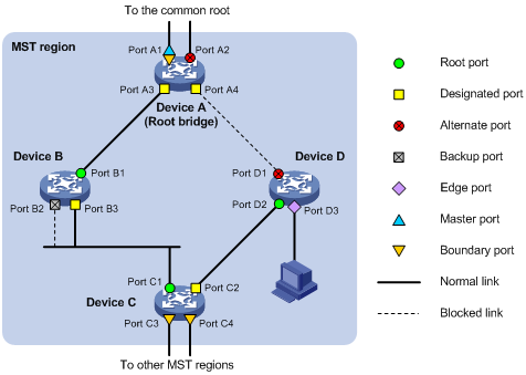

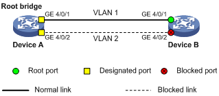

Port roles
A port can play different roles in different MSTIs. As shown in Figure 6, an MST region contains Device A, Device B, Device C, and Device D. Port A1 and port A2 of Device A connect to the common root bridge. Port B2 and Port B3 of Device B form a loop. Port C3 and Port C4 of Device C connect to other MST regions. Port D3 of Device D directly connects to a host.
Figure 6 Port roles
MSTP calculation involves the following port roles:
·     Root port—Forwards data for a non-root bridge to the root bridge. The root bridge does not have any root port.
·     Designated port—Forwards data to the downstream network segment or device.
·     Alternate portActs as the backup port for a root port or master port. When the root port or master port is blocked, the alternate port takes over.
·     Backup portActs as the backup port of a designated port. When the designated port is invalid, the backup port becomes the new designated port. A loop occurs when two ports of the same spanning tree device are connected, so the device blocks one of the ports. The blocked port acts as the backup.
·     Edge port—Does not connect to any network device or network segment, but directly connects to a user host.
·     Master portActs as a port on the shortest path from the local MST region to the common root bridge. The master port is not always located on the regional root. It is a root port on the IST or CIST and still a master port on the other MSTIs.
·     Boundary port—Connects an MST region to another MST region or to an STP/RSTP-running device. In MSTP calculation, a boundary port's role on an MSTI is consistent with its role on the CIST. However, that is not true with master ports. A master port on MSTIs is a root port on the CIST.

Configuring the VLAN Ignore feature
Introduction to VLAN Ignore
Traffic of a VLAN on a complex network might be blocked by the spanning tree.
Figure 7 VLAN connectivity blocked by MSTP
As shown in Figure 7:
·     Port A1 on Device A allows the traffic of VLAN 1 to pass through.
·     Port A2 on Device A allows the traffic of VLAN 2 to pass through.
·     Port B1 on Device B allows the traffic of VLAN 1 to pass through.
·     Port B2 on Device B allows the traffic of VLAN 2 to pass through.
·     Device A and Device B run a spanning tree protocol. Device A is the root bridge, and Port A1 and Port A2 are designated ports. On Device B, Port B1 is the root port, and port B2 is the blocked port. Traffic of VLAN 2 is blocked.
Ignoring a VLAN can make ports of the VLAN forward packets correctly rather than comply with the spanning tree calculation result.
Configuration procedure
To ignore VLANs:
Step
Remarks
N/A
2.     Ignore the specified VLANs.
stp ignored vlan vlan-id-list
By default, no VLAN is ignored.
VLAN Ignore configuration example
Network requirements
As shown in Figure 8:
·     Device A and Device B are directly connected.
·     GigabitEthernet 4/0/1 on Device A and GigabitEthernet 4/0/1 on Device B allow the traffic of VLAN 1 to pass through. GigabitEthernet 4/0/2 on Device A and GigabitEthernet 4/0/2 on Device B allow the traffic of VLAN 2 to pass through.
·     Device A is the root bridge, and Device A and Device B both run a spanning tree protocol. GigabitEthernet 4/0/2 on Device B is blocked, causing traffic of VLAN 2 to be blocked.
Ignore VLAN 2 to keep GigabitEthernet 4/0/2 of Device B in the forwarding state.
Figure 8 Network diagram
# Ignore VLAN 2 on Device B.
<DeviceB> system-view
[DeviceB] stp ignored vlan 2
# Display the ignored VLANs.
[DeviceB] display stp ignored-vlan
 STP-Ignored VLANs:  2

In RSTP and MSTP, the following types of messages are used for rapid state transition on designated ports:
·     Proposal—Sent by designated ports to request rapid transition
·     Agreement—Used to acknowledge rapid transition requests
Both RSTP and MSTP devices can perform rapid transition on a designated port only when the port receives an agreement packet from the downstream device. RSTP and MSTP devices have the following differences:
·     For MSTP, the root port of the downstream device sends an agreement packet only after it receives an agreement packet from the upstream device.
·     For RSTP, the downstream device sends an agreement packet whether or not an agreement packet from the upstream device is received.
Figure 10 Rapid state transition of an MSTP designated port
Figure 11 Rapid state transition of an RSTP designated port

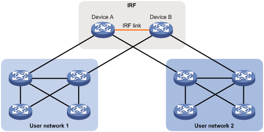

Configuring TC Snooping
As shown in Figure 13, an IRF fabric connects to two user networks through double links.
·     Device A and Device B form the IRF fabric.
·     The spanning tree feature is disabled on Device A and Device B and enabled on all devices in user network 1 and user network 2.
·     The IRF fabric transparently transmits BPDUs for both user networks and is not involved in the calculation of spanning trees.
When the network topology changes, it takes time for the IRF fabric to update its MAC address table and ARP table. During this period, traffic in the network might be interrupted.
Figure 13 TC Snooping application scenario
To avoid traffic interruption, you can enable TC Snooping on the IRF fabric. After receiving a TC-BPDU through a port, the IRF fabric updates MAC address table and ARP table entries associated with the port's VLAN. In this way, TC Snooping prevents topology change from interrupting traffic forwarding in the network. For more information about the MAC address table and the ARP table, see "Configuring the MAC address table" and Layer 3—IP Services Configuration Guide.

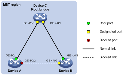

The root bridge and secondary root bridge of a spanning tree should be located in the same MST region. Especially for the CIST, the root bridge and secondary root bridge are put in a high-bandwidth core region during network design. However, due to possible configuration errors or malicious attacks in the network, the legal root bridge might receive a configuration BPDU with a higher priority. Another device supersedes the current legal root bridge, causing an undesired change of the network topology. The traffic that should go over high-speed links is switched to low-speed links, resulting in network congestion.
To prevent this situation, MSTP provides the root guard feature. If the root guard feature is enabled on a port of a root bridge, this port plays the role of designated port on all MSTIs. After this port receives a configuration BPDU with a higher priority from an MSTI, it performs the following operations:
·     Immediately sets that port to the listening state in the MSTI.
·     Does not forward the received configuration BPDU.
This is equivalent to disconnecting the link connected to this port in the MSTI. If the port receives no BPDUs with a higher priority within twice the forwarding delay, it reverts to its original state.

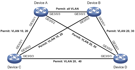

MSTP configuration example
As shown in Figure 14, all devices on the network are in the same MST region. Device A and Device B work at the distribution layer. Device C and Device D work at the access layer.
Configure MSTP so that packets of different VLANs are forwarded along different spanning trees.
·     VLAN 10 packets are forwarded along MSTI 1.
·     VLAN 30 packets are forwarded along MSTI 3.
·     VLAN 40 packets are forwarded along MSTI 4.
·     VLAN 20 packets are forwarded along MSTI 0.
VLAN 10 and VLAN 30 are terminated on the distribution layer devices, and VLAN 40 is terminated on the access layer devices. The root bridges of MSTI 1 and MSTI 3 are Device A and Device B, respectively, and the root bridge of MSTI 4 is Device C.
Figure 14 Network diagram
1.     Configure VLANs and VLAN member ports. (Details not shown.)
¡     Create VLAN 10, VLAN 20, and VLAN 30 on both Device A and Device B.
¡     Create VLAN 10, VLAN 20, and VLAN 40 on Device C.
¡     Create VLAN 20, VLAN 30, and VLAN 40 on Device D.
¡     Configure the ports on these devices as trunk ports and assign them to related VLANs.
2.     Configure Device A:
# Enter MST region view, and configure the MST region name as example.
<DeviceA> system-view
[DeviceA] stp region-configuration
[DeviceA-mst-region] region-name example
# Map VLAN 10, VLAN 30, and VLAN 40 to MSTI 1, MSTI 3, and MSTI 4, respectively.
[DeviceA-mst-region] instance 1 vlan 10
[DeviceA-mst-region] instance 3 vlan 30
[DeviceA-mst-region] instance 4 vlan 40
# Configure the revision level of the MST region as 0.
[DeviceA-mst-region] revision-level 0
# Activate MST region configuration.
[DeviceA-mst-region] active region-configuration
[DeviceA-mst-region] quit
# Specify the current device as the root bridge of MSTI 1.
[DeviceA] stp instance 1 root primary
# Enable the spanning tree feature globally.
[DeviceA] stp global enable
3.     Configure Device B:
[DeviceB] stp region-configuration
[DeviceB-mst-region] region-name example
[DeviceB-mst-region] instance 1 vlan 10
[DeviceB-mst-region] instance 3 vlan 30
[DeviceB-mst-region] instance 4 vlan 40
[DeviceB-mst-region] revision-level 0
[DeviceB-mst-region] active region-configuration
[DeviceB-mst-region] quit
# Specify the current device as the root bridge of MSTI 3.
[DeviceB] stp instance 3 root primary
[DeviceB] stp global enable
4.     Configure Device C:
<DeviceC> system-view
[DeviceC] stp region-configuration
[DeviceC-mst-region] region-name example
[DeviceC-mst-region] instance 1 vlan 10
[DeviceC-mst-region] instance 3 vlan 30
[DeviceC-mst-region] instance 4 vlan 40
[DeviceC-mst-region] revision-level 0
[DeviceC-mst-region] active region-configuration
[DeviceC-mst-region] quit
# Specify the current device as the root bridge of MSTI 4.
[DeviceC] stp instance 4 root primary
[DeviceC] stp global enable
5.     Configure Device D:
<DeviceD> system-view
[DeviceD] stp region-configuration
[DeviceD-mst-region] region-name example
[DeviceD-mst-region] instance 1 vlan 10
[DeviceD-mst-region] instance 3 vlan 30
[DeviceD-mst-region] instance 4 vlan 40
[DeviceD-mst-region] revision-level 0
[DeviceD-mst-region] active region-configuration
[DeviceD-mst-region] quit
[DeviceD] stp global enable
In this example, Device B has the lowest root bridge ID. As a result, Device B is elected as the root bridge in MSTI 0.
When the network is stable, you can use the display stp brief command to display brief spanning tree information on each device.
# Display brief spanning tree information on Device A.
[DeviceA] display stp brief
 MST ID   Port                                Role  STP State   Protection
 0        GigabitEthernet3/0/1                ALTE  DISCARDING  NONE
 0        GigabitEthernet3/0/2                DESI  FORWARDING  NONE
 0        GigabitEthernet3/0/3                ROOT  FORWARDING  NONE
 1        GigabitEthernet3/0/1                DESI  FORWARDING  NONE
 1        GigabitEthernet3/0/3                DESI  FORWARDING  NONE
 3        GigabitEthernet3/0/2                DESI  FORWARDING  NONE
 3        GigabitEthernet3/0/3                ROOT  FORWARDING  NONE
# Display brief spanning tree information on Device B.
[DeviceB] display stp brief
 0        GigabitEthernet3/0/1                DESI  FORWARDING  NONE
 0        GigabitEthernet3/0/3                DESI  FORWARDING  NONE
 1        GigabitEthernet3/0/2                DESI  FORWARDING  NONE
 1        GigabitEthernet3/0/3                ROOT  FORWARDING  NONE
 3        GigabitEthernet3/0/1                DESI  FORWARDING  NONE
 3        GigabitEthernet3/0/3                DESI  FORWARDING  NONE
# Display brief spanning tree information on Device C.
[DeviceC] display stp brief
 0        GigabitEthernet3/0/2                ROOT  FORWARDING  NONE
 1        GigabitEthernet3/0/1                ROOT  FORWARDING  NONE
 1        GigabitEthernet3/0/2                ALTE  DISCARDING  NONE
 4        GigabitEthernet3/0/3                DESI  FORWARDING  NONE
# Display brief spanning tree information on Device D.
[DeviceD] display stp brief
 0        GigabitEthernet3/0/1                ROOT  FORWARDING  NONE
 0        GigabitEthernet3/0/2                ALTE  DISCARDING  NONE
 0        GigabitEthernet3/0/3                ALTE  DISCARDING  NONE
 3        GigabitEthernet3/0/1                ROOT  FORWARDING  NONE
 3        GigabitEthernet3/0/2                ALTE  DISCARDING  NONE
 4        GigabitEthernet3/0/3                ROOT  FORWARDING  NONE
Based on the output, you can draw each MSTI mapped to each VLAN, as shown in Figure 15.
Figure 15 MSTIs mapped to different VLANs
PVST configuration example
As shown in Figure 16, Device A and Device B work at the distribution layer, and Device C and Device D work at the access layer.
Configure PVST so that packets of VLAN 10, VLAN 20, VLAN 30, and VLAN 40 are forwarded along the spanning trees of their own VLANs.
VLAN 10, VLAN 20, and VLAN 30 are terminated on the distribution layer devices, and VLAN 40 is terminated on the access layer devices. Configure the root bridge of VLAN 10 and VLAN 20 as Device A. Configure the root bridge of VLAN 30 as Device B. Configure the root bridge of VLAN 40 as Device C.
Figure 16 Network diagram
# Set the spanning tree mode to PVST.
[DeviceA] stp mode pvst
# Configure the device as the root bridge of VLAN 10 and VLAN 20.
[DeviceA] stp vlan 10 20 root primary
# Enable the spanning tree feature globally and in VLAN 10, VLAN 20, and VLAN 30.
[DeviceA] stp vlan 10 20 30 enable
[DeviceB] stp mode pvst
# Configure the device as the root bridge of VLAN 30.
[DeviceB] stp vlan 30 root primary
[DeviceB] stp vlan 10 20 30 enable
[DeviceC] stp mode pvst
# Configure the device as the root bridge of VLAN 40.
[DeviceC] stp vlan 40 root primary
# Enable the spanning tree feature globally and in VLAN 10, VLAN 20, and VLAN 40.
[DeviceC] stp vlan 10 20 40 enable
[DeviceD] stp mode pvst
# Enable the spanning tree feature globally and in VLAN 20, VLAN 30, and VLAN 40.
[DeviceD] stp vlan 20 30 40 enable
 VLAN ID  Port                                Role  STP State   Protection
 10       GigabitEthernet3/0/1                DESI  FORWARDING  NONE
 10       GigabitEthernet3/0/3                DESI  FORWARDING  NONE
 20       GigabitEthernet3/0/1                DESI  FORWARDING  NONE
 20       GigabitEthernet3/0/2                DESI  FORWARDING  NONE
 20       GigabitEthernet3/0/3                DESI  FORWARDING  NONE
 30       GigabitEthernet3/0/2                DESI  FORWARDING  NONE
 30       GigabitEthernet3/0/3                ROOT  FORWARDING  NONE
 10       GigabitEthernet3/0/2                DESI  FORWARDING  NONE
 10       GigabitEthernet3/0/3                ROOT  FORWARDING  NONE
 20       GigabitEthernet3/0/3                ROOT  FORWARDING  NONE
 30       GigabitEthernet3/0/1                DESI  FORWARDING  NONE
 30       GigabitEthernet3/0/3                DESI  FORWARDING  NONE
 10       GigabitEthernet3/0/1                ROOT  FORWARDING  NONE
 10       GigabitEthernet3/0/2                ALTE  DISCARDING  NONE
 20       GigabitEthernet3/0/1                ROOT  FORWARDING  NONE
 20       GigabitEthernet3/0/2                ALTE  DISCARDING  NONE
 40       GigabitEthernet3/0/3                DESI  FORWARDING  NONE
 20       GigabitEthernet3/0/1                ALTE  DISCARDING  NONE
 20       GigabitEthernet3/0/2                ROOT  FORWARDING  NONE
 20       GigabitEthernet3/0/3                ALTE  DISCARDING  NONE
 30       GigabitEthernet3/0/1                ROOT  FORWARDING  NONE
 30       GigabitEthernet3/0/2                ALTE  DISCARDING  NONE
 40       GigabitEthernet3/0/3                ROOT  FORWARDING  NONE
Based on the output, you can draw a topology for each VLAN spanning tree, as shown in Figure 17.
Figure 17 VLAN spanning tree topologies
