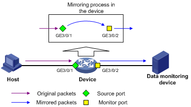

Local port mirroring
In local port mirroring, the mirroring source and the mirroring destination are on the same device. A mirroring group that contains the mirroring source and the mirroring destination on the device is called a local mirroring group.
Figure 1 Local port mirroring implementation
As shown in Figure 1, the source port GigabitEthernet 3/0/1 and monitor port GigabitEthernet 3/0/2 reside on the same device. Packets of GigabitEthernet 3/0/1 are copied to GigabitEthernet 3/0/2, which then forwards the packets to the data monitoring device for analysis.

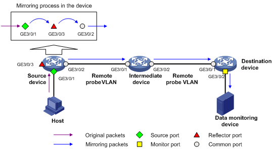

Layer 2 remote port mirroring can be implemented when a fixed reflector port, configurable reflector port, or configurable egress port is available on the source device. The configuration method when either of the first two ports is available on the source device is called reflector port method. You must configure a reflector port on the source device that has a configurable reflector port. The switch only supports Layer 2 remote port mirroring with a configurable reflector port.
Figure 2 Layer 2 remote port mirroring implementation (with a reflector port)
On the network shown in Figure 2, the source device copies the packets received on the source port GigabitEthernet 3/0/1 to the reflector port GigabitEthernet 3/0/3. GigabitEthernet 3/0/3 broadcasts the packets in the remote probe VLAN and the intermediate device in the VLAN transmits the packets to the destination device. When receiving these mirrored packets, the destination device compares their VLAN IDs to the ID of the remote probe VLAN configured in the remote destination group. If the VLAN IDs of these mirrored packets match the remote probe VLAN ID, the device forwards them to the data monitoring device through the monitor port.
·     Allow remote probe VLAN to pass through the intermediate devices to make sure the source device and the destination device can communicate at Layer 2 in the remote probe VLAN.
·     For a mirrored packet to successfully arrive at the remote destination device, make sure the VLAN ID of the mirrored packet is not removed or changed. Otherwise, the Layer 2 remote port mirroring configuration will fail.
·     For the reflector port method, you can implement the local port mirroring function by assigning the other ports on the source device to the remote probe VLAN, because the source device broadcasts mirrored packets in the remote probe VLAN.
·     To monitor both the received and sent packets of a port in a mirroring group, you must make some special configurations on the intermediate devices.

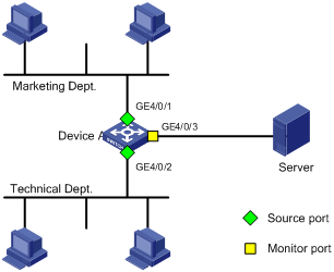

Local port mirroring configuration example (in source port mode)
Network requirements
On a network shown in Figure 3:
·     Device A connects to the marketing department through GigabitEthernet 4/0/1 and to the technical department through GigabitEthernet 4/0/2, and connects to the server through GigabitEthernet 4/0/3.
·     Configure local port mirroring in source port mode to enable the server to monitor the bidirectional traffic of the marketing department and the technical department.
Figure 3 Network diagram

1.     Configure a local mirroring group:
# Create a local mirroring group.
<Sysname> system-view
[Sysname] mirroring-group 1 local
# Configure ports GigabitEthernet 4/0/1 and GigabitEthernet 4/0/2 as mirroring ports and port GigabitEthernet 4/0/3 as the monitor port in the mirroring group.
[Sysname] mirroring-group 1 mirroring-port Gigabitethernet 4/0/1 Gigabitethernet 4/0/2 both
[Sysname] mirroring-group 1 monitor-port Gigabitethernet 4/0/3
# Disable the spanning tree feature on the monitor port GigabitEthernet 4/0/3.
[DeviceA] interface Gigabitethernet 4/0/3
[DeviceA-Gigabitethernet4/0/3] undo stp enable
[DeviceA-Gigabitethernet4/0/3] quit
2.     Verify the configuration by displaying the configuration of all mirroring groups.
[DeviceA] display mirroring-group all
mirroring-group 1:
    type: local
    status: active
    mirroring port:
        Gigabitethernet4/0/1 both
        Gigabitethernet4/0/2 both
    mirroring vlan:
monitor port: Gigabitethernet4/0/3
After the configurations are completed, you can monitor all the packets received and sent by the marketing department and the technical department on the server.

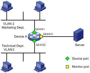

Local port mirroring configuration example (in source VLAN mode)
On a network shown in Figure 4:
·     Device A connects to the marketing department through GigabitEthernet 4/0/1 and to the technical department through GigabitEthernet 4/0/2, and connects to the server through GigabitEthernet 4/0/3. GigabitEthernet 4/0/1 and GigabitEthernet 4/0/2 both belong to VLAN 2.
·     Configure local port mirroring in source VLAN mode to enable the server to monitor the bidirectional traffic of the marketing department and the technical department.
Figure 4 Network diagram
Configuration procedure
1.     Create a local mirroring group:
# Create local mirroring group 1.
<DeviceA> system-view
[DeviceA] mirroring-group 1 local
# Create VLAN 2, and assign GigabitEthernet 4/0/1 and GigabitEthernet 4/0/2 to VLAN 2.
[DeviceA] vlan 2
[DeviceA-vlan2] port GigabitEthernet 4/0/1 GigabitEthernet 4/0/2
[DeviceA-vlan2] quit
# Configure VLAN 2 as a source VLAN and GigabitEthernet 4/0/3 as the monitor port.
[DeviceA] mirroring-group 1 mirroring-vlan 2 both
[DeviceA] mirroring-group 1 monitor-port GigabitEthernet 4/0/3
[DeviceA] interface GigabitEthernet 4/0/3
[DeviceA-GigabitEthernet4/0/3] undo stp enable
[DeviceA-GigabitEthernet4/0/3] quit
mirroring-group 1:
    type: local
    status: active
    mirroring port:
    mirroring vlan:
        2  both
    mirroring CPU:

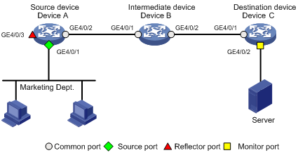

Layer 2 remote port mirroring configuration example (reflector port configurable)
As shown in Figure 5, Device A connects to the marketing department through GigabitEthernet 4/0/1, and to the trunk port GigabitEthernet 4/0/1 of Device B through the trunk port GigabitEthernet 4/0/2. Device C connects to the server through GigabitEthernet 4/0/2, and to the trunk port GigabitEthernet 4/0/2 of Device B through the trunk port GigabitEthernet 4/0/1. Device A supports configurable reflector port configuration.
Configure Layer 2 remote port mirroring to enable the server to monitor the bidirectional traffic of the marketing department.
Figure 5 Network diagram
1.     Configure Device A (the source device):
# Create a remote source group.
[DeviceA] mirroring-group 1 remote-source
# Create VLAN 2.
[DeviceA] vlan 2
# Disable MAC address learning for VLAN 2.
[DeviceA-vlan2] mac-address max-mac-count 0
# Configure VLAN 2 as the remote probe VLAN, GigabitEthernet 4/0/1 as a source port, and GigabitEthernet 4/0/3 as the reflector port in the mirroring group.
[DeviceA] mirroring-group 1 remote-probe vlan 2
[DeviceA] mirroring-group 1 mirroring-port GigabitEthernet 4/0/1 both
[DeviceA] mirroring-group 1 reflector-port GigabitEthernet 4/0/3
# Configure GigabitEthernet 4/0/2 as a trunk port that permits the packets of VLAN 2 to pass through.
[DeviceA] interface GigabitEthernet 4/0/2
[DeviceA-GigabitEthernet 4/0/2] port link-type trunk
[DeviceA-GigabitEthernet 4/0/2] port trunk permit vlan 2
[DeviceA-GigabitEthernet 4/0/2] quit
2.     Configure Device B (the intermediate device):
# Create VLAN 2.
<DeviceB> system-view
[DeviceB] vlan 2
[DeviceB-vlan2] mac-address max-mac-count 0
[DeviceB-vlan2] quit
# Configure GigabitEthernet 4/0/1 as a trunk port that permits the packets of VLAN 2 to pass through.
[DeviceB] interface GigabitEthernet 4/0/1
[DeviceB-GigabitEthernet 4/0/1] port link-type trunk
[DeviceB-GigabitEthernet 4/0/1] port trunk permit vlan 2
[DeviceB-GigabitEthernet 4/0/1] quit
[DeviceB] interface GigabitEthernet 4/0/2
[DeviceB-GigabitEthernet 4/0/2] port link-type trunk
[DeviceB-GigabitEthernet 4/0/2] port trunk permit vlan 2
[DeviceB-GigabitEthernet 4/0/2] quit
3.     Configure Device C (the destination device):
<DeviceC> system-view
[DeviceC] interface GigabitEthernet 4/0/1
[DeviceC-GigabitEthernet 4/0/1] port link-type trunk
[DeviceC-GigabitEthernet 4/0/1] port trunk permit vlan 2
[DeviceC-GigabitEthernet 4/0/1] quit
# Create a remote destination group.
[DeviceC] mirroring-group 1 remote-destination
# Create VLAN 2.
[DeviceC] vlan 2
[DeviceC-vlan2] mac-address max-mac-count 0
[DeviceC-vlan2] quit
# Configure VLAN 2 as the remote probe VLAN of the mirroring group and GigabitEthernet 4/0/2 as the monitor port of the mirroring group, disable the spanning tree feature on GigabitEthernet 4/0/2, and assign the port to VLAN 2.
[DeviceC] mirroring-group 1 remote-probe vlan 2
[DeviceC] interface GigabitEthernet 4/0/2
[DeviceC-GigabitEthernet 4/0/2] mirroring-group 1 monitor-port
[DeviceC-GigabitEthernet 4/0/2] undo stp enable
[DeviceC-GigabitEthernet 4/0/2] port access vlan 2
[DeviceC-GigabitEthernet 4/0/2] quit
4.     Verify the configuration by monitoring all the packets received and sent by the marketing department on the server.

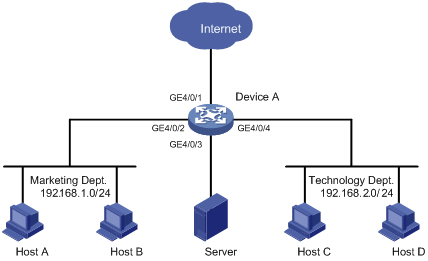

Traffic mirroring configuration example
As shown in Figure 6, different departments of a company use IP addresses on different subnets. The marketing and technology departments use the IP addresses on subnets 192.168.1.0/24 and 192.168.2.0/24 respectively. The working hour of the company is from 8:00 to 18:00 on weekdays.
Configure traffic mirroring so that the server can monitor the traffic that the technology department sends to access the Internet, and IP traffic that the technology department sends to the marketing department.
Figure 6 Network diagram
1.     Monitor the traffic sent by the technology department to access the Internet:
# Create ACL 3000 to allow packets from the technology department (on subnet 192.168.2.0/24) to access the Internet.
[DeviceA] acl number 3000
[DeviceA-acl-adv-3000] rule permit tcp source 192.168.2.0 0.0.0.255 destination-port eq www
[DeviceA-acl-adv-3000] quit
# Create traffic class tech_c, and configure the match criterion as ACL 3000.
[DeviceA] traffic classifier tech_c
[DeviceA-classifier-tech_c] if-match acl 3000
[DeviceA-classifier-tech_c] quit
# Create traffic behavior tech_b, and configure the action of mirroring traffic to port GigabitEthernet 4/0/3.
[DeviceA] traffic behavior tech_b
[DeviceA-behavior-tech_b] mirror-to interface GigabitEthernet 4/0/3
[DeviceA-behavior-tech_b] quit
# Create QoS policy tech_p, and associate traffic class tech_c with traffic behavior tech_b in the QoS policy.
[DeviceA] qos policy tech_p
[DeviceA-qospolicy-tech_p] classifier tech_c behavior tech_b
[DeviceA-qospolicy-tech_p] quit
# Apply QoS policy tech_p to the incoming packets of GigabitEthernet 4/0/4.
[DeviceA] interface GigabitEthernet 4/0/4
[DeviceA-GigabitEthernet4/0/4] qos apply policy tech_p inbound
[DeviceA-GigabitEthernet4/0/4] quit
2.     Monitor the traffic that the technology department sends to the marketing department:
# Configure a time range named work to cover the time from 8: 00 to 18: 00 in working days.
[DeviceA] time-range work 8:0 to 18:0 working-day
# Create ACL 3001 to allow packets sent from the technology department (on subnet 192.168.2.0/24) to the marketing department (on subnet 192.168.1.0/24).
[DeviceA] acl number 3001
[DeviceA-acl-adv-3001] rule permit ip source 192.168.2.0 0.0.0.255 destination 192.168.1.0 0.0.0.255 time-range work
[DeviceA-acl-adv-3001] quit
# Create traffic class mkt_c, and configure the match criterion as ACL 3001.
[DeviceA] traffic classifier mkt_c
[DeviceA-classifier-mkt_c] if-match acl 3001
[DeviceA-classifier-mkt_c] quit
# Create traffic behavior mkt_b, and configure the action of mirroring traffic to port GigabitEthernet 4/0/3.
[DeviceA] traffic behavior mkt_b
[DeviceA-behavior-mkt_b] mirror-to interface GigabitEthernet 4/0/3
[DeviceA-behavior-mkt_b] quit
# Create QoS policy mkt_p, and associate traffic class mkt_c with traffic behavior mkt_b in the QoS policy.
[DeviceA] qos policy mkt_p
[DeviceA-qospolicy-mkt_p] classifier mkt_c behavior mkt_b
[DeviceA-qospolicy-mkt_p] quit
# Apply QoS policy mkt_p to the incoming packets of GigabitEthernet 4/0/4.
[DeviceA-GigabitEthernet4/0/4] qos apply policy mkt_p inbound
After completing the configurations, through the server, you can monitor all traffic sent by the technology department to access the Internet and the IP traffic that the technology department sends to the marketing department during working hours.
