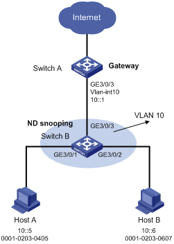

As shown in Figure 2, Host A and Host B connect to Switch A, the gateway, through Switch B. Host A has the IPv6 address 10::5 and MAC address 0001-0203-0405. Host B has the IPv6 address 10::6 and MAC address 0001-0203-0607.
Enable ND detection on Switch B to check ND packets to filter out the ND packets from untrusted hosts.
Figure 2 Network diagram

# Configure the uplink port GigabitEthernet 3/0/3 as an ND-trusted port, while the downlink ports GigabitEthernet 3/0/1 and GigabitEthernet 3/0/2 as ND-untrusted ports (the default).
[SwitchB] interface GigabitEthernet 3/0/3
[SwitchB-GigabitEthernet3/0/3] ipv6 nd detection trust
After the configuration is complete, incoming ND packets on ports GigabitEthernet 3/0/1 and GigabitEthernet 3/0/2 will be checked based on the address entries in the ND snooping table.
