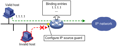

After receiving a packet, an IP source guard-enabled port obtains the key attributes (source IP address, source MAC address and VLAN tag) of the packet and then looks them up in the IP source guard entries. If there is a match, the port forwards the packet; otherwise, the port discards the packet, as shown in Figure 1.
Figure 1 Diagram for the IP source guard function
IP source guard entries configured on a port take effect only on that port.

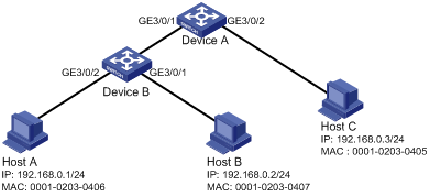

As shown in Figure 2, Host A and Host B are connected to ports GigabitEthernet 3/0/2 and GigabitEthernet 3/0/1 of Device B, respectively. Host C is connected to port GigabitEthernet 3/0/2 of Device A. Device B is connected to port GigabitEthernet 3/0/1 of Device A. All hosts use static IP addresses.
Configure static IPv4 source guard entries on Device A and Device B to meet the following requirements:
·     On port GigabitEthernet 3/0/2 of Device A, only IP packets from Host C can pass.
·     On port GigabitEthernet 3/0/1 of Device A, only IP packets from Host A can pass.
·     On port GigabitEthernet 3/0/2 of Device B, only IP packets from Host A can pass.
·     On port GigabitEthernet 3/0/1 of Device B, only IP packets sourced from 192.168.0.2/24 can pass. Host B can communicate with Host A by using this IP address even if it uses another network adapter.
Figure 2 Network diagram
Configuration procedure
1.     Configure Device A:
# Configure the IPv4 source guard function on GigabitEthernet 3/0/2 to filter packets based on both the source IP address and MAC address.
<DeviceA> system-view
[DeviceA] interface GigabitEthernet 3/0/2
[DeviceA-GigabitEthernet3/0/2] ip verify source ip-address mac-address
# Configure GigabitEthernet 3/0/2 to allow only IP packets with the source MAC address of 0001-0203-0405 and the source IP address of 192.168.0.3 to pass.
[DeviceA-GigabitEthernet3/0/2] ip source binding ip-address 192.168.0.3 mac-address 0001-0203-0405
[DeviceA-GigabitEthernet3/0/2] quit
# Configure the IPv4 source guard function on GigabitEthernet 3/0/1 to filter packets based on both the source IP address and MAC address.
[DeviceA] interface GigabitEthernet 3/0/1
[DeviceA-GigabitEthernet3/0/1] ip verify source ip-address mac-address
# Configure GigabitEthernet 3/0/1 to allow only IP packets with the source MAC address of 0001-0203-0406 and the source IP address of 192.168.0.1 to pass.
[DeviceA-GigabitEthernet3/0/1] ip source binding ip-address 192.168.0.1 mac-address 0001-0203-0406
[DeviceA-GigabitEthernet3/0/1] quit
2.     Configure Device B:
[DeviceB] interface GigabitEthernet 3/0/2
[DeviceB-GigabitEthernet3/0/2] ip verify source ip-address mac-address
# Configure GigabitEthernet 3/0/2 to allow only IP packets with the source MAC address of 0001-0203-0406 and the source IP address of 192.168.0.1 to pass.
[DeviceB-GigabitEthernet3/0/2] ip source binding ip-address 192.168.0.1 mac-address 0001-0203-0406
[DeviceB-GigabitEthernet3/0/2] quit
# Configure the IPv4 source guard function on GigabitEthernet 3/0/1 to filter packets based on the source IP address.
[DeviceB] interface GigabitEthernet 3/0/1
[DeviceB-GigabitEthernet3/0/1] ip verify source ip-address
# Configure GigabitEthernet 3/0/1 to allow only IP packets with the source IP address of 192.168.0.2 to pass.
[DeviceB-GigabitEthernet3/0/1] ip source binding ip-address 192.168.0.2
[DeviceB-GigabitEthernet3/0/1] quit
3.     Verify the configuration:
# On Device A, display information about static IPv4 source guard entries. The output shows that the static IPv4 source guard entries are configured successfully.
[DeviceA] display ip source binding static
Total entries found: 2
 MAC Address       IP Address       VLAN   Interface               Type
 0001-0203-0405    192.168.0.3      N/A    GE3/0/2                 Static
 0001-0203-0406    192.168.0.1      N/A    GE3/0/1                 Static
# On Device B, display information about static IPv4 source guard entries. The output shows that the static IPv4 source guard entries are configured successfully.
[DeviceB] display ip source binding static
 0001-0203-0406    192.168.0.1      N/A    GE3/0/2                 Static
 N/A               192.168.0.2      N/A    GE3/0/1                 Static

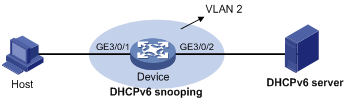

Dynamic IPv6 source guard by DHCPv6 snooping configuration example
Network requirements
As shown in Figure 6, the host (DHCPv6 client) and the DHCPv6 server are connected to the device through ports GigabitEthernet 3/0/1 and GigabitEthernet 3/0/2, respectively.
Enable DHCPv6 and DHCPv6 snooping on the device, so that the host can obtain an IP address through the DHCPv6 server and the IPv6 IP address and MAC address of the host can be recorded in a DHCPv6 snooping entry.
Enable IPv6 source guard function on the device’s port GigabitEthernet 3/0/1 to filter packets based on DHCPv6 snooping entries, allowing only packets from a client that obtains an IP address through DHCP server.
Figure 6 Network diagram
1.     Configure DHCPv6 snooping:
# Enable DHCPv6 snooping globally.
<Device> system-view
[Device] ipv6 dhcp snooping enable
# Enable DHCPv6 snooping in VLAN 2.
[Device] vlan 2
[Device-vlan2] ipv6 dhcp snooping vlan enable
[Device-vlan2] quit
# Configure the port connecting to the DHCP server as a trusted port.
[Device] interface GigabitEthernet 3/0/2
[Device-GigabitEthernet3/0/2] ipv6 dhcp snooping trust
[Device-GigabitEthernet3/0/2] quit
2.     Configure the IPv6 source guard function on GigabitEthernet 3/0/1 to filter packets based on both the source IP address and MAC address:
[Device] interface GigabitEthernet 3/0/1
[Device-GigabitEthernet3/0/1] ipv6 verify source ipv6-address mac-address
[Device-GigabitEthernet3/0/1] quit
# Display the dynamic IPv6 source guard entries generated on port GigabitEthernet 3/0/1.
[Device] display ipv6 source binding
Total entries found: 1
 040a-0000-0001      2001::1         2       GigabitEthernet3/0/1         DHCPv6-SNP
# Display all DHCPv6 snooping entries to see whether they are consistent with the dynamic IP source guard entries generated on GigabitEthernet 3/0/1.
[Device] display ipv6 dhcp snooping user-binding dynamic
IP Address                     MAC Address    Lease      VLAN Interface
2001::1                        040a-0000-0001 286        2    GigabitEthernet3/0/1
---   1 DHCPv6 snooping item(s) found   ---
The output shows that a dynamic IPv6 source guard entry has been generated on port GigabitEthernet 3/0/1 based on the DHCPv6 snooping entry.

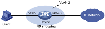

Dynamic IPv6 source guard by ND snooping configuration example
The client is connected to the device through port GigabitEthernet 3/0/1.
Enable ND snooping on the device, establishing ND snooping entries by listening to DAD NS messages.
Enable the IPv6 source guard function on port GigabitEthernet 3/0/1 to filter packets based on the ND snooping entries, allowing only packets with a legally obtained IPv6 address to pass.
Figure 7 Network diagram
1.     Enable ND snooping in VLAN 2:
[Device] vlan 2
[Device-vlan2] ipv6 nd snooping enable
[Device-vlan2] quit
# Display the IPv6 source guard entries generated on port GigabitEthernet 3/0/1.
 040a-0000-0001       2001::1           2      GigabitEthernet3/0/1         ND-SNP
# Display the IPv6 ND snooping entries to see whether they are consistent with the dynamic IP source guard entries generated on GigabitEthernet 3/0/1.
[Device] display ipv6 nd snooping
IPv6 Address              MAC Address     VID  Interface                  Aging Status
2001::1                      040a-0000-0001  2     GigabitEthernet3/0/1       25     Bound
---- Total entries: 1 ----
The output shows that a dynamic IPv6 source guard entry has generated on port GigabitEthernet 3/0/1 based on the ND snooping entry.
