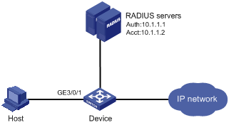

RADIUS-based MAC authentication configuration example
Network requirements
As shown in Figure 2, a host connects to port GigabitEthernet 3/0/1 on the access device. The device uses RADIUS servers for authentication, authorization, and accounting.
Perform MAC authentication on port GigabitEthernet 3/0/1 to control Internet access. Make sure that:
·     The device detects whether a user has gone offline every 180 seconds. If a user fails authentication, the device does not authenticate the user within 180 seconds.
·     All MAC authentication users belong to ISP domain 2000 and share the user account aaa with password 123456.
Figure 2 Network diagram
