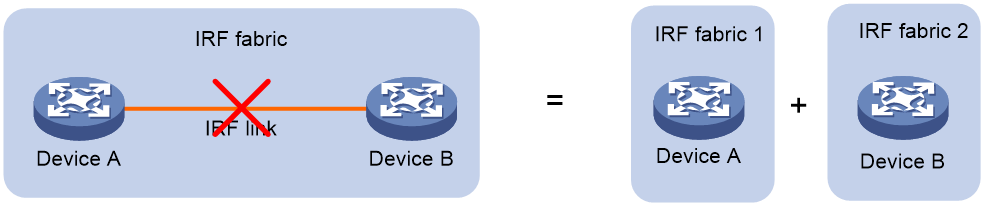

IRF split
IRF split occurs when an IRF fabric breaks up into multiple IRF fabrics because of IRF link failures, as shown in Figure 2. The split IRF fabrics operate with the same IP address. IRF split causes routing and forwarding problems on the network. To quickly detect a multi-active collision, configure a minimum of one MAD mechanism (see "Configuring MAD").
Figure 2 IRF split

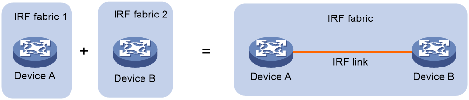

IRF merge
IRF merge occurs when two split IRF fabrics reunite or when two independent IRF fabrics are united, as shown in Figure 3.
Figure 3 IRF merge

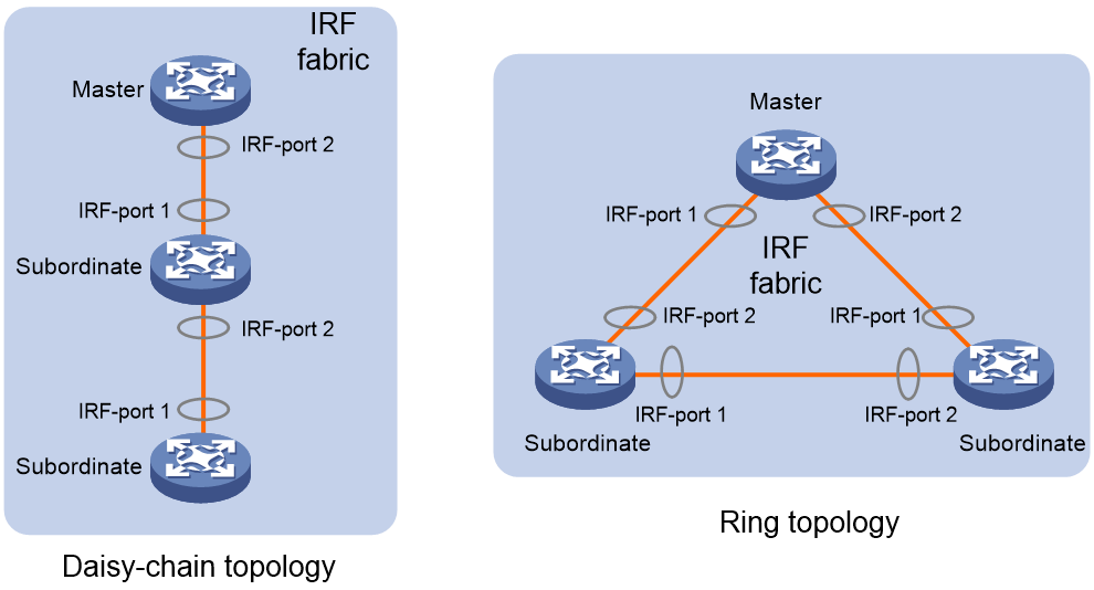

IRF network topology
An IRF fabric can use a daisy-chain or ring topology. As shown in Figure 5, a ring topology is more reliable. In ring topology, the failure of one IRF link does not cause the IRF fabric to split as in daisy-chain topology. Rather, the IRF fabric changes to a daisy-chain topology without interrupting network services.
Figure 5 Daisy-chain topology vs. ring topology

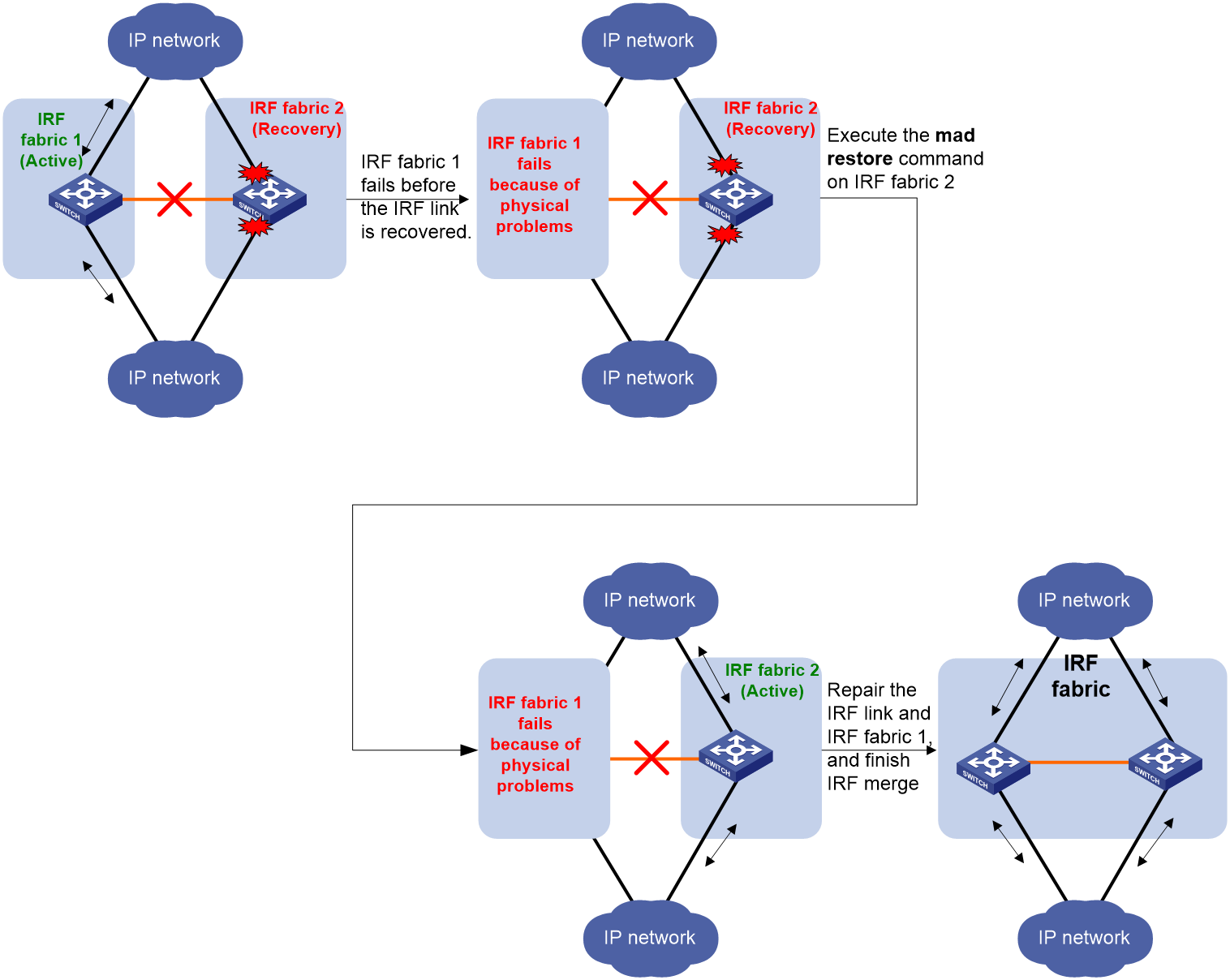

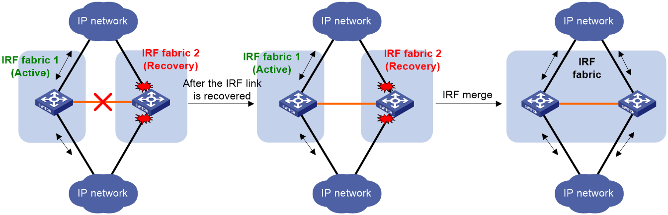

Failure recovery
To merge two split IRF fabrics, first repair the failed IRF link and remove the IRF link failure.
When the failed IRF link between two split IRF fabrics is recovered, all member devices in the inactive IRF fabric automatically reboot to join the active IRF fabric as subordinate members. The network interfaces that have been shut down by MAD automatically restore their original state, as shown in Figure 6.
Figure 6 Recovering the IRF fabric
If the active IRF fabric fails before the IRF link is recovered (see Figure 7), use the mad restore command on the inactive IRF fabric to recover the inactive IRF fabric. This command brings up all network interfaces that were shut down by MAD. After the IRF link is repaired, merge the two parts into a unified IRF fabric.
Figure 7 Active IRF fabric fails before the IRF link is recovered

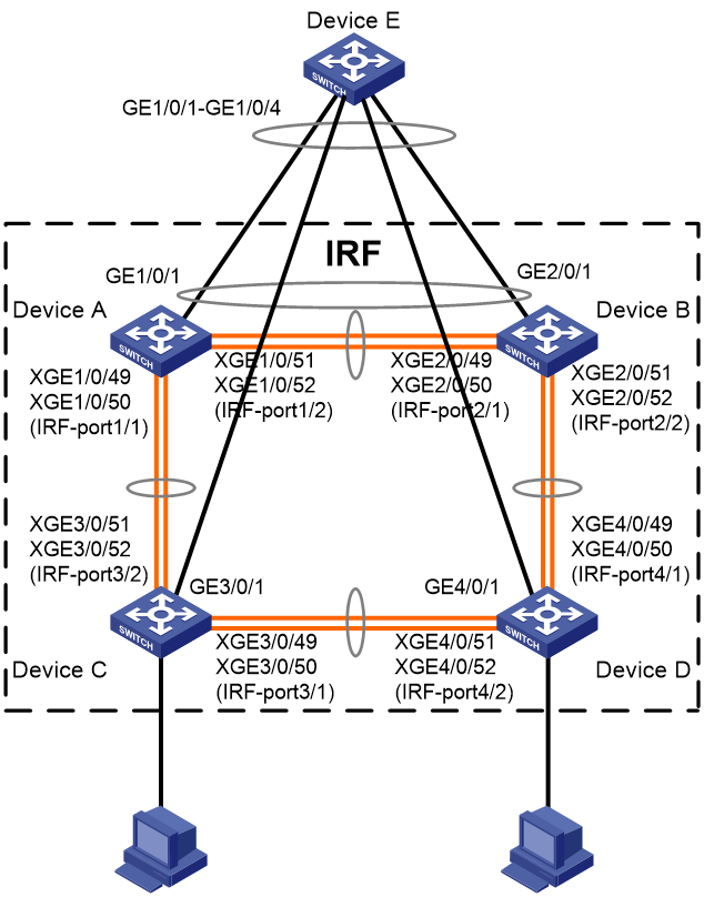

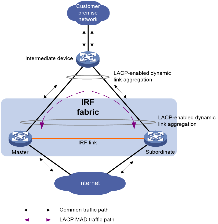

LACP MAD
As shown in Figure 8, LACP MAD has the following requirements:
·     Every IRF member must have a link with an intermediate device.
·     All the links form a dynamic link aggregation group.
·     The intermediate device must be a device that supports extended LACP for MAD.
The IRF member devices send extended LACPDUs that convey a domain ID and an active ID (the member ID of the master). The intermediate device transparently forwards the extended LACPDUs received from one member device to all the other member devices.
·     If the domain IDs and active IDs sent by all the member devices are the same, the IRF fabric is integrated.
·     If the extended LACPDUs convey the same domain ID but different active IDs, a split has occurred. LACP MAD handles this situation as described in "Collision handling."
Figure 8 LACP MAD scenario

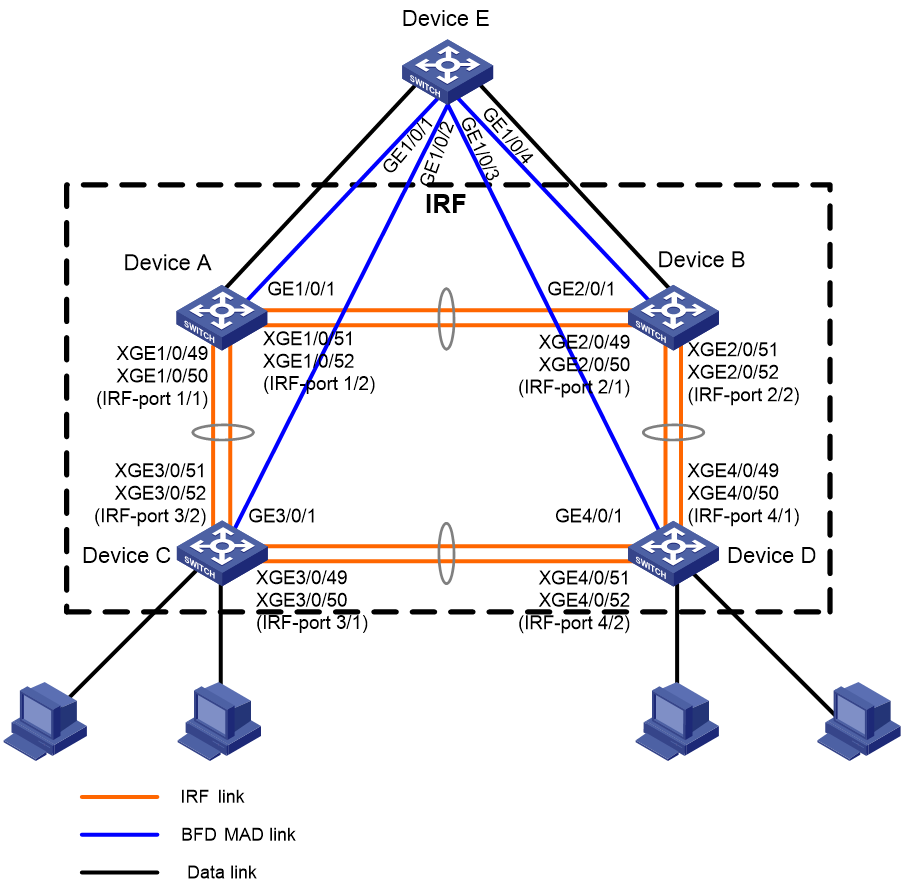

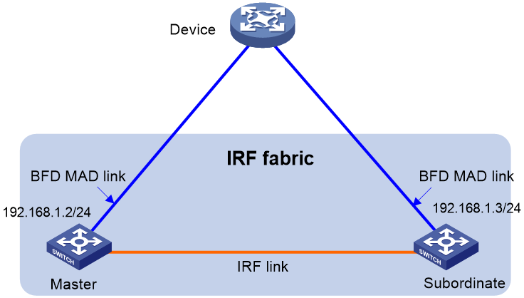

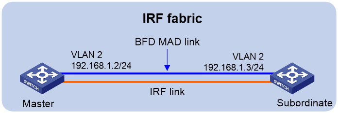

BFD MAD
BFD MAD detects multi-active collisions by using BFD.
You can use common or management Ethernet ports for BFD MAD.
If management Ethernet ports are used, BFD MAD has the following requirements:
·     Use an intermediate device and make sure each IRF member device has a BFD MAD link to the intermediate device.
·     Assign each member device a MAD IP address on the master's management Ethernet port.
If common Ethernet ports are used, BFD MAD has the following requirements:
·     If an intermediate device is used, each member device must have a BFD MAD link to the intermediate device. If no intermediate device is used, all member devices must have a BFD MAD link to each other.
·     Assign all ports on the BFD MAD links to the same VLAN or Layer 3 aggregate interface. Assign each member device a MAD IP address on the VLAN interface or Layer 3 aggregate interface.
When you use BFD MAD, follow these restrictions and guidelines:
·     As a best practice, use an intermediate device to connect IRF member devices if the IRF fabric has more than two member devices. A full mesh of IRF members might cause broadcast loops.
·     As a best practice, preferentially use management Ethernet ports for BFD MAD.
·     The BFD MAD links and BFD MAD VLAN (or Layer 3 aggregate interface) must be dedicated. Do not use the BFD MAD links or BFD MAD VLAN (or Layer 3 aggregate interface) for any other purposes.
·     When you use a Layer 3 aggregate interface for BFD MAD, make sure its member ports do not exceed the maximum number of Selected ports allowed for an aggregation group. If the number of member ports exceeds the maximum number of Selected ports, some member ports cannot become Selected. BFD MAD will be unable to work correctly and its state will change to Faulty. For more information about setting the maximum number of Selected ports for an aggregation group, see Ethernet link aggregation in Layer 2—LAN Switching Configuration Guide.
·     The MAD addresses identify the member devices and must belong to the same subnet.
·     Of all management Ethernet ports on an IRF fabric, only the master's management Ethernet port is accessible.
Figure 9 shows a typical BFD MAD scenario that uses an intermediate device. On the intermediate device, assign the ports on the BFD MAD links to the same VLAN.
Figure 10 shows a typical BFD MAD scenario that does not use an intermediate device.
With BFD MAD, the master attempts to establish BFD sessions with other member devices by using its MAD IP address as the source IP address.
·     If the IRF fabric is integrated, only the MAD IP address of the master takes effect. The master cannot establish a BFD session with any other member. If you execute the display bfd session command, the state of the BFD sessions is Down.
·     When the IRF fabric splits, the IP addresses of the masters in the split IRF fabrics take effect. The masters can establish a BFD session. If you execute the display bfd session command, the state of the BFD session between the two devices is Up.
Figure 9 BFD MAD scenario with an intermediate device
Figure 10 BFD MAD scenario without an intermediate device

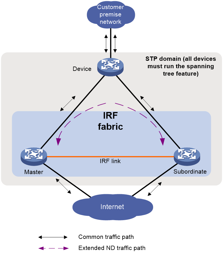

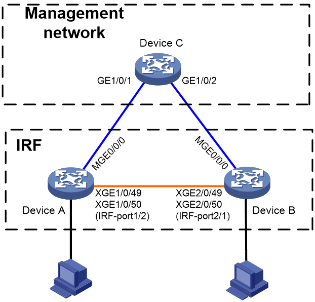

ARP MAD
ARP MAD detects multi-active collisions by using extended ARP packets that convey the IRF domain ID and the active ID.
You can use common or management Ethernet ports for ARP MAD.
If management Ethernet ports are used, ARP MAD must work with an intermediate device. Make sure the following requirements are met:
·     Connect a management Ethernet port on each member device to the intermediate device.
·     On the intermediate device, you must assign the ports used for ARP MAD to the same VLAN.
If common Ethernet ports are used, ARP MAD can work with or without an intermediate device. Make sure the following requirements are met:
·     If an intermediate device is used, connect each IRF member device to the intermediate device, as shown in Figure 11. Run the spanning tree feature between the IRF fabric and the intermediate device. In this situation, data links can be used.
·     If no intermediate device is used, connect each IRF member device to all other member devices. In this situation, IRF links cannot be used for ARP MAD.
Each IRF member compares the domain ID and the active ID (the member ID of the master) in incoming extended ARP packets with its domain ID and active ID.
·     If the domain IDs are different, the extended ARP packet is from a different IRF fabric. The device does not continue to process the packet with the MAD mechanism.
·     If the domain IDs are the same, the device compares the active IDs.
¡     If the active IDs are different, the IRF fabric has split.
¡     If the active IDs are the same, the IRF fabric is integrated.
Figure 11 ARP MAD scenario

IRF port connection
When you connect two neighboring IRF members, follow these restrictions and guidelines:
·     You must connect the physical interfaces of IRF-port 1 on one member to the physical interfaces of IRF-port 2 on the other.
·     For high availability, bind multiple physical interfaces to an IRF port. You can bind a maximum of four physical interfaces to an IRF port.
Figure 13 Connecting IRF physical interfaces

Configuring LACP MAD
2.     Assign a domain ID to the IRF fabric.
irf domain domain-id
The default IRF domain ID is 0.
CAUTION
CAUTION:
Changing the IRF domain ID of an IRF member device will remove that member device from the IRF fabric. This member device will be unable to exchange IRF protocol packets with the remaining member devices in the IRF fabric.
3.     Create an aggregate interface and enter aggregate interface view.
¡     Enter Layer 2 aggregate interface view.
¡     Enter Layer 3 aggregate interface view.
interface route-aggregation interface-number
Perform this step also on the intermediate device.
4.     Configure the aggregation group to operate in dynamic aggregation mode.
link-aggregation mode dynamic
By default, an aggregation group operates in static aggregation mode.
LACP MAD takes effect only on dynamic aggregate interfaces.
5.     Enable LACP MAD.
mad enable
By default, LACP MAD is disabled.
6.     Return to system view.
7.     Enter Ethernet interface view or interface range view.
¡     Enter Ethernet interface view.
¡     Enter interface range view. Choose one of the following commands:
interface range { interface-type interface-number [ to interface-type interface-number ] } &<1-24>
interface range name name [ interface { interface-type interface-number [ to interface-type interface-number ] } &<1-24> ]
To assign a range of ports to the aggregation group, enter interface range view.
To assign one port to the aggregation group, enter Ethernet interface view.
8.     Assign the Ethernet port or the range of Ethernet ports to the specified aggregation group.
port link-aggregation group group-id
Multichassis link aggregation is allowed.
Configuring BFD MAD
Restrictions and guidelines for configuring BFD MAD
As a best practice, use the following procedure to set up BFD MAD:
1.     Choose a BFD MAD link scheme as described in "BFD MAD."
2.     Configure BFD MAD.
3.     Connect the BFD MAD links.
When you configure BFD MAD on a VLAN interface, follow these restrictions and guidelines:
Category
BFD MAD VLAN
·     Do not enable BFD MAD on VLAN-interface 1.
·     If you are using an intermediate device, perform the following tasks:
¡     On the IRF fabric and the intermediate device, create a VLAN for BFD MAD.
¡     On the IRF fabric and the intermediate device, assign the ports of BFD MAD links to the BFD MAD VLAN.
¡     On the IRF fabric, create a VLAN interface for the BFD MAD VLAN.
·     Make sure the IRF fabrics on the network use different BFD MAD VLANs.
·     Make sure the BFD MAD VLAN contains only ports on the BFD MAD links. Exclude a port from the BFD MAD VLAN if that port is not on a BFD MAD link. If you have assigned that port to all VLANs by using the port trunk permit vlan all command, use the undo port trunk permit command to exclude that port from the BFD MAD VLAN.
·     When VSI interfaces exist on the S5560X-EI, S5500V2-EI, ES5500C, and MS4520V2 switch series, VLAN interfaces numbered in the range of 3581 to 4092 cannot be used for BFD MAD.
BFD MAD VLAN and feature compatibility
Do not use the BFD MAD VLAN and its member ports for any purpose other than configuring BFD MAD.
·     Use only the mad bfd enable and mad ip address commands on the BFD MAD-enabled VLAN interface. If you configure other features, both BFD MAD and other features on the interface might run incorrectly.
·     Disable the spanning tree feature on any Layer 2 Ethernet ports in the BFD MAD VLAN. The MAD feature is mutually exclusive with the spanning tree feature.
MAD IP address
·     To avoid network issues, only use the mad ip address command to configure IP addresses on the BFD MAD-enabled VLAN interface. Do not configure an IP address by using the ip address command or configure a VRRP virtual address on the BFD MAD-enabled VLAN interface.
·     Make sure all the MAD IP addresses are on the same subnet.
When you configure BFD MAD on a Layer 3 aggregate interface, follow these restrictions and guidelines:
Category
BFD MAD-enabled Layer 3 aggregate interface
·     Make sure the Layer 3 aggregate interface operates in static aggregation mode.
·     Make sure the member ports in the aggregation group do not exceed the maximum number of Selected ports allowed for an aggregation group. If the number of member ports exceeds the maximum number of Selected ports, some member ports cannot become Selected. BFD MAD will be unable to work correctly and its state will change to Faulty.
BFD MAD VLAN
If a switch is used as the intermediate device, use a VLAN as the BFD MAD VLAN on the intermediate device.
·     If the intermediate device acts as a BFD MAD intermediate device for multiple IRF fabrics, assign different BFD MAD VLANs to the IRF fabrics.
·     Assign the ports on the BFD MAD links for the same IRF fabric to the same VLAN. Do not assign the ports to an aggregate interface. If the ports are hybrid ports, make sure these ports are untagged members of their PVIDs.
·     Do not use the BFD MAD VLAN on the intermediate device for any purposes other than BFD MAD.
·     Make sure the BFD MAD VLAN on the intermediate device contains only ports on the BFD MAD links. Exclude a port from the BFD MAD VLAN if that port is not on a BFD MAD link. If you have assigned that port to all VLANs by using the port trunk permit vlan all command, use the undo port trunk permit command to exclude that port from the BFD MAD VLAN.
BFD MAD-enabled Layer 3 aggregate interface and feature compatibility
Use only the mad bfd enable and mad ip address commands on the BFD MAD-enabled interface. If you configure other features, both BFD MAD and other features on the interface might run incorrectly.
MAD IP address
·     To avoid network issues, only use the mad ip address command to configure IP addresses on the BFD MAD-enabled interface. Do not configure an IP address by using the ip address command or configure a VRRP virtual address on the BFD MAD-enabled interface.
When you configure BFD MAD on a management Ethernet port, follow these restrictions and guidelines:
Category
Management Ethernet ports for BFD MAD
Connect a management Ethernet port on each IRF member device to the common Ethernet ports on the intermediate device.
BFD MAD VLAN
·     On the intermediate device, create a VLAN for BFD MAD, and assign the ports used for BFD MAD to the VLAN. On the IRF fabric, you do not need to assign the management Ethernet ports to the VLAN.
MAD IP address
·     Use the mad ip address command instead of the ip address command to configure MAD IP addresses on the BFD MAD-enabled management Ethernet ports.
Configuring BFD MAD on a VLAN interface
9.     Enable BFD MAD.
mad bfd enable
By default, BFD MAD is disabled.
10.     Assign a MAD IP address to a member device on the Layer 3 aggregate interface.
mad ip address ip-address { mask | mask-length } member member-id
By default, no MAD IP addresses are configured on aggregate interfaces.
Repeat this step to assign a MAD IP address to each member device on the aggregate interface.
Configuring BFD MAD on a management Ethernet port
2.     (Optional.) Assign a domain ID to the IRF fabric.
By default, the domain ID of an IRF fabric is 0.
CAUTION
CAUTION:
3.     Enter management Ethernet interface view.
interface m-gigabitethernet interface-number
4.     Enable BFD MAD.
mad bfd enable
5.     Assign a MAD IP address to each member device.
By default, no MAD IP addresses are configured.

When you configure ARP MAD on a VLAN interface, follow these restrictions and guidelines:
Category
ARP MAD VLAN
·     Do not enable ARP MAD on VLAN-interface 1.
¡     On the IRF fabric and the intermediate device, create a VLAN for ARP MAD.
¡     On the IRF fabric and the intermediate device, assign the ports of ARP MAD links to the ARP MAD VLAN.
¡     On the IRF fabric, create a VLAN interface for the ARP MAD VLAN.
·     Do not use the ARP MAD VLAN for any other purposes.
ARP MAD and feature configuration
If an intermediate device is used, make sure the following requirements are met:
·     Run the spanning tree feature between the IRF fabric and the intermediate device to ensure that there is only one ARP MAD link in forwarding state. For more information about the spanning tree feature and its configuration, see Layer 2—LAN Switching Configuration Guide.
·     Enable the IRF fabric to change its bridge MAC address as soon as the address owner leaves.
·     If the intermediate device is also an IRF fabric, assign the two IRF fabrics different domain IDs for correct split detection.

·     If ARP MAD or ND MAD is used with the spanning tree feature, you must disable IRF bridge MAC persistence by using the undo irf mac-address persistent command. In addition, do not specify a MAC address as the IRF bridge MAC address.

Example: Configuring an IRF fabric with LACP MAD enabled on an aggregate interface
As shown in Figure 14, set up a four-chassis IRF fabric at the access layer of the enterprise network.
Configure LACP MAD on the multichassis aggregation to Device E, which supports extended LACP.
Figure 14 Network diagram
1.     Configure settings for IRF setup on Device A:
# Shut down the physical interfaces used for IRF links. In this example, the physical interfaces are shut down in batch. For more information, see Layer 2—LAN Switching Configuration Guide.
<Sysname> system-view
[Sysname] interface range ten-gigabitethernet 1/0/49 to ten-gigabitethernet 1/0/52
[Sysname-if-range] shutdown
[Sysname-if-range] quit
# Bind Ten-GigabitEthernet 1/0/49 and Ten-GigabitEthernet 1/0/50 to IRF-port 1/1.
[Sysname] irf-port 1/1
[Sysname-irf-port1/1] port group interface ten-gigabitethernet 1/0/49
[Sysname-irf-port1/1] port group interface ten-gigabitethernet 1/0/50
[Sysname-irf-port1/1] quit
# Bind Ten-GigabitEthernet 1/0/51 and Ten-GigabitEthernet 1/0/52 to IRF-port 1/2.
[Sysname] irf-port 1/2
[Sysname-irf-port1/2] port group interface ten-gigabitethernet 1/0/51
[Sysname-irf-port1/2] port group interface ten-gigabitethernet 1/0/52
[Sysname-irf-port1/2] quit
# Bring up the physical interfaces and save the configuration.
[Sysname-if-range] undo shutdown
[Sysname] save
# Activate the IRF port configuration.
[Sysname] irf-port-configuration active
2.     Configure settings for IRF setup on Device B:
# Change the member ID of Device B to 2 and reboot the device to have the change take effect.
[Sysname] irf member 1 renumber 2
Renumbering the member ID may result in configuration change or loss. Continue? [Y/N]:y
[Sysname] quit
<Sysname> reboot
# Connect Device B to Device A as shown in Figure 14, and log in to Device B. (Details not shown.)
# Shut down the physical interfaces for IRF links.
[Sysname] interface range ten-gigabitethernet 2/0/49 to ten-gigabitethernet 2/0/52
# Bind Ten-GigabitEthernet 2/0/49 and Ten-GigabitEthernet 2/0/50 to IRF-port 2/1.
[Sysname] irf-port 2/1
[Sysname-irf-port2/1] port group interface ten-gigabitethernet 2/0/49
[Sysname-irf-port2/1] port group interface ten-gigabitethernet 2/0/50
[Sysname-irf-port2/1] quit
# Bind Ten-GigabitEthernet 2/0/51 and Ten-GigabitEthernet 2/0/52 to IRF-port 2/2.
[Sysname] irf-port 2/2
[Sysname-irf-port2/2] port group interface ten-gigabitethernet 2/0/51
[Sysname-irf-port2/2] port group interface ten-gigabitethernet 2/0/52
[Sysname-irf-port2/2] quit
[Sysname] save
The two devices perform master election, and the one that has lost the election reboots to form an IRF fabric with the master.
3.     Configure settings for IRF setup on Device C:
# Change the member ID of Device C to 3 and reboot the device to have the change take effect.
[Sysname] irf member 1 renumber 3
[Sysname] quit
<Sysname> reboot
# Connect Device C to Device A as shown in Figure 14, and log in to Device C. (Details not shown.)
[Sysname] interface range ten-gigabitethernet 3/0/49 to ten-gigabitethernet 3/0/52
# Bind Ten-GigabitEthernet 3/0/49 and Ten-GigabitEthernet 3/0/50 to IRF-port 3/1.
[Sysname] irf-port 3/1
[Sysname-irf-port3/1] port group interface ten-gigabitethernet 3/0/49
[Sysname-irf-port3/1] port group interface ten-gigabitethernet 3/0/50
[Sysname-irf-port3/1] quit
# Bind Ten-GigabitEthernet 3/0/51 and Ten-GigabitEthernet 3/0/52 to IRF-port 3/2.
[Sysname] irf-port 3/2
[Sysname-irf-port3/2] port group interface ten-gigabitethernet 3/0/51
[Sysname-irf-port3/2] port group interface ten-gigabitethernet 3/0/52
[Sysname-irf-port3/2] quit
[Sysname] save
Device C reboots to join the IRF fabric.
4.     Configure settings for IRF setup on Device D:
# Change the member ID of Device D to 4 and reboot the device to have the change take effect.
[Sysname] irf member 1 renumber 4
[Sysname] quit
<Sysname> reboot
# Connect Device D to Device B and Device C as shown in Figure 14, and log in to Device D. (Details not shown.)
# Shut down the physical interfaces.
[Sysname] interface range ten-gigabitethernet 4/0/49 to ten-gigabitethernet 4/0/52
# Bind Ten-GigabitEthernet 4/0/49 and Ten-GigabitEthernet 4/0/50 to IRF-port 4/1.
[Sysname] irf-port 4/1
[Sysname-irf-port4/1] port group interface ten-gigabitethernet 4/0/49
[Sysname-irf-port4/1] port group interface ten-gigabitethernet 4/0/50
[Sysname-irf-port4/1] quit
# Bind Ten-GigabitEthernet 4/0/51 and Ten-GigabitEthernet 4/0/52 to IRF-port 4/2.
[Sysname] irf-port 4/2
[Sysname-irf-port4/2] port group interface ten-gigabitethernet 4/0/51
[Sysname-irf-port4/2] port group interface ten-gigabitethernet 4/0/52
[Sysname-irf-port4/2] quit
[Sysname] save
Device D reboots to join the IRF fabric. A four-chassis IRF fabric is formed.
5.     Configure LACP MAD on the IRF fabric:
# Set the domain ID of the IRF fabric to 1.
[Sysname] irf domain 1
# Create a dynamic aggregate interface and enable LACP MAD.
[Sysname] interface bridge-aggregation 2
[Sysname-Bridge-Aggregation2] link-aggregation mode dynamic
[Sysname-Bridge-Aggregation2] mad enable
You need to assign a domain ID (range: 0-4294967295)
[Current domain ID is: 1]:
The assigned domain ID is: 1
[Sysname-Bridge-Aggregation2] quit
# Assign GigabitEthernet 1/0/1, GigabitEthernet 2/0/1, GigabitEthernet 3/0/1, and GigabitEthernet 4/0/1 to the aggregate interface.
[Sysname] interface range gigabitethernet 1/0/1  gigabitethernet 2/0/1 gigabitethernet 3/0/1 gigabitethernet 4/0/1
[Sysname-if-range] port link-aggregation group 2
6.     Configure Device E as the intermediate device for LACP MAD:
CAUTION
CAUTION:
If the intermediate device is also an IRF fabric, assign the two IRF fabrics different domain IDs for correct split detection. False detection causes IRF split.
# Create a dynamic aggregate interface.
# Assign GigabitEthernet 1/0/1, GigabitEthernet 1/0/2, GigabitEthernet 1/0/3, and GigabitEthernet 1/0/4 to the aggregate interface.
[Sysname] interface range gigabitethernet 1/0/1 to gigabitethernet 1/0/4
Example: Configuring an IRF fabric with BFD MAD enabled on a VLAN interface
As shown in Figure 15, set up a four-chassis IRF fabric at the distribution layer of the enterprise network.
·     Configure BFD MAD on the IRF fabric and set up BFD MAD links between each member device and the intermediate device.

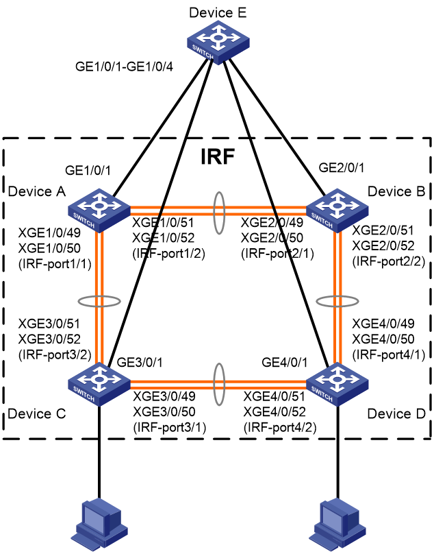

Figure 15 Network diagram

Figure 16 Network diagram

Example: Configuring an IRF fabric with ND MAD enabled on a VLAN interface
As shown in Figure 17, set up a four-chassis IRF fabric in the IPv6 enterprise network.
·     Configure ND MAD on the IRF fabric and use the links connected to Device E for transmitting ND MAD packets.
·     To prevent loops, run the spanning tree feature between Device E and the IRF fabric.
Figure 17 Network diagram

# Connect Device B to Device A, as shown in Figure 18.
Device A and Device B perform master election. The device that has failed master election automatically reboots to form an IRF fabric with the other device. A two-chassis IRF fabric is formed.
