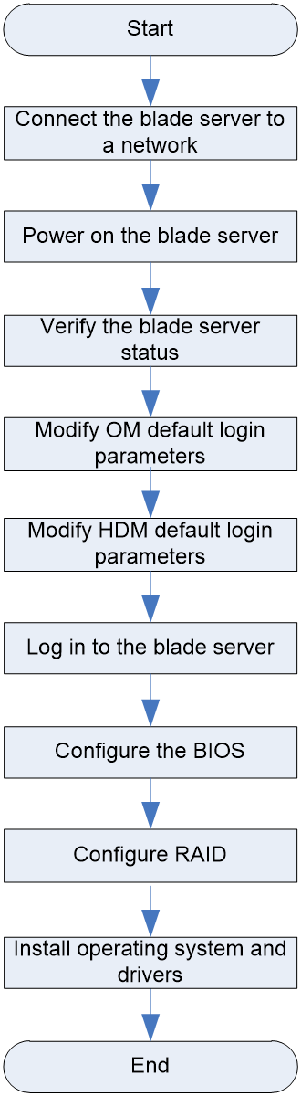

3SFF drive backplane (1SAS/SATA+2UniBay)
B/D/F information about the server
Component installation guidelines
Storage controller and its power fail safeguard module
Installing or removing the blade server
Powering on and powering off the blade server
Connecting the blade server to a network
Connecting through the management module
Verifying the blade server status
Modifying the default user password of OM
Modifying the default IP address of the OM module
Modifying the default user password of HDM
Modifying the default IP address of HDM
Logging into the blade server operating system
Configuring basic BIOS settings
Installing the operating system and hardware drivers

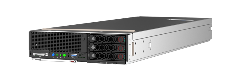

H3C UniServer B5700 G6 server (hereinafter referred to as the blade server) is an H3C-proprietary blade server with a maximum of two Eagle Stream Sapphire Rapids series processors. The server provides strong computing performance and flexible expansion capability. This blade server is designed for rich configurations and complex deployment scenarios, enabling flexible optimization of core IT applications to reduce TCO. The blade server can be installed in an H3C UniServer B16000 blade chassis (hereinafter referred to as the chassis) and managed through the OM module in a centralized way.
Figure 1 shows the appearance of the blade server.
Figure 1 Appearance of the blade server

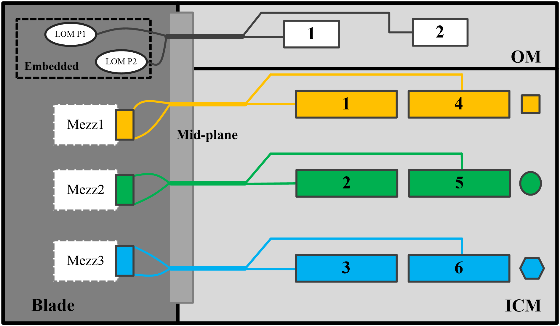

2 × embedded 1 Gb/s Ethernet interfaces, connected to chassis backplane for interconnection with the active and standby OM modules |

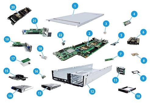

Components

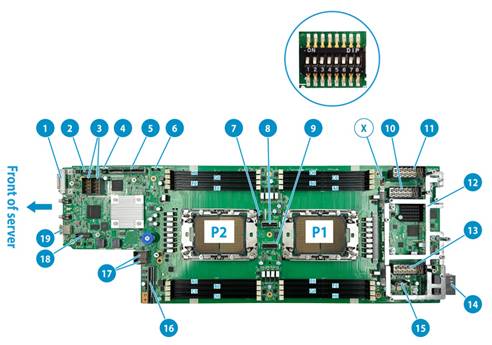

This section describes components of the blade server.
Figure 2 Components of the blade server
Table 3 Description of blade server components
Name |
Description |
1 |
Chassis cover |
2 |
System board |
One of the most important parts of a blade server, on which multiple components are installed, such as a processor, memory, and PCIe module. It is integrated with basic server components, including the BIOS chip, BMC chip, and PCIe connectors. |
3 |
System battery |
Powers the system clock to ensure a correct system date and time. |
4 |
Mezzanine module |
Refers to modules connected by the mezzanine connectors. Mezzanine modules communicate with the processor via the PCIe protocol. One of the mezzanine modules is the mezzanine network adapter, which is used to connect to the interconnect module (ICM) at the rear of the chassis to enable interaction between the blade server and the client. |
5 |
Straight-through card |
Connects the embedded VROC array controller soft RAID and SATA drives. |
6 |
processor heatsink |
Cools the processor. |
7 |
Memory |
Temporarily stores operational data in the processor and data exchanged with external storage devices such as drives. The product supports DDR5 memory modules with up to 4800 MHz frequency. |
8 |
Processor |
Integrates the memory controller and PCIe controller to provide powerful data processing capabilities for blade servers. |
9 |
Processor retaining bracket |
Attaches a processor to the heatsink. |
10 |
Drive filler panel |
Ensures adequate cooling of the blade server. Install a filler panel when no drive is installed on the blade server. |
11 |
Drive backplane |
Powers the drive and provides a data transfer channel. |
12 |
Blade server chassis |
Centralizes blade server parts and components. |
13 |
Drive |
Provides data storage media for blade servers, and supports hot swapping. The product supports SSD and HDD drives and various drive interface types, including SAS, SATA, and M.2. |
14 |
SATA M.2 SSD adapter module |
Expands two SATA M.2 SSD modules, and supports hot swapping. |
15 |
Storage controller |
Provides RAID support for SAS/SATA drives, and supports RAID expansion, RAID configuration memory, online upgrade and remote setup. |
16 |
Encryption module (TCM/TPM module) |
Provides encryption services for servers to improve server data security. |
17 |
Embedded M.2 SSD convert board |
Provides slots for expanding two SATA M.2 SSD modules. |
18 |
Supercapacitor |
Powers the Flash card integrated or installed on the memory controller in case of unexpected system power failure, to achieve power failure protection for data on the memory controller. |
19 |
Riser card 1 |
Standard PCIe cards are installed to the blade server through the riser card. Riser card 1 is installed at the node left. |
20 |
Air duct |
Provides cooling ducts inside the blade server. |
21 |
Riser card 2 |
Standard PCIe cards are installed to the blade server through the riser card. Riser card 2 is installed at the node right. |
22 |
NVMe VROC module |
Activates the NVMe drive array feature based on the VMD technology. |

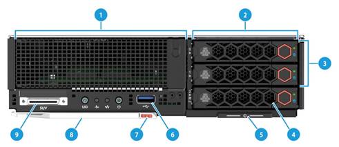

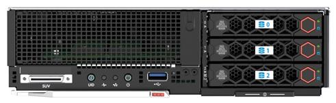

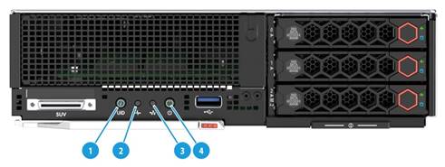

Front panel
This section introduces the components, LEDs, and interfaces on the front panel.
Front panel components
Figure 3 Front panel of the blade server
Table 4 Description of front panel components
Description |
1 |
Optional riser card 1 (for processor 2) |
2 |
Optional riser card 2 (for processor 1) |
3 |
Optional SAS/SATA drive or NVMe drive |
4 |
Optional SAS/SATA drive or SATA M.2 SSD module (via the adapter module) |
5 |
Pull-out asset label |
6 |
USB 3.0 port |
7 |
Buttons for releasing the locking levers |
8 |
Locking levers |
9 |
SUV connector |
USB 3.0 ports can be used to connect the USB flash drive, USB keyboard or mouse, USB optical drive (for OS installation). |
LEDs and buttons
Figure 4 Front panel LEDs and buttons
SN |
Description |
Status |
1 |
UID button/LED |
· Steady blue—UID LED is activated. The UID LED can be activated by using the following methods: ¡ Press the UID button LED. ¡ Activate the UID LED from HDM or OM. · Flashing blue: ¡ 1 Hz—The upgrade is being upgraded or the system is being managed from HDM. Do not power off the server. ¡ 4 Hz—HDM is restarting. To restart HDM, press the UID button LED for ten seconds. · Off—UID LED is not activated. |
2 |
Health LED |
· Steady green—The system is operating correctly. · Flashing green (4 Hz)—HDM is initializing. · Flashing amber (0.5 Hz)—A predictive alarm is present. · Flashing amber (1 Hz)—A minor alarm is present. · Flashing red (1 Hz)—A critical alarm is present. |
3 |
Embedded GE network adapter LED |
· Steady green—A link is present on the port. · Flashing green—The port is receiving or sending data. · Off—No link is present on the port. |
4 |
Power off/standby button and system power LED |
· Steady green—The system has started. · Flashing green (1 Hz)—The system is starting. · Steady amber—The system is standby. · Off—No power is present. |
· When the Health LED shows that the system is faulty, check the system operating state on HDM. ¡ No power supplies are present. ¡ The installed power supplies are faulty. ¡ The chassis is not powered. |
SUV cable
The SUV cable connects to the SUV connector on the front panel of the blade server. The SUV cable allows for the expansion of two USB 2.0 ports, one serial port and one VGA port for the blade server.
Figure 5 SUV cable
Table 6 SUV cable description
Item |
Description |
Application |
1 |
Serial port |
Diagnoses faults and debugs devices. |
2 |
VGA connector |
Connects terminal displays such as monitors or KVM devices |
3 |
2 × USB 2.0 connectors |
The extended USB 2.0 connectors and USB 3.0 connector that comes with the default configuration are all available for the following USB devices: · USB drives · USB keyboards or mouses. · USB optical drives for installing operating systems. |
Serial asset label pull tab
The serial label pull tab is on the front panel, as shown in "Front panel components." It provides the following information about the blade server:
· Product QR code. Users can scan the QR code to access the product document center, and view documents for the blade server.
· HDM default information.
· Product serial number.
· Server model.
System board
System board layout
Table 7 Layout description
Description |
1 |
SUV connector |
2 |
XDP connector |
3 |
Storage controller connector |
4 |
Power connector for PCIe riser card 1 |
5 |
PCIe connector for riser card 1 (for processor 2) |
6 |
NVMe VROC module connector |
7 |
Power connector for PCIe riser card 2 |
8 |
PCIe connector 1 for riser card 2 (for processor 1) |
9 |
PCIe connector 2 for riser card 2 (for processor 1) |
10 |
Mezzanine module connector 2 (for processor 2, ICM 2/5) |
11 |
Mezzanine module connector 3 (slave processor 1, ICM 2/6) |
12 |
Mezzanine module supporting bracket |
13 |
Mezzanine module connector 1 (for processor 1, ICM 1/4) |
14 |
Backplane power connector |
15 |
System battery |
16 |
E1.S drive backplane connector |
17 |
Drive backplane connector |
18 |
TPM/TCM connector |
19 |
USB connector |
X |
System maintenance switch |

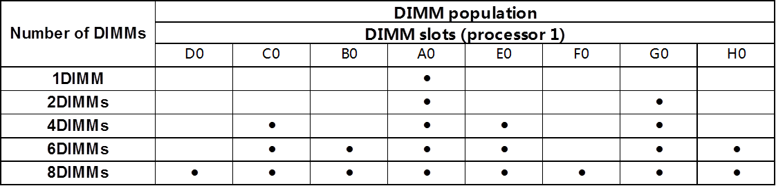

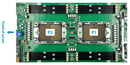

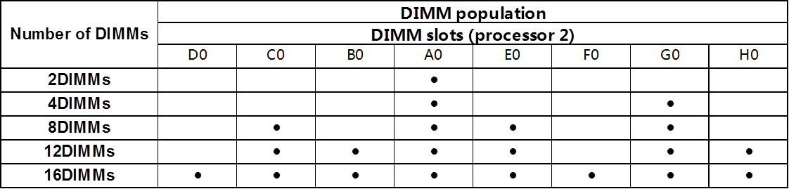

DIMM slots
The DIMM slot layout is shown in Figure 7. A0, B0 ......G0, H0 indicate the DIMM slot number. See "DIMMs" for specific installation guidelines for DIMMs.

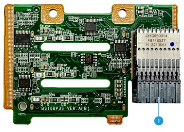

The 3SFF drive backplane is installed on the front of the chassis and supports up to three 2.5-inch drives, including one SAS/SATA drive and two SAS/SATA/NVMe drives.
Figure 12 3SFF drive backplane
Table 13 3SFF drive backplane component
SN |
Description |
Silkscreen |
1 |
Data, AUX and power 3-in-1 connector |

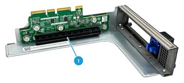

RC-LP-B5700G6
Figure 13 RC-LP-B5700G6
Table 14 Connectors on the RC-1FHHL-2U-G6 riser card
No. |
Description |
1 |
PCIe5.0 x16 (8, 4, 2, 1) |

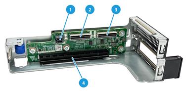

RC-LP-SlimSAS-B5700G6
Figure 14 RC-LP-SlimSAS-B5700G6
Figure 15 Connectors on the RC-1FHHL-2U-G6 riser card
No. |
Description |
1 |
Power connector |
2 |
MCIO x8 connector |
3 |
MCIO x8 connector |
4 |
PCIe5.0 x16 (16, 8, 4, 2, 1): · PCIe5.0: Fifth-generation signal rate. · x16: Connector width. · (16, 8, 4, 2, 1): Compatible bus bandwidth, including x16, x8, x4, x2, and x1. |
Internal networking
The blade server accesses the network through an interconnection module. The interconnection module provides the internal interconnection with blade servers through the infix backplane, and provides uplink interconnection interfaces for blade servers through the panel interfaces. The chassis may contain up to 6 interconnection modules. Among them, the interconnection modules in slots 1 and 4, 2 and 5, and 3 and 6 are interconnected through the internal ports of the chassis to form three pairs. Each pair can be used as a switching plane. You may configure them as active or standby based on service needs.
Internal wiring method of the blade server chassis is shown in Figure 16. Where:
· The onboard network adapter is connected to the active and standby OM modules.
· Mezzanine module 1 is connected to interconnect modules in slot 1 and slot 4.
· Mezzanine module 2 is connected to interconnect modules in slot 2 and slot 5.
· Mezzanine module 3 is connected to interconnect modules in slot 3 and slot 6.
Figure 16 Internal wiring method of the blade server chassis

· The blade server supports installing a maximum of three mezzanine network adapters.
· When installing the mezzanine network adapter, make sure the corresponding processor is present. See "PCIe connector" for the specific relations.
· The mezzanine network adapter and the interconnect module are interconnected through the chassis backplane. There is a slot correspondence between them. When installing the mezzanine network adapter, ensure that the interconnect module in the corresponding slot is present. See "Internal networking" for the specific relations.

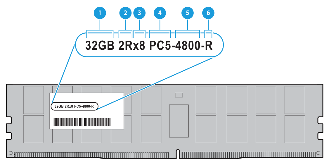

DIMM specifications can be identified by the label on it. The memory labels across different DDR generations have similar meanings. This section uses DDR5 memory as an example to explain the significance of each character in the label.
Figure 17 DIMM identification
Table 20 Description of DIMM identification
SN |
Description |
Definition |
1 |
Capacity |
· 8 GB · 16 GB · 32 GB |
2 |
Number of ranks |
· 1R = The number of ranks is 1. · 2R = The number of ranks is 2. · 4R = The number of ranks is 4. · 8R = The number of ranks is 8. |
3 |
Data width |
· x4 = 4-bit · x8 = 8-bit |
4 |
DIMM generation |
DDR5 |
5 |
DIMM equivalent speed |
· 2666V: 2666 MHz · 2933Y: 2933 MHz · 3200AA: 3200MHz · 4800: 4800MHz |
6 |
DIMM type |
· R = RDIMM · L = LRDIMM |
DIMM mode
The blade server supports the following DIMM modes to protect the data in the DIMM.
NOTE: Independent Mode is the default mode and is not available on the BIOS interface. |

DIMM installation guidelines
The blade server supports 1 or 2 processors, each processor supports 8 channels, and each channel supports 1 DIMM, that is, one processor supports 8 DIMMs and 2 processors support 16 DIMMs. The server supports only DDR5.
NOTE: The operating frequency of the DIMM can be up to 4800 MHz only when both of the following conditions are met: · Use a processor with a maximum DIMM frequency of 4800 MHz. · Use a DIMM with a maximum frequency of 4800 MHz. |

Guidelines for installing only DDR5 DIMMs
· Make sure the corresponding processor is installed.
· As a best practice, use DDR5 DIMMs of the same specifications (type, capacity, ranks, data width, and rate) on the same server. For DIMM specifications, use the server compatibility lookup tool at http://www.h3c.com/en/home/qr/default.htm?id=66. To expand the memory capacity or replace with DIMMs of different specifications, contact Technical Support.
· In addition to the above guidelines, different DIMM modes have their own specific guidelines, as described in Table 22. Note that when the actual DIMM installation does not meet these specific guidelines, the system will use the default Independent mode regardless of the DIMM mode configured by the user.
Table 22 Specific installation guidelines for different DIMM modes
Memory mode |
DIMM population requirements |
Independent Mode (default) |
· Strictly follow the DIMM population schemes: · If one processor is present, see Figure 18. · If two processors are present, see Figure 19 and Figure 20. |
Mirror Mode |
· A minimum of two DIMMs for a processor. · This mode does not support DIMM population schemes that are not recommended. ¡ If one processor is present, see Figure 18. ¡ If two processors are present, see Figure 19 and Figure 20. |
Figure 18 1-processor DIMM configuration guidelines
Figure 19 2-processor DIMM configuration guidelines (1)
Figure 20 2-processor DIMM configuration guidelines (2)
Processor
Guidelines
You can install one or two processors.
· To avoid damage to a processor or the system board, only H3C authorized or professional server engineers can install, replace, or remove a processor.
· Make sure the processors on the server are the same model.
· A processor model is suffixed with U, indicating the CP supports single-socket operation only. Use "Meaning of processor product model suffix" to identify processor model suffixes.
· Processors of the same model support two types of heatsinks: one with sparse fins and one with dense fins. Heatsinks with sparse fins labeled with Front must be installed on processor 2 and the heatsinks with dense fins labeled with Rear must be installed on processor 1. For more information about the position of processors, see "System board layout."
· For the server to operate correctly, make sure processor 1 is in position. For more information about processor locations, see "System board layout."
· The pins in the processor sockets are very fragile and prone to damage. Install a protective cover if a processor socket is empty.
· To prevent static electricity from damaging the electronic components, wear an ESD wrist strap before operation and ground the other end of the ESD wrist strap.

Configuring the blade server
The following information describes the procedures to configure the server after the server installation is complete.
Configuration flowchart
Figure 21 Configuration flowchart

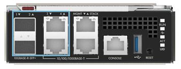

Use either of the following methods to connect the blade server to the network through the management module:
· Connect the network cable to one of the four service ports on the management module.
Figure 22 Service ports on the management module
· The management module provides a management port (MGMT) to which a network cable is connected. Thought this port, you can log in to the chassis OM and the HDM of the blade server to monitor the operating status of the chassis and the blade server and set basic information.
Connecting through ICMs
The mezzanine network adapter on each blade server has a corresponding ICM. To connect a blade server to the network through an ICM, make sure the corresponding ICM are present. For more information about mezzanine network adapter and ICM mapping relations, see "Internal networking."
1. After powering on the server, perform the following tasks to make sure that the server is working correctly. Power on the blade server. For more information, see "Powering on the blade server."
· Verify that the state of the four LEDs on the front panel of the blade server are as expected. For more information about the LEDs, see "LEDs and buttons."

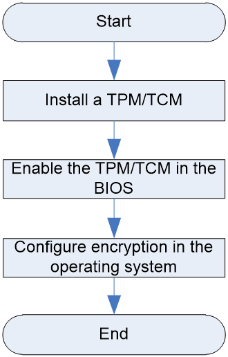

Installation and setup flowchart
Figure 23 TCM/TPM installation and setup flowchart

Removing a drive backplane
1. Remove the drives attached to the backplane.
2. Remove the access panel. Press the unlock button on the access panel, slide the panel to the serve rear, and lift the access panel.
3. Remove the drive backplane. Hold the handle on the backplane to lift the backplane up.
Installing a drive backplane
1. Install a drive backplane. Align both sides of the drive backplane with the two guide slots on the drive frame to insert the drive backplane downward.
2. Install the access panel. Align the standouts on the access panel with the notches in the chassis side panels, place the panel onto the chassis, and slide the access panel to the server front until it is secured into place.
3. Install the removed drives.
4. Install the blade server. Power on the blade server. For more information, see "Powering on the blade server."
