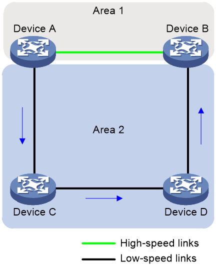

In practice, these requirements might not be met due to lack of physical links. OSPF virtual links can solve this issue.

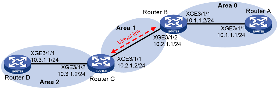

Virtual links
A virtual link is established between two ABRs through a non-backbone area. It must be configured on both ABRs to take effect. The non-backbone area is called a transit area.
As shown in Figure 2, Area 2 has no direct physical link to the backbone Area 0. You can configure a virtual link between the two ABRs to connect Area 2 to the backbone area.
Figure 2 Virtual link application 1
Virtual links can also be used as redundant links. If a physical link failure breaks the internal connectivity of the backbone area, you can configure a virtual link to replace the failed physical link, as shown in Figure 3.
Figure 3 Virtual link application 2
The virtual link between the two ABRs acts as a point-to-point connection. You can configure interface parameters, such as hello interval, on the virtual link as they are configured on a physical interface.
The two ABRs on the virtual link unicast OSPF packets to each other, and the OSPF routers in between convey these OSPF packets as normal IP packets.

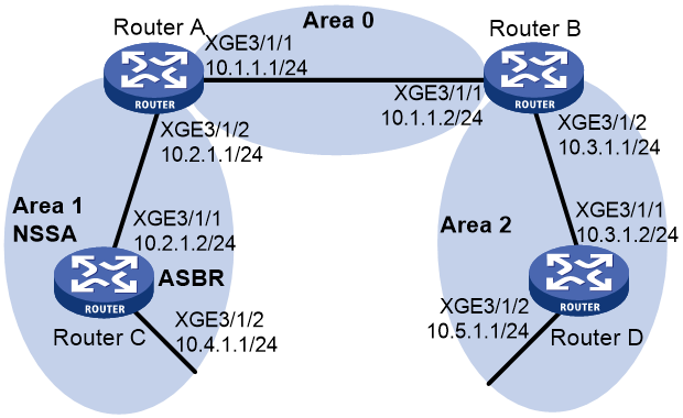

NSSA area and totally NSSA area
An NSSA area does not import AS external LSAs (Type-5 LSAs) but can import Type-7 LSAs generated by the NSSA ASBR. The NSSA ABR translates Type-7 LSAs into Type-5 LSAs and advertises the Type-5 LSAs to other areas.
As shown in Figure 4, the OSPF AS contains Area 1, Area 2, and Area 0. The other two ASs run RIP. Area 1 is an NSSA area where the ASBR redistributes RIP routes in Type-7 LSAs into Area 1. Upon receiving the Type-7 LSAs, the NSSA ABR translates them to Type-5 LSAs, and advertises the Type-5 LSAs to Area 0.
The ASBR of Area 2 redistributes RIP routes in Type-5 LSAs into the OSPF routing domain. However, Area 1 does not receive Type-5 LSAs because it is an NSSA area.

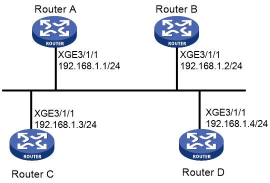

As shown in Figure 6, solid lines are Ethernet physical links, and dashed lines represent OSPF adjacencies. With the DR and BDR, only seven adjacencies are established.
Figure 6 DR and BDR in a network
NOTE: In OSPF, neighbor and adjacency are different concepts. After startup, OSPF sends a hello packet on each OSPF interface. A receiving router checks parameters in the packet. If the parameters match its own, the receiving router considers the sending router an OSPF neighbor. Two OSPF neighbors establish an adjacency relationship after they synchronize their LSDBs through exchange of DD packets and LSAs. |
DR and BDR election
DR election is performed on broadcast or NBMA networks but not on P2P and P2MP networks.
Routers in a broadcast or NBMA network elect the DR and BDR by router priority and ID. Routers with a router priority value higher than 0 are candidates for DR and BDR election.
The election votes are hello packets. Each router sends the DR elected by itself in a hello packet to all the other routers. If two routers on the network declare themselves as the DR, the router with the higher router priority wins. If router priorities are the same, the router with the higher router ID wins.
If a router with a higher router priority becomes active after DR and BDR election, the router cannot replace the DR or BDR until a new election is performed. Therefore, the DR of a network might not be the router with the highest priority, and the BDR might not be the router with the second highest priority.

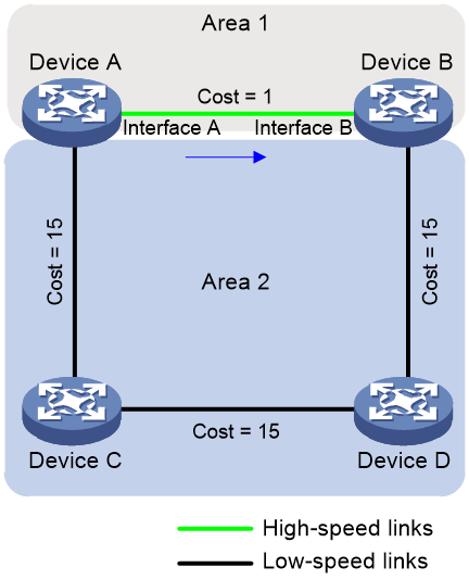

OSPF multi-area adjacency
According to OSPF protocols, intra-area paths have higher priority than inter-area paths. Assume an area contains a high-speed link. Devices in other areas cannot use it for data transmission, because the interface belongs to only one area. To address this issue, you can configure multiple subinterfaces and enable them in different areas. However, this method requires assigning a unique IP address to each subinterface, which increases the total number of routes released by the device.
OSPF multi-area adjacency can enable an OSPF interface into multiple areas, allowing a single path to be shared among multiple areas.
Multi-area adjacency interfaces
You can use the network command or the ospf area command to enable an OSPF interface as the primary interface. Then, use the ospf multi-area command to add more areas to the primary interface. The additional OSPF logical interfaces are multi-area adjacency interfaces.
Multi-area adjacency provides the following features:
· Multi-area adjacency interfaces and the primary interface belong to different OSPF areas.
· The network type for multi-area adjacency interfaces must be P2P, and they run independent OSPF interface state machines and OSPF neighbor state machines.
· Multi-area adjacency interfaces and the primary interface have the same interface type and number, sharing the same packet transmission channel. You can identify whether a packet is sent from a multi-area adjacency interface based on the area ID in the OSPF packet header and the configuration.
Operating mechanism
As shown in Figure 9, only the link between Device A and Device B in Area 1 is a high-speed link. Before the OSPF multi-area adjacency feature is enabled, the traffic forwarding path from Device A to Device B in Area 2 is Device A -> Device C -> Device D -> Device B. To use the traffic forwarding path Device A -> Device B, enable the OSPF multi-area adjacency feature.
Figure 9 OSPF multi-area adjacency disabled
As shown in Figure 10, create multi-area adjacency interfaces on primary interfaces Interface A and Interface B on Device A and Device B, respectively. The multi-area adjacency interfaces belong to Area 2. Then, establish neighbor relationship between the multi-area adjacency interfaces on Device A and Device B. When Device A calculates routes to Device B, it finds that the link cost between the multi-area adjacency interfaces in Area 2 is the lowest. Therefore, the traffic forwarding path from Device A to Device B in Area 2 is determined as Device A -> Device B, achieving the goal of sharing a path across multiple areas.
Figure 10 OSPF multi-area adjacency enabled

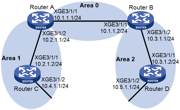

Configuring OSPF areas
About OSPF area configuration
This task allows you to configure an OSPF area as a stub area or NSSA area. It also allows you to create a virtual link if no connectivity can be achieved between a non-backbone area and backbone area, or in the backbone area.

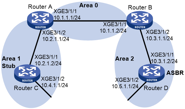

Configuring a stub area
You can configure a non-backbone area at an AS edge as a stub area. To do so, execute the stub command on all routers attached to the area. The routing table size is reduced because Type-5 LSAs will not be flooded within the stub area. The ABR generates a default route into the stub area so all packets destined outside of the AS are sent through the default route.
To further reduce the routing table size and routing information exchanged in the stub area, configure a totally stub area by using the stub no-summary command on the ABR. AS external routes and inter-area routes will not be distributed into the area. All the packets destined for outside of the AS or area will be sent to the ABR for forwarding.
A stub or totally stub area cannot have an ASBR because external routes cannot be distributed into the area.
Do not configure the backbone area as a stub area or totally stub area.
To configure an area as a stub area, execute the stub command on all routers attached to the area.
To configure an area as a totally stub area, execute the stub command on all routers attached to the area, and execute the stub no-summary command on the ABR.
Procedure (OSPF area view)
1. Enter system view.
2. Enter OSPF view.
ospf [ process-id | router-id { auto-select | router-id } | vpn-instance vpn-instance-name ] *
3. Enter area view.
area area-id
4. Configure the area as a stub area.
stub [ default-route-advertise-always | no-summary ] *
By default, no stub area is configured.
5. (Optional.) Set a cost for the default route advertised to the stub area.
default-cost cost-value
By default, the cost is 1 for the default route advertised to the stub area.
This command takes effect only on the ABR of a stub area or totally stub area.
Configuring an NSSA area
A stub area cannot import external routes, but an NSSA area can import external routes into the OSPF routing domain while retaining other stub area characteristics.
To configure an area as a totally NSSA area, use the nssa no-summary command. The ABR of the area does not advertise inter-area routes into the area.
Do not configure the backbone area as an NSSA area or totally NSSA area.
To configure an NSSA area, configure the nssa command on all the routers attached to the area.
To configure a totally NSSA area, configure the nssa command on all the routers attached to the area and configure the nssa no-summary command on the ABR.
2. Enter OSPF view.
3. Enter area view.
area area-id
4. Configure the area as an NSSA area.
nssa [ default-route-advertise [ cost cost-value | nssa-only | route-policy route-policy-name | type type ] * | no-import-route | no-summary | suppress-fa | [ [ [ translate-always ] [ translate-ignore-checking-backbone ] ] | translate-never ] | translator-stability-interval value ] *
By default, no area is configured as an NSSA area.
5. (Optional.) Set a cost for the default route advertised to the NSSA area.
By default, the cost is 1 for the default route advertised to the NSSA area.
This command takes effect only on the ABR/ASBR on an NSSA area or totally NSSA area.
Configuring a virtual link
You can configure a virtual link to maintain connectivity between a non-backbone area and the backbone, or in the backbone itself.
A virtual link cannot traverse a stub area, totally stub area, NSSA area, or totally NSSA area.
2. Enter OSPF view.
3. Enter OSPF area view.
area area-id
4. Configure a virtual link.
vlink-peer router-id [ dead seconds | hello seconds | { { hmac-md5 | hmac-sha-256 | md5 } key-id { cipher | plain } string | keychain keychain-name | simple { cipher | plain } string } | retransmit seconds | trans-delay seconds ] *
Configure this command on both ends of a virtual link. The hello and dead intervals must be identical on both ends of the virtual link.
This command is available only in OSPF area view.

Changing the link cost of a Layer 3 aggregate interface when its bandwidth falls below the threshold
When a member port of a Layer 3 aggregate interface goes down, the bandwidth of the aggregate interface decreases and services might be interrupted. To resolve this issue, perform this task to change the link cost of a Layer 3 aggregate interface as follows:
· When the bandwidth of the Layer 3 aggregate interface falls below the specified threshold, the aggregate interface uses the specified link cost. Make sure the link cost you specified is larger than the original link cost, so that OSPF can select an optimal path for traffic forwarding.
· When the bandwidth of the Layer 3 aggregate interface is equal to or larger than the bandwidth threshold, the aggregate interface uses the original link cost.
For more information about OSPF link cost, see "Setting an OSPF cost for an interface."
This feature applies to only Layer 3 aggregate interfaces and Layer 3 aggregate subinterfaces.
2. Enter interface view.
3. Change the link cost of the interface to the specified value when the bandwidth of the interface falls below the specified threshold.
ospf cost-fallback cost-value threshold bandwidth-value [ instance instance-id ]
By default, an aggregate interface uses the original link cost.

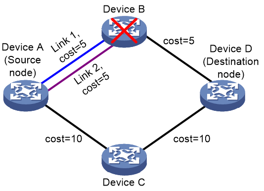

Enabling OSPF to advertise the maximum link cost to neighbors
On an OSPF network, when a link recovers from failures or the state of an interface changes, OSPF will re-establish neighbor relationships and perform route convergence. During the route convergence process, routing loops and traffic loss might occur because the convergence speeds of the nodes are different. To address this issue, enable OSPF to advertise the maximum link cost to neighbors within the specified period of time, so the traffic forwarding path remains unchanged. After the specified period of time, OSPF advertises the original link cost to neighbors and performs optimal route selection again.
3. Enable OSPF to advertise the maximum link cost to neighbors within the specified period of time.
ospf peer hold-max-cost duration time
By default, OSPF advertises the original link cost to neighbors during route convergence.

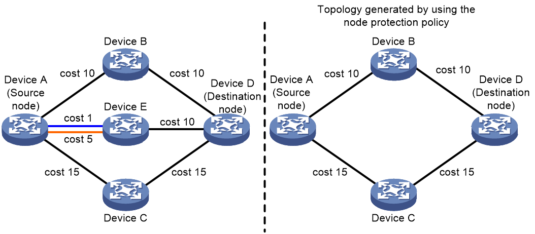

OSPF might find multiple optimal equal-cost routes to the same destination, which can be used to share the traffic load. This task allows you to set the maximum number of ECMP routes for OSPF.
As shown in Figure 11, Device A and Device B run OSPF. There are three equal-cost routes between Device A and Device B. You can use these routes to implement load sharing.
2. Enter OSPF view.
3. Set the maximum number of ECMP routes.
maximum load-balancing number
By default, the maximum number of OSPF ECMP routes is 64.

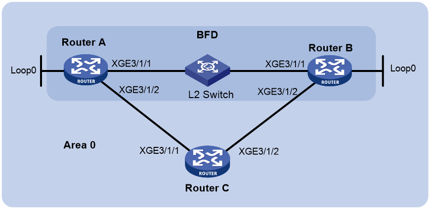

Configuring OSPF PIC
Prefix Independent Convergence (PIC) enables the device to speed up network convergence by ignoring the number of prefixes.
Restrictions and guidelines for OSPF PIC
When both OSPF PIC and OSPF FRR are configured, OSPF FRR takes effect.
OSPF PIC applies only to inter-area routes and external routes.
Enabling OSPF PIC
2. Enter OSPF view.
3. Enable PIC for OSPF.
pic [ additional-path-always ]
By default, OSPF PIC is disabled.
Configuring BFD control packet mode for OSPF PIC
3. Enable BFD control packet mode for OSPF PIC.
ospf primary-path-detect bfd ctrl
By default, BFD control packet mode is disabled for OSPF PIC.
This mode requires BFD configuration on both OSPF routers on the link.
Configuring BFD echo packet mode for OSPF PIC
2. (Optional.) Configure the source IP address of BFD echo packets.
bfd echo-source-ip ip-address
By default, the source IP address of BFD echo packets is not configured.
As a best practice to avoid network congestion caused by massive ICMP redirect packets from the remote end, execute this command and specify a source IP address that is not on the same network segment as any local interface's IP address.
For more information about this command, see BFD commands in High Availability Command Reference.
3. Enter interface view.
4. Enable BFD echo packet mode for OSPF PIC.
ospf primary-path-detect bfd echo
By default, BFD echo packet mode is disabled for OSPF PIC.
This mode requires BFD configuration on one OSPF router on the link.

Configuring stub routers
A stub router is used for traffic control. It reports its status as a stub router to neighboring OSPF routers. The neighboring routers can have a route to the stub router, but they do not use the stub router to forward data.
Router LSAs from the stub router might contain different link type values. A value of 3 means a link to a stub network, and the cost of the link will not be changed by default. To set the cost of the link to 65535, specify the include-stub keyword in the stub-router command. A value of 1, 2 or 4 means a point-to-point link, a link to a transit network, or a virtual link. On such links, a maximum cost value of 65535 is used. Neighbors do not send packets to the stub router as long as they have a route with a smaller cost.
As shown in Figure 12, Device A, Device B, Device C, and Device D run OSPF. Device C is the backup device for Device B. Device A and Device B, Device A and Device C, Device B and Device D, and Device C and Device D are IBGP peers.
When the network is stable, BGP and OSPF can finish route convergence completely. Device A forwards traffic destined for 10.3.1.0/30 to Device B. If Device B fails, Device C will take over to forward the traffic from Device A.
After Device B recovers, Device A immediately forwards the traffic Device B. However, BGP might have not finished route convergence when OSPF has finished route convergence, because OSPF has a higher route convergence speed than BGP. In this situation, Device B does not have a route to 10.3.1.0/30 and will discard the traffic destined for 10.3.1.0/30. To resolve this issue, configure Device B to act as a stub router during BGP route convergence. Device A will forward traffic to Device C instead of Device B until Device B finishes BGP route convergence.

Configuring BFD for OSPF
About BFD for OSPF
OSPF sends hello packets to neighbors at specific intervals to detect their state. If OSPF does not receive a hello packet from a neighbor within a specific period, OSPF considers the neighbor stale. Such a failure detection method cannot achieve high data reliability, because it takes a long time and causes data loss.
To resolve this issue, configure Bidirectional Forwarding Detection (BFD) for OSPF. This feature improves the route convergence speed against link state changes through fast link state detection. For more information about BFD, see High Availability Configuration Guide.
OSPF supports the following BFD detection modes:
· Bidirectional control detection—Requires BFD configuration to be made on both OSPF routers on the link.
· Single-hop echo detection—Requires BFD configuration to be made on one OSPF router on the link.

Enabling OSPF to adjust the interface cost according to the BFD session state
After you enable BFD for OSPF, the OSPF neighbor relationship goes down when the BFD session is down and comes up when the BFD session is up. When the BFD session state changes frequently, OSPF neighbor relationship flapping will occur and traffic forwarding might be affected.
To resolve this issue, enable OSPF to adjust the interface cost according to the BFD session state.
After you configure this feature on an interface, OSPF adjusts the interface cost as follows:
· When the BFD session on the interface goes down, OSPF increases the cost value for the interface.
· When the BFD session on the interface comes up, OSPF restores the cost value for the interface.
3. Enable OSPF to adjust the interface cost according to the BFD session state.
ospf bfd adjust-cost { cost-offset | max }
By default, OSPF does not adjust the link cost according to the BFD session state.
Suppressing interface cost adjustment according to the BFD session state upon BFD session flapping
After you enable OSPF to adjust the interface cost according to the BFD session state, if BFD session flaps frequently, the following conditions might occur:
· The OSPF interface cost changes frequently, resulting in repeated route calculations that greatly consume device resources.
· When the BFD session state changes from down to up, OSPF immediately resumes the original interface cost. If the link becomes unavailable again in a short time, packet loss will occur on this link before route convergence.

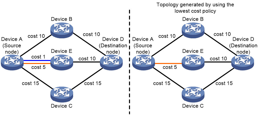

OSPF ECMP FRR
In ECMP scenarios, you can configure OSPF to calculate a backup next hop separately for each ECMP route with the LFA algorithm. ECMP routes might not share the same backup next hop.
As shown in Figure 14, the source node Device A forwards traffic to the destination node Device D. Traffic is load balanced among Link 1, Link 2, and Link 3.
· With ECMP FRR disabled, OSPF does not calculate a backup next hop separately for Link 1, Link 2, and Link 3. When Link 1 fails, traffic previously forwarded through Link 1 is randomly switched to Link 2 or Link 3. This does not facilitate service traffic management.
· With ECMP FRR enabled, OSPF calculates a backup next hop separately for Link 1, Link 2, and Link 3. For example, if the backup next hop for Link 1 is Device C, when Link 1 fails, traffic previously forwarded through Link 1 is switched to backup next hop Device C. This facilitates service traffic management.

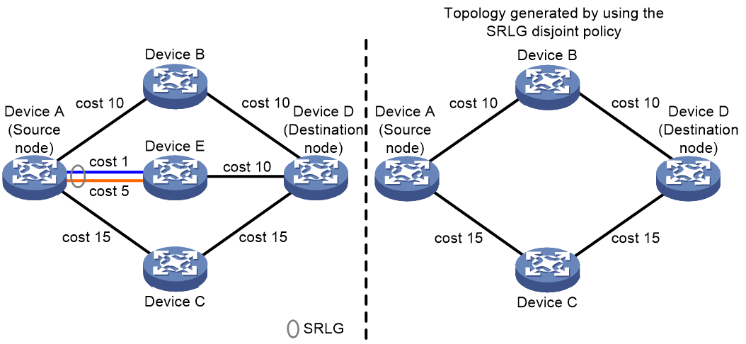

OSPF ECMP-shared FRR
In ECMP scenarios, you can configure OSPF to calculate a backup next hop for ECMP routes with the LFA algorithm. ECMP routes share the same backup next hop.
As shown in Figure 15, the source node Device A forwards traffic to the destination node Device D. Traffic is load balanced between Link 1 and Link 2. ECMP-shared FRR operates as follows:
· With ECMP-shared FRR disabled, OSPF does not calculate any backup next hop for Link 1 or Link 2. When Device B fails, Link 1 and Link 2 both fail, causing traffic disruption before routing convergence.
· With ECMP-shared FRR enabled, OSPF calculates a backup next hop for Link 1 and Link 2. If Device B fails, traffic is switched to the backup next hop Device C, preventing traffic disruption.
Figure 15 OSPF ECMP-shared FRR

As shown in Figure 16, the traffic forwarding path is PE 1—P 1—P 2—PE 2. To avoid traffic loss caused by link failures between P 1 and P 2, the system establishes an LDP tunnel between P 1 and P 4, which is the PQ node. When the link between P 1 and P 2 fails, P 1 encapsulates IP packets in MPLS packets and sends the MPLS packets to P 4 through the LDP tunnel. After receiving the MPLS packets, P 4 removes the MPLS labels of the packets and then forwards the packets to the next hop based on the IP routing table.
The system determines P 4 as the PQ node as follows:
1. Uses P 1 (source node of the protected link) and its neighbors except P 2 (which passes the protected link) as the roots to establish shortest path trees.
2. Finds out all nodes that are reachable from P 1 or one of its neighbors without passing the protected link, which are PE 1, P 1, P 3, and P 4.
These nodes form the extended P space.
3. Uses P 2 (destination node of the protected link) as the root to establish a reverse shortest path tree.
4. Finds out all nodes that are reachable from P 2 without passing the protected link, which are PE 2 and P 4.
These nodes form the Q space.
5. Finds out all nodes that reside in both the extended P space and the Q space.
Only P 4 resides in both the extended P space and the Q space, so P 4 is the PQ node of the protected link.
Figure 16 Network diagram for OSPF remote LFA FRR

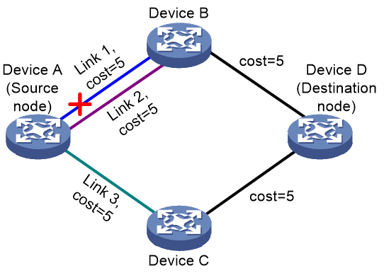

Figure 17 Node protection backup path selection
· Lowest cost policy.
As shown in Figure 18, Device A uses the lowest cost policy and selects path Device A->Device E->Device D as the backup path.
Figure 18 Lowest cost backup path selection
· Node protection and SRLG disjoint policies.
As shown in Figure 19, Device A uses the node protection and SRLG disjoint policies and selects path Device A->Device B->Device D as the backup path.
Figure 19 SRLG disjoint backup path selection

Configuring OSPF multi-area adjacency
Enabling OSPF on a multi-area adjacency interface
According to OSPF protocols, intra-area paths have higher priority than inter-area paths. Assume an area contains a high-speed link. Devices in other areas cannot use it for data transmission, because the interface belongs to only one area. To address this issue, perform this task.
3. Enable OSPF on the multi-area adjacent interface.
ospf multi-area area-id
By default, OSPF is not enabled on a multi-area adjacency interface.
Setting the OSPF cost on a multi-area adjacency interface
Perform this task to manually set a cost for a multi-area adjacency interface. If you do not configure this command, the interface calculates its OSPF cost according to the interface bandwidth.
4. Enable OSPF to adjust the interface cost according to the link quality and set the value to be added to the interface cost.
ospf multi-area area-id cost cost-value
By default, a multi-area adjacency interface calculates its OSPF cost according to the interface bandwidth.

Example: Configuring basic OSPF
As shown in Figure 20:
· Enable OSPF on all routers, and split the AS into three areas.
· Configure Router A and Router B as ABRs.
1. Configure IP addresses for interfaces. (Details not shown.)
2. Enable OSPF:
# Configure Router A.
<RouterA> system-view
[RouterA] router id 10.2.1.1
[RouterA] ospf
[RouterA-ospf-1] area 0
[RouterA-ospf-1-area-0.0.0.0] network 10.1.1.0 0.0.0.255
[RouterA-ospf-1-area-0.0.0.0] quit
[RouterA-ospf-1] area 1
[RouterA-ospf-1-area-0.0.0.1] network 10.2.1.0 0.0.0.255
[RouterA-ospf-1-area-0.0.0.1] quit
[RouterA-ospf-1] quit
# Configure Router B.
<RouterB> system-view
[RouterB] router id 10.3.1.1
[RouterB] ospf
[RouterB-ospf-1] area 0
[RouterB-ospf-1-area-0.0.0.0] network 10.1.1.0 0.0.0.255
[RouterB-ospf-1-area-0.0.0.0] quit
[RouterB-ospf-1] area 2
[RouterB-ospf-1-area-0.0.0.2] network 10.3.1.0 0.0.0.255
[RouterB-ospf-1-area-0.0.0.2] quit
[RouterB-ospf-1] quit
# Configure Router C.
<RouterC> system-view
[RouterC] router id 10.4.1.1
[RouterC] ospf
[RouterC-ospf-1] area 1
[RouterC-ospf-1-area-0.0.0.1] network 10.2.1.0 0.0.0.255
[RouterC-ospf-1-area-0.0.0.1] network 10.4.1.0 0.0.0.255
[RouterC-ospf-1-area-0.0.0.1] quit
[RouterC-ospf-1] quit
# Configure Router D.
<RouterD> system-view
[RouterD] router id 10.5.1.1
[RouterD] ospf
[RouterD-ospf-1] area 2
[RouterD-ospf-1-area-0.0.0.2] network 10.3.1.0 0.0.0.255
[RouterD-ospf-1-area-0.0.0.2] network 10.5.1.0 0.0.0.255
[RouterD-ospf-1-area-0.0.0.2] quit
[RouterD-ospf-1] quit
# Display the OSPF neighbors of Router A.
[RouterA] display ospf peer verbose
(M) Indicates MADJ neighbor
OSPF Process 1 with Router ID 10.2.1.1
Neighbors
Area 0.0.0.0 interface 10.1.1.1(Ten-GigabitEthernet3/1/1)'s neighbors
Router ID: 10.3.1.1 Address: 10.1.1.2 GR State: Normal
State: Full Mode: Nbr is master Priority: 1
DR: 10.1.1.1 BDR: 10.1.1.2 MTU: 0
Options is 0x02 (-|-|-|-|-|-|E|-)
Dead timer due in 37 sec
Neighbor is up for 06:03:59
Authentication Sequence: [ 0 ]
Neighbor state change count: 5
BFD status: Disabled
Area 0.0.0.1 interface 10.2.1.1(Ten-GigabitEthernet3/1/2)'s neighbors
Router ID: 10.4.1.1 Address: 10.2.1.2 GR State: Normal
DR: 10.2.1.1 BDR: 10.2.1.2 MTU: 0
Dead timer due in 32 sec
Neighbor is up for 06:03:12
# Display OSPF routing information on Router A.
[RouterA] display ospf routing
Routing Table
Topology base (MTID 0)
Routing for network
Destination Cost Type NextHop AdvRouter Area
10.2.1.0/24 1 Transit 10.2.1.1 10.2.1.1 0.0.0.1
10.3.1.0/24 2 Inter 10.1.1.2 10.3.1.1 0.0.0.0
10.4.1.0/24 2 Stub 10.2.1.2 10.4.1.1 0.0.0.1
10.5.1.0/24 3 Inter 10.1.1.2 10.3.1.1 0.0.0.0
10.1.1.0/24 1 Transit 10.1.1.1 10.2.1.1 0.0.0.0
Total nets: 5
Intra area: 3 Inter area: 2 ASE: 0 NSSA: 0
# Display OSPF routing information on Router D.
[RouterD] display ospf routing
OSPF Process 1 with Router ID 10.5.1.1
Routing Table
Routing for network
10.2.1.0/24 3 Inter 10.3.1.1 10.3.1.1 0.0.0.2
10.3.1.0/24 1 Transit 10.3.1.2 10.3.1.1 0.0.0.2
10.4.1.0/24 4 Inter 10.3.1.1 10.3.1.1 0.0.0.2
10.5.1.0/24 1 Stub 10.5.1.1 10.5.1.1 0.0.0.2
10.1.1.0/24 2 Inter 10.3.1.1 10.3.1.1 0.0.0.2
Total nets: 5
Intra area: 2 Inter area: 3 ASE: 0 NSSA: 0
# Ping 10.4.1.1 to test reachability.
[RouterD] ping 10.4.1.1
Ping 10.4.1.1 (10.4.1.1): 56 data bytes, press CTRL+C to break
56 bytes from 10.4.1.1: icmp_seq=0 ttl=253 time=1.549 ms
56 bytes from 10.4.1.1: icmp_seq=1 ttl=253 time=1.539 ms
56 bytes from 10.4.1.1: icmp_seq=2 ttl=253 time=0.779 ms
56 bytes from 10.4.1.1: icmp_seq=3 ttl=253 time=1.702 ms
56 bytes from 10.4.1.1: icmp_seq=4 ttl=253 time=1.471 ms
--- Ping statistics for 10.4.1.1 ---
round-trip min/avg/max/std-dev = 0.779/1.408/1.702/0.323 ms

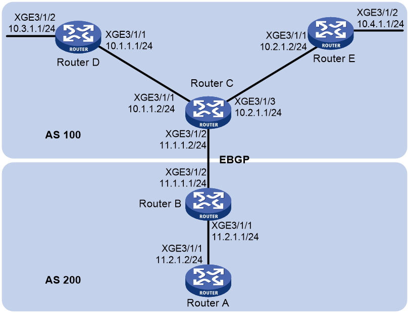

Example: Configuring OSPF route summarization
As shown in Figure 22:
· Configure OSPF on Router A and Router B in AS 200.
· Configure OSPF on Router C, Router D, and Router E in AS 100.
· Configure an EBGP connection between Router B and Router C. Configure Router B and Router C to redistribute OSPF routes and direct routes into BGP and BGP routes into OSPF.
· Configure Router B to advertise only summary route 10.0.0.0/8 to Router A.
2. Enable OSPF:
[RouterA] router id 11.2.1.2
[RouterA] ospf
[RouterA-ospf-1-area-0.0.0.0] network 11.2.1.0 0.0.0.255
[RouterB] router id 11.2.1.1
[RouterB] ospf
[RouterB-ospf-1-area-0.0.0.0] network 11.2.1.0 0.0.0.255
[RouterC] router id 11.1.1.2
[RouterC] ospf
[RouterC-ospf-1] area 0
[RouterC-ospf-1-area-0.0.0.0] network 10.1.1.0 0.0.0.255
[RouterC-ospf-1-area-0.0.0.0] network 10.2.1.0 0.0.0.255
[RouterC-ospf-1-area-0.0.0.0] quit
[RouterD] router id 10.3.1.1
[RouterD] ospf
[RouterD-ospf-1] area 0
[RouterD-ospf-1-area-0.0.0.0] network 10.1.1.0 0.0.0.255
[RouterD-ospf-1-area-0.0.0.0] network 10.3.1.0 0.0.0.255
[RouterD-ospf-1-area-0.0.0.0] quit
# Configure Router E.
<RouterE> system-view
[RouterE] router id 10.4.1.1
[RouterE] ospf
[RouterE-ospf-1] area 0
[RouterE-ospf-1-area-0.0.0.0] network 10.2.1.0 0.0.0.255
[RouterE-ospf-1-area-0.0.0.0] network 10.4.1.0 0.0.0.255
[RouterE-ospf-1-area-0.0.0.0] quit
[RouterE-ospf-1] quit
3. Configure BGP to redistribute OSPF routes and direct routes:
[RouterB] bgp 200
[RouterB-bgp-default] peer 11.1.1.2 as-number 100
[RouterB-bgp-default] address-family ipv4 unicast
[RouterB-bgp-default-ipv4] peer 11.1.1.2 enable
[RouterB-bgp-default-ipv4] import-route ospf
[RouterB-bgp-default-ipv4] import-route direct
[RouterB-bgp-default-ipv4] quit
[RouterB-bgp-default] quit
[RouterC] bgp 100
[RouterC-bgp-default] peer 11.1.1.1 as-number 200
[RouterC-bgp-default] address-family ipv4 unicast
[RouterC-bgp-default-ipv4] peer 11.1.1.1 enable
[RouterC-bgp-default-ipv4] import-route ospf
[RouterC-bgp-default-ipv4] import-route direct
[RouterC-bgp-default] quit
4. Configure Router B and Router C to redistribute BGP routes into OSPF:
# Configure OSPF to redistribute routes from BGP on Router B.
[RouterB] ospf
[RouterB-ospf-1] import-route bgp
# Configure OSPF to redistribute routes from BGP on Router C.
[RouterC] ospf
[RouterC-ospf-1] import-route bgp
# Display the IP routing table on Router A.
[RouterA] display ip routing-table
Destinations : 14 Routes : 14
Destination/Mask Proto Pre Cost NextHop Interface
0.0.0.0/32 Direct 0 0 127.0.0.1 InLoop0
10.1.1.0/24 O_ASE2 150 1 11.2.1.1 XGE3/1/1
10.2.1.0/24 O_ASE2 150 1 11.2.1.1 XGE3/1/1
10.3.1.0/24 O_ASE2 150 1 11.2.1.1 XGE3/1/1
10.4.1.0/24 O_ASE2 150 1 11.2.1.1 XGE3/1/1
11.2.1.0/24 Direct 0 0 11.2.1.2 XGE3/1/1
11.2.1.0/32 Direct 0 0 11.2.1.2 XGE3/1/1
11.2.1.2/32 Direct 0 0 127.0.0.1 InLoop0
11.2.1.255/32 Direct 0 0 11.2.1.2 XGE3/1/1
127.0.0.0/8 Direct 0 0 127.0.0.1 InLoop0
127.0.0.0/32 Direct 0 0 127.0.0.1 InLoop0
127.0.0.1/32 Direct 0 0 127.0.0.1 InLoop0
127.255.255.255/32 Direct 0 0 127.0.0.1 InLoop0
255.255.255.255/32 Direct 0 0 127.0.0.1 InLoop0
5. Configure route summarization:
# Configure route summarization on Router B to advertise a single route 10.0.0.0/8.
[RouterB-ospf-1] asbr-summary 10.0.0.0 8
Destinations : 11 Routes : 11
10.0.0.0/8 O_ASE2 150 1 11.2.1.1 XGE3/1/1
The output shows that routes 10.1.1.0/24, 10.2.1.0/24, 10.3.1.0/24 and 10.4.1.0/24 are summarized into a single route 10.0.0.0/8.
Example: Configuring OSPF stub area
As shown in Figure 23:
· Configure Router A and Router B as ABRs to forward routing information between areas.
· Configure Router D as the ASBR to redistribute static routes.
· Configure Area 1 as a stub area to reduce advertised LSAs without influencing reachability.
2. Enable OSPF (see "Example: Configuring basic OSPF").
3. Configure route redistribution:
# Configure Router D to redistribute static routes.
[RouterD] ip route-static 3.1.2.1 24 10.5.1.2
[RouterD] ospf
[RouterD-ospf-1] import-route static
# Display ABR/ASBR information on Router C.
<RouterC> display ospf abr-asbr
OSPF Process 1 with Router ID 10.4.1.1
Routing Table to ABR and ASBR
Type Destination Area Cost Nexthop RtType
Intra 10.2.1.1 0.0.0.1 3 10.2.1.1 ABR
Inter 10.5.1.1 0.0.0.1 7 10.2.1.1 ASBR
# Display OSPF routing information on Router C.
<RouterC> display ospf routing
Routing Table
Routing for network
10.2.1.0/24 3 Transit 0.0.0.0 10.2.1.1 0.0.0.1
10.3.1.0/24 7 Inter 10.2.1.1 10.2.1.1 0.0.0.1
10.4.1.0/24 3 Stub 10.4.1.1 10.4.1.1 0.0.0.1
10.5.1.0/24 17 Inter 10.2.1.1 10.2.1.1 0.0.0.1
10.1.1.0/24 5 Inter 10.2.1.1 10.2.1.1 0.0.0.1
Routing for ASEs
Destination Cost Type Tag NextHop AdvRouter
3.1.2.0/24 1 Type2 1 10.2.1.1 10.5.1.1
Total nets: 6
Intra area: 2 Inter area: 3 ASE: 1 NSSA: 0
The output shows that Router C's routing table contains an AS external route.
4. Configure Area 1 as a stub area:
[RouterA] ospf
[RouterA-ospf-1-area-0.0.0.1] stub
[RouterC] ospf
[RouterC-ospf-1-area-0.0.0.1] stub
[RouterC] display ospf routing
Routing Table
Routing for network
0.0.0.0/0 4 Inter 10.2.1.1 10.2.1.1 0.0.0.1
Total nets: 6
Intra area: 2 Inter area: 4 ASE: 0 NSSA: 0
The output shows that a default route replaces the AS external route.
# Configure Area 1 as a totally stub area.
[RouterA] ospf
[RouterA-ospf-1-area-0.0.0.1] stub no-summary
Routing Table
Routing for network
10.2.1.0/24 3 Transit 0.0.0.0 10.4.1.1 0.0.0.1
Total nets: 3
Intra area: 2 Inter area: 1 ASE: 0 NSSA: 0
The output shows that inter-area routes are removed, and only one external route (a default route) exists on Router C.
Example: Configuring OSPF NSSA area
As shown in Figure 24:
· Configure OSPF on all routers and split AS into three areas.
· Configure Area 1 as an NSSA area and configure Router C as an ASBR to redistribute static routes into the AS.
3. Configure Area 1 as an NSSA area:
[RouterA] ospf
[RouterA-ospf-1-area-0.0.0.1] nssa
[RouterC] ospf
[RouterC-ospf-1-area-0.0.0.1] nssa
# Display routing information on Router C.
Routing Table
Routing for network
10.2.1.0/24 3 Transit 10.2.1.2 10.4.1.1 0.0.0.1
Total nets: 5
4. Configure route redistribution:
# Configure OSPF to redistribute the static route on Router C.
[RouterC] ip route-static 3.1.2.1 24 10.4.1.2
[RouterC] ospf
[RouterC-ospf-1] import-route static
# Display routing information on Router D.
<RouterD> display ospf routing
Routing Table
Routing for network
10.2.1.0/24 22 Inter 10.3.1.1 10.3.1.1 0.0.0.2
10.3.1.0/24 10 Transit 10.3.1.2 10.3.1.1 0.0.0.2
10.4.1.0/24 25 Inter 10.3.1.1 10.3.1.1 0.0.0.2
10.5.1.0/24 10 Stub 10.5.1.1 10.5.1.1 0.0.0.2
10.1.1.0/24 12 Inter 10.3.1.1 10.3.1.1 0.0.0.2
Routing for ASEs
3.1.2.0/24 1 Type2 1 10.3.1.1 10.2.1.1
Total nets: 6
The output shows that an AS external route imported from the NSSA area exists on Router D.
Example: Configuring OSPF DR election
As shown in Figure 25:
· Enable OSPF on Routers A, B, C, and D on the same network.
· Configure Router D as the DR, and configure Router C as the BDR.
· Change the router priorities on the interfaces to configure Router A as the DR and Router C as the BDR.
2. Configure basic OSPF settings on all routers. (Details not shown.)
For more information, see "Example: Configuring basic OSPF."
3. Display neighbor information on Router A.
OSPF Process 1 with Router ID 1.1.1.1
Neighbors
Area 0.0.0.0 interface 192.168.1.1(Ten-GigabitEthernet3/1/1)'s neighbors
Router ID: 2.2.2.2 Address: 192.168.1.2 GR State: Normal
State: 2-Way Mode: None Priority: 1
DR: 192.168.1.4 BDR: 192.168.1.3 MTU: 0
Dead timer due in 38 sec
Neighbor is up for 00:01:31
Neighbor state change count: 6
Router ID: 3.3.3.3 Address: 192.168.1.3 GR State: Normal
Dead timer due in 31 sec
Neighbor is up for 00:01:28
Router ID: 4.4.4.4 Address: 192.168.1.4 GR State: Normal
The output shows that Router D is the DR and Router C is the BDR.
4. Configure router priorities on interfaces:
[RouterA] interface ten-gigabitethernet 3/1/1
[RouterA-Ten-GigabitEthernet3/1/1] ospf dr-priority 100
[RouterA-Ten-GigabitEthernet3/1/1] quit
[RouterA] quit
[RouterB] interface ten-gigabitethernet 3/1/1
[RouterB-Ten-GigabitEthernet3/1/1] ospf dr-priority 0
[RouterB-Ten-GigabitEthernet3/1/1] quit
[RouterB] quit
[RouterC] interface ten-gigabitethernet 3/1/1
[RouterC-Ten-GigabitEthernet3/1/1] ospf dr-priority 2
[RouterC-Ten-GigabitEthernet3/1/1] quit
[RouterC] quit
# Display information about neighbors of Router D.
<RouterD> display ospf peer verbose
OSPF Process 1 with Router ID 4.4.4.4
Neighbors
Area 0.0.0.0 interface 192.168.1.4(Ten-GigabitEthernet3/1/1)'s neighbors
Router ID: 1.1.1.1 Address: 192.168.1.1 GR State: Normal
State: Full Mode:Nbr is slave Priority: 100
Neighbor is up for 00:11:17
State: Full Mode:Nbr is slave Priority: 0
Dead timer due in 35 sec
Neighbor is up for 00:11:19
State: Full Mode:Nbr is slave Priority: 2
Dead timer due in 33 sec
Neighbor is up for 00:11:15
The output shows that the DR and BDR are not changed, because the new router priority settings do not take effect immediately.
5. Restart OSPF processes:
# Restart the OSPF process on Router A.
<RouterA> reset ospf 1 process
Warning : Reset OSPF process? [Y/N]:y
# Restart the OSPF process on Router B.
<RouterB> reset ospf 1 process
# Restart the OSPF process on Router C.
<RouterC> reset ospf 1 process
# Restart the OSPF process on Router D.
<RouterD> reset ospf 1 process
# Display neighbor information on Router D.
Neighbors
State: Full Mode: Nbr is slave Priority: 100
DR: 192.168.1.1 BDR: 192.168.1.3 MTU: 0
Dead timer due in 39 sec
Neighbor is up for 00:01:40
State: 2-Way Mode: None Priority: 0
Neighbor is up for 00:01:44
State: Full Mode: Nbr is slave Priority: 2
Neighbor is up for 00:01:41
The output shows that Router A becomes the DR and Router C becomes the BDR.
The full neighbor state means an adjacency has been established. The 2-way neighbor state means the two routers are not the DR or BDR, and they do not exchange LSAs.
# Display OSPF interface information.
<RouterA> display ospf interface
(M) Indicates MADJ interface
Interfaces
Area: 0.0.0.0
IP Address Type State Cost Pri DR BDR
192.168.1.1 Broadcast DR 1 100 192.168.1.1 192.168.1.3
<RouterB> display ospf interface
OSPF Process 1 with Router ID 2.2.2.2
Interfaces
Area: 0.0.0.0
192.168.1.2 Broadcast DROther 1 0 192.168.1.1 192.168.1.3
The interface state DROther means the interface is not the DR or BDR.
Example: Configuring OSPF virtual link
As shown in Figure 26, configure a virtual link between Router B and Router C to connect Area 2 to the backbone area. After configuration, Router B can learn routes to Area 2.
2. Enable OSPF:
[RouterA] ospf 1 router-id 1.1.1.1
[RouterB] ospf 1 router-id 2.2.2.2
[RouterB-ospf-1] area 1
[RouterB–ospf-1-area-0.0.0.1] network 10.2.1.0 0.0.0.255
[RouterB–ospf-1-area-0.0.0.1] quit
[RouterC] ospf 1 router-id 3.3.3.3
[RouterC-ospf-1] area 2
[RouterC–ospf-1-area-0.0.0.2] network 10.3.1.0 0.0.0.255
[RouterC–ospf-1-area-0.0.0.2] quit
[RouterD] ospf 1 router-id 4.4.4.4
# Display OSPF routing information on Router B.
[RouterB] display ospf routing
Routing Table
Routing for network
10.2.1.0/24 2 Transit 10.2.1.1 3.3.3.3 0.0.0.1
10.1.1.0/24 2 Transit 10.1.1.2 2.2.2.2 0.0.0.0
Total nets: 2
Intra area: 2 Inter area: 0 ASE: 0 NSSA: 0
The output shows that Router B does not have routes to Area 2 because Area 0 is not directly connected to Area 2.
3. Configure a virtual link:
[RouterB] ospf
[RouterB-ospf-1-area-0.0.0.1] vlink-peer 3.3.3.3
[RouterB-ospf-1-area-0.0.0.1] quit
[RouterC] ospf
[RouterC-ospf-1-area-0.0.0.1] vlink-peer 2.2.2.2
Routing Table
Routing for network
10.3.1.0/24 5 Inter 10.2.1.2 3.3.3.3 0.0.0.0
Total nets: 3
The output shows that Router B has learned the route 10.3.1.0/24 to Area 2.
Example: Configuring OSPF GR
As shown in Figure 27:
· Router A, Router B, and Router C that belong to the same autonomous system and the same OSPF routing domain are GR capable.
· Router A acts as the non-IETF GR restarter. Router B and Router C are the GR helpers, and synchronize their LSDBs with Router A through OOB communication of GR.
2. Enable OSPF:
[RouterA] router id 1.1.1.1
[RouterA] ospf 100
[RouterA-ospf-100] area 0
[RouterA-ospf-100-area-0.0.0.0] network 192.1.1.0 0.0.0.255
[RouterA-ospf-100-area-0.0.0.0] quit
[RouterB] router id 2.2.2.2
[RouterB] ospf 100
[RouterB-ospf-100] area 0
[RouterB-ospf-100-area-0.0.0.0] network 192.1.1.0 0.0.0.255
[RouterB-ospf-100-area-0.0.0.0] quit
[RouterC] router id 3.3.3.3
[RouterC] ospf 100
[RouterC-ospf-100] area 0
[RouterC-ospf-100-area-0.0.0.0] network 192.1.1.0 0.0.0.255
[RouterC-ospf-100-area-0.0.0.0] quit
3. Configure OSPF GR:
# Configure Router A as the non-IETF OSPF GR restarter: enable the link-local signaling capability, the out-of-band re-synchronization capability, and non-IETF GR for OSPF process 100.
[RouterA-ospf-100] enable link-local-signaling
[RouterA-ospf-100] enable out-of-band-resynchronization
[RouterA-ospf-100] graceful-restart
[RouterA-ospf-100] quit
[RouterA] quit
# Configure Router B as the GR helper: enable the link-local signaling capability and the out-of-band re-synchronization capability for OSPF process 100.
[RouterB-ospf-100] enable link-local-signaling
[RouterB-ospf-100] enable out-of-band-resynchronization
# Configure Router C as the GR helper: enable the link-local signaling capability and the out-of-band re-synchronization capability for OSPF process 100.
[RouterC-ospf-100] enable link-local-signaling
[RouterC-ospf-100] enable out-of-band-resynchronization
# Enable OSPF GR event debugging and restart the OSPF process by using GR on Router A.
<RouterA> debugging ospf event graceful-restart
<RouterA> terminal monitor
<RouterA> terminal logging level 7
<RouterA> reset ospf 100 process graceful-restart
%Oct 21 15:29:28:727 2011 RouterA OSPF/5/OSPF_NBR_CHG: OSPF 100 Neighbor 192.1.1.2(Ten-GigabitEthernet3/1/1) from Full to Down.
%Oct 21 15:29:28:729 2011 RouterA OSPF/5/OSPF_NBR_CHG: OSPF 100 Neighbor 192.1.1.3(Ten-GigabitEthernet3/1/1) from Full to Down.
*Oct 21 15:29:28:735 2011 RouterA OSPF/7/DEBUG:
OSPF 100 nonstandard GR Started for OSPF Router
OSPF 100 created GR wait timer,timeout interval is 40(s).
OSPF 100 created GR Interval timer,timeout interval is 120(s).
*Oct 21 15:29:28:758 2011 RouterA OSPF/7/DEBUG:
OSPF 100 created OOB Progress timer for neighbor 192.1.1.3.
*Oct 21 15:29:28:766 2011 RouterA OSPF/7/DEBUG:
OSPF 100 created OOB Progress timer for neighbor 192.1.1.2.
%Oct 21 15:29:29:902 2011 RouterA OSPF/5/OSPF_NBR_CHG: OSPF 100 Neighbor 192.1.1.2(Ten-GigabitEthernet3/1/1) from Loading to Full.
*Oct 21 15:29:29:902 2011 RouterA OSPF/7/DEBUG:
OSPF 100 deleted OOB Progress timer for neighbor 192.1.1.2.
%Oct 21 15:29:30:897 2011 RouterA OSPF/5/OSPF_NBR_CHG: OSPF 100 Neighbor 192.1.1.3(Ten-GigabitEthernet3/1/1) from Loading to Full.
*Oct 21 15:29:30:897 2011 RouterA OSPF/7/DEBUG:
OSPF 100 deleted OOB Progress timer for neighbor 192.1.1.3.
*Oct 21 15:29:30:911 2011 RouterA OSPF/7/DEBUG:
OSPF GR: Process 100 Exit Restart,Reason : DR or BDR change,for neighbor : 192.1.1.3.
OSPF 100 deleted GR Interval timer.
*Oct 21 15:29:30:912 2011 RouterA OSPF/7/DEBUG:
OSPF 100 deleted GR wait timer.
%Oct 21 15:29:30:920 2011 RouterA OSPF/5/OSPF_NBR_CHG: OSPF 100 Neighbor 192.1.1.2(Ten-GigabitEthernet3/1/1) from Full to Down.
%Oct 21 15:29:30:921 2011 RouterA OSPF/5/OSPF_NBR_CHG: OSPF 100 Neighbor 192.1.1.3(Ten-GigabitEthernet3/1/1) from Full to Down.
%Oct 21 15:29:33:815 2011 RouterA OSPF/5/OSPF_NBR_CHG: OSPF 100 Neighbor 192.1.1.3(Ten-GigabitEthernet3/1/1) from Loading to Full.
%Oct 21 15:29:35:578 2011 RouterA OSPF/5/OSPF_NBR_CHG: OSPF 100 Neighbor 192.1.1.2(Ten-GigabitEthernet3/1/1) from Loading to Full.
The output shows that Router A completes GR.
Example: Configuring BFD for OSPF
As shown in Figure 28, run OSPF on Router A, Router B, and Router C so that they can reach each other at the network layer.
· When the link over which Router A and Router B communicate through a Layer 2 switch fails, BFD can quickly detect the failure and notify OSPF of the failure.
· Router A and Router B then communicate through Router C.
2. Enable OSPF:
[RouterA] ospf
[RouterA-ospf-1-area-0.0.0.0] network 192.168.0.0 0.0.0.255
[RouterA-ospf-1-area-0.0.0.0] network 121.1.1.1 0.0.0.0
[RouterB] ospf
[RouterB-ospf-1-area-0.0.0.0] network 192.168.0.0 0.0.0.255
[RouterB-ospf-1-area-0.0.0.0] network 13.1.1.0 0.0.0.255
[RouterB-ospf-1-area-0.0.0.0] network 120.1.1.1 0.0.0.0
[RouterC] ospf
[RouterC-ospf-1-area-0.0.0.0] network 13.1.1.0 0.0.0.255
3. Configure BFD:
# Enable BFD on Router A and configure BFD parameters.
[RouterA] bfd session init-mode active
[RouterA-Ten-GigabitEthernet3/1/1] ospf bfd enable
[RouterA-Ten-GigabitEthernet3/1/1] bfd min-transmit-interval 500
[RouterA-Ten-GigabitEthernet3/1/1] bfd min-receive-interval 500
[RouterA-Ten-GigabitEthernet3/1/1] bfd detect-multiplier 7
[RouterA] quit
# Enable BFD on Router B and configure BFD parameters.
[RouterB] bfd session init-mode active
[RouterB-Ten-GigabitEthernet3/1/1] ospf bfd enable
[RouterB-Ten-GigabitEthernet3/1/1] bfd min-transmit-interval 500
[RouterB-Ten-GigabitEthernet3/1/1] bfd min-receive-interval 500
[RouterB-Ten-GigabitEthernet3/1/1] bfd detect-multiplier 6
# Display the BFD information on Router A.
<RouterA> display bfd session
Total sessions: 1 Up sessions: 1 Init mode: Active
IPv4 session working in control packet mode:
LD/RD SourceAddr DestAddr State Holdtime Interface
3/1 192.168.0.102 192.168.0.100 Up 1700ms XGE3/1/1

Example: Configuring OSPF FRR
As shown in Figure 29, Router A, Router B, and Router C reside in the same OSPF domain. Configure OSPF FRR so that when Link A fails, traffic is immediately switched to Link B.
Table 6 Interface and IP address assignment
Device |
Interface |
IP address |
Router A |
XGE3/1/1 |
12.12.12.1/24 |
Router A |
XGE3/1/2 |
13.13.13.1/24 |
Router A |
Loop0 |
1.1.1.1/32 |
Router B |
XGE3/1/1 |
24.24.24.4/24 |
Router B |
XGE3/1/2 |
13.13.13.2/24 |
Router B |
Loop0 |
4.4.4.4/32 |
Router C |
XGE3/1/1 |
12.12.12.2/24 |
Router C |
XGE3/1/2 |
24.24.24.2/24 |
1. Configure IP addresses and subnet masks for interfaces on the routers. (Details not shown.)
2. Configure OSPF on the routers to ensure that Router A, Router B, and Router C can communicate with each other at the network layer. (Details not shown.)
3. Configure OSPF FRR:
You can enable OSPF FRR to either calculate a backup next hop by using the LFA algorithm, or specify a backup next hop by using a routing policy.
¡ (Method 1.) Enable OSPF FRR to calculate a backup next hop by using the LFA algorithm:
[RouterA] ospf 1
[RouterA-ospf-1] fast-reroute lfa
[RouterB] ospf 1
[RouterB-ospf-1] fast-reroute lfa
¡ (Method 2.) Enable OSPF FRR to specify a backup next hop by using a routing policy:
[RouterA] ip prefix-list abc index 10 permit 4.4.4.4 32
[RouterA] route-policy frr permit node 10
[RouterA-route-policy-frr-10] if-match ip address prefix-list abc
[RouterA-route-policy-frr-10] apply fast-reroute backup-interface ten-gigabitethernet 3/1/1 backup-nexthop 12.12.12.2
[RouterA-route-policy-frr-10] quit
[RouterA] ospf 1
[RouterA-ospf-1] fast-reroute route-policy frr
[RouterB] ip prefix-list abc index 10 permit 1.1.1.1 32
[RouterB] route-policy frr permit node 10
[RouterB-route-policy-frr-10] if-match ip address prefix-list abc
[RouterB-route-policy-frr-10] apply fast-reroute backup-interface ten-gigabitethernet 3/1/1 backup-nexthop 24.24.24.2
[RouterB-route-policy-frr-10] quit
[RouterB] ospf 1
[RouterB-ospf-1] fast-reroute route-policy frr

# Display route 4.4.4.4/32 on Router A to view the backup next hop information.
[RouterA] display ip routing-table 4.4.4.4 verbose
Summary Count : 1
Destination: 4.4.4.4/32
Protocol: O_INTRA
Process ID: 1
SubProtID: 0x1 Age: 04h20m37s
FlushedAge: 15h28m49s
Cost: 1 Preference: 10
IpPre: N/A QosLocalID: N/A
Tag: 0 State: Active Adv
OrigTblID: 0x0 OrigVrf: default-vrf
TableID: 0x2 OrigAs: 0
NibID: 0x26000002 LastAs: 0
AttrID: 0xffffffff
BkAttrID: 0xffffffff Neighbor: 0.0.0.0
Flags: 0x1008c OrigNextHop: 13.13.13.2
Label: NULL RealNextHop: 13.13.13.2
BkLabel: NULL BkNextHop: 12.12.12.2
SRLabel: NULL Interface: Ten-GigabitEthernet3/1/2
BkSRLabel: NULL BkInterface: N/A
Tunnel ID: Invalid IPInterface: Ten-GigabitEthernet3/1/2
BkTunnel ID: Invalid BkIPInterface: Ten-GigabitEthernet3/1/1
InLabel: NULL ColorInterface: N/A
SIDIndex: NULL BkColorInterface: N/A
FtnIndex: 0x0 TunnelInterface: N/A
TrafficIndex: N/A BkTunnelInterface: N/A
Connector: N/A PathID: 0x0
UserID: 0x0 SRTunnelID: Invalid
SID Type: N/A NID: Invalid
FlushNID: Invalid BkNID: Invalid
BkFlushNID: Invalid StatFlags: 0x0
SID: N/A
BkSID: N/A
CommBlockLen: 0 Priority: Critical
MemberPort: N/A ExtFlags: 0x0
UCMIndex: 0x0 UserVLAN: 65535
UCMMTU: 0 BrasHash: 0
SessionID: 0 UserGroupID: 0
# Display route 1.1.1.1/32 on Router B to view the backup next hop information.
[RouterB] display ip routing-table 1.1.1.1 verbose
Summary Count : 1
Destination: 1.1.1.1/32
Protocol: O_INTRA
Process ID: 1
AttrID: 0xffffffff
Flags: 0x1008c OrigNextHop: 13.13.13.1
Label: NULL RealNextHop: 13.13.13.1
BkLabel: NULL BkNextHop: 24.24.24.2
SID: N/A
BkSID: N/A
