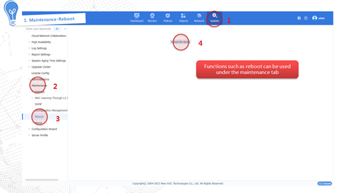

The reset button restarts the firewall. It does not restore the factory defaults.

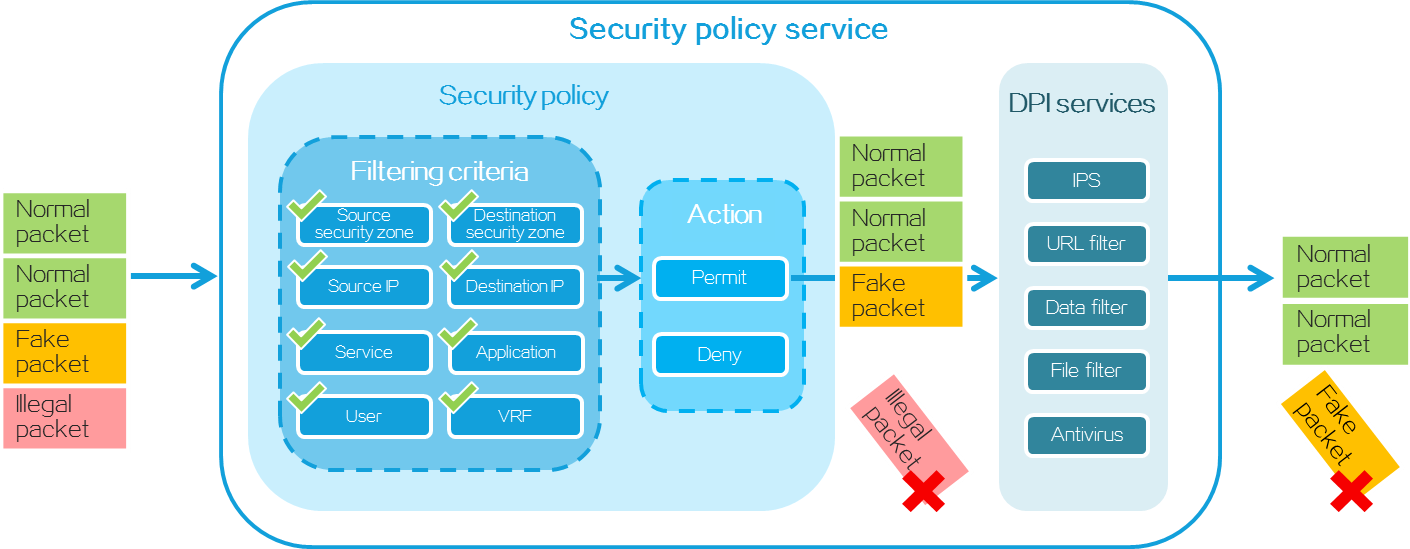

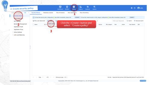

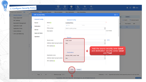

Security policy

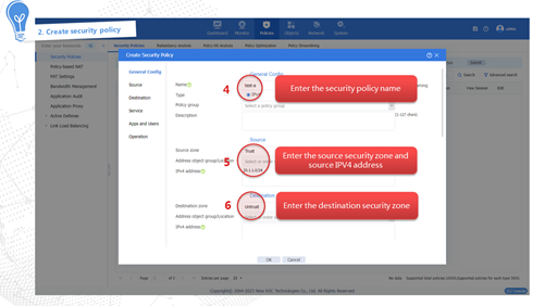

As shown in Figure 4, a security policy filters packets based on the specified filtering conditions such as source/destination security zone, source IP/MAC address, destination IP address, service, application, terminal, user, and time period. It processes matched packets according to the pre-set policy action. If a packet does not match any policy, it will be discarded. If no filtering conditions are configured in the security policy, the policy matches all packets.
Figure 4 Packet processing of security policy

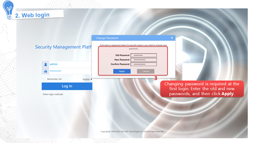

Obtaining the factory default settings
Table 1 shows the factory default settings of the device. You can also obtain the default username and password of the device through the nameplate on the device.
Table 1 Factory default settings of the device
Item
Default
Remarks
Username
admin
N/A
Password
admin
N/A

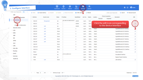

IP address of the Ethernet management interface
·     Interface: GigabitEthernet 1/0/0 or M-GigabitEthernet 1/0/0
·     IP address: 192.168.0.1/24
The management interface varies by device model. For more information, see the product manuals or the nameplate on the device.

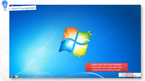

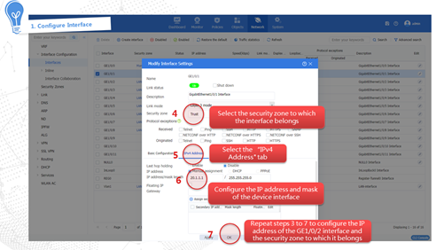

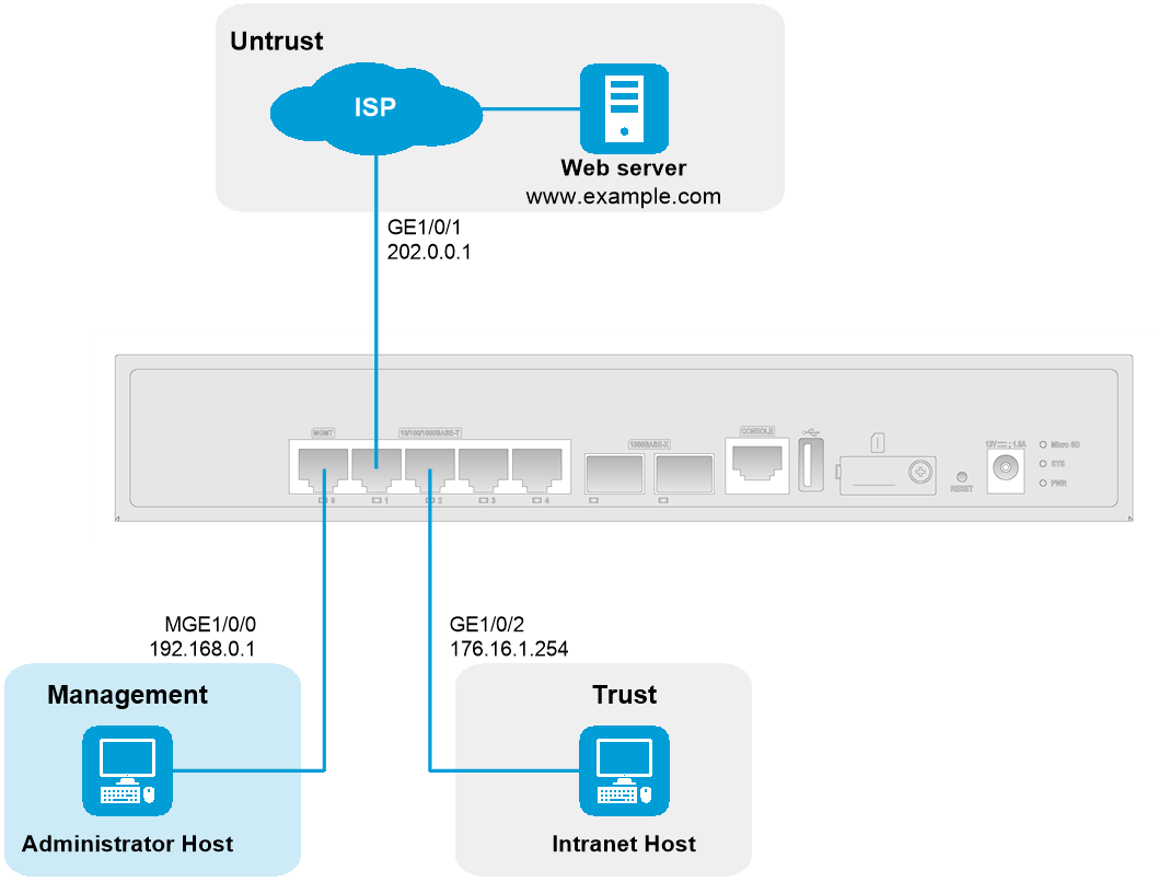

As shown in Figure 5, connect the management interface, internal interface GE 1/0/2, and external interface GE 1/0/1 of the device. The internal interface acts as a LAN port and is typically added to the Trust security zone to connect the intranet host. The external interface acts as a WAN port and is typically added to the Untrust security zone to connect the carrier network for external communication.
To configure the device from the CLI, use the console cable to connect the serial port on the management PC to the console port on the device for first login.
Figure 5 Connecting cables

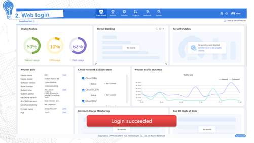

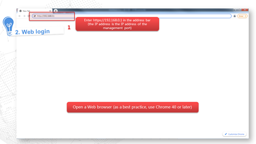

Logging in to the Web interface
As a best practice, using the following browsers:
·     Chrome 40 and higher
·     Firefox 19 and higher.
·     Internet Explorer 10 and higher.
To access the Web interface, you must use the following browser settings:
·     Accept the first-party cookies (cookies from the site you are accessing).
·     Enable active scripting or JavaScript, depending on the Web browser.
·     If you are using an Internet Explorer browser, you must enable the following security settings:
¡     Script ActiveX controls marked safe for scripting.
¡     Run ActiveX controls and plug-ins.
·     To ensure correct display of webpage contents after software upgrade or downgrade, clear data cached by the browser before you log in.

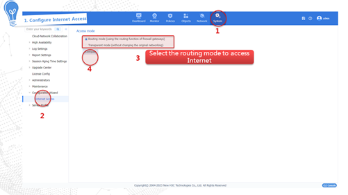

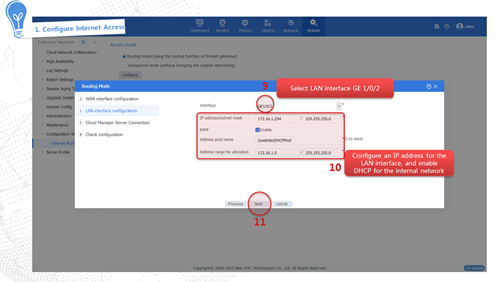

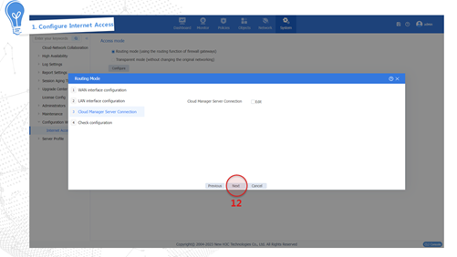

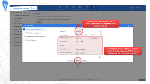

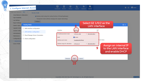

Internet access in routing mode
Internet access in routing mode indicates that the device in the network is deployed in Layer 3 mode. That is, the uplink and downlink service interfaces of the device operate in Layer 3 mode. In this mode, the device typically serves as the gateway of the enterprise that connects the internal network and the Internet, and performs security monitoring and control of network traffic. In this mode, the device supports abundant routing and security features. To adapt to various network environments, the device provides the following methods to fast access the Internet:
·     Specified IP address—Obtains a fixed public network IP address from the carrier. Users in the internal network must use this public network IP address to access the Internet.

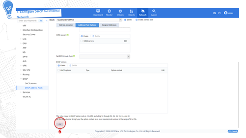

·     DHCP—The device dynamically obtains a public network IP address through the DHCP service provided by the carrier to access the Internet.
·     PPPoE—The user can access the Internet through a PPPoE access authentication account obtained from the carrier.
Internet access through a specific IP address
This access method indicates obtaining a fixed public network IP address from the carrier. Users in the internal network must use this public network IP address to access the Internet. The configuration procedure is as follows:
Internet access through DHCP
The device dynamically obtains a public network IP address through the DHCP service provided by the carrier to access the Internet. The configuration procedure is as follows:
Internet access through PPPoE
The user can access the Internet through a PPPoE access authentication account obtained from the carrier. The configuration procedure is as follows:

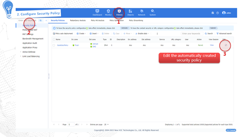

Configuring a security policy

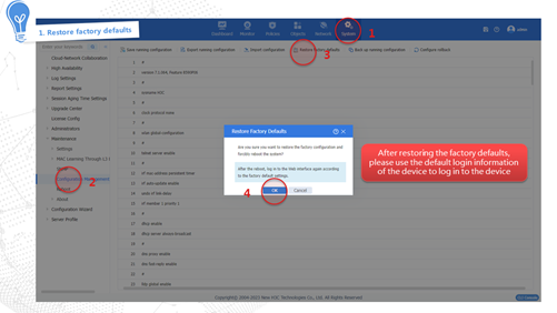

Restoring the factory defaults
IMPORTANT
IMPORTANT:
Use this feature with caution. This feature delete all configurations and files except .bin files and license files.
