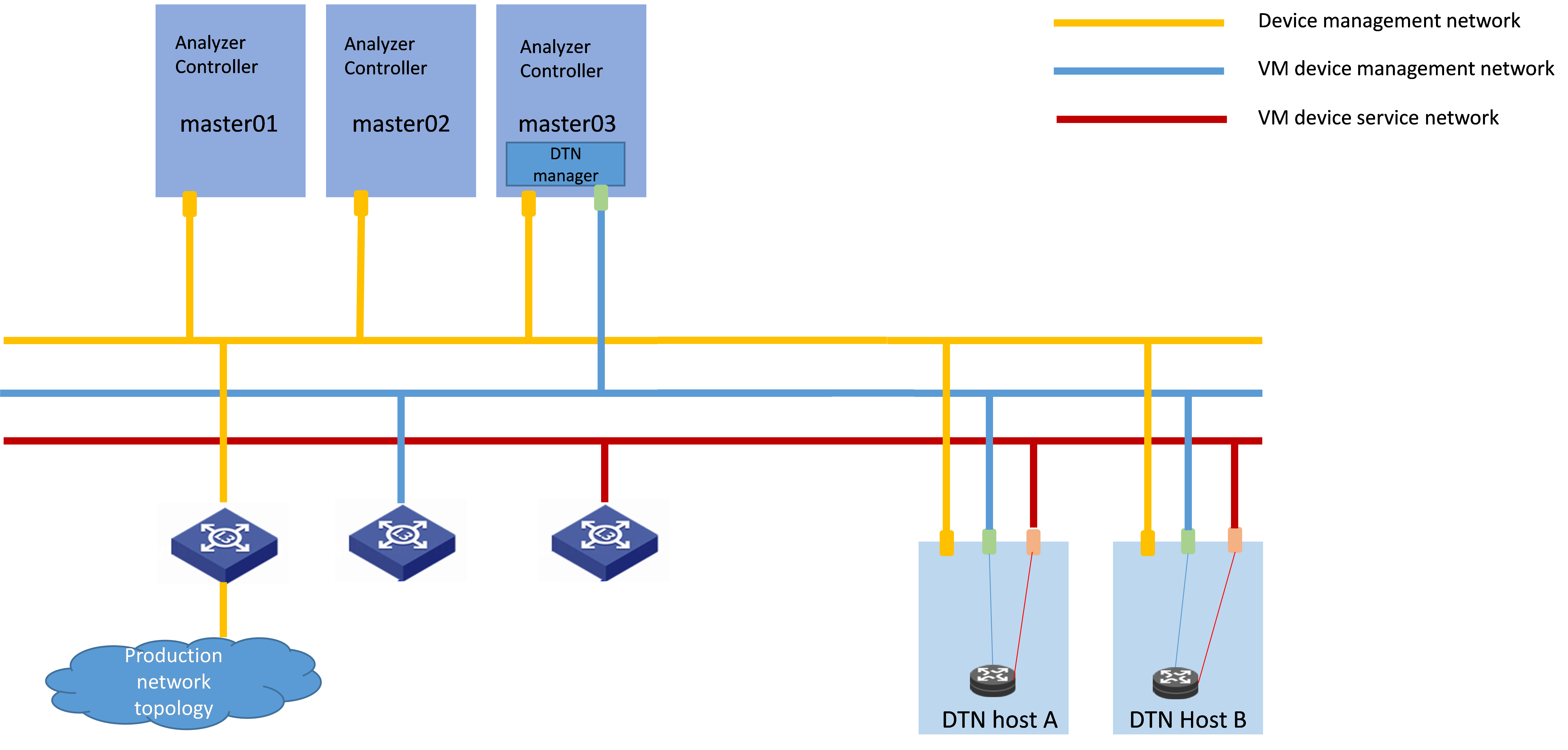

A simulation network includes three types of networks, including device management network, VM device management network, and VM device service network.
·     Device management networkNetwork for cluster communication between analyzers and device management.
·     VM device management networkNetwork over which the digital twin network (DTN) microservice component and DTN hosts exchange management information.
·     VM device service networkNetwork over which the DTN hosts exchange service data.
Before you deploy the simulation system, plan the VM device management network and VM device service network.
Figure 1 Typical simulation network topology design for the carrier network scenario in non-remote disaster recovery mode
CAUTION
CAUTION:
·     If the device management network and VM device management network use the same management switch, configure VPN instances for isolation on the management switch to isolate the VM device management network from the production network and prevent IP address conflicts from affecting the services. If the device management network and VM device management network use different management switches, physically isolate these switches.
·     Configure routes to provide Layer 3 connectivity between simulation management IPs and simulated device management IPs.
·     On the port connecting the switch to the service interface of a simulation host, execute the port link-type trunk command to configure the link type of the port as trunk, and execute the port trunk permit vlan vlan-id-list command to assign the port to 150 contiguous VLAN IDs. Among these VLAN IDs, the start ID is the VLAN ID specified when installing the DTN host, and the end VLAN ID is the start VLAN ID+149. For example, if the start VLAN ID is 11, the permitted VLAN ID range is 11 to 160. When you plan the network, do not use any VLAN ID permitted by the port.

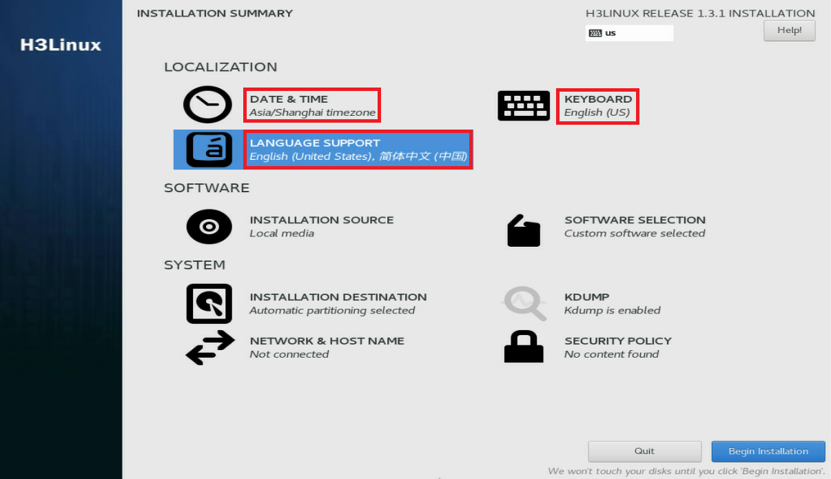

After the ISO image is loaded, the INSTALLATION SUMMARY page opens.
Figure 2 INSTALLATION SUMMARY page
4.     In the LOCALIZATION area, perform the following steps:
¡     Click DATE & TIME to modify the date and time settings.
¡     Click KEYBOARD to modify keyboard settings as needed.
¡     Click LANGUAGE SUPPORT to select your preferred language.
IMPORTANT
IMPORTANT:
Make sure you select the same time zone across the hosts. In this document, [Asia/Shanghai] is selected for example.

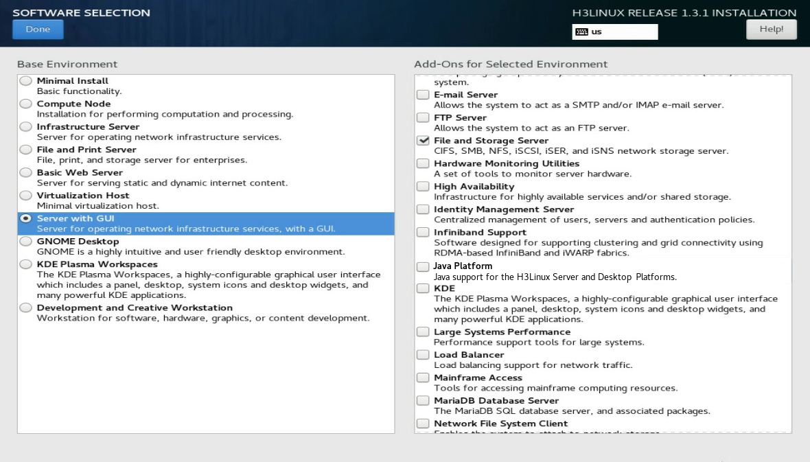

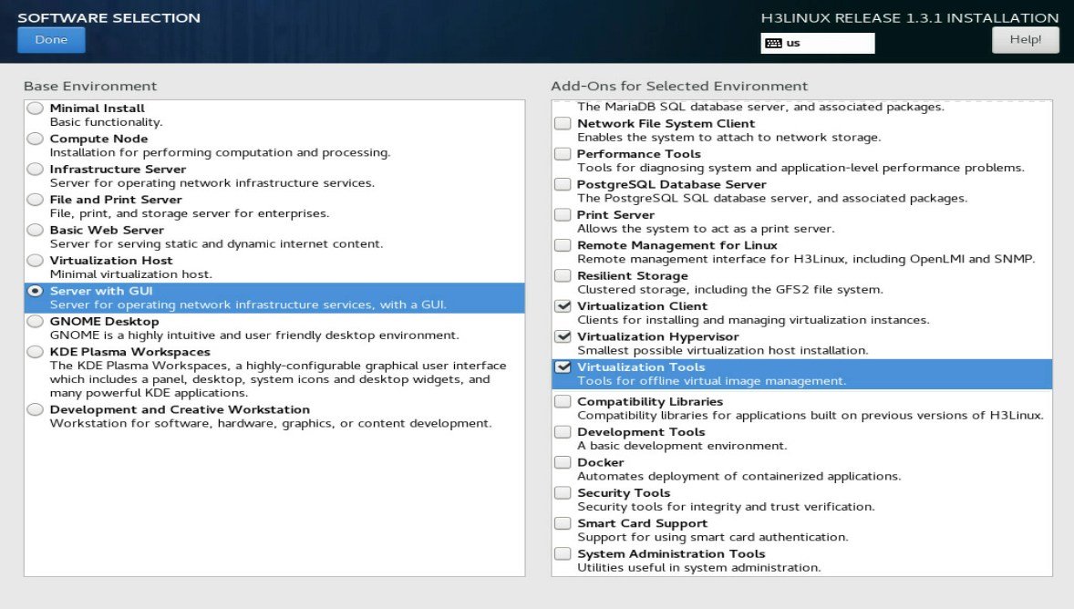

5.     Click SOFTWARE SELECTION in the SOFTWARE area to enter the page for selecting software. Select the Server with GUI base environment and the File and Storage Server, Virtualization Client, Virtualization Hypervisor, and Virtualization Tools add-ons. Then, click Done to return to the INSTALLATION SUMMARY page.
Figure 4 SOFTWARE SELECTION page (1)
Figure 5 SOFTWARE SELECTION page (2)

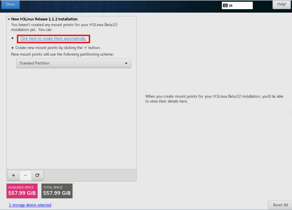

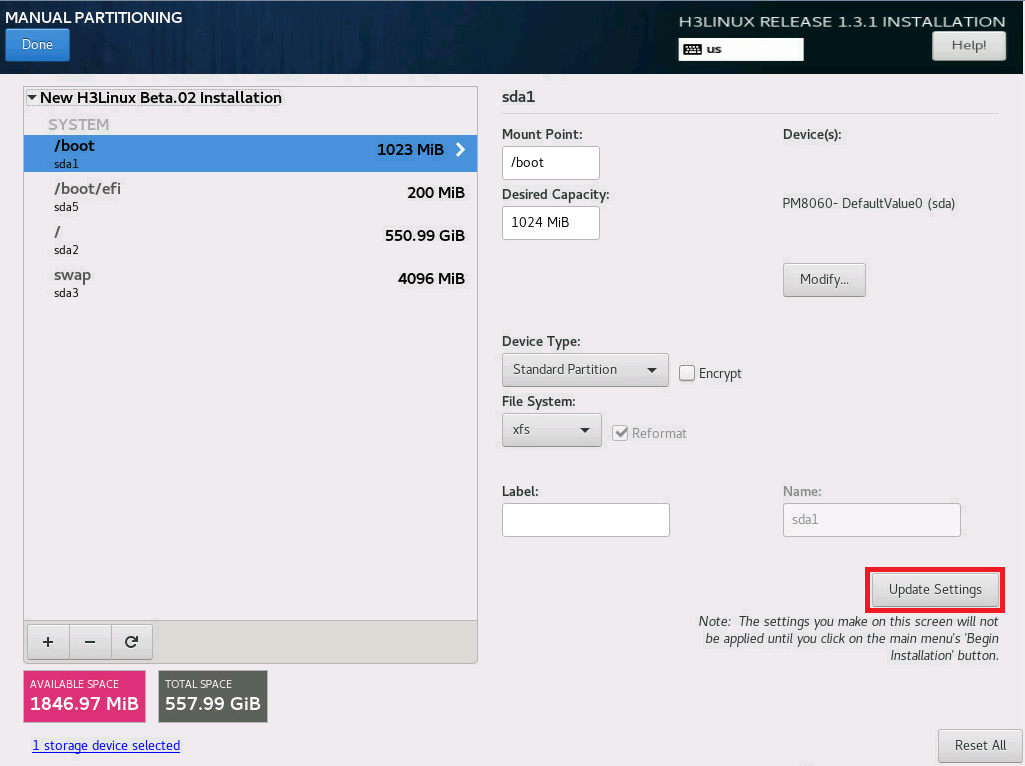

8.     In the MANUAL PARTITIONING dialog box, click Click here to create them automatically to automatically generate recommended partitions.
Figure 7 MANUAL PARTITIONING dialog box
The list of automatically created partitions opens. Figure 8 shows the list of automatically created partitions when the disk size is 600 GiB.
IMPORTANT
IMPORTANT:
The /boot/efi partition is available only if UEFI mode is enabled for OS installation.
Figure 8 Automatically created partition list

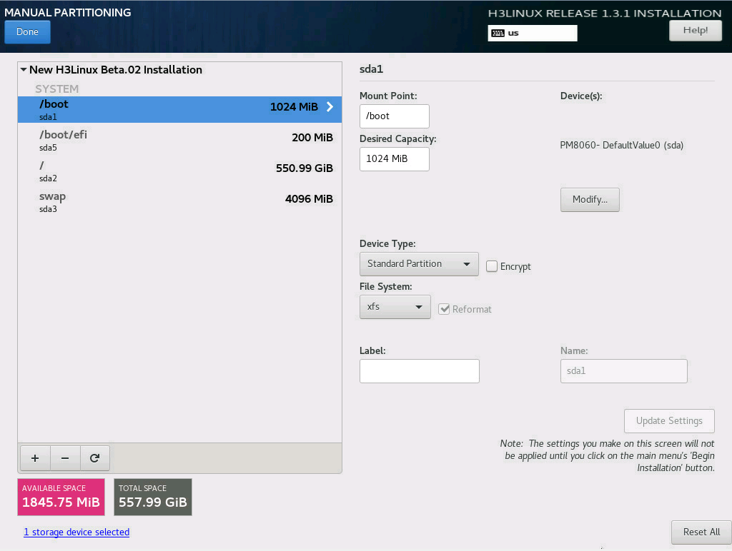

9.     Set the device type and file system of a partition. As a best practice, set the device type to Standard Partition to improve system stability. Table 5 shows the device type and file system of each partition used in this document.
Table 5 Partition settings
Partition name
Device type
File system
/boot
Standard Partition
xfs
/boot/efi (UEFI mode)
Standard Partition
EFI System Partition
Standard Partition
xfs
/swap
Standard Partition
swap
10.     Edit the device type and file system of a partition as shown in Table 6. Take the /boot partition for example. Select a partition on the left, and select Standard Partition from the Device Type list and xfs from the File System list. Then, click Update Settings.
Table 6 Configuring partitions

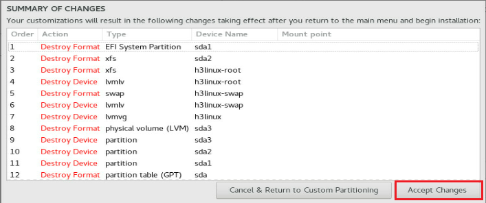

11.     After you finish the partitioning task, click Done in the upper left corner. In the dialog box that opens, select Accept Changes.
Figure 9 Accepting changes

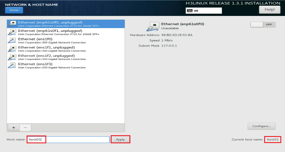

12.     In the INSTALLATION SUMMARY window that opens, click NETWORK & HOSTNAME in the SYSTEM area to configure the host name and network settings.
13.     In the Host name field, enter the host name (for example, host01) for this server, and then click Apply.
Figure 10 Setting the host name

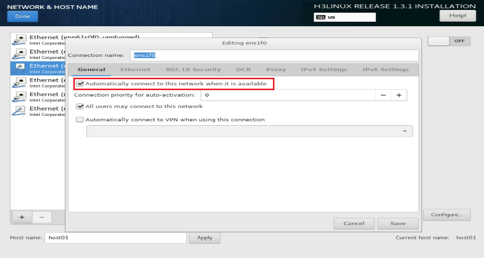

a.     Select a network port and then click Configure.
b.     In the dialog box that opens, configure basic network port settings on the General tab:
-     Select the Automatically connect to this network when it is available option .
-     Verify that the All users may connect to this network option is selected. By default, this option is selected.
Figure 11 General settings for a network port

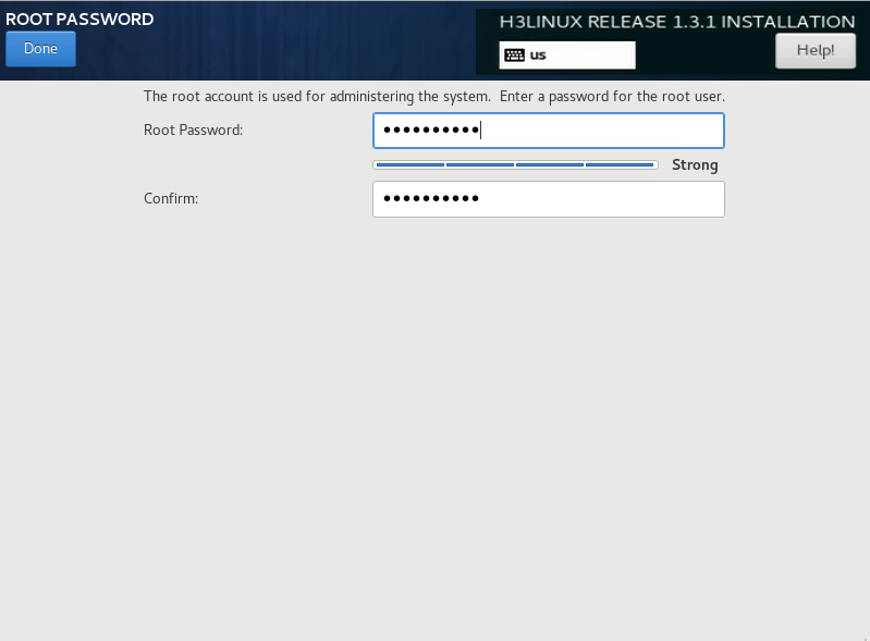

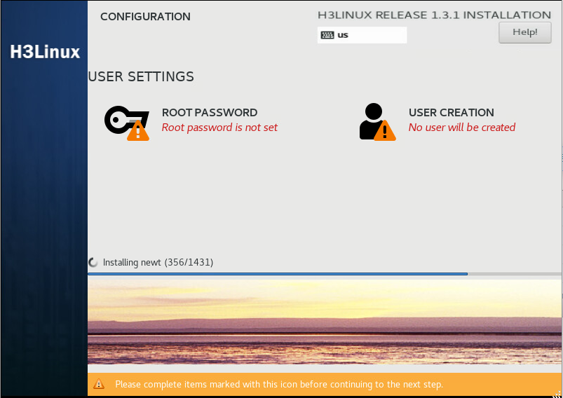

18.     During the installation, configure the root password as prompted:
IMPORTANT
IMPORTANT:
You must configure a root password before you can continue with the installation.
a.     In the USER SETTINGS area, click ROOT PASSWORD.
b.     In the dialog box that opens, set the root password for the system, and then click Done in the upper left corner.
Figure 13 Configuration window for H3Linux OS installation
Figure 14 Setting the root password
Then, the system automatically reboots to finish OS installation.

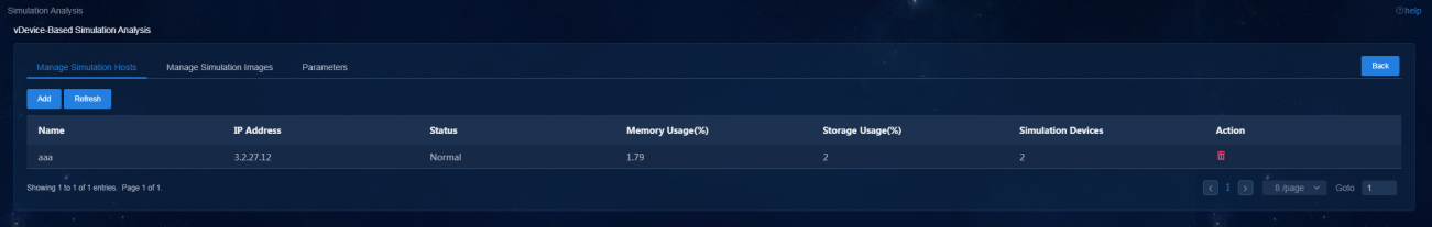

Figure 16 Managing simulation hosts

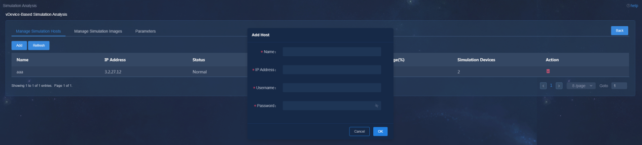

3.     Click Add. In the dialog box that opens, configure the host name, IP address, username, and password.
Parameters
¡     Name: Name of the DTN host.
¡     IP Address: Management IP of the DTN host.
¡     Username: Username for logging in to the host.
¡     Password: Password for logging in to the host.
Figure 17 Adding a host
4.     Click OK.

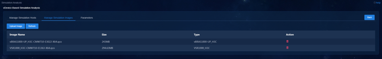

1.     Log in to the system as a user that has permissions to manage the simulation network. Navigate to the Analytics > Simulation Analysis > vDevice Simulation Analysis page. Click Build in the Create Simulation Network area. In the dialog box that opens, select a building mode.
2.     Click Build on the page that opens. In the dialog box that opens, click the preconfiguring the simulation network link. The Manage Simulation Hosts tab is displayed by default.
3.     Click the Manage Simulation Images tab.
Figure 18 Managing simulation images

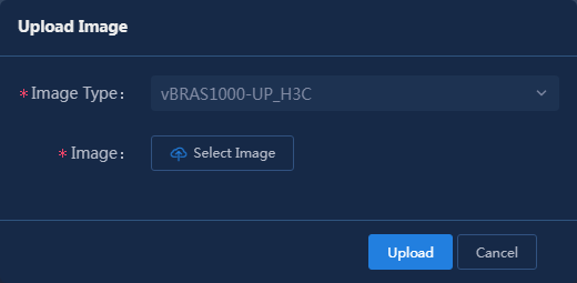

4.     Click Upload Image. In the dialog box that opens, select an image type and then an image of the corresponding type.
Figure 19 Uploading a simulation image
5.     Click Upload.

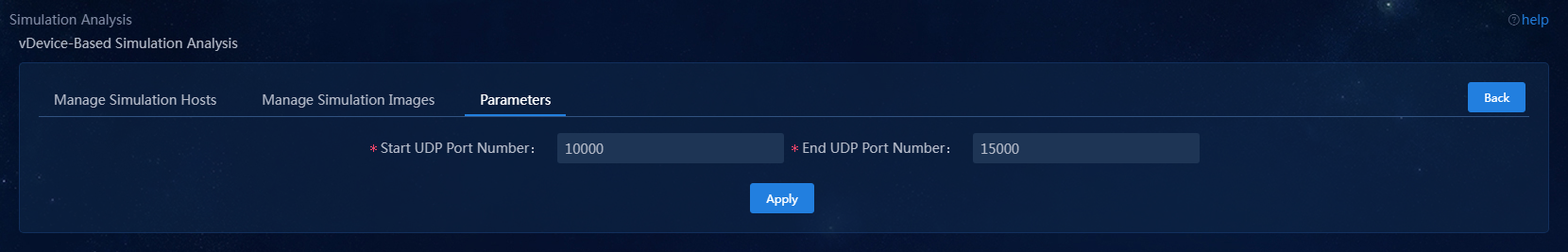

Configure parameters
3.     Click the Parameters tab.
Figure 20 Parameters
4.     Configure the following parameters as needed.
5.     Click Apply.

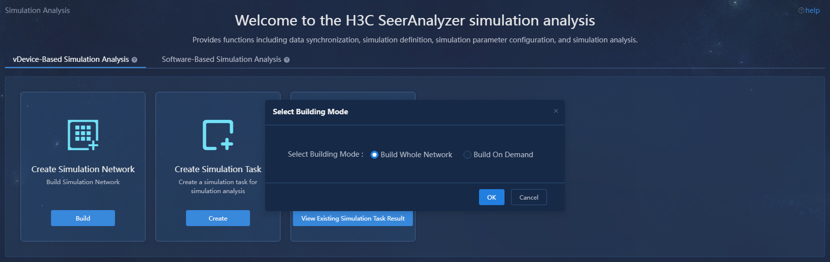

Figure 21 Selecting a building mode

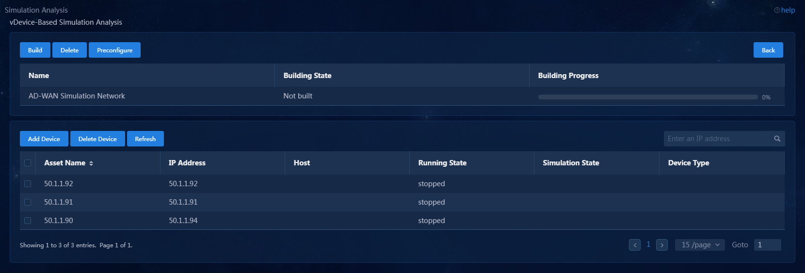

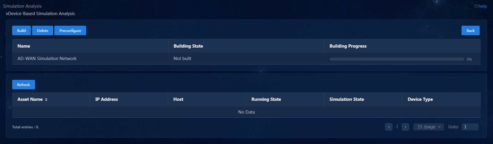

2.     After selecting the building mode, click OK to access the vDevice-Based Simulation Analysis page.
Figure 22 vDevice-based simulation analysis page for building the whole network
If you select the Build On Demand option, add devices as needed on the page as shown in Figure 23.
Figure 23 Building a simulation network on demand

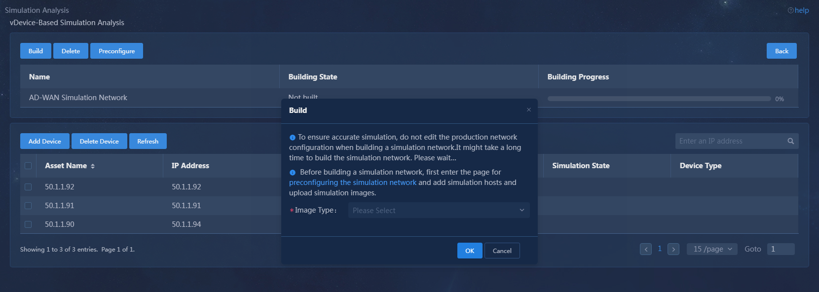

3.     Click Build on the page that opens. In the dialog box that opens, select an image type and then click OK to start building the simulation network.
Figure 24 Build a simulation network

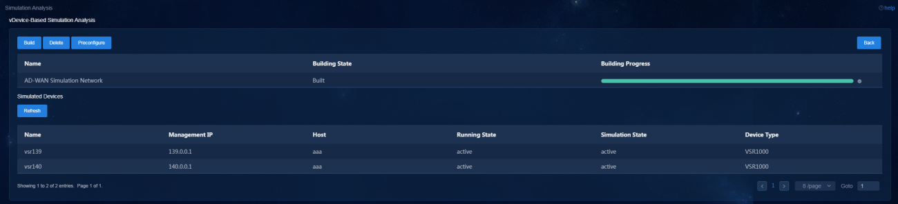

4.     During the process of building a simulation network, view the building progress.
Figure 25 Simulation network building progress
5.     After the simulation network is built successfully, you can view the simulated device information:
¡     The simulated device running state is Active.
¡     The device model is displayed correctly on the production network and the simulation network.
The VMs in the simulation network model are created on the host created. If multiple hosts are available, the simulation service selects a host with optimal resources for creating VMs.
