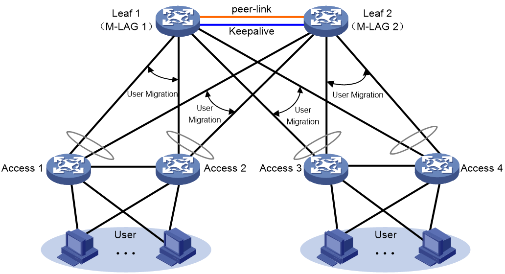

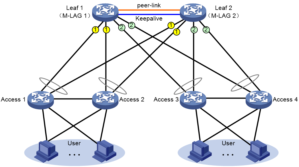

Configuring TC Snooping
As shown in Figure 18, an IRF fabric connects to two user networks through double links.
As shown in Figure 18, Device A and Device B connects to two user networks through double links.
·     The spanning tree feature is disabled on Device A and Device B and enabled on all devices in user network 1 and user network 2.
·     Device A and Device B transparently transmit BPDUs for both user networks and are not involved in the calculation of spanning trees.
When the network topology changes, it takes time for Device A and Device B to update their MAC address tables and ARP tables. During this period, traffic in the network might be interrupted.

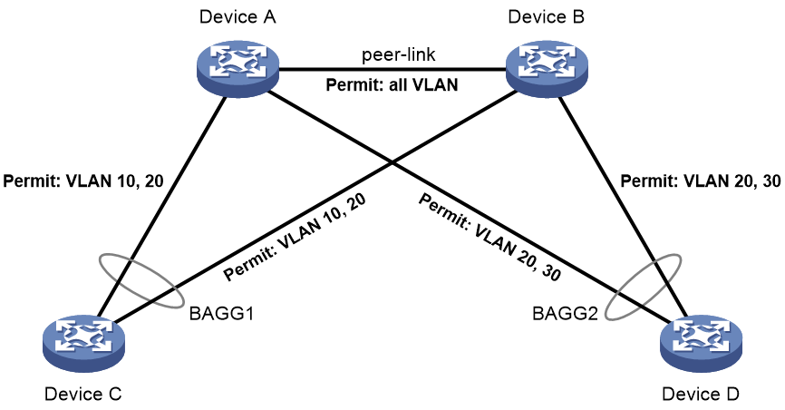

Dispute guard can be triggered by unidirectional link failures. If an upstream port receives inferior BPDUs from a downstream designated port in forwarding or learning state because of a unidirectional link failure, a loop appears. Dispute guard blocks the upstream designated port to prevent the loop.
As shown in Figure 19, in normal conditions, the spanning tree calculation result is as follows:
·     Device A is the root bridge, and Port A1 is a designated port.
·     Port B1 is blocked.
When the link between Port A1 and Port B1 fails in the direction of Port A1 to Port B1 and becomes unidirectional, the following events occur:
1.     Port A1 can only receive BPDUs and cannot send BPDUs to Port B1.
2.     Port B1 does not receive BPDUs from Port A1 for a certain period of time.
3.     Device B determines itself as the root bridge.
4.     Port B1 sends its BPDUs to Port A1.
5.     Port A1 determines the received BPDUs are inferior to its own BPDUs. A dispute is detected.
6.     Dispute guard is triggered and blocks Port A1 to prevent a loop.

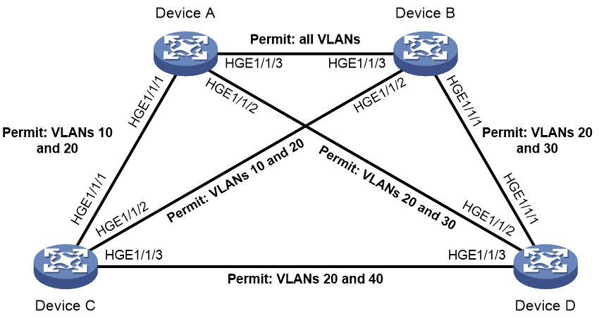

As shown in Figure 20, in normal conditions, Device A is the root bridge, and Port B1 and Port C1 are root ports. When the links between Device A and Device B become unidirectional (the links fail in the direction of Port A1 to Port B1), the following events occur:
1.     Device B cannot receive BPDUs from Device A.
2.     Device B determines itself as the root bridge.
3.     Port B1 sends BPDUs in which the root bridge is Device B to Port C1.
4.     Port C1 receives BPDUs from two root bridges, Device A and Device B. A dispute is detected.
5.     Dispute guard is triggered and blocks Port C1 to avoid a loop.
Figure 20 Dispute guard triggering scenario (on a root port)
However, dispute guard might disrupt the network connectivity. You can disable dispute guard to avoid connectivity loss in VLAN networks. As shown in Figure 21, the spanning tree feature is disabled on Device B and enabled on Device A and device C. Device B transparently transmits BPDUs.
Device C cannot receive superior BPDUs of VLAN 1 from Device A because Port B1 of Device B is configured to deny packets of VLAN 1. Device C determines itself as the root bridge after a certain period of time. Then, Port C1 sends an inferior BPDU of VLAN 100 to Device A.
When Device A receives the inferior BPDU, dispute guard blocks Port A1, which causes traffic interruption. To ensure service continuity, you can disable dispute guard on Device A to prevent the link from being blocked.
Figure 21 Disabling dispute guard application scenario
You can disable dispute guard if the network does not have unidirectional link failures.

As shown in Figure 22, two devices at the leaf tier form an M-LAG system. The M-LAG system is connected to two loops (Access 1 — Access 2 — M-LAG and Access 3 — Access 4 — M-LAG), and STP runs on all devices. By default, any topology change by a device causes TC-BPDUs to be sent to both loops and create excessive TC-BPDUs in the network, which impacts system stability. If the topology changes, the interfaces for the user onboarding service on the leaf devices might change. In this case, users must be re-authenticated on other interfaces of the leaf devices to come online. During the re-authentication process, service traffic might be lost.
Figure 22 Network diagram
To address this issue, you can configure topology change (TC) groups. A TC group is a logical combination of multiple interfaces on a device, and supports a maximum of two interfaces. As shown in Figure 23, the two M-LAG interfaces connecting to Access 1 and Access 2 are added to TC group 1, and the two M-LAG interfaces connecting to Access 3 and Access 4 are added to TC group 2 on the leaf devices.
Figure 23 Network diagram
After TC groups are configured, the network can achieve the following functions:
·     When an M-LAG interface in a TC group receives a TC-BPDU, it forwards it only to the other M-LAG interface in the same TC group. This mechanism reduces the number of TC-BPDUs in the entire network, isolating the TC-BPDUs of the Access 1—Access 2—M-LAG loop and those of the Access 3—Access 4—M-LAG loop. When leaf devices are connected to many loops, this mechanism reduces the impact of exchanging TC-BPDU packets among loops.
·     When the network topology changes, static users, MAC authentication users, and 802.1X users in the same TC group can migrate between the two M-LAG interfaces in the TC group without authentication, enabling users to quickly come online again. For more information about the configuration procedures, migration conditions, and migration rules for authentication-free migration, see port security configuration in Security Configuration Guide.

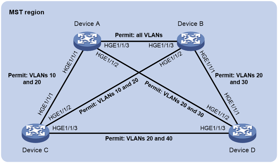

Example: Configuring MSTP
As shown in Figure 24, all devices on the network are in the same MST region. Device A and Device B work at the distribution layer. Device C and Device D work at the access layer.
Configure MSTP so that frames of different VLANs are forwarded along different spanning trees.
·     VLAN 10 frames are forwarded along MSTI 1.
·     VLAN 30 frames are forwarded along MSTI 3.
·     VLAN 40 frames are forwarded along MSTI 4.
·     VLAN 20 frames are forwarded along MSTI 0.
VLAN 10 and VLAN 30 are terminated on the distribution layer devices, and VLAN 40 is terminated on the access layer devices. The root bridges of MSTI 1 and MSTI 3 are Device A and Device B, respectively, and the root bridge of MSTI 4 is Device C.
Figure 24 Network diagram

In this example, Device B has the lowest root bridge ID. As a result, Device B is elected as the root bridge in MSTI 0.
When the network is stable, you can use the display stp brief command to display brief spanning tree information on each device.
# Display brief spanning tree information on Device A.
[DeviceA] display stp brief
 MST ID      Port                         Role  STP State     Protection
 0           HundredGigE1/1/1             ALTE  DISCARDING    NONE
 0           HundredGigE1/1/2             DESI  FORWARDING    NONE
 0           HundredGigE1/1/3             ROOT  FORWARDING    NONE
 1           HundredGigE1/1/1             DESI  FORWARDING    NONE
 1           HundredGigE1/1/3             DESI  FORWARDING    NONE
 3           HundredGigE1/1/2             DESI  FORWARDING    NONE
 3           HundredGigE1/1/3             ROOT  FORWARDING    NONE

Configure M-LAG on Device A and Device B. In the M-LAG system, Device A is the primary M-LAG device, and Device B is the secondary M-LAG device.
Configure PVST on the devices to meet the following requirements:
·     Frames of a VLAN are forwarded along the spanning trees of the VLAN.
·     VLAN 10, VLAN 20, and VLAN 30 are terminated on the distribution layer devices.
·     The root bridge of VLAN 10, VLAN 20, and VLAN 30 is the M-LAG system formed by Device A and Device B.
·     As a best practice, do not connect ports on Device A and Device B that have the same port ID with each other, for example Layer 2 aggregate ports. Otherwise, when Device A and Device B communicate through the link, the spanning tree protocol determines that the device receives its own BPDUs. Loop guard will block the link, though spanning tree features are not affected.
·     You can view port IDs of interfaces on the device by using the display stp interface command.
·     The preceding restrictions do not apply to peer-link interfaces and their member ports.
Figure 28 Network diagram
1.     Configure VLANs and VLAN member ports. (Details not shown.)
¡     Create VLAN 10, VLAN 20, and VLAN 30 on both Device A and Device B.
¡     Create VLAN 10, and VLAN 20 on Device C.
¡     Create VLAN 20, and VLAN 30 on Device D.
¡     Configure the ports on these devices as trunk ports and assign them to related VLANs.
2.     Configure M-LAG on Device A and Device B. (Details not shown.)
For more information about M-LAG, see "Configuring M-LAG."
3.     Configure Device A:
# Set the spanning tree mode to PVST.
<DeviceA> system-view
[DeviceA] stp mode pvst
# Configure the device as the root bridge of VLAN 10 and VLAN 20.
[DeviceA] stp vlan 10 20 root primary
# Enable the spanning tree feature globally and in VLAN 10, VLAN 20, and VLAN 30.
[DeviceA] stp global enable
[DeviceA] stp vlan 10 20 30 enable
4.     Configure Device B in the same way Device A is configured. (Details not shown.)
5.     Configure Device C:
<DeviceC> system-view
[DeviceC] stp mode pvst
# Enable the spanning tree feature globally and in VLAN 10, and VLAN 20.
[DeviceC] stp global enable
[DeviceC] stp vlan 10 20 enable
6.     Configure Device D:
<DeviceD> system-view
[DeviceD] stp mode pvst
# Enable the spanning tree feature globally and in VLAN 20, and VLAN 30.
[DeviceD] stp global enable
[DeviceD] stp vlan 20 30 enable
# Display brief spanning tree information of the M-LAG system on the primary M-LAG device, Device A.
VLAN ID     Port                            Role  STP State     Protection
 10         Bridge-Aggregation1 (M-LAG)     DESI  FORWARDING    NONE
 20         Bridge-Aggregation1 (M-LAG)     DESI  FORWARDING    NONE
 20         Bridge-Aggregation2 (M-LAG)     DESI  FORWARDING    NONE
 30         Bridge-Aggregation2 (M-LAG)     DESI  FORWARDING    NONE
# Display brief spanning tree information on Device C.
[DeviceC] display stp brief
 10         Bridge-Aggregation1          ROOT  FORWARDING    NONE
 20         Bridge-Aggregation1          ROOT  FORWARDING    NONE
# Display brief spanning tree information on Device D.
[DeviceD] display stp brief
 20         Bridge-Aggregation2          ROOT  FORWARDING    NONE
 30         Bridge-Aggregation2          ROOT  FORWARDING    NONE
