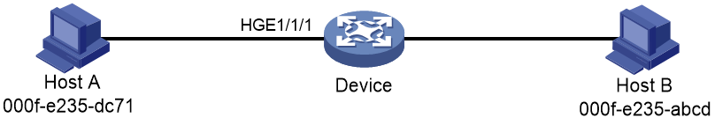

Manually configuring MAC address entries
Dynamic MAC address learning does not distinguish between illegitimate and legitimate frames, which can invite security hazards. When Host A is connected to Port A, a MAC address entry will be learned for the MAC address of Host A (for example, MAC A). When an illegal user sends frames with MAC A as the source MAC address to Port B, the device performs the following operations:
1.     Learns a new MAC address entry with Port B as the outgoing interface and overwrites the old entry for MAC A.
2.     Forwards frames destined for MAC A out of Port B to the illegal user.
As a result, the illegal user obtains the data of Host A. To improve the security for Host A, manually configure a static entry to bind Host A to Port A. Then, the frames destined for Host A are always sent out of Port A. Other hosts using the forged MAC address of Host A cannot obtain the frames destined for Host A.

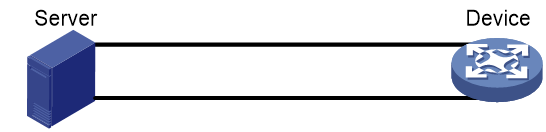

You can configure a multiport unicast MAC address entry to associate a unicast destination MAC address with multiple ports. The frame with a destination MAC address matching the entry is sent out of multiple ports.
For example, in NLB unicast mode (see Figure 1):
·     All servers within a cluster uses the cluster's MAC address as their own address.
·     Frames destined for the cluster are forwarded to every server in the group.
In this case, you can configure a multiport unicast MAC address entry on the device connected to the server group. Then, the device forwards the frame destined for the server group to every server through all ports connected to the servers within the cluster.
Figure 1 NLB cluster

Disabling MAC address learning on a VLAN
When global MAC address learning is enabled, you can disable MAC address learning on a per-VLAN basis.
As shown in Figure 2, VLAN 2, VLAN 3, and VLAN 10 are configured on the network to isolate users from different departments. To save MAC address entry resources on the core device and deny external access to these VLANs, you can disable MAC address learning for the VLANs other than VLAN 2, VLAN 3, and VLAN 10 on Device A and Device B.
Figure 2 Network diagram

Disabling the device from learning the source MAC addresses of Layer 2 protocol packets
As shown in Figure 3, the server attached to the device has two NICs that use the same MAC address. The NICs send LLDP protocol packets sourced from the same MAC address to the device, and that MAC address moves frequently between the server-facing interfaces of the device. To resolve this issue, disable the device from learning the source MAC addresses of Layer 2 protocol packets.
Figure 3 Frequent MAC moves caused by protocol packets
If you disable the device from learning the source MAC addresses of Layer 2 protocol packets, the device does not learn the source MAC addresses of the following protocol packets:

[Device] mac-address information mode syslog
# Enable MAC Information on HundredGigE 1/1/1 to enable the port to record MAC address change information when the interface performs either of the following operations:
¡     Learns a new MAC address.
¡     Deletes an existing MAC address.
[Device] interface hundredgige 1/1/1
[Device-HundredGigE1/1/1] mac-address information enable added
[Device-HundredGigE1/1/1] mac-address information enable deleted
[Device-HundredGigE1/1/1] quit
# Set the MAC Information queue length to 100.
[Device] mac-address information queue-length 100
# Set the MAC change notification interval to 20 seconds.
[Device] mac-address information interval 20
