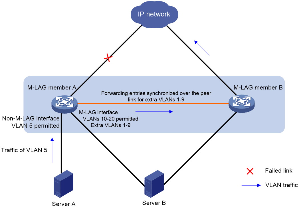

Table 4 M-LAG interface type 2 configuration
Setting
Details
VLANs permitted by an M-LAG interface
VLANs permitted by an M-LAG interface.
The M-LAG system compares tagged VLANs prior to untagged VLANs.
Using port speed as the prioritized criterion for reference port selection
Whether an M-LAG interface uses port speed as the prioritized criterion for reference port selection.
Ignoring port speed in setting the aggregation states of member ports
Whether an M-LAG interface ignores port speed in setting the aggregation states of member ports.

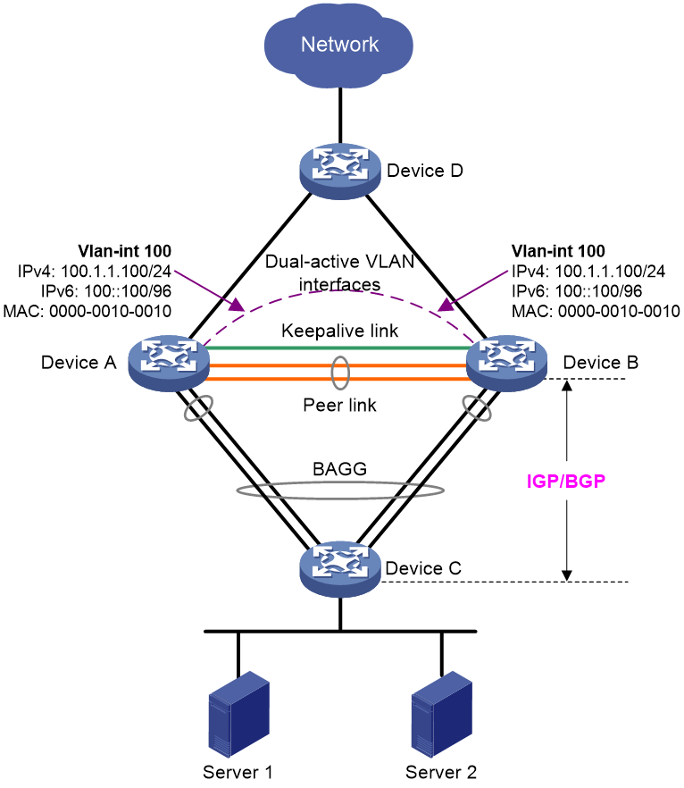

Dual-active gateways on an M-LAG system
When a Layer 3 network is dualhomed to an M-LAG system, each M-LAG member device uses a logical interface as the gateway interface for the Layer 3 network. Both logical interfaces are active to perform Layer 3 forwarding, and they use the same IP address and MAC address. When both links to the M-LAG system are operating correctly, the links load share traffic to balance bandwidth usage. When one of the links fails, the M-LAG system switches the traffic on the failed link to the other link to ensure high availability.
Typically, dual-active gateways are deployed if downstream devices run a dynamic routing protocol to communicate with the M-LAG system. As shown in Figure 4, IGP or BGP runs between Device C and the M-LAG system. To configure dual-active VLAN interfaces, perform the following tasks on Device A and Device B:
1.     Create VLAN interfaces for the same VLAN, VLAN-interface 100 for example, assign the same IPv4, IPv6, and MAC addresses to the VLAN interfaces, and assign the M-LAG interfaces to that VLAN.
2.     Assign different M-LAG VIPs to the VLAN interfaces.
Device A and Device B use their M-LAG VIPs to set up IGP or BGP peer relationships with Device C and with each other.
Figure 4 Layer 3 access to an M-LAG system through dynamic routing protocols

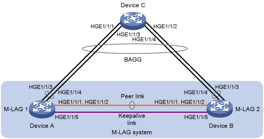

M-LAG interface failure handling mechanism
When the M-LAG interface of one M-LAG member device fails, the M-LAG system forwards traffic through the other M-LAG member device.
As shown in Figure 5, Device A and Device B form an M-LAG system, to which Device C is attached through a multichassis aggregation. If traffic to Device C arrives at Device B after the M-LAG interface connected Device B to Device C has failed, the M-LAG system forwards the traffic as follows:
1.     Device B sends the traffic to Device A over the peer link.
2.     Device A forwards the downlink traffic received from the peer link to Device C.
After the faulty M-LAG interface comes up, Device B forwards traffic to Device C through the M-LAG interface.
Figure 5 M-LAG interface failure handling mechanism

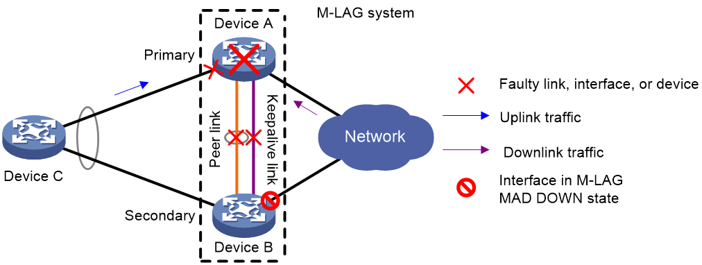

Mechanisms to handle concurrent peer link and keepalive link failures
When both the peer link and the keepalive link are down, the M-LAG member devices handle this situation depending on your configuration.
Default failure handling mechanism
Figure 9 shows the default mechanism to handle peer link and keepalive link failures when the M-LAG standalone mode and M-LAG MAD DOWN state persistency features are not configured.
·     If the peer link goes down while the keepalive link is up, the M-LAG member devices negotiate their roles over the keepalive link. M-LAG MAD shuts down all network interfaces on the secondary M-LAG member device except those excluded from the shutdown action by M-LAG MAD.
·     If the keepalive link goes down while the peer link is down, the secondary M-LAG member device sets its role to primary and brings up the network interfaces in M-LAG MAD DOWN state to forward traffic. In this situation, both of the M-LAG member devices might operate with the primary role to forward traffic. Forwarding errors might occur because the M-LAG member devices cannot synchronize MAC address entries over the peer link.
·     If the keepalive link is down before the peer link goes down, M-LAG MAD will not place network interfaces in M-LAG MAD DOWN state. Both M-LAG member devices can operate with the primary role to forward traffic.
Figure 9 Default failure handling mechanism
Failure handling mechanism with M-LAG MAD DOWN state persistence
Figure 10 shows the mechanism to handle peer link and keepalive link failures when the M-LAG MAD DOWN state persistence feature is configured.
·     If the keepalive link goes down while the peer link is down, the secondary M-LAG member device sets its role to primary, but it does not bring up the network interfaces in M-LAG MAD DOWN state. Only the original primary member device can forward traffic.
Figure 10 Failure handling mechanism with M-LAG MAD DOWN state persistence
As shown in Figure 11, you can bring up the interfaces in M-LAG MAD DOWN state on the secondary M-LAG member device for it to forward traffic if the following conditions exist:
·     Both the peer link and the keepalive link are down.
·     The primary M-LAG member device fails or its M-LAG interface fails.
Figure 11 Bringing up the interfaces in M-LAG MAD DOWN state
Failure handling mechanism with M-LAG standalone mode
Figure 12 shows the mechanism to handle peer link and keepalive link failures when the M-LAG standalone mode feature is configured.
·     If the keepalive link goes down while the peer link is down, both M-LAG member devices change to M-LAG standalone mode. The secondary M-LAG member device sets its role to primary and brings up its network interfaces in M-LAG MAD DOWN state. In M-LAG standalone mode, only the aggregation member ports on one M-LAG member device can become Selected to forward traffic. For more information about how M-LAG standalone mode operates, see "M-LAG standalone mode."

Configuring M-LAG extra VLANs
For VLANs permitted only on non-M-LAG interfaces, the device processes traffic locally and do not synchronize forwarding entries such as MAC and ARP entries with the M-LAG peer device. For the device to synchronize forwarding entries for such VLANs, configure them as extra VLANs. The device will synchronize forwarding entries for the extra VLANs even though they are not permitted on M-LAG interfaces, as shown in Figure 13. When the uplink of one M-LAG member device fails, traffic of the extra VLANs can fail over to the other M-LAG member device through the peer link.
Figure 13 M-LAG extra VLANs
2.     Configure M-LAG extra VLANs.
m-lag extra-vlan vlan-id-list
By default, no M-LAG extra VLANs are configured.

Example: Configuring basic M-LAG functions
As shown in Figure 14, configure M-LAG on Device A and Device B to establish a multichassis aggregate link with Device C.
Figure 14 Network diagram
1.     Configure Device A:
# Configure M-LAG system settings.
<DeviceA> system-view
[DeviceA] m-lag system-mac 1-1-1
[DeviceA] m-lag system-number 1
[DeviceA] m-lag system-priority 123
# Configure M-LAG keepalive packet parameters.
[DeviceA] m-lag keepalive ip destination 1.1.1.1 source 1.1.1.2
# Set the link mode of HundredGigE 1/1/5 to Layer 3, and assign the interface an IP address. The IP address will be used as the source IP address of keepalive packets.
[DeviceA] interface hundredgige 1/1/5
[DeviceA-HundredGigE1/1/5] port link-mode route
[DeviceA-HundredGigE1/1/5] ip address 1.1.1.2 24
[DeviceA-HundredGigE1/1/5] quit
# Exclude the interface used for M-LAG keepalive detection (HundredGigE 1/1/5) from the shutdown action by M-LAG MAD.
[DeviceA] m-lag mad exclude interface hundredgige 1/1/5
# Create Layer 2 dynamic aggregate interface Bridge-Aggregation 3.
[DeviceA] interface bridge-aggregation 3
[DeviceA-Bridge-Aggregation3] link-aggregation mode dynamic
[DeviceA-Bridge-Aggregation3] quit
# Assign HundredGigE 1/1/1 and HundredGigE 1/1/2 to aggregation group 3.
[DeviceA] interface hundredgige 1/1/1
[DeviceA-HundredGigE1/1/1] port link-aggregation group 3
[DeviceA-HundredGigE1/1/1] quit
[DeviceA] interface hundredgige 1/1/2
[DeviceA-HundredGigE1/1/2] port link-aggregation group 3
[DeviceA-HundredGigE1/1/2] quit
# Specify Bridge-Aggregation 3 as the peer-link interface.
[DeviceA-Bridge-Aggregation3] port m-lag peer-link 1
[DeviceA-Bridge-Aggregation3] undo mac-address static source-check enable
# Create Layer 2 dynamic aggregate interface Bridge-Aggregation 4.
[DeviceA] interface bridge-aggregation 4
[DeviceA-Bridge-Aggregation4] link-aggregation mode dynamic
[DeviceA-Bridge-Aggregation4] quit
# Assign HundredGigE 1/1/3 and HundredGigE 1/1/4 to aggregation group 4.
[DeviceA] interface hundredgige 1/1/3
[DeviceA-HundredGigE1/1/3] port link-aggregation group 4
[DeviceA-HundredGigE1/1/3] quit
[DeviceA] interface hundredgige 1/1/4
[DeviceA-HundredGigE1/1/4] port link-aggregation group 4
[DeviceA-HundredGigE1/1/4] quit
# Assign Bridge-Aggregation 4 to M-LAG group 4.
[DeviceA-Bridge-Aggregation4] port m-lag group 4
2.     Configure Device B:
<DeviceB> system-view
[DeviceB] m-lag system-mac 1-1-1
[DeviceB] m-lag system-number 2
[DeviceB] m-lag system-priority 123
[DeviceB] m-lag keepalive ip destination 1.1.1.2 source 1.1.1.1
[DeviceB] interface hundredgige 1/1/5
[DeviceB-HundredGigE1/1/5] port link-mode route
[DeviceB-HundredGigE1/1/5] ip address 1.1.1.1 24
[DeviceB-HundredGigE1/1/5] quit
[DeviceB] m-lag mad exclude interface hundredgige 1/1/5
[DeviceB] interface bridge-aggregation 3
[DeviceB-Bridge-Aggregation3] link-aggregation mode dynamic
[DeviceB-Bridge-Aggregation3] quit
[DeviceB] interface hundredgige 1/1/1
[DeviceB-HundredGigE1/1/1] port link-aggregation group 3
[DeviceB-HundredGigE1/1/1] quit
[DeviceB] interface hundredgige 1/1/2
[DeviceB-HundredGigE1/1/2] port link-aggregation group 3
[DeviceB-HundredGigE1/1/2] quit
[DeviceB-Bridge-Aggregation3] port m-lag peer-link 1
[DeviceB-Bridge-Aggregation3] undo mac-address static source-check enable
[DeviceB] interface bridge-aggregation 4
[DeviceB-Bridge-Aggregation4] link-aggregation mode dynamic
[DeviceB-Bridge-Aggregation4] quit
[DeviceB] interface hundredgige 1/1/3
[DeviceB-HundredGigE1/1/3] port link-aggregation group 4
[DeviceB-HundredGigE1/1/3] quit
[DeviceB] interface hundredgige 1/1/4
[DeviceB-HundredGigE1/1/4] port link-aggregation group 4
[DeviceB-HundredGigE1/1/4] quit
[DeviceB-Bridge-Aggregation4] port m-lag group 4
3.     Configure Device C:
<DeviceC> system-view
[DeviceC] interface bridge-aggregation 4
[DeviceC-Bridge-Aggregation4] link-aggregation mode dynamic
[DeviceC-Bridge-Aggregation4] quit
# Assign HundredGigE 1/1/1 through HundredGigE 1/1/4 to aggregation group 4.
[DeviceC] interface range hundredgige 1/1/1 to hundredgige 1/1/4
[DeviceC-if-range] port link-aggregation group 4
[DeviceC-if-range] quit
# Verify that the keepalive link is working correctly on Device A.
[DeviceA] display m-lag keepalive

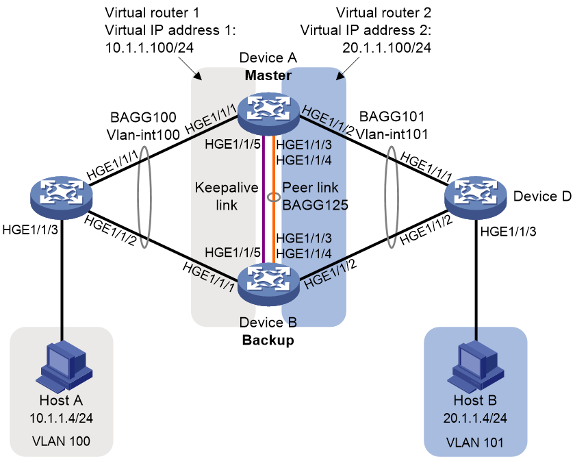

Example: Configuring Layer 3 gateways on an M-LAG system
As shown in Figure 15:
·     Configure Device A and Device B as an M-LAG system to establish one multichassis aggregate link with Device C and one with Device D.
·     Set up a keepalive link between HundredGigE 1/1/5 of Device A and HundredGigE 1/1/5 of Device B, and exclude the interfaces from the shutdown action by M-LAG MAD.
·     Configure two VRRP groups on Device A and Device B to provide gateway services for VLAN 100 and VLAN 200. Configure Device A as the master of the VRRP groups.
Figure 15 Network diagram
# Configure M-LAG keepalive parameters.
[DeviceA] m-lag keepalive ip destination 1.1.1.2 source 1.1.1.1
[DeviceA-HundredGigE1/1/5] ip address 1.1.1.1 24
# Create Layer 2 dynamic aggregate interface Bridge-Aggregation 125.
[DeviceA] interface bridge-aggregation 125
[DeviceA-Bridge-Aggregation125] link-aggregation mode dynamic
[DeviceA-Bridge-Aggregation125] quit
# Assign HundredGigE 1/1/3 and HundredGigE 1/1/4 to aggregation group 125.
[DeviceA-HundredGigE1/1/3] port link-aggregation group 125
[DeviceA] interface HundredGigE 1/1/4
[DeviceA-HundredGigE1/1/4] port link-aggregation group 125
# Specify Bridge-Aggregation 125 as the peer-link interface.
[DeviceA-Bridge-Aggregation125] port m-lag peer-link 1
[DeviceA-Bridge-Aggregation125] undo mac-address static source-check enable
# Create Layer 2 dynamic aggregate interface Bridge-Aggregation 100, and assign it to M-LAG group 1.
[DeviceA] interface bridge-aggregation 100
[DeviceA-Bridge-Aggregation100] link-aggregation mode dynamic
[DeviceA-Bridge-Aggregation100] port m-lag group 1
[DeviceA-Bridge-Aggregation100] quit
# Assign HundredGigE 1/1/1 to aggregation group 100.
[DeviceA-HundredGigE1/1/1] port link-aggregation group 100
# Create Layer 2 dynamic aggregate interface Bridge-Aggregation 101, and assign it to M-LAG group 2.
[DeviceA] interface bridge-aggregation 101
[DeviceA-Bridge-Aggregation101] link-aggregation mode dynamic
[DeviceA-Bridge-Aggregation101] port m-lag group 2
[DeviceA-Bridge-Aggregation101] quit
# Assign HundredGigE 1/1/2 to aggregation group 101.
[DeviceA-HundredGigE1/1/2] port link-aggregation group 101
# Create VLAN 100 and VLAN 101.
[DeviceA] vlan 100
[DeviceA-vlan100] quit
[DeviceA] vlan 101
[DeviceA-vlan101] quit
# Set the link type of Bridge-Aggregation 100 to trunk, and assign it to VLAN 100.
[DeviceA-Bridge-Aggregation100] port link-type trunk
[DeviceA-Bridge-Aggregation100] port trunk permit vlan 100
# Set the link type of Bridge-Aggregation 101 to trunk, and assign it to VLAN 101.
[DeviceA-Bridge-Aggregation101] port link-type trunk
[DeviceA-Bridge-Aggregation101] port trunk permit vlan 101
# Create VLAN-interface 100 and VLAN-interface 101, and assign IP addresses to them.
[DeviceA] interface vlan-interface 100
[DeviceA-vlan-interface100] ip address 10.1.1.1 24
[DeviceA-vlan-interface100] quit
[DeviceA] interface vlan-interface 101
[DeviceA-vlan-interface101] ip address 20.1.1.1 24
[DeviceA-vlan-interface101] quit
# Exclude VLAN-interface 100 and VLAN-interface 101 from the shutdown action by M-LAG MAD.
[DeviceA] m-lag mad exclude interface vlan-interface 100
[DeviceA] m-lag mad exclude interface vlan-interface 101
# Configure OSPF.
[DeviceA] ospf
[DeviceA-ospf-1] import-route direct
[DeviceA-ospf-1] area 0
[DeviceA-ospf-1-area-0.0.0.0] network 10.1.1.0 0.0.0.255
[DeviceA-ospf-1-area-0.0.0.0] network 20.1.1.0 0.0.0.255
[DeviceA-ospf-1-area-0.0.0.0] quit
[DeviceA-ospf-1] quit
# Create VRRP group 1 on VLAN-interface 100 and set its virtual IP address to 10.1.1.100.
[DeviceA-Vlan-interface100] vrrp vrid 1 virtual-ip 10.1.1.100
# Set the priority of Device A (primary M-LAG member device) to 200 for it to become the master in VRRP group 1.
[DeviceA-Vlan-interface100] vrrp vrid 1 priority 200
[DeviceA-Vlan-interface100] quit
# Create VRRP group 2 on VLAN-interface 101 and set its virtual IP address to 20.1.1.100.
[DeviceA-Vlan-interface101] vrrp vrid 2 virtual-ip 20.1.1.100
# Set the priority of Device A (primary M-LAG member device) to 200 for it to become the master in VRRP group 2.
[DeviceA-Vlan-interface101] vrrp vrid 2 priority 200
[DeviceA-Vlan-interface101] quit

# Verify that Device A has formed an M-LAG system with Device B.
[DeviceA] display m-lag summary
Flags: A -- Aggregate interface down, B -- No peer M-LAG interface configured
       C -- Configuration consistency check failed
Peer-link interface: BAGG125
Peer-link interface state (cause): UP
Keepalive link state (cause): UP
                     M-LAG interface information
M-LAG IF      M-LAG group  Local state (cause)  Peer state  Remaining down time(s)
BAGG100       1            UP                   UP          -
BAGG101       2            UP                   UP          -
[DeviceA] display m-lag verbose
Flags: A -- Home_Gateway, B -- Neighbor_Gateway, C -- Other_Gateway,
       D -- PeerLink_Activity, E -- DRCP_Timeout, F -- Gateway_Sync,
       G -- Port_Sync, H -- Expired
Peer-link interface/Peer-link interface ID: BAGG125/1
State: UP
Cause: -
Local DRCP flags/Peer DRCP flags: ABDFG/ABDFG
Local Selected ports (index): HGE1/1/3 (260), HGE1/1/4 (261)
Peer Selected ports indexes: 260, 261
M-LAG interface/M-LAG group ID: BAGG100/1
Local M-LAG interface state: UP
Peer M-LAG interface state: UP
M-LAG group state: UP
Local M-LAG interface down cause: -
Remaining M-LAG DOWN time: -
Local M-LAG interface LACP MAC: Config=N/A, Effective=0001-0001-0001
Peer M-LAG interface LACP MAC: Config=N/A, Effective=0001-0001-0001
Local M-LAG interface LACP priority: Config=32768, Effective=123
Peer M-LAG interface LACP priority: Config=32768, Effective=123
Local Selected ports (index): HGE1/1/1 (258)
Peer Selected ports indexes: 258
M-LAG interface/M-LAG group ID: BAGG101/2
Local Selected ports (index): HGE1/1/2 (259)
Peer Selected ports indexes: 259
# Verify that Device C and Device D have correctly set up aggregate links with the M-LAG system.
[DeviceC] display link-aggregation verbose
Loadsharing Type: Shar -- Loadsharing, NonS -- Non-Loadsharing
Port Status: S -- Selected, U -- Unselected, I -- Individual
Port: A -- Auto port, M -- Management port, R -- Reference port
Flags:  A -- LACP_Activity, B -- LACP_Timeout, C -- Aggregation,
        G -- Defaulted, H -- Expired
Aggregate Interface: Bridge-Aggregation100
Creation Mode: Manual
Aggregation Mode: Dynamic
Management VLANs: None
System ID: 0x8000, a03b-0694-0300
Local:
  Port                Status   Priority Index    Oper-Key               Flag
  HGE1/1/1            S        32768    1        1                      {ACDEF}
  HGE1/1/2            S        32768    2        1                      {ACDEF}
Remote:
  Actor               Priority Index    Oper-Key SystemID               Flag
  HGE1/1/1(R)         32768    16386    40001    0x7b  , 0001-0001-0001 {ACDEF}
  HGE1/1/2            32768    32770    40001    0x7b  , 0001-0001-0001 {ACDEF}
[DeviceD] display link-aggregation verbose
Aggregate Interface: Bridge-Aggregation101
System ID: 0x8000, a03b-0d51-0400
Local:
Remote:
  HGE1/1/1(R)         32768    16387    40002    0x7b  , 0001-0001-0001 {ACDEF}
  HGE1/1/2            32768    32771    40002    0x7b  , 0001-0001-0001 {ACDEF}
# Verify that Device A is the master in VRRP group 1 and VRRP group 2.
[DeviceA] display vrrp
IPv4 Virtual Router Information:
 Running mode : Standard
 Total number of virtual routers : 2
 Interface          VRID  State        Running Adver   Auth             Virtual
                                       Pri     Timer   Type             IP
 Vlan100            1     Master       200     100     None             10.1.1.100
 Vlan101            2     Master       200     100     None             20.1.1.100
[DeviceB] display vrrp
                                       Pri     Timer   Type             IP
 Vlan100            1     Backup       100     100     None             10.1.1.100
 Vlan101            2     Backup       100     100     None             20.1.1.100
# Verify that Device C and Device D have established OSPF neighbor relationships with Device A and Device B.
[DeviceC] display ospf peer
         OSPF Process 1 with Router ID 10.1.1.3
               Neighbor Brief Information
 Area: 0.0.0.0
 Router ID       Address         Pri Dead-Time  State             Interface
 20.1.1.1        10.1.1.1        1   37         Full/DR           Vlan100
 20.1.1.2        10.1.1.2        1   32         Full/BDR          Vlan100
[DeviceD] display ospf peer
         OSPF Process 1 with Router ID 20.1.1.3
 Area: 0.0.0.0
 20.1.1.1        20.1.1.1        1   38         Full/DR           Vlan101
 20.1.1.2        20.1.1.2        1   37         Full/BDR          Vlan101
# Verify that Host A and Host B can ping each other. (Details not shown.)
Example: Configure dual-active gateways on an M-LAG system
As shown in Figure 16, set up an M-LAG system with Device A and Device B and configure dual-active gateways for the servers on Device A and Device B.
Figure 16 Network diagram
In this example, all devices use the factory default settings. When you apply this configuration example to a live environment, make sure the existing configurations do not conflict with the configurations in this example.
You must configure the same M-LAG system MAC address on the M-LAG member devices in the same M-LAG system. You must assign unique M-LAG system MAC addresses to different M-LAG systems.
To avoid loops, do not configure local proxy ARP or ND on the downstream VLAN interfaces of the M-LAG member devices. For more information about local proxy ARP or ND, see proxy ARP configuration and IPv6 neighbor discovery in Layer 3—IP Services Configuration Guide.
1.     Configure Device A to form an M-LAG system:
[DeviceA] m-lag system-mac 2-2-2
[DeviceA] m-lag keepalive ip destination 21.1.1.2 source 21.1.1.1
# Set the link mode of HundredGigE 1/1/5 to Layer 3, and assign the interface IPv4 and IPv6 addresses. The IPv4 address will be used as the source IP address of keepalive packets.
[DeviceA-HundredGigE1/1/5] ip address 21.1.1.1 24
[DeviceA-HundredGigE1/1/5] ipv6 address 21::1 64
# Create Layer 2 dynamic aggregate interface Bridge-Aggregation 1.
[DeviceA-Bridge-Aggregation1] link-aggregation mode dynamic
[DeviceA-Bridge-Aggregation1] quit
# Assign HundredGigE 1/1/3 and HundredGigE 1/1/4 to aggregation group 1.
# Configure Bridge-Aggregation 1 as the peer-link interface.
[DeviceA-Bridge-Aggregation1] port m-lag peer-link 1
[DeviceA-Bridge-Aggregation1] undo mac-address static source-check enable
# Create Layer 2 dynamic aggregate interface Bridge-Aggregation 3, and assign it to M-LAG group 1.
[DeviceA-Bridge-Aggregation3] port m-lag group 1
# Create VLAN 102 and VLAN 103.
[DeviceA] vlan 102 103
# Set the link type of Bridge-Aggregation 3 to trunk, and assign it to VLAN 102 and VLAN 103.
[DeviceA-Bridge-Aggregation3] port link-type trunk
[DeviceA-Bridge-Aggregation3] port trunk permit vlan 102 103
[DeviceB] m-lag system-mac 2-2-2
[DeviceB] m-lag keepalive ip destination 21.1.1.1 source 21.1.1.2
[DeviceB-HundredGigE1/1/5] ip address 21.1.1.2 255.255.255.0
[DeviceB-HundredGigE1/1/5] ipv6 address 21::2 64
[DeviceB] interface bridge-aggregation 1
[DeviceB-Bridge-Aggregation1] link-aggregation mode dynamic
