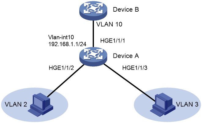

The Virtual Local Area Network (VLAN) technology divides a physical LAN into multiple logical LANs. It has the following benefits:
·     Security—Hosts in the same VLAN can communicate with one another at Layer 2, but they are isolated from hosts in other VLANs at Layer 2.
·     Broadcast traffic isolation—Each VLAN is a broadcast domain that limits the transmission of broadcast packets.

Hosts of different VLANs use VLAN interfaces to communicate at Layer 3. VLAN interfaces are virtual interfaces that do not exist as physical entities on devices. For each VLAN, you can create one VLAN interface and assign an IP address to it. The VLAN interface acts as the gateway of the VLAN to forward packets at Layer 3. When the IP addresses of multiple VLAN interfaces are on different subnets, you must configure IP routing protocols to enable Layer 3 communication between these IP addresses. Then, the devices can forward packets at Layer 3 across subnets between different VLANs. For more information about IP routing protocols, see Layer 3—IP Routing Configuration Guide.

Super VLAN configuration examples
Example: Configuring a super VLAN
As shown in Figure 3:
·     HundredGigE 1/1/1 and HundredGigE 1/1/2 are in VLAN 2.
·     HundredGigE 1/1/3 and HundredGigE 1/1/4 are in VLAN 3.
·     HundredGigE 1/1/5 and HundredGigE 1/1/6 are in VLAN 5.
To save IP addresses and enable sub-VLANs to be isolated at Layer 2 but interoperable at Layer 3, perform the following tasks:
·     Create a super VLAN and assign an IP address to its VLAN interface.
·     Associate the super VLAN with VLANs 2, 3, and 5.
Figure 3 Network diagram

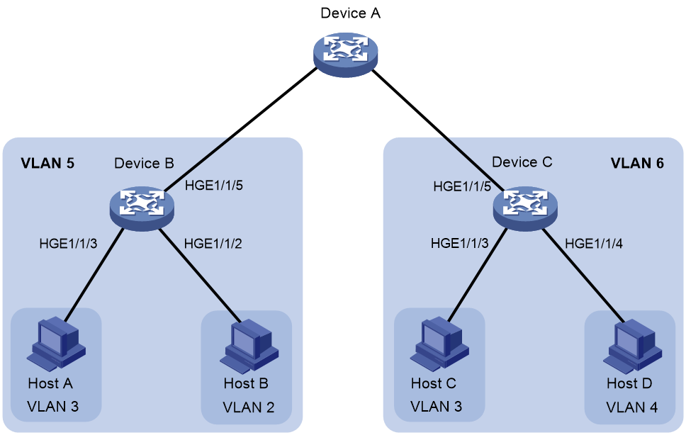

Configuring private VLAN
About private VLAN
VLAN technology provides a method for isolating traffic from customers. At the access layer of a network, customer traffic must be isolated for security or accounting purposes. If VLANs are assigned on a per-user basis, a large number of VLANs will be required.
The private VLAN feature saves VLAN resources. It uses a two-tier VLAN structure as follows:
·     Primary VLAN—Used for connecting the upstream device. A primary VLAN can be associated with multiple secondary VLANs. The upstream device identifies only the primary VLAN.
·     Secondary VLANs—Used for connecting users. Secondary VLANs are isolated at Layer 2. To implement Layer 3 communication between secondary VLANs associated with the primary VLAN, enable local proxy ARP or ND on the upstream device (for example, L3 Device A in Figure 4).
As shown in Figure 4, the private VLAN feature is enabled on L2 Device B. VLAN 10 is the primary VLAN. VLANs 2, 5, and 8 are secondary VLANs that are associated with VLAN 10. L3 Device A is only aware of VLAN 10.
Figure 4 Private VLAN example
If the private VLAN feature is configured on a Layer 3 device, use one of the following methods on the Layer 3 device to enable Layer 3 communication. Layer 3 communication might be required between secondary VLANs that are associated with the same primary VLAN, or between secondary VLANs and other networks.
·     Method 1:
a.     Create VLAN interfaces for the secondary VLANs.
b.     Assign IP addresses to the secondary VLAN interfaces.
·     Method 2:
a.     Enable Layer 3 communication between the secondary VLANs that are associated with the primary VLAN.
b.     Create the VLAN interface for the primary VLAN and assign an IP address to it. (Do not create secondary VLAN interfaces if you use this method.)
c.     Enable local proxy ARP or ND on the primary VLAN interface.

Example: Configuring promiscuous ports
As shown in Figure 5, configure the private VLAN feature to meet the following requirements:
·     On Device B, VLAN 5 is a primary VLAN that is associated with secondary VLANs 2 and 3. HundredGigE 1/1/5 is in VLAN 5. HundredGigE 1/1/2 is in VLAN 2. HundredGigE 1/1/3 is in VLAN 3.
·     On Device C, VLAN 6 is a primary VLAN that is associated with secondary VLANs 3 and 4. HundredGigE 1/1/5 is in VLAN 6. HundredGigE 1/1/3 is in VLAN 3. HundredGigE 1/1/4 is in VLAN 4.
·     Device A is aware of only VLAN 5 on Device B and VLAN 6 on Device C.
Figure 5 Network diagram
This example describes the configurations on Device B and Device C.

# Verify the private VLAN configurations on the devices, for example, on Device B.
[DeviceB] display private-vlan
 Primary VLAN ID: 5
 Secondary VLAN ID: 2-3
 VLAN ID: 5
 VLAN type: Static
 Private VLAN type: Primary
 Route interface: Not configured
 Description: VLAN 0005
 Tagged ports:   None
 Untagged ports:
    HundredGigE1/1/2
    HundredGigE1/1/3
    HundredGigE1/1/5
 VLAN ID: 2
 VLAN type: Static
 Private VLAN type: Secondary
 Description: VLAN 0002
 Tagged ports:   None
 Untagged ports:
    HundredGigE1/1/2
    HundredGigE1/1/5
 VLAN ID: 3
 VLAN type: Static
 Description: VLAN 0003
 Tagged Ports:   None
 Untagged Ports:
    HundredGigE1/1/3
    HundredGigE1/1/5
The output shows that:
·     The promiscuous port (HundredGigE 1/1/5) is an untagged member of primary VLAN 5 and secondary VLANs 2 and 3.
·     Host port HundredGigE 1/1/2 is an untagged member of primary VLAN 5 and secondary VLAN 2.
·     Host port HundredGigE 1/1/3 is an untagged member of primary VLAN 5 and secondary VLAN 3.

Example: Configuring Layer 3 communication for secondary VLANs
As shown in Figure 8, configure the private VLAN feature to meet the following requirements:
·     Primary VLAN 10 on Device A is associated with secondary VLANs 2 and 3. The IP address of VLAN-interface 10 is 192.168.1.1/24.
·     HundredGigE 1/1/1 belongs to VLAN 10. HundredGigE 1/1/2 and HundredGigE 1/1/3 belong to VLAN 2 and VLAN 3, respectively.
·     Secondary VLANs are isolated at Layer 2 but interoperable at Layer 3.
Figure 8 Network diagram
# Create VLAN 10 and configure it as a primary VLAN.
<DeviceA> system-view
[DeviceA] vlan 10
[DeviceA-vlan10] private-vlan primary
[DeviceA-vlan10] quit
# Create VLANs 2 and 3.
[DeviceA] vlan 2 to 3
# Associate primary VLAN 10 with secondary VLANs 2 and 3.
[DeviceA] vlan 10
[DeviceA-vlan10] private-vlan secondary 2 3
# Configure the uplink port (HundredGigE 1/1/1) as a promiscuous port of VLAN 10.
[DeviceA] interface hundredgige 1/1/1
[DeviceA-HundredGigE1/1/1] port private-vlan 10 promiscuous
[DeviceA-HundredGigE1/1/1] quit
# Assign downlink port HundredGigE 1/1/2 to VLAN 2, and configure the port as a host port.
[DeviceA] interface hundredgige 1/1/2
[DeviceA-HundredGigE1/1/2] port access vlan 2
[DeviceA-HundredGigE1/1/2] port private-vlan host
[DeviceA-HundredGigE1/1/2] quit
# Assign downlink port HundredGigE 1/1/3 to VLAN 3, and configure the port as a host port.
[DeviceA] interface hundredgige 1/1/3
[DeviceA-HundredGigE1/1/3] port access vlan 3
[DeviceA-HundredGigE1/1/3] port private-vlan host
[DeviceA-HundredGigE1/1/3] quit
# Enable Layer 3 communication between secondary VLANs 2 and 3 that are associated with primary VLAN 10.
[DeviceA] interface vlan-interface 10
[DeviceA-Vlan-interface10] private-vlan secondary 2 3
# Assign IP address 192.168.1.1/24 to VLAN-interface 10.
[DeviceA-Vlan-interface10] ip address 192.168.1.1 255.255.255.0
# Enable local proxy ARP on VLAN-interface 10.
[DeviceA-Vlan-interface10] local-proxy-arp enable
[DeviceA-Vlan-interface10] quit
# Display the configuration of primary VLAN 10.
[DeviceA] display private-vlan 10
 Primary VLAN ID: 10
 VLAN ID: 10
 VLAN type: Static
 Route interface: Configured
 IPv4 address: 192.168.1.1
 IPv4 subnet mask: 255.255.255.0
 Description: VLAN 0010
 Tagged ports:   None
 Untagged ports:
    HundredGigE1/1/1
    HundredGigE1/1/2
    HundredGigE1/1/3
 VLAN ID: 2
 VLAN type: Static
 Tagged ports:   None
 Untagged ports:
    HundredGigE1/1/1
    HundredGigE1/1/2
 VLAN ID: 3
 VLAN type: Static
 Tagged ports:   None
 Untagged ports:
    HundredGigE1/1/1
    HundredGigE1/1/3
The Route interface field in the output is Configured, indicating that secondary VLANs 2 and 3 are interoperable at Layer 3.
