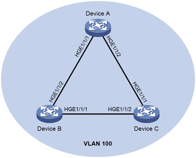

As shown in Figure 3, configure loop detection on Device A to meet the following requirements:
·     Device A generates a log as a notification.
·     Device A automatically shuts down the interface on which a loop is detected.
Figure 3 Network diagram

# View the system logs on devices, for example, Device A.
[DeviceA]
%Feb 24 15:04:29:663 2019 DeviceA LPDT/4/LPDT_LOOPED:  A loop was detected on HundredGigE1/1/1.
%Feb 24 15:04:29:664 2019 DeviceA LPDT/4/LPDT_VLAN_LOOPED: A loop was detected on HundredGigE1/1/1 in VLAN 100.
%Feb 24 15:04:29:667 2019 DeviceA LPDT/4/LPDT_LOOPED: A loop was detected on HundredGigE1/1/2.
%Feb 24 15:04:29:668 2019 DeviceA LPDT/4/LPDT_VLAN_LOOPED: A loop was detected on HundredGigE1/1/2 in VLAN 100.
%Feb 24 15:04:44:243 2019 DeviceA LPDT/5/LPDT_VLAN_RECOVERED: A loop was removed on HundredGigE1/1/1 in VLAN 100.
%Feb 24 15:04:44:243 2019 DeviceA LPDT/5/LPDT_RECOVERED: All loops were removed on HundredGigE1/1/1.
%Feb 24 15:04:44:248 2019 DeviceA LPDT/5/LPDT_VLAN_RECOVERED: A loop was removed on HundredGigE1/1/2 in VLAN 100.

Example: Configuring loop detection for protected VLANs
As shown in Figure 4, configure loop detection on Device A to meet the following requirements:
·     Device A automatically blocks a protected VLAN on an interface if a loop is detected in the VLAN on the interface.
Figure 4 Network diagram
1.     Configure Device A:
# Create VLAN 100, configure it as a protected VLAN, and then globally enable loop detection for the VLAN.
<DeviceA> system-view
[DeviceA] vlan 100
[DeviceA–vlan100] quit
[DeviceA] loopback-detection protected-vlan 100
[DeviceA] loopback-detection global enable vlan 100
# Configure HundredGigE 1/1/1 and HundredGigE 1/1/2 as trunk ports, and assign them to VLAN 100.
[DeviceA] interface hundredgige 1/1/1
[DeviceA-HundredGigE1/1/1] port link-type trunk
[DeviceA-HundredGigE1/1/1] port trunk permit vlan 100
[DeviceA-HundredGigE1/1/1] quit
[DeviceA] interface hundredgige 1/1/2
[DeviceA-HundredGigE1/1/2] port link-type trunk
[DeviceA-HundredGigE1/1/2] port trunk permit vlan 100
[DeviceA-HundredGigE1/1/2] quit
# Enable VLAN-block mode on HundredGigE 1/1/1 and HundredGigE 1/1/2.
[DeviceA-HundredGigE1/1/1] undo stp enable
[DeviceA-HundredGigE1/1/1] loopback-detection action vlan-block
# Set the loop detection interval to 35 seconds.
[DeviceA] loopback-detection interval-time 35
2.     Configure Device B:
# Create VLAN 100.
<DeviceB> system-view
[DeviceB] vlan 100
[DeviceB–vlan100] quit
[DeviceB] interface hundredgige 1/1/1
[DeviceB-HundredGigE1/1/1] port link-type trunk
[DeviceB-HundredGigE1/1/1] port trunk permit vlan 100
[DeviceB-HundredGigE1/1/1] quit
[DeviceB] interface hundredgige 1/1/2
[DeviceB-HundredGigE1/1/2] port link-type trunk
[DeviceB-HundredGigE1/1/2] port trunk permit vlan 100
[DeviceB-HundredGigE1/1/2] quit

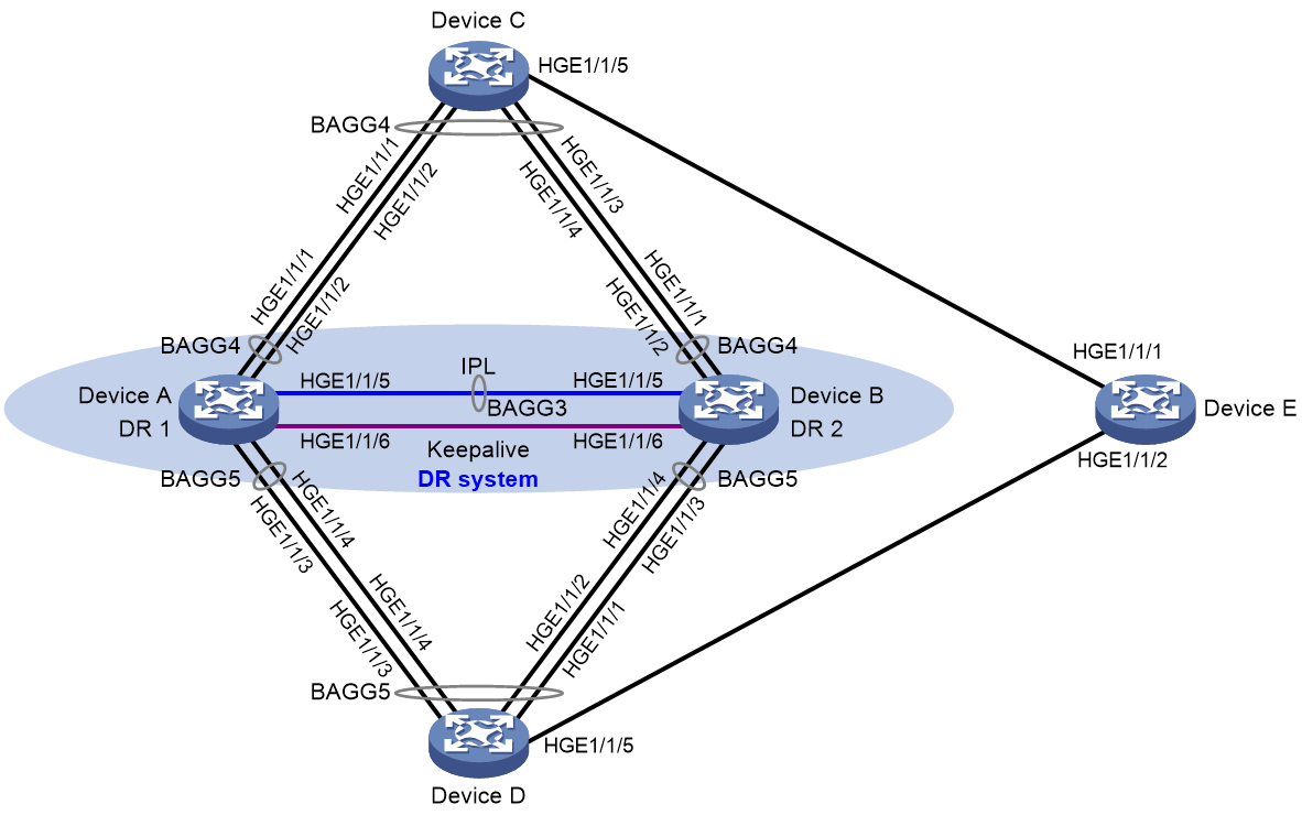

Example: Configuring loop detection on an M-LAG system
As shown in Figure 5, configure loop detection on the M-LAG system formed by Device A and Device B to meet the following requirements:
·     Generates a log as a notification.
·     Automatically shuts down the interface on which a loop is detected.
Figure 5 Network diagram
# Create VLAN 100.
[DeviceA] vlan 100
[DeviceA-vlan100] quit
# Configure M-LAG system settings.
[DeviceA] m-lag system-mac 1-1-1
[DeviceA] m-lag system-number 1
[DeviceA] m-lag system-priority 123
# Configure M-LAG keepalive packet parameters.
[DeviceA] m-lag keepalive ip destination 1.1.1.1 source 1.1.1.2
# Set the link mode of HundredGigE 1/1/6 to Layer 3, and assign the interface an IP address. The IP address will be used as the source IP address of keepalive packets.
[DeviceA] interface hundredgige 1/1/6
[DeviceA-HundredGigE1/1/6] port link-mode route
[DeviceA-HundredGigE1/1/6] ip address 1.1.1.2 24
[DeviceA-HundredGigE1/1/6] quit
# Exclude the interface used for M-LAG keepalive detection (HundredGigE 1/1/6) from the shutdown action by M-LAG MAD.
[DeviceA] drni m-lag exclude interface hundredgige 1/1/6
# Create Layer 2 dynamic aggregate interface Bridge-Aggregation 3, and specify it as the M-LAG peer-link interface.
[DeviceA] interface bridge-aggregation 3
[DeviceA-Bridge-Aggregation3] link-aggregation mode dynamic
[DeviceA-Bridge-Aggregation3] port m-lag peer-link 1
[DeviceA-Bridge-Aggregation3] quit
# Assign HundredGigE 1/1/5 to aggregation group 3.
[DeviceA] interface hundredgige 1/1/5
[DeviceA-HundredGigE1/1/5] port link-aggregation group 3
[DeviceA-HundredGigE1/1/5] quit
# Set the link type of Bridge-Aggregation 3 to trunk, and assign it to VLAN 100.
[DeviceA-Bridge-Aggregation3] port link-type trunk
[DeviceA-Bridge-Aggregation3] port trunk permit vlan 100
# Create Layer 2 dynamic aggregate interface Bridge-Aggregation 4, and assign it to M-LAG group 4.
[DeviceA] interface bridge-aggregation 4
[DeviceA-Bridge-Aggregation4] link-aggregation mode dynamic
[DeviceA-Bridge-Aggregation4] port m-lag group 4
[DeviceA-Bridge-Aggregation4] quit
# Assign HundredGigE 1/1/1 and HundredGigE 1/1/2 to aggregation group 4.
[DeviceA-HundredGigE1/1/1] port link-aggregation group 4
[DeviceA-HundredGigE1/1/2] port link-aggregation group 4
# Set the link type of Bridge-Aggregation 4 to trunk, and assign it to VLAN 100.
[DeviceA-Bridge-Aggregation4] port link-type trunk
[DeviceA-Bridge-Aggregation4] port trunk permit vlan 100
# Create Layer 2 dynamic aggregate interface Bridge-Aggregation 5, and assign it to M-LAG group 5.
[DeviceA] interface bridge-aggregation 5
[DeviceA-Bridge-Aggregation5] link-aggregation mode dynamic
[DeviceA-Bridge-Aggregation5] port m-lag group 5
[DeviceA-Bridge-Aggregation5] quit
# Assign HundredGigE 1/1/3 and HundredGigE 1/1/4 to aggregation group 5.
[DeviceA] interface hundredgige 1/1/3
[DeviceA-HundredGigE1/1/3] port link-aggregation group 5
[DeviceA-HundredGigE1/1/3] quit
[DeviceA] interface hundredgige 1/1/4
[DeviceA-HundredGigE1/1/4] port link-aggregation group 5
[DeviceA-HundredGigE1/1/4] quit
# Set the link type of Bridge-Aggregation 5 to trunk, and assign it to VLAN 100.
[DeviceA-Bridge-Aggregation5] port link-type trunk
[DeviceA-Bridge-Aggregation5] port trunk permit vlan 100
# Disable the spanning tree feature.
[DeviceA] undo stp global enable
# Enable loop detection for VLAN 100 globally, set the global loop protection action to shutdown, and set the loop detection interval to 35 seconds.
[DeviceA] loopback-detection global action shutdown
2.     Configure Device B in the same way Device A is configured. Set the M-LAG system number to 2, and set the source and destination IP addresses of keepalive packets to 1.1.1.1 and 1.1.1.2, respectively. (Details not shown.)

Loop detection is enabled.
Global loop detection interval is 35 second(s).
Loop is detected on following interfaces:
  Interface                       Action mode     VLANs/VSI
  Bridge-Aggregation4             Shutdown        100
  Bridge-Aggregation5             Shutdown        100
The output shows that the device has removed the loops from Bridge-Aggregation 4 and Bridge-Aggregation 5 according to the shutdown action.
# Verify that Bridge-Aggregation 4 has been shut down by loop detection.
[DeviceA] display interface Bridge-Aggregation 4
Bridge-Aggregation4
The interface has assigned a M-LAG group.
Current state: DOWN (Loopback detection down)
# Verify that Bridge-Aggregation 5 has been shut down by loop detection.
[DeviceA] display interface Bridge-Aggregation 5
Bridge-Aggregation5
# Verify that loops have been removed on Device B. (Details not shown.)
