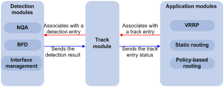

The Track module works between application and detection modules, as shown in Figure 1. It hides the differences among detection modules from application modules.
Collaboration is enabled after you associate the Track module with a detection module and an application module. The detection module monitors specific objects such as interface status, link status, network reachability, and network performance, and informs the Track module of detection results. The Track module sends the detection results to the associated application module, and the application module takes actions when the tracked object changes its state.

Collaboration fundamentals
The Track module collaborates with detection modules and application modules:
·     Collaboration between the Track module and a detection module
·     Collaboration between the Track module and an application module
After being associated with a track entry, the detection module sends the detection result of the tracked object to the Track module, which then changes the status of the track entry:
·     If the tracked object functions correctly, for example, the target interface is up or the target network is reachable, the state of the track entry is Positive.
·     If the tracked object does not function correctly, for example, the target interface is down or the target network is unreachable, the state of the track entry is Negative.
·     If the detection result is not valid, for example, the NQA test group that is associated with the track entry does not exist, the state of the track entry is Invalid.
Detection modules that can be associated with the Track module include:
·     NQA
·     BFD
·     Interface management module
After being associated with an application module, when the status of the track entry changes, the Track module notifies the application module, which then takes proper actions.
Application modules that can be associated with the Track module include:
·     Virtual Router Redundancy Protocol (VRRP)
·     Static routing
·     Policy-based routing
In some cases, when the status of the track entry changes, if the Track module notifies the application modules immediately, communication might be interrupted because routes cannot be recovered in time. For example, the master in a VRRP group monitors the uplink interface through the Track module. When the uplink interface fails, the Track module notifies the master to reduce its priority so that a backup with a higher priority can preempt as the master to forward packets. When the uplink interface recovers, if the Track module notifies the original master to restore its priority immediately, the master will forward packets immediately; however, the uplink route has not been recovered yet, which might result in packet forwarding failure. Then configure the Track module to wait a specified delay time before notifying the application modules of the track entry status change.

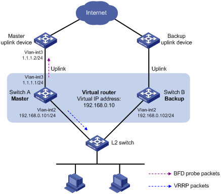

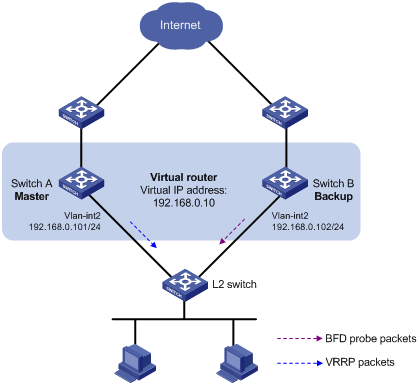

VRRP is an error-tolerant protocol. It adds a group of routers that can act as network gateways to a VRRP group, which forms a virtual router. Routers in the VRRP group elect the master acting as the gateway according to their priorities. A router with a higher priority is more likely to become the master. The other routers function as the backups. When the master fails, to make sure that the hosts in the network segment can uninterruptedly communicate with external networks, the backups in the VRRP group elect a new gateway to undertake the responsibility of the failed master.
When VRRP operates in standard protocol mode or load balancing mode, associate Track with the VRRP group to implement the following actions:
·     Change the priority of a router according to the status of the uplink. If a fault occurs on the uplink of the router, the VRRP group cannot be aware of the uplink failure. If the router is the master, hosts in the LAN cannot access the external network. This problem can be solved by establishing a Track-VRRP group association. Use the detection modules to monitor the status of the uplink of the router and establish collaborations between the detection modules, Track module and VRRP. When the uplink fails, the detection modules notify the Track module to change the status of the monitored track entry to Negative, and the priority of the master decreases by a specified value. This allows a higher priority router in the VRRP group to become the master, and maintain proper communication between the hosts in the LAN and the external network.
·     Monitor the master on a backup. If a fault occurs on the master, the backup working in switchover mode will switch to the master immediately to maintain normal communication.
When VRRP operates in load balancing mode, associate the Track module with the VRRP Virtual Forwarder (VF) to implement the following functions:
·     Change the priority of the active VF (AVF) according to its uplink state. When the uplink of the AVF fails, the track entry changes to Negative state and the weight of the AVF decreases by a specified value so that the VF with a higher priority becomes the new AVF to forward packets.
·     Monitor the AVF status from the listening VF (LVF), which refers to the VF in listening state. When the AVF fails, the LVF that operates in the switchover mode becomes the new AVF to ensure continuous forwarding.

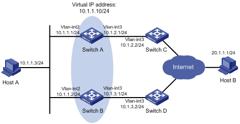

Network requirements
As shown in Figure 2, Host A needs to access Host B on the Internet. The default gateway of Host A is 10.1.1.10/24. Switch A and Switch B belong to VRRP group 1, whose virtual IP address is 10.1.1.10.
When Switch A works correctly, packets from Host A to Host B are forwarded through Switch A. When VRRP finds that a fault is on the uplink of Switch A through NQA, packets from Host A to Host B are forwarded through Switch B.
Figure 2 Network diagram

6.     Verify the configuration.
After configuration, ping Host B on Host A, and you can see that Host B is reachable. Use the display vrrp command to view the configuration result.
# Display detailed information about VRRP group 1 on Switch A.
[SwitchA-Vlan-interface2] display vrrp verbose
IPv4 Standby Information:
     Run Mode       : Standard
     Run Method     : Virtual MAC
 Total number of virtual routers : 1
   Interface Vlan-interface2
     VRID           : 1                    Adver Timer  : 5
     Admin Status   : Up                   State        : Master
     Config Pri     : 110                  Running Pri  : 110
     Preempt Mode   : Yes                  Delay Time   : 5
     Auth Type      : Simple               Key          : hello
     Virtual IP     : 10.1.1.10
     Virtual MAC    : 0000-5e00-0101
     Master IP      : 10.1.1.1
   VRRP Track Information:
     Track Object   : 1                    State : Positive   Pri Reduced : 30
# Display detailed information about VRRP group 1 on Switch B.
[SwitchB-Vlan-interface2] display vrrp verbose
     Run Mode       : Standard
     Admin Status   : Up                   State        : Backup
     Config Pri     : 100                  Running Pri  : 100
     Become Master  : 2200ms left
The output shows that in VRRP group 1, Switch A is the master and Switch B is a backup. Packets from Host A to Host B are forwarded through Switch A.
When a fault is on the link between Switch A and Switch C, you can still successfully ping Host B on Host A. Use the display vrrp command to view information about VRRP group 1.
# Display detailed information about VRRP group 1 on Switch A when a fault is on the link between Switch A and Switch C.
     Run Mode       : Standard
     Config Pri     : 110                  Running Pri  : 80
     Master IP      : 10.1.1.2
     Track Object   : 1                    State : Negative   Pri Reduced : 30
# Display detailed information about VRRP group 1 on Switch B when a fault is on the link between Switch A and Switch C.
     Run Mode       : Standard
The output shows that when a fault is on the link between Switch A and Switch C, the priority of Switch A decreases to 80. Switch A becomes the backup, and Switch B becomes the master. Packets from Host A to Host B are forwarded through Switch B.
Configuring BFD for a VRRP backup to monitor the master
As shown in Figure 3, Switch A and Switch B belong to VRRP group 1, the virtual IP address of which is 192.168.0.10.
The default gateway of the hosts in the LAN is 192.168.0.10. When Switch A works correctly, the hosts in the LAN access the external network through Switch A. When Switch A fails, the hosts in the LAN access the external network through Switch B.
If BFD is not configured, when the master in a VRRP group fails, the backup cannot become the master until the configured timeout timer expires. The timeout is generally 3 to 4 seconds, which makes the switchover slow. To solve this problem, VRRP uses BFD to probe the state of the master. Once the master fails, the backup can become the new master in milliseconds.
Figure 3 Network diagram

Configuring BFD for the VRRP master to monitor the uplinks
As shown in Figure 4, Switch A and Switch B belong to VRRP group 1, which has the virtual IP address 192.168.0.10. The default gateway of the hosts in the LAN is 192.168.0.10.
When Switch A works correctly, the hosts in the LAN access the external network through Switch A. When Switch A detects that the uplink is down through BFD, it decreases its priority so that Switch B can preempt as the master, ensuring that the hosts in the LAN can access the external network through Switch B.
Figure 4 Network diagram
     VRID           : 1                    Adver Timer  : 1
     Preempt Mode   : Yes                  Delay Time   : 0
     Auth Type      : None
     Virtual IP     : 192.168.0.10
     Master IP      : 192.168.0.101
The output shows that when the status of track entry 1 becomes Positive, Switch A is the master and Switch B the backup.
# When the uplink of Switch A goes down, the status of track entry 1 becomes Negative.
<SwitchA> display track 1
Track ID: 1
  Status: Negative
  Duration: 0 days 0 hours 0 minutes 32 seconds
  Notification delay: Positive 0, Negative 0 (in seconds)
  Reference object:
    BFD session:
    Packet type: Echo
    Interface  : Vlan-interface2
    Remote IP  : 1.1.1.2
    Local IP   : 1.1.1.1
<SwitchA> display vrrp verbose
     Run Mode       : Standard
     Config Pri     : 110                  Running Pri  : 90
     Auth Type      : None
     Master IP      : 192.168.0.102
     Track Object   : 1                    State : Negative   Pri Reduced : 20
<SwitchB> display vrrp verbose
     Run Mode       : Standard
     Auth Type      : None
The output shows that when Switch A detects that the uplink fails through BFD, it decreases its priority by 20 to make sure that Switch B can preempt as the master.

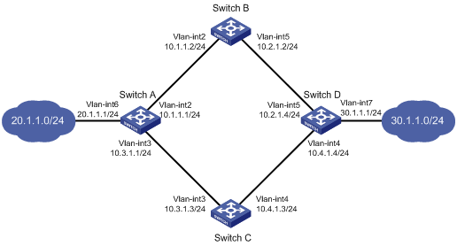

Static routing-Track-NQA collaboration configuration example
As shown in Figure 5, Switch A, Switch B, Switch C, and Switch D are connected to two segments 20.1.1.0/24 and 30.1.1.0/24. Configure static routes on these switches so that the two segments can communicate with each other, and configure route backup to improve reliability of the network.
Switch A is the default gateway of the hosts in segment 20.1.1.0/24. Two static routes to 30.1.1.0/24 exist on Switch A, with the next hop being Switch B and Switch C, respectively. These two static routes back up each other, where:
·     The static route with Switch B as the next hop has a higher priority, and is the master route. If this route is available, Switch A forwards packets to 30.1.1.0/24 through Switch B.
·     The static route with Switch C as the next hop acts as the backup route.
·     Configure static routing-Track-NQA collaboration to determine whether the master route is available in real time. If the master route is unavailable, the backup route takes effect, and Switch A forwards packets to 30.1.1.0/24 through Switch C.
Similarly, Switch D is the default gateway of the hosts in segment 30.1.1.0/24. Two static routes to 20.1.1.0/24 exist on Switch D, with the next hop being Switch B and Switch C, respectively. These two static routes back up each other, where:
·     The static route with Switch B as the next hop has a higher priority, and is the master route. If this route is available, Switch D forwards packets to 20.1.1.0/24 through Switch B.
·     Configure static routing-Track-NQA collaboration to determine whether the master route is available in real time. If the master route is unavailable, the backup route takes effect, and Switch D forwards packets to 20.1.1.0/24 through Switch C.
Figure 5 Network diagram
Configuration procedure
1.     Create VLANs, and assign corresponding ports to the VLANs, and configure the IP address of each VLAN interface as shown in Figure 5. (Details not shown.)
2.     Configure Switch A.
# Configure a static route to 30.1.1.0/24, with the address of the next hop as 10.1.1.2 and the default priority 60. This static route is associated with track entry 1.
<SwitchA> system-view
[SwitchA] ip route-static 30.1.1.0 24 10.1.1.2 track 1
# Configure a static route to 30.1.1.0/24, with the address of the next hop as 10.3.1.3 and the priority 80.
[SwitchA] ip route-static 30.1.1.0 24 10.3.1.3 preference 80
# Configure a static route to 10.2.1.4, with the address of the next hop as 10.1.1.2.
[SwitchA] ip route-static 10.2.1.4 24 10.1.1.2
# Create an NQA test group with the administrator admin and the operation tag test.
[SwitchA] nqa entry admin test
# Configure the test type as ICMP-echo.
[SwitchA-nqa-admin-test] type icmp-echo
# Configure the destination address of the test as 10.2.1.4 and the next hop address as 10.1.1.2 to check the connectivity of the path from Switch A to Switch B, and then to Switch D through NQA.
[SwitchA-nqa-admin-test-icmp-echo] destination ip 10.2.1.4
[SwitchA-nqa-admin-test-icmp-echo] next-hop 10.1.1.2
# Configure the test frequency as 100 milliseconds.
[SwitchA-nqa-admin-test-icmp-echo] frequency 100
# Configure reaction entry 1, specifying that five consecutive probe failures trigger the Track module.
[SwitchA-nqa-admin-test-icmp-echo] reaction 1 checked-element probe-fail threshold-type consecutive 5 action-type trigger-only
[SwitchA-nqa-admin-test-icmp-echo] quit
# Start the NQA test.
[SwitchA] nqa schedule admin test start-time now lifetime forever
# Configure track entry 1, and associate it with reaction entry 1 of the NQA test group (with the administrator admin, and the operation tag test).
[SwitchA] track 1 nqa entry admin test reaction 1
3.     Configure Switch B.
# Configure a static route to 30.1.1.0/24, with the address of the next hop as 10.2.1.4.
<SwitchB> system-view
[SwitchB] ip route-static 30.1.1.0 24 10.2.1.4
# Configure a static route to 20.1.1.0/24, with the address of the next hop as 10.1.1.1.
[SwitchB] ip route-static 20.1.1.0 24 10.1.1.1
4.     Configure Switch C.
# Configure a static route to 30.1.1.0/24, with the address of the next hop as 10.4.1.4.
<SwitchC> system-view
[SwitchC] ip route-static 30.1.1.0 24 10.4.1.4
# Configure a static route to 20.1.1.0/24, with the address of the next hop as 10.3.1.1.
[SwitchC] ip route-static 20.1.1.0 24 10.3.1.1
5.     Configure Switch D.
# Configure a static route to 20.1.1.0/24, with the address of the next hop as 10.2.1.2 and the default priority 60. This static route is associated with track entry 1.
<SwitchD> system-view
[SwitchD] ip route-static 20.1.1.0 24 10.2.1.2 track 1
# Configure a static route to 20.1.1.0/24, with the address of the next hop as 10.4.1.3 and the priority 80.
[SwitchD] ip route-static 20.1.1.0 24 10.4.1.3 preference 80
# Configure a static route to 10.1.1.1, with the address of the next hop as 10.2.1.2.
[SwitchD] ip route-static 10.1.1.1 24 10.2.1.2
[SwitchD] nqa entry admin test
[SwitchD-nqa-admin-test] type icmp-echo
# Configure the destination address of the test as 10.1.1.1 and the next hop address as 10.2.1.2 to check the connectivity of the path from Switch D to Switch B, and then to Switch A through NQA.
[SwitchD-nqa-admin-test-icmp-echo] destination ip 10.1.1.1
[SwitchD-nqa-admin-test-icmp-echo] next-hop 10.2.1.2
[SwitchD-nqa-admin-test-icmp-echo] frequency 100
[SwitchD-nqa-admin-test-icmp-echo] reaction 1 checked-element probe-fail threshold-type consecutive 5 action-type trigger-only
[SwitchD-nqa-admin-test-icmp-echo] quit
[SwitchD] nqa schedule admin test start-time now lifetime forever
[SwitchD] track 1 nqa entry admin test reaction 1
# Display information about the track entry on Switch A.
[SwitchA] display track all
Track ID: 1
  Status: Positive
  Reference object:
    NQA entry: admin test
    Reaction: 1
# Display the routing table of Switch A.
[SwitchA] display ip routing-table
Routing Tables: Public
         Destinations : 10       Routes : 10
10.1.1.0/24         Direct 0    0            10.1.1.1        Vlan2
10.1.1.1/32         Direct 0    0            127.0.0.1       InLoop0
10.2.1.0/24         Static 60   0            10.1.1.2        Vlan2
10.3.1.0/24         Direct 0    0            10.3.1.1        Vlan3
10.3.1.1/32         Direct 0    0            127.0.0.1       InLoop0
20.1.1.0/24         Direct 0    0            20.1.1.1        Vlan6
20.1.1.1/32         Direct 0    0            127.0.0.1       InLoop0
30.1.1.0/24         Static 60   0            10.1.1.2        Vlan2
127.0.0.0/8         Direct 0    0            127.0.0.1       InLoop0
127.0.0.1/32        Direct 0    0            127.0.0.1       InLoop0
The output shows the NQA test result: the master route is available (the status of the track entry is Positive), and Switch A forwards packets to 30.1.1.0/24 through Switch B.
# Remove the IP address of interface VLAN-interface 2 on Switch B.
[SwitchB-Vlan-interface2] undo ip address
Track ID: 1
  Status: Negative
  Reference object:
    Reaction: 1
30.1.1.0/24         Static 80   0            10.3.1.3        Vlan3
The output shows the NQA test result: the master route is unavailable (the status of the track entry is Negative), and the backup static route takes effect and Switch A forwards packets to 30.1.1.0/24 through Switch C.
# When the master route fails, the hosts in 20.1.1.0/24 can still communicate with the hosts in 30.1.1.0/24.
[SwitchA] ping -a 20.1.1.1 30.1.1.1
  PING 30.1.1.1: 56  data bytes, press CTRL_C to break
    Reply from 30.1.1.1: bytes=56 Sequence=1 ttl=254 time=2 ms
    Reply from 30.1.1.1: bytes=56 Sequence=2 ttl=254 time=1 ms
    Reply from 30.1.1.1: bytes=56 Sequence=3 ttl=254 time=1 ms
    Reply from 30.1.1.1: bytes=56 Sequence=4 ttl=254 time=2 ms
    Reply from 30.1.1.1: bytes=56 Sequence=5 ttl=254 time=1 ms
  --- 30.1.1.1 ping statistics ---
    5 packet(s) transmitted
    5 packet(s) received
    0.00% packet loss
    round-trip min/avg/max = 1/1/2 ms
# The output on Switch D is similar to that on Switch A. When the master route fails, the hosts in 30.1.1.0/24 can still communicate with the hosts in 20.1.1.0/24.
[SwitchB] ping -a 30.1.1.1 20.1.1.1
  PING 20.1.1.1: 56  data bytes, press CTRL_C to break
    Reply from 20.1.1.1: bytes=56 Sequence=1 ttl=254 time=2 ms
    Reply from 20.1.1.1: bytes=56 Sequence=2 ttl=254 time=1 ms
    Reply from 20.1.1.1: bytes=56 Sequence=3 ttl=254 time=1 ms
    Reply from 20.1.1.1: bytes=56 Sequence=4 ttl=254 time=1 ms
    Reply from 20.1.1.1: bytes=56 Sequence=5 ttl=254 time=1 ms
  --- 20.1.1.1 ping statistics ---
    0.00% packet loss

5.     Verify the configuration.
Track ID: 1
  Status: Positive
  Reference object:
    BFD Session:
    Packet type: Echo
    Remote IP  : 10.2.1.2
    Local IP   : 10.2.1.1
         Destinations : 9        Routes : 9
10.2.1.0/24         Direct 0    0            10.2.1.1        Vlan2
10.2.1.1/32         Direct 0    0            127.0.0.1       InLoop0
20.1.1.0/24         Direct 0    0            20.1.1.1        Vlan5
30.1.1.0/24         Static 60   0            10.2.1.2        Vlan2
The output shows the BFD detection result: the next hop 10.2.1.2 is reachable (the status of the track entry is Positive), and the master static route takes effect. Switch A forwards packets to 30.1.1.0/24 through Switch B.
Track ID: 1
  Status: Negative
  Reference object:
    BFD Session:
    Packet type: Echo
    Local IP   : 10.2.1.1
The output shows the BFD detection result: the next hop 10.2.1.2 is unreachable (the status of the track entry is Negative), and the backup static route takes effect, and Switch A forwards packets to 30.1.1.0/24 through Switch C and Switch B.
    0.00% packet loss
# The output on Switch B is similar to that on Switch A. When the master route fails, the hosts in 30.1.1.0/24 can still communicate with the hosts in 20.1.1.0/24.
    0.00% packet loss
VRRP-Track-interface management collaboration configuration example (the master monitors the uplink interface)
As shown in Figure 7, Host A needs to access Host B on the Internet. The default gateway of Host A is 10.1.1.10/24. Switch A and Switch B belong to VRRP group 1, whose virtual IP address is 10.1.1.10.
When Switch A works correctly, packets from Host A to Host B are forwarded through Switch A. When VRRP detects that a fault is on the uplink interface of Switch A through the interface management module, packets from Host A to Host B are forwarded through Switch B.
Figure 7 Network diagram
1.     Create VLANs, and assign corresponding ports to the VLANs, and configure the IP address of each VLAN interface as shown in Figure 7. (Details not shown.)
2.     Configure a track entry on Switch A.
# Configure track entry 1, and associate it with the physical status of the uplink interface VLAN-interface 3.
[SwitchA] track 1 interface vlan-interface 3
3.     Configure VRRP on Switch A.
# Create VRRP group 1, and configure the virtual IP address 10.1.1.10 for the group.
[SwitchA-Vlan-interface2] vrrp vrid 1 virtual-ip 10.1.1.10
# Set the priority of Switch A in VRRP group 1 to 110.
[SwitchA-Vlan-interface2] vrrp vrid 1 priority 110
# Configure to monitor track entry 1 and specify the priority decrement as 30.
[SwitchA-Vlan-interface2] vrrp vrid 1 track 1 reduced 30
4.     Configure VRRP on Switch B.
[SwitchB-Vlan-interface2] vrrp vrid 1 virtual-ip 10.1.1.10
     Run Mode       : Standard
     Auth Type      : None
     Run Mode       : Standard
     Auth Type      : None
# Shut down the uplink interface VLAN-interface 3 on Switch A.
[SwitchA-Vlan-interface2] interface vlan-interface 3
[SwitchA-Vlan-interface3] shutdown
After shutting down the uplink interface on Switch A, you can still successfully ping Host B on Host A. Use the display vrrp command to view information about VRRP group 1.
# After shutting down the uplink interface on Switch A, display detailed information about VRRP group 1 on Switch A.
[SwitchA-Vlan-interface3] display vrrp verbose
     Run Mode       : Standard
     Auth Type      : None
# After shutting down the uplink interface on Switch A, display detailed information about VRRP group 1 on Switch B.
     Run Mode       : Standard
     Auth Type      : None
The output shows that when the uplink interface on Switch A is shut down, the priority of Switch A decreases to 80. Switch A becomes the backup, and Switch B becomes the master. Packets from Host A to Host B are forwarded through Switch B.
