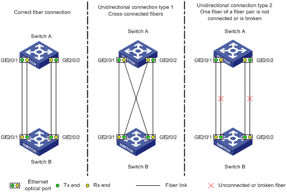

Unidirectional links occur when one end of a link can receive packets from the other end, but the other end cannot receive packets sent by the first end. Unidirectional links result in problems such as loops in an STP-enabled network.
For example, the link between Switch A and Switch B is bidirectional when they are connected through a fiber pair, with one fiber used for sending packets from A to B and the other for sending packets from B to A. This link is a two-way link. If one of these fibers gets broken, the link becomes unidirectional (one-way link).

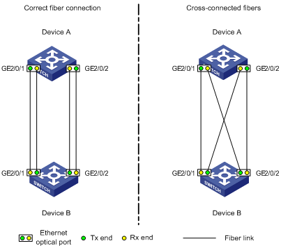

There are two types of unidirectional fiber links. One occurs when fibers are cross-connected. The other occurs when a fiber is not connected, or when one fiber of a fiber pair gets broken. Figure 1 shows a correct fiber connection and the two types of unidirectional fiber connection.
Figure 1 Correct and incorrect fiber connections

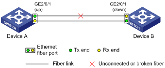

Enhanced DLDP mode is designed for addressing black holes. It prevents situations where one end of a link is up and the other is down.
If you configure forced speed and full duplex mode on a port, the situation shown in Figure 2 might occur (take the fiber link for example). Without DLDP enabled, the port on Switch B is actually down but its state cannot be detected by common data link protocols, so the port on Switch A is still up. However, in enhanced DLDP mode, the following occurs:
The port on Device B is in Inactive DLDP state because it is physically down.
The port on Switch A tests the peer port on Switch B after the Entry timer for the port on Switch B expires. The port on Switch A transits to the Disable state if it does not receive an Echo packet from the port on Switch B when the Echo timer expires.
Figure 2 A scenario for enhanced DLDP mode

After you shut down Gigabitethernet 2/0/1 and Gigabitethernet 2/0/2, the following log information is displayed:
<DeviceA> system-view
[DeviceA] interface gigabitethernet 2/0/1
[DeviceA-Gigabitethernet2/0/1] shutdown
%Jan 18 18:16:12:044 2010 DeviceA IFNET/3/LINK_UPDOWN: Gigabitethernet2/0/1 link status is DOWN.
[DeviceA-Gigabitethernet2/0/1] quit
[DeviceA] interface gigabitethernet 2/0/2
[DeviceA-Gigabitethernet2/0/2] shutdown
%Jan 18 18:18:03:583 2010 DeviceA IFNET/3/LINK_UPDOWN: Gigabitethernet2/0/2 link status is DOWN.
The output shows that the link status of both Gigabitethernet 2/0/1 and Gigabitethernet 2/0/2 is down.
Assume that in this example, the unidirectional links are caused by cross-connected fibers. Correct the fiber connections, and then bring up the ports shut down earlier.
# On Device A, bring up Gigabitethernet 2/0/1 and Gigabitethernet 2/0/2:
[DeviceA-Gigabitethernet2/0/2] undo shutdown
%Jan 18 18:22:11:698 2010 DeviceA IFNET/3/LINK_UPDOWN: Gigabitethernet2/0/2 link status is UP.
[DeviceA-Gigabitethernet2/0/2] quit
[DeviceA-Gigabitethernet2/0/1] undo shutdown
%Jan 18 18:22:46:065 2010 DeviceA IFNET/3/LINK_UPDOWN: Gigabitethernet2/0/1 link status is UP.
The output indicates that the link status of both Gigabitethernet 2/0/1 and Gigabitethernet 2/0/2 is now up.
