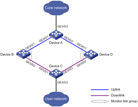

Monitor Link is a port collaboration function. Monitor Link usually works together with Layer 2 topology protocols. The idea is to monitor the states of uplink ports and adapt the up/down state of downlink ports to the up/down state of uplink ports, triggering link switchover on the downstream switch in time, as shown in Figure 1.
Figure 1 Monitor Link application scenario
Terminology
Monitor link group
A monitor link group is a set of uplink and downlink ports. A port can belong to only one monitor link group. As shown in Figure 1, ports GigabitEthernet 3/0/1 and GigabitEthernet 3/0/2 of Device B and those of Device D each form a monitor link group. GigabitEthernet 3/0/1 on both switches are uplink ports, and GigabitEthernet 3/0/2 on both switches are downlink ports.
Uplink/Downlink ports
Uplink port and downlink port are two port roles in monitor link groups:
·     Uplink ports refer to the monitored ports. The state of a monitor link group adapts to that of its member uplink ports. When a monitor link group contains no uplink port or all the uplink ports are down, the monitor link group becomes down; as long as one member uplink port is up, the monitor link group stays up.
·     Downlink ports refer to the monitoring ports. The state of the downlink ports in a monitor link group adapts to that of the monitor link group. When the state of a monitor link group changes, the state of its member downlink ports change accordingly. In this way, the state of the downlink ports in a monitor link group is always consistent with that of the monitor link group.
Uplink/Downlink
The uplink is the link that connects the uplink ports in a monitor link group, while the downlink is the link that connects the downlink ports.
How Monitor Link works
A monitor link group works independently of other monitor link groups. When a monitor link group contains no uplink port or all its uplink ports are down, the monitor link group goes down and forces all downlink ports down at the same time. When any uplink port goes up, the monitor link group goes up and brings up all the downlink ports.
H3C recommends not manually shutting down or bringing up the downlink ports in a monitor link group.

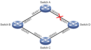

Network requirements
As shown in Figure 2, Switch C is a smart link device, and Switch A, Switch B, and Switch D are associated devices. Traffic of VLANs 1 through 30 on Switch C is dual-uplinked to Switch A through a smart link group.
Implement dual uplink backup on Switch C, and make sure that when the link between Switch A and Switch B (or Switch D) fails, Switch C must be able to sense the link fault and perform uplink switchover in the smart link group.
For more information about the Smart Link feature, see "Configuring Smart Link."
Figure 2 Network diagram

5.     Verify the configuration:
Use the display monitor-link group command display the monitor link group information on devices. For example, when GigabitEthernet 4/0/2 on Switch A goes down due to a link fault:
# Check information about monitor link group 1 on Switch B.
<SwitchB> display monitor-link group 1
 Monitor link group 1 information:
 Group status: UP
 Last-up-time: 16:37:20 2009/4/21
 Last-down-time: 16:35:26 2009/4/21
 Member                    Role     Status
 GigabitEthernet4/0/1      UPLINK   UP
 GigabitEthernet4/0/2      DOWNLINK UP
# Check information about monitor link group 1 on Switch D.
<SwitchD> display monitor-link group 1
 Group status: DOWN
 Last-up-time: 16:35:27 2009/4/21
 Last-down-time: 16:37:19 2009/4/21
 Member                    Role     Status
 GigabitEthernet4/0/1      UPLINK   DOWN
 GigabitEthernet4/0/2      DOWNLINK DOWN
