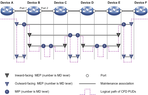

An MP is configured on a port and belongs to an MA. MPs include maintenance association end points (MEPs) and maintenance association intermediate points (MIPs).
·     MEP
MEPs define the boundary of the MD. Each MEP is identified by an MEP ID.
The MA that a MEP belongs to defines the VLAN of packets sent by the MEP; the level of an MEP equals the level of the MD that the MEP belongs to, and the level of packets sent by an MEP equals the level of the MEP. The level of a MEP determines the levels of packets that the MEP can process. A MEP forwards packets at a higher level and processes packet of its level or lower. The processing procedure is specific to packets in the same VLAN. Packets of different VLANs are independent.
MEPs include inward-facing MEPs and outward-facing MEPs. An outward-facing MEP sends packets to its host port. An inward-facing MEP does not send packets to its host port. Rather, it sends packets to other ports on the device.
·     MIP
A MIP is internal to an MD. It cannot send CFD packets actively; however, it can handle and respond to CFD packets. By cooperating with MEPs, a MIP can perform a function similar to ping and traceroute. A MIP forwards packets of a different level without any processing and only processes packet of its level.
The MA to which a MIP belongs defines the VLAN of packets that the MIP can receive; the level of a MIP is defined by its generation rule and the MD that the MIP belongs to. MIPs are generated on each port automatically according to related MIP generation rules. If a port has no MIP, the system will check the MAs in each MD (from low to high levels), and follow the procedure as described in Figure 2 to create or not to create MIPs at the relevant level.
Figure 2 Procedure of creating MIPs

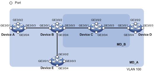

Figure 3 demonstrates a grading example of the CFD module. Four levels of MDs (0, 2, 3, and 5) are designed. The bigger the number, the higher the level and the larger the area covered. MPs are configured on the ports of device A through device F. Port 1 of device B is configured with the following MPs—a level 5 MIP, a level 3 inward-facing MEP, a level 2 inward-facing MEP, and a level 0 outward-facing MEP.
Figure 3 CFD grading example

CFD configuration example
IMPORTANT:
By default, Ethernet, VLAN, and aggregate interfaces are down. Before configuring these interfaces, bring them up by using the undo shutdown command.
Network requirements
As shown in Figure 4:
·     The network comprises five devices and is divided into two MDs: MD_A (level 5) and MD_B (level 3). All ports belong to VLAN 100, and the MAs in the two MDs all serve VLAN 100.
·     MD_A has three edge ports: GigabitEthernet 3/0/1 on Device A, GigabitEthernet 3/0/3 on Device D, and GigabitEthernet 3/0/4 on Device E, and they are all inward-facing MEPs. MD_B has two edge ports: GigabitEthernet 3/0/3 on Device B and GigabitEthernet 3/0/1 on Device D, and they are both outward-facing MEPs.
·     In MD_A, Device B is designed to have MIPs when its port is configured with low level MEPs. Port GigabitEthernet 3/0/3 is configured with MEPs of MD_B, and the MIPs of MD_A can be configured on this port. You should configure the MIP generation rule of MD_A as explicit.
·     The MIPs of MD_B are designed on Device C, and are configured on all ports. You should configure the MIP generation rule as default.
·     Configure CC to monitor the connectivity among all the MEPs in MD_A and MD_B. Configure to use LB to locate link faults, and use the AIS function to suppress the error alarms reported.
·     After the status information of the entire network is obtained, use LT and TST to detect link faults.
Figure 4 Network diagram
Configuration procedure
1.     Configure a VLAN and assign ports to it.
On each device shown in Figure 4, create VLAN 100 and assign ports GigabitEthernet 3/0/1 through GigabitEthernet 3/0/4 to VLAN 100.
2.     Enable CFD:
# Enable CFD on Device A.
<DeviceA> system-view
[DeviceA] cfd enable
Configure Device B through Device E in the same way Device A is configured.
3.     Configure service instances:
# Create MD_A (level 5) on Device A, create MA_A, which serves VLAN 100, in MD_A, and create service instance 1 for MD_A and MA_A.
[DeviceA] cfd md MD_A level 5
[DeviceA] cfd ma MA_A md MD_A vlan 100
[DeviceA] cfd service-instance 1 md MD_A ma MA_A
Configure Device E as you configure Device A.
# Create MD_A (level 5) on Device B, create MA_A, which serves VLAN 100, in MD_A, and then create service instance 1 for MD_A and MA_A; in addition, create MD_B (level 3), create MA_B, which serves VLAN 100, in MD_B, and then create service instance 2 for MD_B and MA_B.
[DeviceB] cfd md MD_A level 5
[DeviceB] cfd ma MA_A md MD_A vlan 100
[DeviceB] cfd service-instance 1 md MD_A ma MA_A
[DeviceB] cfd md MD_B level 3
[DeviceB] cfd ma MA_B md MD_B vlan 100
[DeviceB] cfd service-instance 2 md MD_B ma MA_B
Configure Device D as you configure Device B.
# Create MD_B (level 3) on Device C, create MA_B, which serves VLAN 100, in MD_B, and then create service instance 2 for MD_B and MA_B;
[DeviceC] cfd md MD_B level 3
[DeviceC] cfd ma MA_B md MD_B vlan 100
[DeviceC] cfd service-instance 2 md MD_B ma MA_B
4.     Configure MEPs:
# On Device A, configure a MEP list in service instance 1; create and enable inward-facing MEP 1001 in service instance 1 on GigabitEthernet 3/0/1.
[DeviceA] cfd meplist 1001 4002 5001 service-instance 1
[DeviceA] interface GigabitEthernet3/0/1
[DeviceA-GigabitEthernet3/0/1] cfd mep 1001 service-instance 1 inbound
[DeviceA-GigabitEthernet3/0/1] cfd mep service-instance 1 mep 1001 enable
[DeviceA-GigabitEthernet3/0/1] quit
# On Device B, configure a MEP list in service instances 1 and 2; create and enable outward-facing MEP 2001 in service instance 2 on GigabitEthernet 3/0/3.
[DeviceB] cfd meplist 1001 4002 5001 service-instance 1
[DeviceB] cfd meplist 2001 4001 service-instance 2
[DeviceB] interface GigabitEthernet3/0/3
[DeviceB-GigabitEthernet3/0/3] cfd mep 2001 service-instance 2 outbound
[DeviceB-GigabitEthernet3/0/3] cfd mep service-instance 2 mep 2001 enable
[DeviceB-GigabitEthernet3/0/3] quit
# On Device D, configure a MEP list in service instances 1 and 2, create and enable outward-facing MEP 4001 in service instance 2 on GigabitEthernet 3/0/1, and then create and enable inward-facing MEP 4002 in service instance 1 on GigabitEthernet 3/0/3.
[DeviceD] cfd meplist 1001 4002 5001 service-instance 1
[DeviceD] cfd meplist 2001 4001 service-instance 2
[DeviceD] interface GigabitEthernet3/0/1
[DeviceD-GigabitEthernet3/0/1] cfd mep 4001 service-instance 2 outbound
[DeviceD-GigabitEthernet3/0/1] cfd mep service-instance 2 mep 4001 enable
[DeviceD-GigabitEthernet3/0/1] quit
[DeviceD] interface GigabitEthernet3/0/3
[DeviceD-GigabitEthernet3/0/3] cfd mep 4002 service-instance 1 inbound
[DeviceD-GigabitEthernet3/0/3] cfd mep service-instance 1 mep 4002 enable
[DeviceD-GigabitEthernet3/0/3] quit
# On Device E, configure a MEP list in service instance 1; create and enable inward-facing MEP 5001 in service instance 1 on GigabitEthernet 3/0/4.
[DeviceE] cfd meplist 1001 4002 5001 service-instance 1
[DeviceE] interface GigabitEthernet3/0/4
[DeviceE-GigabitEthernet3/0/4] cfd mep 5001 service-instance 1 inbound
[DeviceE-GigabitEthernet3/0/4] cfd mep service-instance 1 mep 5001 enable
[DeviceE-GigabitEthernet3/0/4] quit
5.     Configure MIP generation rules:
# Configure the MIP generation rule in service instance 1 on Device B as explicit.
[DeviceB] cfd mip-rule explicit service-instance 1
# Configure the MIP generation rule in service instance 2 on Device C as default.
[DeviceC] cfd mip-rule default service-instance 2
6.     Configure CC:
# On Device A, enable the sending of CCM frames for MEP 1001 in service instance 1 on GigabitEthernet 3/0/1.
[DeviceA-GigabitEthernet3/0/1] cfd cc service-instance 1 mep 1001 enable
# On Device B, enable the sending of CCM frames for MEP 2001 in service instance 2 on GigabitEthernet 3/0/3.
[DeviceB-GigabitEthernet3/0/3] cfd cc service-instance 2 mep 2001 enable
# On Device D, enable the sending of CCM frames for MEP 4001 in service instance 2 on GigabitEthernet 3/0/1, and enable the sending of CCM frames for MEP 4002 in service instance 1 on GigabitEthernet 3/0/3.
[DeviceD-GigabitEthernet3/0/1] cfd cc service-instance 2 mep 4001 enable
[DeviceD-GigabitEthernet3/0/3] cfd cc service-instance 1 mep 4002 enable
# On Device E, enable the sending of CCM frames for MEP 5001 in service instance 1 on GigabitEthernet 3/0/4.
[DeviceE-GigabitEthernet3/0/4] cfd cc service-instance 1 mep 5001 enable
7.     Configure AIS:
# Enable AIS on Device B, and configure the AIS frame transmission level as 2 and AIS frame transmission interval as 1 second in service instance 2.
[DeviceB] cfd ais enable
[DeviceB] cfd ais level 5 service-instance 2
[DeviceB] cfd ais period 1 service-instance 2
