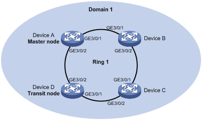

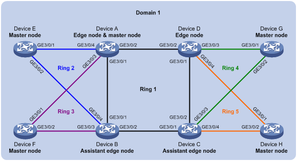

Figure 1 RRPP network diagram
RRPP domain
The interconnected devices with the same domain ID and control VLANs constitute an RRPP domain. The major elements of an RRPP domain includes the primary ring, subring, control VLAN, master node, transit node, primary port, secondary port, common port, and edge port.
As shown in Figure 1, Domain 1 is an RRPP domain, including two RRPP rings: Ring 1 and Ring 2. All the nodes on the two RRPP rings belong to the RRPP domain.

As shown in Figure 1, Ring 1 is the primary ring and Ring 2 is a subring. Device A is the master node of Ring 1, Device B, Device C and Device D are the transit nodes of Ring 1. Device E is the master node of Ring 2, Device B is the edge node of Ring 2, and Device C is the assistant-edge node of Ring 2.

As shown in Figure 1, Device A is the master node of Ring 1. Port 1 and Port 2 are the primary port and the secondary port of the master node on Ring 1, respectively. Device B, Device C, and Device D are the transit nodes of Ring 1. Their Port 1 and Port 2 are the primary port and the secondary port on Ring 1, respectively.
Common port and edge port
The ports connecting the edge node and assistant-edge node to the primary ring are common ports. The ports connecting the edge node and assistant-edge node only to the subrings are edge ports.
As shown in Figure 1, Device B and Device C lie on Ring 1 and Ring 2. Device B's Port 1 and Port 2 and Device C's Port 1 and Port 2 access the primary ring, so they are common ports. Device B's Port 3 and Device C's Port 3 access only the subring, so they are edge ports.

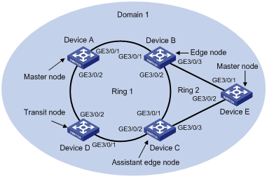

As shown in Figure 5, Ring 1 is the primary ring, and Ring 2 and Ring 3 are subrings. When the two SRPTs between the edge node and the assistant-edge node are down, the master nodes of Ring 2 and Ring 3 will open their respective secondary ports, generating a loop among Device B, Device C, Device E, and Device F and causing a broadcast storm.
To prevent generating a loop, the edge node will temporarily block the edge port. The blocked edge port is activated only when the edge node is sure that no loop will be generated when the edge port is activated.

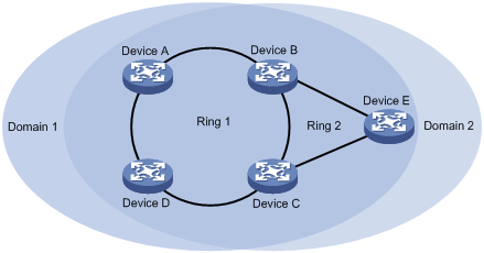

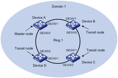

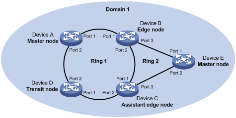

Single ring
As shown in Figure 2, only a single ring exists in the network topology. You only need to define an RRPP domain.
Figure 2 Schematic diagram for a single-ring network

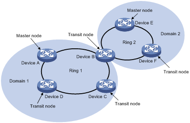

Tangent rings
As shown in Figure 3, two or more rings are in the network topology and only one common node exists between rings. You must define an RRPP domain for each ring.
Figure 3 Schematic diagram for a tangent-ring network

As shown in Figure 4, two or more rings are in the network topology and two common nodes exist between rings. You only need to define an RRPP domain, and configure one ring as the primary ring and the other rings as subrings.
Figure 4 Schematic diagram for an intersecting-ring network

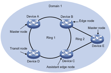

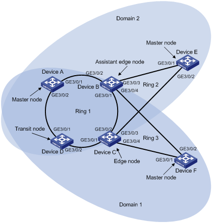

Dual homed rings
As shown in Figure 5, two or more rings are in the network topology and two similar common nodes exist between rings. You only need to define an RRPP domain, and configure one ring as the primary ring and the other rings as subrings.
Figure 5 Schematic diagram for a dual-homed-ring network

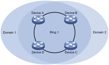

Single-ring load balancing
In a single-ring network, you can achieve load balancing by configuring multiple domains.
As shown in Figure 6, Ring 1 is configured as the primary ring of both Domain 1 and Domain 2. Domain 1 and Domain 2 are configured with different protected VLANs. In Domain 1, Device A is configured as the master node of Ring 1; in Domain 2, Device B is configured as the master node of Ring 1. Such configurations enable the ring to block different links based on VLANs and achieve single-ring load balancing.
Figure 6 Schematic diagram for a single-ring load balancing network

Single ring configuration example
Networking requirements
As shown in Figure 8,
·     Device A, Device B, Device C, and Device D form RRPP domain 1. Specify the primary control VLAN of RRPP domain 1 as VLAN 4092, and specify that RRPP domain 1 protects VLANs 1 through 30.
·     Device A, Device B, Device C and Device D form primary ring 1.
Specify Device A as the master node of primary ring 1, GigabitEthernet 3/0/1 as the primary port and GigabitEthernet 3/0/2 as the secondary port.
Specify Device B, Device C and Device D as the transit nodes of primary ring 1, their GigabitEthernet 3/0/1 as the primary port and GigabitEthernet 3/0/2 as the secondary port.
Figure 8 Network diagram

Intersecting ring configuration example
As shown in Figure 9,
·     Device A, Device B, Device C, Device D, and Device E form RRPP domain 1, VLAN 4092 is the primary control VLAN of RRPP domain 1, and RRPP domain 1 protects VLANs 1 through 30.
·     Device A, Device B, Device C and Device D form primary ring 1, and Device B, Device C and Device E form subring 2.
·     Device A is the master node of primary ring 1, with GigabitEthernet 3/0/1 as the primary port and GigabitEthernet 3/0/2 the secondary port.
·     Device E is the master node of subring 2, with GigabitEthernet 3/0/1 as the primary port and GigabitEthernet 3/0/2 the secondary port.
·     Device B is the transit node of primary ring 1 and the edge node of subring 2, and GigabitEthernet 3/0/3 is the edge port.
·     Device C is the transit node of primary ring 1 and the assistant-edge node of subring 1, and GigabitEthernet 3/0/3 is the edge port.
·     Device D is the transit node of primary ring 1, with GigabitEthernet 3/0/1 as the primary port and GigabitEthernet 3/0/2 the secondary port.
Figure 9 Network diagram

Dual homed rings configuration example
As shown in Figure 10,
·     Device A through Device H form RRPP domain 1. Specify the primary control VLAN of RRPP domain 1 as VLAN 4092, and specify that RRPP domain 1 protects VLANs 1 through 30.
·     Device A through Device D form primary ring 1. Device A, Device B, and Device E form subring 2. Device A, Device B, and Device F form subring 3. Device C, Device D, and Device G form subring 4. Device C, Device D, and Device H form subring 5.
Specify Device A as the master node of primary ring 1, GigabitEthernet 3/0/1 as the primary port and GigabitEthernet 3/0/2 as the secondary port. Specify Device E as the master node of subring 2, GigabitEthernet 3/0/1 as the primary port and GigabitEthernet 3/0/2 as the secondary port. Specify Device F as the master node of subring 3, GigabitEthernet 3/0/1 as the primary port and GigabitEthernet 3/0/2 as the secondary port. Specify Device G as the master node of subring 4, GigabitEthernet 3/0/1 as the primary port and GigabitEthernet 3/0/2 as the secondary port. Specify Device H as the master node of subring 5, GigabitEthernet 3/0/1 as the primary port and GigabitEthernet 3/0/2 as the secondary port.
Specify Device A as the edge node of the connected subrings, its GigabitEthernet 3/0/3 and GigabitEthernet 3/0/4 as the edge ports. Specify Device D as the transit node of the primary ring and edge node of the connected subrings, its GigabitEthernet 3/0/3 and GigabitEthernet 3/0/4 as the edge ports. Specify Device B and Device C as the transit node of the primary ring and assistant-edge nodes of the connected subrings, their GigabitEthernet 3/0/3 and GigabitEthernet 3/0/4 as the edge ports.
Configure the primary and secondary ports on the master nodes correctly to make sure other protocols still work correctly when data VLANs are denied by the secondary ports.
Figure 10 Network diagram

[DeviceA-rrpp-domain1] ring 2 node-mode edge edge-port gigabitEthernet3/0/4
[DeviceA-rrpp-domain1] ring 2 enable
# Configure Device A as the edge node of subring 3, with GigabitEthernet 3/0/3 as the edge port, and enable subring 3.
[DeviceA-rrpp-domain1] ring 3 node-mode edge edge-port gigabitEthernet3/0/3
[DeviceA-rrpp-domain1] ring 3 enable
[DeviceA-rrpp-domain1] quit

2.     Configure Device B:
# Create VLANs 1 through 30, map these VLANs to MSTI 1, and activate the MST region configuration.
<DeviceB> system-view
[DeviceB] vlan 1 to 30
[DeviceB] stp region-configuration
[DeviceB-mst-region] instance 1 vlan 1 to 30
[DeviceB-mst-region] active region-configuration
[DeviceB-mst-region] quit
# Set the physical state change suppression interval to 0 seconds on GigabitEthernet 3/0/1 through GigabitEthernet 3/0/4, disable the spanning tree feature, configure the four ports as trunk ports, and assign them to VLANs 1 through 30.
[DeviceB] interface gigabitEthernet3/0/1
[DeviceB-GigabitEthernet3/0/1] link-delay 0
[DeviceB-GigabitEthernet3/0/1] undo stp enable
[DeviceB-GigabitEthernet3/0/1] port link-type trunk
[DeviceB-GigabitEthernet3/0/1] port trunk permit vlan 1 to 30
[DeviceB-GigabitEthernet3/0/1] quit
[DeviceB] interface gigabitEthernet3/0/2
[DeviceB-GigabitEthernet3/0/2] link-delay 0
[DeviceB-GigabitEthernet3/0/2] undo stp enable
[DeviceB-GigabitEthernet3/0/2] port link-type trunk
[DeviceB-GigabitEthernet3/0/2] port trunk permit vlan 1 to 30
[DeviceB-GigabitEthernet3/0/2] quit
[DeviceB] interface gigabitEthernet3/0/3
[DeviceB-GigabitEthernet3/0/3] link-delay 0
[DeviceB-GigabitEthernet3/0/3] undo stp enable
[DeviceB-GigabitEthernet3/0/3] port link-type trunk
[DeviceB-GigabitEthernet3/0/3] port trunk permit vlan 1 to 30
[DeviceB-GigabitEthernet3/0/3] quit
[DeviceB] interface gigabitEthernet3/0/4
[DeviceB-GigabitEthernet3/0/4] link-delay 0
[DeviceB-GigabitEthernet3/0/4] undo stp enable
[DeviceB-GigabitEthernet3/0/4] port link-type trunk
[DeviceB-GigabitEthernet3/0/4] port trunk permit vlan 1 to 30
[DeviceB-GigabitEthernet3/0/4] quit
# Create RRPP domain 1, configure VLAN 4092 as the primary control VLAN of RRPP domain 1, and configure the VLANs mapped to MSTI 1 as the protected VLANs of RRPP domain 1.
[DeviceB] rrpp domain 1
[DeviceB-rrpp-domain1] control-vlan 4092
[DeviceB-rrpp-domain1] protected-vlan reference-instance 1
# Configure Device B as the transit node of primary ring 1, with GigabitEthernet 3/0/1 as the primary port and GigabitEthernet 3/0/2 as the secondary port, and enable ring 1.
[DeviceB-rrpp-domain1] ring 1 node-mode transit primary-port gigabitEthernet3/0/1 secondary-port gigabitEthernet3/0/2 level 0
[DeviceB-rrpp-domain1] ring 1 enable
# Configure Device B as the assistant-edge node of subring 2, with GigabitEthernet 3/0/4 as the edge port, and enable subring 2.
[DeviceB-rrpp-domain1] ring 2 node-mode assistant-edge edge-port gigabitEthernet3/0/4
[DeviceB-rrpp-domain1] ring 2 enable
# Configure Device B as the assistant-edge node of subring 3, with GigabitEthernet 3/0/3 as the edge port, and enable subring 3.
[DeviceB-rrpp-domain1] ring 3 node-mode assistant-edge edge-port gigabitEthernet3/0/3
[DeviceB-rrpp-domain1] ring 3 enable
[DeviceB-rrpp-domain1] quit
# Enable RRPP.
[DeviceB] rrpp enable
3.     Configure Device C:
<DeviceC> system-view
[DeviceC] vlan 1 to 30
[DeviceC] stp region-configuration
[DeviceC-mst-region] instance 1 vlan 1 to 30
[DeviceC-mst-region] active region-configuration
[DeviceC-mst-region] quit
[DeviceC] interface gigabitEthernet3/0/1
[DeviceC-GigabitEthernet3/0/1] link-delay 0
[DeviceC-GigabitEthernet3/0/1] undo stp enable
[DeviceC-GigabitEthernet3/0/1] port link-type trunk
[DeviceC-GigabitEthernet3/0/1] port trunk permit vlan 1 to 30
[DeviceC-GigabitEthernet3/0/1] quit
[DeviceC] interface gigabitEthernet3/0/2
[DeviceC-GigabitEthernet3/0/2] link-delay 0
[DeviceC-GigabitEthernet3/0/2] undo stp enable
[DeviceC-GigabitEthernet3/0/2] port link-type trunk
[DeviceC-GigabitEthernet3/0/2] port trunk permit vlan 1 to 30
[DeviceC-GigabitEthernet3/0/2] quit
[DeviceC] interface gigabitEthernet3/0/3
[DeviceC-GigabitEthernet3/0/3] link-delay 0
[DeviceC-GigabitEthernet3/0/3] undo stp enable
[DeviceC-GigabitEthernet3/0/3] port link-type trunk
[DeviceC-GigabitEthernet3/0/3] port trunk permit vlan 1 to 30
[DeviceC-GigabitEthernet3/0/3] quit
[DeviceC] interface gigabitEthernet3/0/4
[DeviceC-GigabitEthernet3/0/4] link-delay 0
[DeviceC-GigabitEthernet3/0/4] undo stp enable
[DeviceC-GigabitEthernet3/0/4] port link-type trunk
[DeviceC-GigabitEthernet3/0/4] port trunk permit vlan 1 to 30
[DeviceC-GigabitEthernet3/0/4] quit
[DeviceC] rrpp domain 1
[DeviceC-rrpp-domain1] control-vlan 4092
[DeviceC-rrpp-domain1] protected-vlan reference-instance 1
# Configure Device C as the transit node of primary ring 1, with GigabitEthernet 3/0/1 as the primary port and GigabitEthernet 3/0/2 as the secondary port, and enable ring 1.
[DeviceC-rrpp-domain1] ring 1 node-mode transit primary-port gigabitEthernet3/0/1 secondary-port gigabitEthernet3/0/2 level 0
[DeviceC-rrpp-domain1] ring 1 enable
# Configure Device C as the assistant-edge node of subring 4, with GigabitEthernet 3/0/3 as the edge port, and enable subring 4.
[DeviceC-rrpp-domain1] ring 4 node-mode assistant-edge edge-port gigabitEthernet3/0/3
[DeviceC-rrpp-domain1] ring 4 enable
# Configure Device C as the assistant-edge node of subring 5, with GigabitEthernet 3/0/4 as the edge port, and enable subring 5.
[DeviceC-rrpp-domain1] ring 5 node-mode assistant-edge edge-port gigabitEthernet3/0/4
[DeviceC-rrpp-domain1] ring 5 enable
[DeviceC-rrpp-domain1] quit
# Enable RRPP.
[DeviceC] rrpp enable
4.     Configure Device D:
<DeviceD> system-view
[DeviceD] vlan 1 to 30
[DeviceD] stp region-configuration
[DeviceD-mst-region] instance 1 vlan 1 to 30
[DeviceD-mst-region] active region-configuration
[DeviceD-mst-region] quit
[DeviceD] interface gigabitEthernet3/0/1
[DeviceD-GigabitEthernet3/0/1] link-delay 0
[DeviceD-GigabitEthernet3/0/1] undo stp enable
[DeviceD-GigabitEthernet3/0/1] port link-type trunk
[DeviceD-GigabitEthernet3/0/1] port trunk permit vlan 1 to 30
[DeviceD-GigabitEthernet3/0/1] quit
[DeviceD] interface gigabitEthernet3/0/2
[DeviceD-GigabitEthernet3/0/2] link-delay 0
[DeviceD-GigabitEthernet3/0/2] undo stp enable
[DeviceD-GigabitEthernet3/0/2] port link-type trunk
[DeviceD-GigabitEthernet3/0/2] port trunk permit vlan 1 to 30
[DeviceD-GigabitEthernet3/0/2] quit
[DeviceD] interface gigabitEthernet3/0/3
[DeviceD-GigabitEthernet3/0/3] link-delay 0
[DeviceD-GigabitEthernet3/0/3] undo stp enable
[DeviceD-GigabitEthernet3/0/3] port link-type trunk
[DeviceD-GigabitEthernet3/0/3] port trunk permit vlan 1 to 30
[DeviceD-GigabitEthernet3/0/3] quit
[DeviceD] interface gigabitEthernet3/0/4
[DeviceD-GigabitEthernet3/0/4] link-delay 0
[DeviceD-GigabitEthernet3/0/4] undo stp enable
[DeviceD-GigabitEthernet3/0/4] port link-type trunk
[DeviceD-GigabitEthernet3/0/4] port trunk permit vlan 1 to 30
[DeviceD-GigabitEthernet3/0/4] quit
[DeviceD] rrpp domain 1
[DeviceD-rrpp-domain1] control-vlan 4092
[DeviceD-rrpp-domain1] protected-vlan reference-instance 1
# Configure Device D as the transit node of primary ring 1, with GigabitEthernet 3/0/1 as the primary port and GigabitEthernet 3/0/2 as the secondary port, and enable ring 1.
[DeviceD-rrpp-domain1] ring 1 node-mode transit primary-port gigabitEthernet3/0/1 secondary-port gigabitEthernet3/0/2 level 0
[DeviceD-rrpp-domain1] ring 1 enable
# Configure Device D as the edge node of subring 4, with GigabitEthernet 3/0/3 as the edge port, and enable subring 4.
[DeviceD-rrpp-domain1] ring 4 node-mode edge edge-port gigabitEthernet3/0/3
[DeviceD-rrpp-domain1] ring 4 enable
# Configure Device D as the edge node of subring 5, with GigabitEthernet 3/0/4 as the edge port, and enable subring 5.
[DeviceD-rrpp-domain1] ring 5 node-mode edge edge-port gigabitEthernet3/0/4
[DeviceD-rrpp-domain1] ring 5 enable
[DeviceD-rrpp-domain1] quit
# Enable RRPP.
[DeviceD] rrpp enable
5.     Configure Device E:
<DeviceE> system-view
[DeviceE] vlan 1 to 30
[DeviceE] stp region-configuration
[DeviceE-mst-region] instance 1 vlan 1 to 30
[DeviceE-mst-region] active region-configuration
[DeviceE-mst-region] quit
# Set the physical state change suppression interval to 0 seconds on GigabitEthernet 3/0/1 and GigabitEthernet 3/0/2, disable the spanning tree feature, configure the two ports as trunk ports, and assign them to VLANs 1 through 30.
[DeviceE] interface gigabitEthernet3/0/1
[DeviceE-GigabitEthernet3/0/1] link-delay 0
[DeviceE-GigabitEthernet3/0/1] undo stp enable
[DeviceE-GigabitEthernet3/0/1] port link-type trunk
[DeviceE-GigabitEthernet3/0/1] port trunk permit vlan 1 to 30
[DeviceE-GigabitEthernet3/0/1] quit
[DeviceE] interface gigabitEthernet3/0/2
[DeviceE-GigabitEthernet3/0/2] link-delay 0
[DeviceE-GigabitEthernet3/0/2] undo stp enable
[DeviceE-GigabitEthernet3/0/2] port link-type trunk
[DeviceE-GigabitEthernet3/0/2] port trunk permit vlan 1 to 30
[DeviceE-GigabitEthernet3/0/2] quit
[DeviceE] rrpp domain 1
[DeviceE-rrpp-domain1] control-vlan 4092
[DeviceE-rrpp-domain1] protected-vlan reference-instance 1
# Configure Device E as the master node of subring 2, with GigabitEthernet 3/0/1 as the primary port and GigabitEthernet 3/0/2 as the secondary port, and enable subring 2.
[DeviceE-rrpp-domain1] ring 2 node-mode master primary-port gigabitEthernet3/0/1 secondary-port gigabitEthernet3/0/2 level 1
[DeviceE-rrpp-domain1] ring 2 enable
[DeviceE-rrpp-domain1] quit
# Enable RRPP.
[DeviceE] rrpp enable
6.     Configure Device F:
<DeviceF> system-view
[DeviceF] vlan 1 to 30
[DeviceF] stp region-configuration
[DeviceF-mst-region] instance 1 vlan 1 to 30
[DeviceF-mst-region] active region-configuration
[DeviceF-mst-region] quit
[DeviceF] interface gigabitEthernet3/0/1
[DeviceF-GigabitEthernet3/0/1] link-delay 0
[DeviceF-GigabitEthernet3/0/1] undo stp enable
[DeviceF-GigabitEthernet3/0/1] port link-type trunk
[DeviceF-GigabitEthernet3/0/1] port trunk permit vlan 1 to 30
[DeviceF-GigabitEthernet3/0/1] quit
[DeviceF] interface gigabitEthernet3/0/2
[DeviceF-GigabitEthernet3/0/2] link-delay 0
[DeviceF-GigabitEthernet3/0/2] undo stp enable
[DeviceF-GigabitEthernet3/0/2] port link-type trunk
[DeviceF-GigabitEthernet3/0/2] port trunk permit vlan 1 to 30
[DeviceF-GigabitEthernet3/0/2] quit
[DeviceF] rrpp domain 1
[DeviceF-rrpp-domain1] control-vlan 4092
[DeviceF-rrpp-domain1] protected-vlan reference-instance 1
# Configure Device F as the master node of subring 3, with GigabitEthernet 3/0/1 as the primary port and GigabitEthernet 3/0/2 as the secondary port, and enable subring 3.
[DeviceF-rrpp-domain1] ring 3 node-mode master primary-port gigabitEthernet3/0/1 secondary-port gigabitEthernet3/0/2 level 1
[DeviceF-rrpp-domain1] ring 3 enable
[DeviceF-rrpp-domain1] quit
# Enable RRPP.
[DeviceF] rrpp enable
7.     Configure Device G:
<DeviceG> system-view
[DeviceG] vlan 1 to 30
[DeviceG] stp region-configuration
[DeviceG-mst-region] instance 1 vlan 1 to 30
[DeviceG-mst-region] active region-configuration
[DeviceG-mst-region] quit
[DeviceG] interface gigabitEthernet3/0/1
[DeviceG-GigabitEthernet3/0/1] link-delay 0
[DeviceG-GigabitEthernet3/0/1] undo stp enable
[DeviceG-GigabitEthernet3/0/1] port link-type trunk
[DeviceG-GigabitEthernet3/0/1] port trunk permit vlan 1 to 30
[DeviceG-GigabitEthernet3/0/1] quit
[DeviceG] interface gigabitEthernet3/0/2
[DeviceG-GigabitEthernet3/0/2] link-delay 0
[DeviceG-GigabitEthernet3/0/2] undo stp enable
[DeviceG-GigabitEthernet3/0/2] port link-type trunk
[DeviceG-GigabitEthernet3/0/2] port trunk permit vlan 1 to 30
[DeviceG-GigabitEthernet3/0/2] quit
[DeviceG] rrpp domain 1
[DeviceG-rrpp-domain1] control-vlan 4092
[DeviceG-rrpp-domain1] protected-vlan reference-instance 1
# Configure Device G as the master node of subring 4, with GigabitEthernet 3/0/1 as the primary port and GigabitEthernet 3/0/2 as the secondary port, and enable subring 4.
[DeviceG-rrpp-domain1] ring 4 node-mode master primary-port gigabitEthernet3/0/1 secondary-port gigabitEthernet3/0/2 level 1
[DeviceG-rrpp-domain1] ring 4 enable
[DeviceG-rrpp-domain1] quit
# Enable RRPP.
[DeviceG] rrpp enable
8.     Configure Device H:
<DeviceH> system-view
[DeviceH] vlan 1 to 30
[DeviceH] stp region-configuration
[DeviceH-mst-region] instance 1 vlan 1 to 30
[DeviceH-mst-region] active region-configuration
[DeviceH-mst-region] quit
[DeviceH] rrpp domain 1
[DeviceH-rrpp-domain1] control-vlan 4092
[DeviceH-rrpp-domain1] protected-vlan reference-instance 1
# Configure Device H as the master node of subring 5, with GigabitEthernet 3/0/1 as the primary port and GigabitEthernet 3/0/2 as the secondary port, and enable subring 5.
[DeviceH-rrpp-domain1] ring 5 node-mode master primary-port gigabitEthernet3/0/1 secondary-port gigabitEthernet3/0/2 level 1
[DeviceH-rrpp-domain1] ring 5 enable
[DeviceH-rrpp-domain1] quit
# Enable RRPP.
[DeviceH] rrpp enable

Intersecting-ring load balancing configuration example
As shown in Figure 11,
·     Device A, Device B, Device C, Device D, and Device F form RRPP domain 1, and VLAN 100 is the primary control VLAN of the RRPP domain. Device A is the master node of the primary ring, Ring 1; Device D is the transit node of Ring 1; Device F is the master node of the subring Ring 3; Device C is the edge node of the subring Ring 3; Device B is the assistant-edge node of the subring Ring 3.
·     Device A, Device B, Device C, Device D, and Device E form RRPP domain 2, and VLAN 105 is the primary control VLAN of the RRPP domain. Device A is the master node of the primary ring, Ring 1; Device D is the transit node of Ring 1; Device E is the master node of the subring Ring 2; Device C is the edge node of the subring Ring 2; Device B is the assistant-edge node of the subring Ring 2.
Specify VLAN 10 as the protected VLAN of domain 1, and VLAN 20 the protected VLAN of domain 2. You can implement VLAN-based load balancing on Ring 1.
As the edge node and assistant-edge node of Ring 2 is the same as those of Ring 3, and the two subrings have the same SRPTs, you can add Ring 2 and Ring 3 to the RRPP ring group to reduce Edge-Hello traffic.
Figure 11 Network diagram
Configuration procedure
1.     Configure Device A:
# Create VLANs 10 and 20, map VLAN 10 to MSTI 1 and VLAN 20 to MSTI 2, and activate MST region configuration.
<DeviceA> system-view
[DeviceA] vlan 10
[DeviceA-vlan10] quit
[DeviceA] vlan 20
[DeviceA-vlan20] quit
[DeviceA] stp region-configuration
[DeviceA-mst-region] instance 1 vlan 10
[DeviceA-mst-region] instance 2 vlan 20
[DeviceA-mst-region] active region-configuration
[DeviceA-mst-region] quit
# Set the physical state change suppression interval to 0 seconds on GigabitEthernet 3/0/1 and GigabitEthernet 3/0/2, disable the spanning tree feature, configure the two ports as trunk ports, remove them from VLAN 1, and assign them to VLANs 10 and 20.
[DeviceA] interface gigabitethernet 3/0/1
[DeviceA-GigabitEthernet3/0/1] link-delay 0
[DeviceA-GigabitEthernet3/0/1] undo stp enable
[DeviceA-GigabitEthernet3/0/1] port link-type trunk
[DeviceA-GigabitEthernet3/0/1] undo port trunk permit vlan 1
[DeviceA-GigabitEthernet3/0/1] port trunk permit vlan 10 20
[DeviceA-GigabitEthernet3/0/1] quit
[DeviceA] interface gigabitethernet 3/0/2
[DeviceA-GigabitEthernet3/0/2] link-delay 0
[DeviceA-GigabitEthernet3/0/2] undo stp enable
[DeviceA-GigabitEthernet3/0/2] port link-type trunk
[DeviceA-GigabitEthernet3/0/2] undo port trunk permit vlan 1
[DeviceA-GigabitEthernet3/0/2] port trunk permit vlan 10 20
[DeviceA-GigabitEthernet3/0/2] quit
# Create RRPP domain 1, configure VLAN 100 as the primary control VLAN of RRPP domain 1, and configure the VLAN mapped to MSTI 1 as the protected VLAN of RRPP domain 1.
[DeviceA] rrpp domain 1
[DeviceA-rrpp-domain1] control-vlan 100
[DeviceA-rrpp-domain1] protected-vlan reference-instance 1
# Configure Device A as the master node of primary ring 1, with GigabitEthernet 3/0/1 as the primary port and GigabitEthernet 3/0/2 as the secondary port, and enable ring 1.
[DeviceA-rrpp-domain1] ring 1 node-mode master primary-port gigabitethernet 3/0/1 secondary-port gigabitethernet 3/0/2 level 0
[DeviceA-rrpp-domain1] ring 1 enable
# Create RRPP domain 2, configure VLAN 105 as the primary control VLAN of RRPP domain 2, and configure the VLAN mapped to MSTI 2 as the protected VLAN of RRPP domain 2.
[DeviceA] rrpp domain 2
[DeviceA-rrpp-domain2] control-vlan 105
[DeviceA-rrpp-domain2] protected-vlan reference-instance 2
# Configure Device A as the master node of primary ring 1, with GigabitEthernet 3/0/2 as the master port and GigabitEthernet 3/0/1 as the secondary port, and enable ring 1.
[DeviceA-rrpp-domain2] ring 1 node-mode master primary-port gigabitethernet 3/0/2 secondary-port gigabitethernet 3/0/1 level 0
[DeviceA-rrpp-domain2] ring 1 enable
[DeviceA-rrpp-domain2] quit
# Enable RRPP.
[DeviceA] rrpp enable
[DeviceB] vlan 10
[DeviceB-vlan10] quit
[DeviceB] vlan 20
[DeviceB-vlan20] quit
[DeviceB-mst-region] instance 1 vlan 10
[DeviceB-mst-region] instance 2 vlan 20
[DeviceB] interface gigabitethernet 3/0/1
[DeviceB-GigabitEthernet3/0/1] undo port trunk permit vlan 1
[DeviceB-GigabitEthernet3/0/1] port trunk permit vlan 10 20
[DeviceB] interface gigabitethernet 3/0/2
[DeviceB-GigabitEthernet3/0/2] undo port trunk permit vlan 1
[DeviceB-GigabitEthernet3/0/2] port trunk permit vlan 10 20
# Set the physical state change suppression interval to 0 seconds on GigabitEthernet 3/0/3, disable the spanning tree feature, configure the port as a trunk port, remove it from VLAN 1, and assign it to VLAN 20.
[DeviceB] interface gigabitethernet 3/0/3
[DeviceB-GigabitEthernet3/0/3] undo port trunk permit vlan 1
[DeviceB-GigabitEthernet3/0/3] port trunk permit vlan 20
# Set the physical state change suppression interval to 0 seconds on GigabitEthernet 3/0/4, disable the spanning tree feature, configure the port as a trunk port, remove it from VLAN 1, and assign it to VLAN 10.
[DeviceB] interface gigabitethernet 3/0/4
[DeviceB-GigabitEthernet3/0/4] undo port trunk permit vlan 1
[DeviceB-GigabitEthernet3/0/4] port trunk permit vlan 10
[DeviceB-rrpp-domain1] control-vlan 100
# Configure Device B as a transit node of primary ring 1 in RRPP domain 1, with GigabitEthernet 3/0/1 as the primary port and GigabitEthernet 3/0/2 as the secondary port, and enable ring 1.
[DeviceB-rrpp-domain1] ring 1 node-mode transit primary-port gigabitethernet 3/0/1 secondary-port gigabitethernet 3/0/2 level 0
# Configure Device B as the assistant-edge node of subring 3 in RRPP domain 1, with GigabitEthernet 3/0/4 as the edge port, and enable subring 3.
[DeviceB-rrpp-domain1] ring 3 node-mode assistant-edge edge-port gigabitethernet 3/0/4
 [DeviceB] rrpp domain 2
[DeviceB-rrpp-domain2] control-vlan 105
[DeviceB-rrpp-domain2] protected-vlan reference-instance 2
[DeviceB-rrpp-domain2] ring 1 node-mode transit primary-port gigabitethernet 3/0/1 secondary-port gigabitethernet 3/0/2 level 0
[DeviceB-rrpp-domain2] ring 1 enable
# Configure Device B as the assistant-edge node of subring 2 in RRPP domain 2, with GigabitEthernet 3/0/3 as the edge port, and enable subring 2.
[DeviceB-rrpp-domain2] ring 2 node-mode assistant-edge edge-port gigabitethernet 3/0/3
[DeviceB-rrpp-domain2] ring 2 enable
[DeviceB-rrpp-domain2] quit
# Enable RRPP.
[DeviceC] vlan 10
[DeviceC-vlan10] quit
[DeviceC] vlan 20
[DeviceC-vlan20] quit
[DeviceC-mst-region] instance 1 vlan 10
[DeviceC-mst-region] instance 2 vlan 20
[DeviceC] interface gigabitethernet 3/0/1
[DeviceC-GigabitEthernet3/0/1] undo port trunk permit vlan 1
[DeviceC-GigabitEthernet3/0/1] port trunk permit vlan 10 20
[DeviceC] interface gigabitethernet 3/0/2
[DeviceC-GigabitEthernet3/0/2] undo port trunk permit vlan 1
[DeviceC-GigabitEthernet3/0/2] port trunk permit vlan 10 20
[DeviceC] interface gigabitethernet 3/0/3
[DeviceC-GigabitEthernet3/0/3] undo port trunk permit vlan 1
[DeviceC-GigabitEthernet3/0/3] port trunk permit vlan 20
[DeviceC] interface gigabitethernet 3/0/4
[DeviceC-GigabitEthernet3/0/4] undo port trunk permit vlan 1
[DeviceC-GigabitEthernet3/0/4] port trunk permit vlan 10
[DeviceC-rrpp-domain1] control-vlan 100
# Configure Device C as the transit node of primary ring 1 in RRPP domain 1, with GigabitEthernet 3/0/1 as the primary port and GigabitEthernet 3/0/2 as the secondary port, and enable ring 1.
[DeviceC-rrpp-domain1] ring 1 node-mode transit primary-port gigabitethernet 3/0/1 secondary-port gigabitethernet 3/0/2 level 0
# Configure Device C as the edge node of subring 3 in RRPP domain 1, with GigabitEthernet 3/0/4 as the edge port, and enable subring 3.
[DeviceC-rrpp-domain1] ring 3 node-mode edge edge-port gigabitethernet 3/0/4
[DeviceC-rrpp-domain1] ring 3 enable
[DeviceC] rrpp domain 2
[DeviceC-rrpp-domain2] control-vlan 105
[DeviceC-rrpp-domain2] protected-vlan reference-instance 2
# Configure Device C as the transit node of primary ring 1 in RRPP domain 2, with GigabitEthernet 3/0/1 as the primary port and GigabitEthernet 3/0/2 as the secondary port, and enable ring 1.
[DeviceC-rrpp-domain2] ring 1 node-mode transit primary-port gigabitethernet 3/0/1 secondary-port gigabitethernet 3/0/2 level 0
[DeviceC-rrpp-domain2] ring 1 enable
# Configure Device C as the edge node of subring 2 in RRPP domain 2, with GigabitEthernet 3/0/3 as the edge port, and enable subring 2.
[DeviceC-rrpp-domain2] ring 2 node-mode edge edge-port GigabitEthernet3/0/3
[DeviceC-rrpp-domain2] ring 2 enable
[DeviceC-rrpp-domain2] quit
# Enable RRPP.
[DeviceD] vlan 10
[DeviceD-vlan10] quit
[DeviceD] vlan 20
[DeviceD-vlan20] quit
[DeviceD-mst-region] instance 1 vlan 10
[DeviceD-mst-region] instance 2 vlan 20
[DeviceD] interface gigabitethernet 3/0/1
[DeviceD-GigabitEthernet3/0/1] undo port trunk permit vlan 1
[DeviceD-GigabitEthernet3/0/1] port trunk permit vlan 10 20
[DeviceD] interface gigabitethernet 3/0/2
[DeviceD-GigabitEthernet3/0/2] undo port trunk permit vlan 1
[DeviceD-GigabitEthernet3/0/2] port trunk permit vlan 10 20
[DeviceD-rrpp-domain1] control-vlan 100
# Configure Device D as the transit node of primary ring 1 in RRPP domain 1, with GigabitEthernet 3/0/1 as the primary port and GigabitEthernet 3/0/2 as the secondary port, and enable ring 1.
[DeviceD-rrpp-domain1] ring 1 node-mode transit primary-port gigabitethernet 3/0/1 secondary-port gigabitethernet 3/0/2 level 0
# Create RRPP domain 2, configure VLAN 105 as the primary control VLAN of RPPP domain 2, and configure the VLAN mapped to MSTI 2 as the protected VLAN of RRPP domain 2.
[DeviceD] rrpp domain 2
[DeviceD-rrpp-domain2] control-vlan 105
[DeviceD-rrpp-domain2] protected-vlan reference-instance 2
# Configure Device D as the transit node of primary ring 1 in RRPP domain 2, with GigabitEthernet 3/0/1 as the primary port and GigabitEthernet 3/0/2 as the secondary port, and enable ring 1.
[DeviceD-rrpp-domain2] ring 1 node-mode transit primary-port gigabitethernet 3/0/1 secondary-port gigabitethernet 3/0/2 level 0
[DeviceD-rrpp-domain2] ring 1 enable
[DeviceD-rrpp-domain2] quit
# Enable RRPP.

# Create RRPP domain 2, configure VLAN 105 as the primary control VLAN, and configure the VLAN mapped to MSTI 2 as the protected VLAN.
[DeviceE] rrpp domain 2
[DeviceE-rrpp-domain2] control-vlan 105
[DeviceE-rrpp-domain2] protected-vlan reference-instance 2
# Configure Device E as the master mode of subring 2 in RRPP domain 2, with GigabitEthernet 3/0/2 as the primary port and GigabitEthernet 3/0/1 as the secondary port, and enable ring 2.
[DeviceE-rrpp-domain2] ring 2 node-mode master primary-port gigabitethernet 3/0/2 secondary-port gigabitethernet 3/0/1 level 1
[DeviceE-rrpp-domain2] ring 2 enable
[DeviceE-rrpp-domain2] quit
# Enable RRPP.
# Create VLAN 10, map VLAN 10 to MSTI 1, and activate MST region configuration.
[DeviceF] vlan 10
[DeviceF-vlan10] quit
[DeviceF-mst-region] instance 1 vlan 10
# Set the physical state change suppression interval to 0 seconds on GigabitEthernet 3/0/1 and GigabitEthernet 3/0/2, disable the spanning tree feature, configure the two ports as trunk ports, remove them from VLAN 1, and assign them to VLAN 10.
[DeviceF] interface gigabitethernet 3/0/1
[DeviceF-GigabitEthernet3/0/1] undo port trunk permit vlan 1
[DeviceF-GigabitEthernet3/0/1] port trunk permit vlan 10
[DeviceF] interface gigabitethernet 3/0/2
[DeviceF-GigabitEthernet3/0/2] undo port trunk permit vlan 1
[DeviceF-GigabitEthernet3/0/2] port trunk permit vlan 10
# Create RRPP domain 1, configure VLAN 100 as the primary control VLAN, and configure the VLAN mapped to MSTI 1 as the protected VLAN.
[DeviceF-rrpp-domain1] control-vlan 100
# Configure Device F as the master node of subring 3 in RRPP domain 1, with GigabitEthernet 3/0/1 as the primary port and GigabitEthernet 3/0/2 as the secondary port, and enable subring 3.
[DeviceF-rrpp-domain1] ring 3 node-mode master primary-port gigabitethernet 3/0/1 secondary-port gigabitethernet 3/0/2 level 1
# Enable RRPP.
7.     Configure RRPP ring groups on Device B and Device C after the configurations:
# Create RRPP ring group 1 on Device B, and add subrings 2 and 3 to the RRPP ring group.
[DeviceB] rrpp ring-group 1
[DeviceB-rrpp-ring-group1] domain 2 ring 2
[DeviceB-rrpp-ring-group1] domain 1 ring 3
# Create RRPP ring group 1 on Device C, and add subrings 2 and 3 to the RRPP ring group.
[DeviceC] rrpp ring-group 1
[DeviceC-rrpp-ring-group1] domain 2 ring 2
[DeviceC-rrpp-ring-group1] domain 1 ring 3
8.     Verify the configuration.
