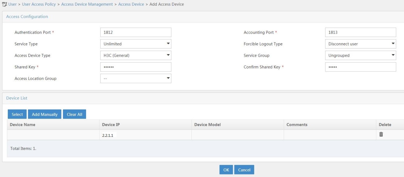

For dual-link central AC backup to operate correctly, configure the local AC and manual AP settings on both central ACs. Make sure the priority settings on the local AC, the master central AC, and the backup central AC are correctly configured so that the local AC can re-associate with the master central AC when the master central AC recovers from a failure.
For the RADIUS server to dynamically change client authorization information or forcibly disconnect a wireless client, enable the RADIUS session-control feature on the central ACs.
For GigabitEthernet 1/0/1 to forward client data traffic in VLAN 300, edit a .txt AP configuration file and upload the file to the central ACs. In the file, the port is added to VLAN 300.
To avoid dynamic authorization failures, configure the RADIUS Dynamic Authorization Extensions Server (DAS) feature on the central ACs.

Adding the central ACs as access devices to IMC
This example only illustrates the process to add Central AC 1 to IMC as an access device. You can add Central AC 2 at 2.2.1.2 to IMC in the same way Central AC 1 is added.
To add Central AC 1 to IMC as an access device:
1.     Log in to IMC and click the User tab.
2.     From the navigation tree, select User Access Policy > Access Device Management > Access Device.
3.     Click Add.
The Add Access Device page opens.
4.     In the Access Configuration area, configure the following parameters, as shown in Figure 2:
¡     Enter 123456 in the Shared Key and Confirm Shared Key fields. The shared key must be the same as the authentication and accounting shared keys configured on the AC.
¡     Use the default values for other parameters.
5.     In the Device List area, click Select or Add Manually to add Central AC 1 at 2.2.1.1 as an access device.
The IP address must be the source IP address specified for outgoing RADIUS packets on the AC.
6.     Click OK.
Figure 2 Adding an access device
