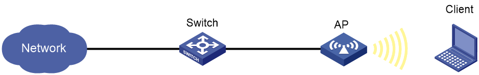

As shown in Figure 1, configure the AP to learn the client's IP address only from DHCPv6 packets.
Figure 1 Network diagram
# Configure wireless services. (Details not shown.)
For more information, see WLAN Access Configuration Guide.
# Disable snooping ND packets.
<AP> system-view
[AP] wlan service-template service
[AP-wlan-st-service] undo client ipv6-snooping nd-learning enable
# Enable snooping DHCPv6 packets.
[AP-wlan-st-service] client ipv6-snooping dhcpv6-learning enable
[AP-wlan-st-service] quit
# Verify that the AP has learned the IPv6 address of the client.
[AP] display wlan client ipv6
MAC address    AP name              IPv6 address                            VLAN
84db-ac14-dd08 fatap                1::2:0:0:3                              1
