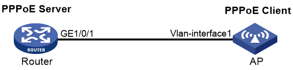

Router-initiated network structure
As shown in Figure 1, the PPPoE session is established between devices (Device A and Device B). All hosts share one PPPoE session for data transmission without being installed with PPPoE client software. This network structure is typically used by enterprises.
Figure 1 Router-initiated network structure

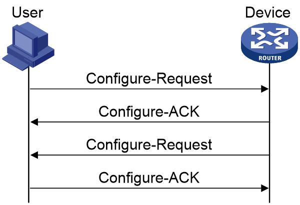

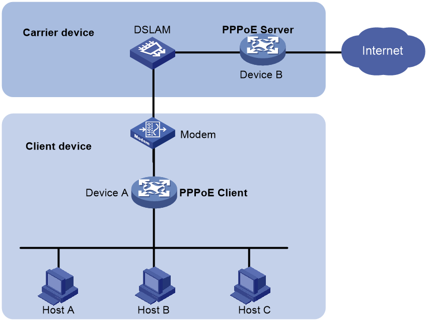

Host-initiated network structure
As shown in Figure 2, a PPPoE session is established between each host (PPPoE client) and the carrier device (PPPoE server). The service provider assigns an account to each host for billing and control. The host must be installed with PPPoE client software.
Figure 2 Host-initiated network structure

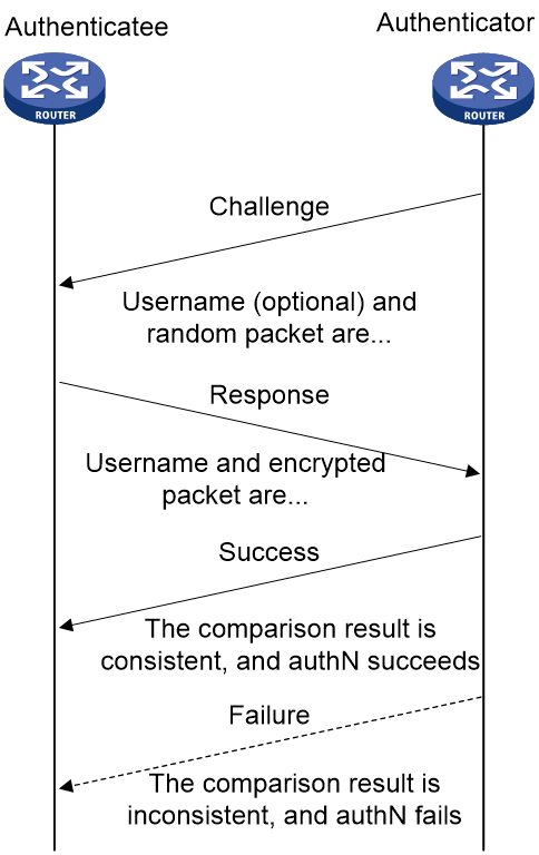

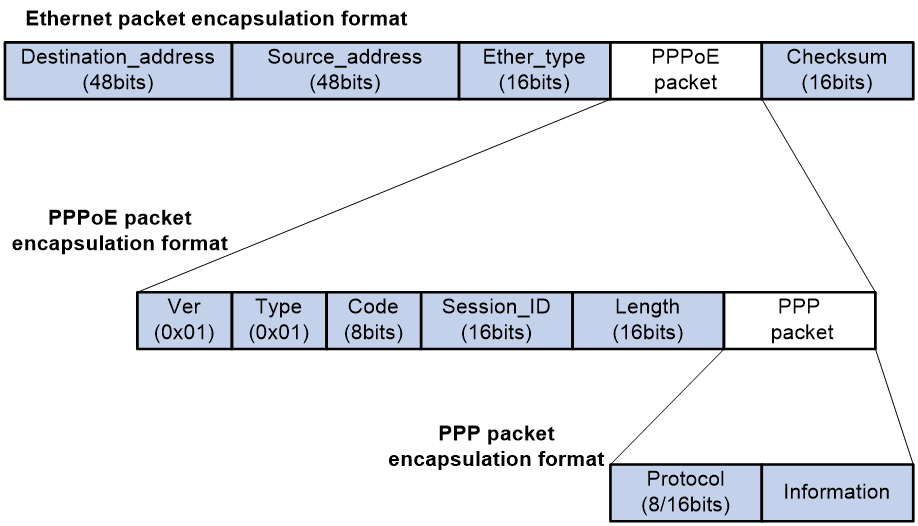

PPPoE packet structure
The format of PPPoE packets carries PPP packets in Ethernet frames. The encapsulation structure of the packets is as shown in Figure 3.
Figure 3 PPPoE packet structure
Table 1 Fields in the PPPoE packets
Field
Description
Destination address
An Ethernet unicast destination address or Ethernet broadcast address (0xffffffffffff):
·     In the discovery phase, the field value is a unicast or broadcast address. The PPPoE client uses a broadcast address to find the PPPoE server, and then uses a unicast address after determining the PPPoE server.
·     In the session phase, this field must be the unicast address of the peer end determined during the discovery phase.
Source_address
Ethernet MAC address of the source device.
Ether_type
Set to 0x8863 (discovery phase) or 0x8864 (session phase).
Ver
4 bits long. This field represents the PPPoE version number. The value is 0x1.
Type
4 bits long. This field represents the PPPoE type. The value is 0x1.
Code
8 bits. This field represents the PPPoE packet type. Possible values include:
·     0x00—Session data.
·     0x09—PADI packet.
·     0x07—PADO or PADT packet.
·     0x19—PADR packet.
·     0x65—PADS packet.
Session_ID
16 bits long. The value is fixed for a given PPP session and, in fact, defines a PPP session along with the Ethernet Source_address and Destination_address fields. The value of 0xffff is reserved for future use and must not be used.
Length
16 bits long. This field defines the length of the PPPoE payload. It does not include the length of the Ethernet or PPPoE headers.
PPP packet
For the PPP packet structure, see the frame format for PPP packet encapsulation in basic PPP concepts.

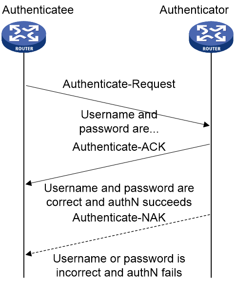

PPPoE negotiation
In the PPPoE negotiation phase, the device assigns a session ID for the user's PPPoE access. A session ID uniquely identifies a virtual PPPoE link between the user and the device. The negotiation process of PPPoE is as shown in Figure 4.
1.     The user broadcasts a PPPoE Active Discovery Initiation (PADI) packet, which contains the type of service the user wants.
2.     Upon receiving this PADI packet, all access concentrators on the Ethernet (such as the device in the diagram) compare the requested service with their own capabilities. The device that can provide the service responds with a PPPoE Active Discovery Offer (PADO) packet.
3.     The user might receive PADO packets from different devices. The user selects a device from the returned PADO packets based on certain conditions and sends to the device a non-broadcast session request packet, PPPoE Active Discovery Request (PADR). The PADR packet has the required service information encapsulated.
4.     The selected device starts to enter the PPP session phase after receiving the PADR packet. The device will generate a session ID to uniquely identify the PPPoE session between the device and the host. The device includes this specific session ID in a session confirmation packet, PPPoE Active Discovery Session-confirmation (PADS), and sends the PADS packet to the user. If no errors occur, the device enters the PPP session phase. When the user receives the PADS packet, the user also enters the PPP session phase if no errors occur.
Figure 4 PPPoE negotiation process

As shown in Figure 9, Router serves as a PPPoE server. Configure AP as a PPPoE client operating in permanent mode.
Figure 9 Network diagram
1.     Configure Router as the PPPoE server:
# Configure an IP address for Virtual-Template 1 and specify an IP address for the peer.
<Router> system-view
[Router] interface virtual-template 1
[Router-Virtual-Template1] ip address 1.1.1.1 255.0.0.0
[Router-Virtual-Template1] remote address 1.1.1.2
# Configure Virtual-Template 1 to authenticate the peer by using PAP.
[Router-Virtual-Template1] ppp authentication-mode pap domain dm1
[Router-Virtual-Template1] quit
# Enable the PPPoE server on GigabitEthernet 1/0/1, and bind the interface to Virtual-Template 1.
[Router] interface gigabitethernet 1/0/1
[Router-GigabitEthernet1/0/1] pppoe-server bind virtual-template 1
[Router-GigabitEthernet1/0/1] quit
# Configure a PPPoE user.
[Router] local-user user1 class network
[Router-luser-network-user1] password simple 123456TESTplat&!
[Router-luser-network-user1] service-type ppp
[Router-luser-network-user1] quit
# Configure local AAA for the PPP users in ISP domain dm1.
[Router] domain dm1
[Router-isp-dm1] authentication ppp local
[Router-isp-dm1] accounting ppp local
[Router-isp-dm1] authorization ppp local
[Router-isp-dm1] quit
2.     Configure AP as the PPPoE client:
# Create dialer group 1 and configure a dial rule for it.
<AP> system-view
[AP] dialer-group 1 rule ip permit
# Enable bundle DDR on Dialer 1.
[AP] interface dialer 1
[AP-Dialer1] dialer bundle enable
# Associate Dialer 1 with dialer group 1.
[AP-Dialer1] dialer-group 1
# Configure Dialer 1 to obtain an IP address through PPP negotiation.
[AP-Dialer1] ip address ppp-negotiate
# On Dialer 1, configure the PAP username and password sent from AP to Router as user1 and 123456TESTplat&! when AP is authenticated by Router by using PAP.
[AP-Dialer1] ppp pap local-user user1 password simple 123456TESTplat&!
[AP-Dialer1] quit
# Configure a PPPoE session that corresponds to dialer bundle 1 (dialer bundle 1 corresponds to Dialer 1).
[AP] interface vlan-interface 1
[AP-Vlan-interface1] pppoe-client dial-bundle-number 1
[AP-Vlan-interface1] quit
# Configure the PPPoE session to operate in permanent mode.
[AP-Dialer1] dialer timer idle 0
# Set the DDR auto-dial interval to 60 seconds.
[AP-Dialer1] dialer timer autodial 60
[AP-Dialer1] quit
# Configure a static route.
[AP] ip route-static 1.1.1.1 255.0.0.0 dialer 1
# Display summary information about the PPPoE session established between AP and Router (PPPoE server).
[AP-Dialer1] display pppoe-client session summary
Bundle ID    Interface    VA          RemoteMAC      LocalMAC       State
1      1     Vlan1        VA0         00e0-1400-4300 00e0-1500-4100 SESSION
