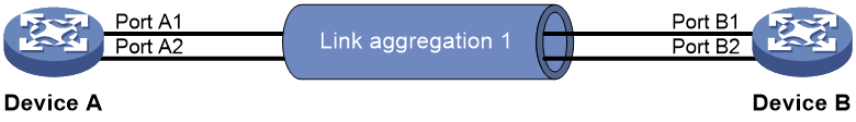

Ethernet link aggregation application scenario
As shown in Figure 1, Device A and Device B are connected by two physical Ethernet links. Both physical Ethernet links are combined into an aggregate link called link aggregation 1. The bandwidth of this aggregate link can reach up to the total bandwidth of the two physical Ethernet links. At the same time, the two Ethernet links back up one another. When a physical Ethernet link fails, the traffic transmitted on the failed link is switched to another link.
Figure 1 Ethernet link aggregation diagram

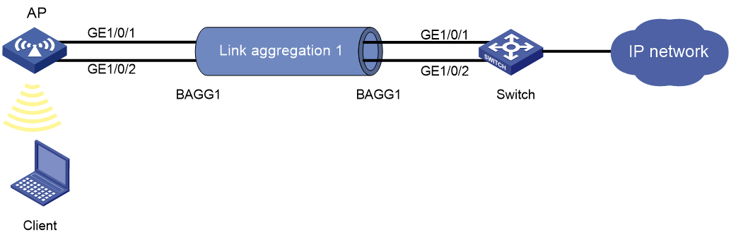

Example: Configuring a Layer 2 static aggregation group
On the network shown in Figure 4, perform the following tasks:
·     Configure a Layer 2 static aggregation group on both the AP and the switch.
·     Configure the aggregation group to distribute traffic based on the source and destination MAC addresses.
Figure 4 Network diagram
1.     Configure the AP:
# Create Layer 2 aggregate interface Bridge-Aggregation 1.
<AP> system-view
[AP] interface bridge-aggregation 1
[AP-Bridge-Aggregation1] quit
# Assign ports GigabitEthernet 1/0/1 and GigabitEthernet 1/0/2 to link aggregation group 1.
[AP] interface gigabitethernet 1/0/1
[AP-GigabitEthernet1/0/1] port link-aggregation group 1
[AP-GigabitEthernet1/0/1] quit
[AP] interface gigabitethernet 1/0/2
[AP-GigabitEthernet1/0/2] port link-aggregation group 1
[AP-GigabitEthernet1/0/2] quit
# Configure the aggregation group to distribute traffic based on the source and destination MAC addresses.
[AP] link-aggregation global load-sharing mode source-mac destination-mac
2.     Configure the switch in the same way the AP is configured. (Details not shown.)
# Display detailed information about all aggregation groups on the AP.
[AP] display link-aggregation verbose
Loadsharing Type: Shar -- Loadsharing, NonS -- Non-Loadsharing
Port Status: S -- Selected, U -- Unselected, I -- Individual
Port: A -- Auto port
Flags:  A -- LACP_Activity, B -- LACP_Timeout, C -- Aggregation,
        G -- Defaulted, H -- Expired
Aggregate Interface: Bridge-Aggregation1
Aggregation Mode: Static
  Port             Status  Priority Oper-Key
  GE1/0/1          S       32768    1
  GE1/0/2          S       32768    1
The output shows that link aggregation group 1 is a Layer 2 static aggregation group that contains two Selected ports.
Example: Configuring a Layer 2 dynamic aggregation group
On the network shown in Figure 5, perform the following tasks:
·     Configure a Layer 2 dynamic aggregation group on both the AP and the switch.
Figure 5 Network diagram
# Create Layer 2 aggregate interface Bridge-Aggregation 1, and set the link aggregation mode to dynamic.
<AP> system-view
[AP-Bridge-Aggregation1] link-aggregation mode dynamic
Creation Mode: Manual
Aggregation Mode: Dynamic
System ID: 0x8000, 000f-e267-6c6a
Local:
  Port             Status  Priority Oper-Key  Flag
  GE1/0/1          S       32768    1         {ACDEF}
  GE1/0/2          S       32768    1         {ACDEF}
Remote:
  Actor            Partner Priority Oper-Key  SystemID               Flag
  GE1/0/1          1       32768    1         0x8000, 000f-e267-57ad {ACDEF}
  GE1/0/2          2       32768    1         0x8000, 000f-e267-57ad {ACDEF}
The output shows that link aggregation group 1 is a Layer 2 dynamic aggregation group that contains two Selected ports.
