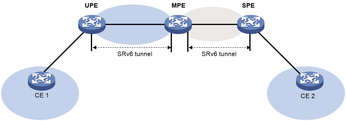

As shown in Figure 1, in an SRv6 HoVPN scenario, there's an SRv6 network between the UPE and the MPE and another between the MPE and the SPE. This feature measures the performance across the entire UPE-to-SPE link.
Figure 1 SRv6 HoVPN networking scenario
Operating mechanism
To monitor the entire link performance between the UPE and the SPE, execute this command on the MPE and specify the next-hop locator. When the MPE receives a packet from the UPE, and the next-hop locator is the specified SPE, MPE inherits the iFIT header in the received packet into the SRv6 packet sent to the SPE. This retains the iFIT header information during traffic transmission on a hierarchical network for measuring link performance.
If you do not execute this command, when the traffic passes through the MPE, the original iFIT header is removed and a new iFIT header is added based on the egress interface that belongs to another SRv6 network.
