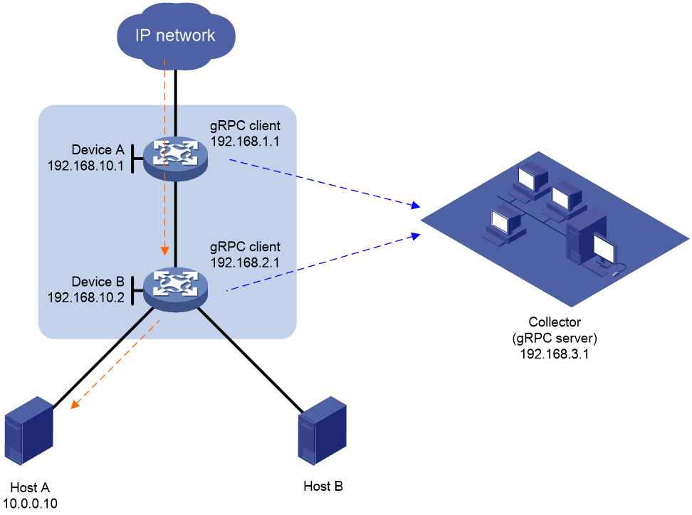

Example: Configuring common MOD to send packets through gRPC
As shown in Figure 2, Host A and Host B access the external network through Device A and Device B. Some packets from the external network are missing on Host A. Configure MOD on the access device and aggregation device to identify whether packets are dropped during the forwarding process on the two devices.
Figure 2 Network diagram
Configure IP addresses for devices, and make sure they can reach each other at Layer 3.
Procedures
1.     Configure Device A:
a.     Configure a flow group:
# Create advanced IPv4 ACL 3000, and configure a rule to match packets with destination IP address 10.0.0.10 for the ACL.
<DeviceA> system-view
[DeviceA] acl advanced 3000
[DeviceA-acl-ipv4-adv-3000] rule permit ip destination 10.0.0.10 0
[DeviceA-acl-ipv4-adv-3000] quit
# Create flow group 1 and configure it to reference ACL 3000.
[DeviceA] telemetry flow-group 1
[DeviceA-telemetry-flow-group-1] if-match acl 3000
# Configure the flow group to generate flow entries based on the destination IP address.
[DeviceA-telemetry-flow-group-1] template destination-ip
[DeviceA-telemetry-flow-group-1] quit
# Set the flow entry aging time to 50 minutes.
[DeviceA] telemetry flow-group aging-time 50
# Apply flow group 1.
[DeviceA] telemetry apply flow-group 1
b.     Configure MOD:
# Configure the device ID for MOD as 192.168.10.1.
[DeviceA] telemetry mod
[DeviceA-telemetry-mod] device-id 192.168.10.1
# Configure MOD to use gRPC to send packets to the collector.
[DeviceA-telemetry-mod] transport-protocol grpc
# Configure MOD to monitor all packet drop reasons.
[DeviceA-telemetry-mod] reason-list all
[DeviceA-telemetry-mod] quit
c.     Configure gRPC:
# Enable the gRPC service.
[DeviceA] grpc enable
# Create a sensor group named test, and add sensor path telemetryftrace/Genevent.
[DeviceA] telemetry
[DeviceA-telemetry] sensor-group test
[DeviceA-telemetry-sensor-group-test] sensor path telemetryftrace/Genevent
[DeviceA-telemetry-sensor-group-test] quit
# Create a destination group named collector1. Specify a collector that uses IPv4 address 192.168.3.1 and port number 50050.
[DeviceA-telemetry] destination-group collector1
[DeviceA-telemetry-destination-group-collector1] ipv4-address 192.168.3.1 port 50050
[DeviceA-telemetry-destination-group-collector1] quit
# Configure a subscription named A to bind sensor group test with destination group collector1.
[DeviceA-telemetry] subscription A
[DeviceA-telemetry-subscription-A] sensor-group test
[DeviceA-telemetry-subscription-A] destination-group collector1
[DeviceA-telemetry-subscription-A] quit
[DeviceA-telemetry] quit
2.     Configure Device B.
Configure Device B in the same way Device A is configured except the device ID for MOD.
1.     Verify the configuration on Device A:
# Display the ACL configuration.
<DeviceA> display acl 3000
Advanced IPv4 ACL 3000, 1 rule,
ACL's step is 5, start ID is 0
 rule 0 permit ip destination 10.0.0.10 0
# Display the flow group configuration.
<DeviceA> display telemetry flow-group 1
Flow group 1 (Successful)
  ACL       : 3000
  Template  :
    destination-ip
  Mode      : Common-MOD
Aging time: 50 minutes
Rate limit: -
Max  entry: -
# Display the MOD configuration.
<DeviceA> display telemetry mod
Status             : Successful
Drop reason list   :
DeviceID           : 192.168.10.1
Transport protocol : gRPC
2.     Verify the configuration on Device B.
The configuration on Device B is the same as the configuration on Device A except the device ID for MOD. (Details not shown.)
3.     Verify the configuration on the collector.
When a packet destined for IP address 10.0.0.10 is dropped during the forwarding process on Device A and Device B, the collector (gRPC server) can receive the packet drop reason and the characteristics of the dropped packet from the devices (gRPC clients).
