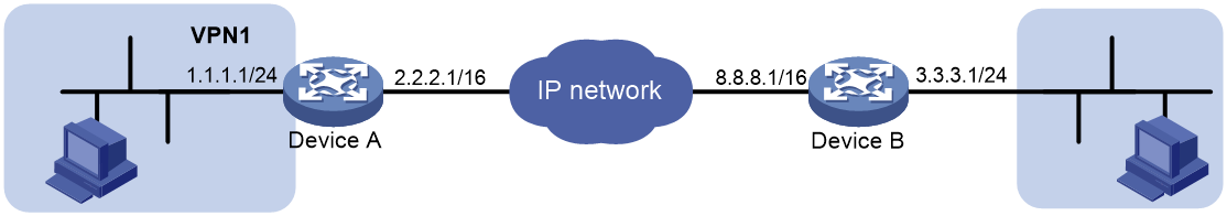

IPsec RRI
IPsec Reverse Route Injection (RRI) enables an IPsec tunnel gateway to automatically add and delete static routes destined for the protected private networks. It automatically adds the static routes when the IPsec SAs are established and deletes the static routes when the IPsec SAs are deleted. This greatly reduces the static route configuration work load on the gateway and increases the scalability of the IPsec VPN.
IPsec RRI is applicable to gateways that must provide many IPsec tunnels (for example, a headquarters gateway).
As shown in Figure 4, the traffic between the enterprise center and the branches are protected by IPsec. The gateway at the enterprise center is configured with static routes to route traffic to the IPsec-protected interfaces. It is difficult to add or modify static routes on the gateway at the enterprise center if the IPsec VPN has a large number of branches or if the network structure changes.
Figure 4 IPsec VPN
After you can enable IPsec RRI on the gateway, the gateway automatically adds a static route to the routing table each time an IPsec tunnel is established. The destination IP address is the protected private network. The next hop IP address can be the remote IP address of the IPsec tunnel (default) or a user-defined next hop IP address. Traffic destined for the peer end is routed to the IPsec tunnel interface and thereby protected by IPsec.
You can advertise the static routes created by IPsec RRI in the internal network, and the internal network device can use them to forward traffic in the IPsec VPN.
You can set preferences for the static routes created by IPsec RRI to implement flexible route management. For example, you can set the same preference for multiple routes to the same destination to implement load sharing, or you can set different preferences to implement route backup.
You can also set tags for the static routes created by IPsec RRI to implement flexible route control through routing policies.

ACL for MPLS L3VPN IPsec protection
To use IPsec to protect the data of an MPLS L3VPN, you must specify the VPN instance for the protected data in the ACL.
As shown in Figure 7, to protect traffic of VPN1 by using IPsec, you must configure the ACL on Device A as follows:
acl advanced 3400
 rule 0 permit ip vpn-instance vpn1 source 1.1.1.0 0.0.0.255 destination 3.3.3.0 0.0.0.255
In addition, you must specify VPN1 as the inside VPN instance in the IKE profile.
ike profile vpn1
 keychain vpn1
 match remote identity address 8.8.8.1 255.255.255.255
 inside-vpn vpn-instance vpn1
Figure 7 IPsec for MPLS L3VPN
