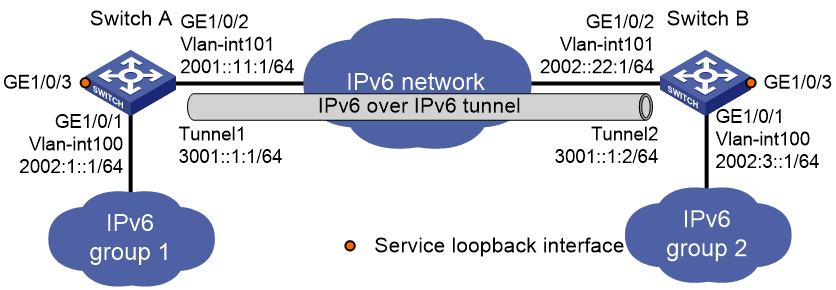

IPv6 over IPv6 tunneling (RFC 2473) enables isolated IPv6 networks to communicate with each other over another IPv6 network. For example, two isolated IPv6 networks that do not want to show their addresses to the Internet can use an IPv6 over IPv6 tunnel to communicate with each other.
Figure 1 Principle of IPv6 over IPv6 tunneling
Figure 1 shows the encapsulation and de-encapsulation processes.

As shown in Figure 2, configure an IPv6 over IPv6 tunnel between Switch A and Switch B so the two networks can reach each other without disclosing their IPv6 addresses.
Figure 2 Network diagram
Make sure Switch A and Switch B have the corresponding VLAN interfaces created and can reach each other through IPv6.
