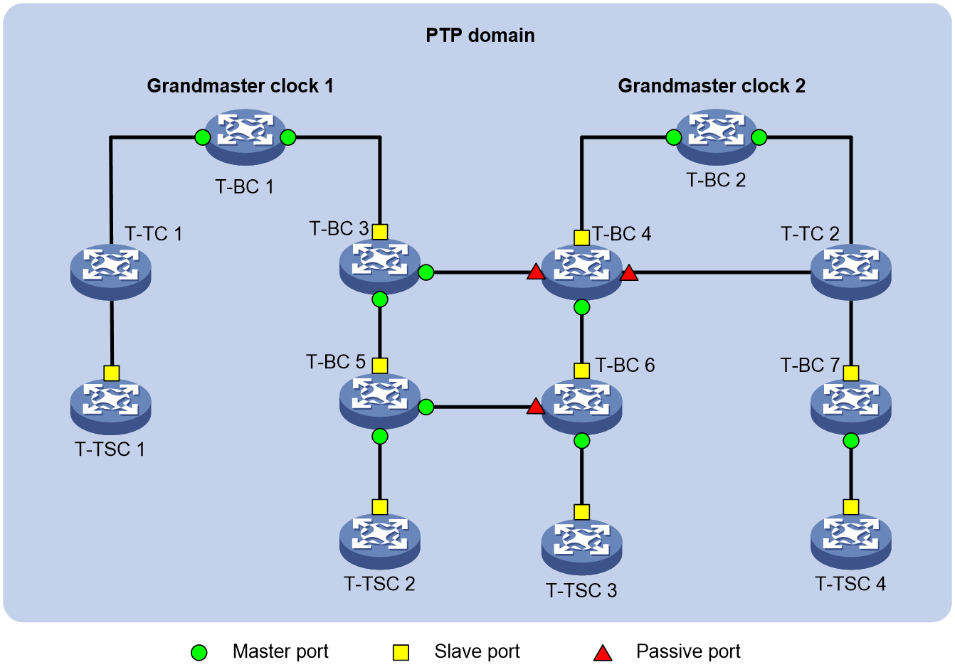

Clock node and PTP port (ITU-T G.8275.1)
A node in a PTP domain is a clock node. A port enabled with PTP is a PTP port.
ITU-T G.8275.1 defines the following types of basic clock nodes:
·     Telecom boundary clock (T-BC)—A clock node with more than one PTP port in a PTP domain for time synchronization. It uses one of the ports to synchronize time to its upstream clock node and uses the other ports to distribute time to the downstream clock nodes. If a T-BC operates as the clock source, it distributes time through multiple PTP ports to its downstream clock nodes.
·     Telecom transparent Clock (T-TC)—A clock code that forwards non-P2P PTP messages in the network. The forwarding duration will be included in calculation of the entire link delay.
·     Telecom time slave clock (T-TSC) —An OC clock node (as defined in IEEE 1588 version 2 and IEEE 802.1AS) that can act only as a member clock.
Figure 1 shows the positions of these basic clock nodes in a PTP domain.
Figure 2 Clock nodes and PTP ports in a PTP domain (ITU-T G.8275.1)

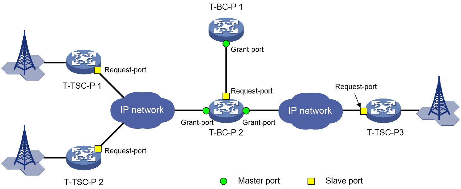

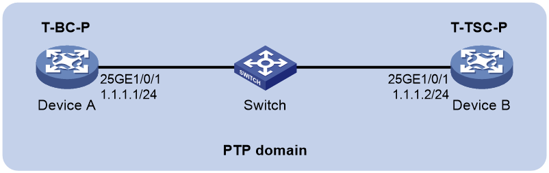

Clock nodes and PTP ports (ITU-T G.8275.2)
ITU-T G.8275.2 defines the following types of basic clock nodes:
·     Partial-support telecom boundary clock (T-BC-P)—A clock node with more than one PTP port in a PTP domain for time synchronization. It uses one of the ports to synchronize time to its upstream clock node and uses the other ports to distribute time to the downstream clock nodes. When a T-BC-P clock node is a clock source, it distributes time through multiple PTP ports to its downstream clock nodes.
·     Partial-support telecom time slave clock (T-TSC-P)—A clock node with a single PTP port in a PTP domain for time synchronization. It synchronizes time from its upstream clock node through the port. It can operate only as a member clock.
Figure 3 shows the positions of these basic clock nodes in a PTP domain.
Figure 3 Clock nodes and PTP ports in a PTP domain (ITU-T G.8275.2)

ITU-T G.8275.1
A GM can be manually specified. It can also be automatically elected through the BMC algorithm as follows:
1.     The clock nodes in a PTP domain exchange announce messages and elect a GM by using the following rules in descending order of precedence:
a.     Clock node with higher time class.
b.     Clock node with higher time accuracy.
c.     Clock node with higher priority 2.
d.     Clock node with higher local priority.
You can use the ptp priority clock-source command to set the local priority for the local node.
To set a local priority for the peer node, use the ptp local-priority command to set a local priority for the PTP interface connected to the peer node. This priority will be used as the local priority of the peer node.
e.     Whether the time class values of the clock nodes are smaller than or equal to 127.
-     If the time class values of the clock nodes are smaller than or equal to 127, two or more clock nodes are elected GMs in the PTP domain. A member node selects the GM nearer to it as its master node. Two or more spanning trees are generated. No PTP messages are exchanged between the trees.
-     If the time class values of the clock nodes are greater than 127, the clock node with a smaller port ID (containing clock number and port number) will be the GM.
The master nodes, member nodes, master ports, and subordinate ports are determined during the process.
2.     The master node periodically sends announce messages to the member nodes. If the member nodes do not receive announce messages from the master node, they determine that the master node is invalid, and they start to elect another GM.

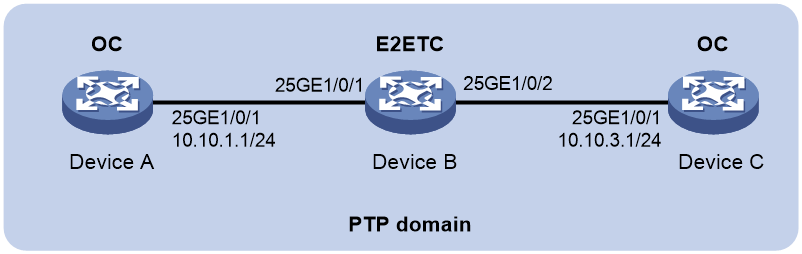

PTP configuration examples
Example: Configuring PTP (IEEE 1588 version 2, IEEE 802.3/Ethernet transport, multicast transmission)
As shown in Figure 6, a PTP domain contains Device A, Device B, and Device C.
·     Configure all devices to use the IEEE 1588 version 2 PTP profile.
·     Configure PTP messages to be encapsulated in IEEE 802.3/Ethernet packets.
·     Specify the OC clock node type for Device A and Device C, and E2ETC clock node type for Device B. All clock nodes elect a GM through BMC based on their respective default GM attributes.
·     Use the default Request_Response delay measurement mechanism on Device A and Device C.
Figure 6 Network diagram
1.     Configure Device A:
# Specify the IEEE 1588 version 2 PTP profile.
<DeviceA> system-view
[DeviceA] ptp profile 1588v2
# Specify the OC clock node type.
[DeviceA] ptp mode oc
# Create a PTP domain.
[DeviceA] ptp domain 0
# Specify PTP for obtaining the time.
[DeviceA] clock protocol ptp
# Enable PTP on Twenty-FiveGigE 1/0/1.
[DeviceA] interface twenty-fivegige 1/0/1
[DeviceA-Twenty-FiveGigE1/0/1] ptp enable
[DeviceA-Twenty-FiveGigE1/0/1] quit
2.     Configure Device B:
<DeviceB> system-view
[DeviceB] ptp profile 1588v2
# Specify the E2ETC clock node type.
[DeviceB] ptp mode e2etc
[DeviceB] ptp domain 0
[DeviceB] clock protocol ptp
[DeviceB] interface twenty-fivegige 1/0/1
[DeviceB-Twenty-FiveGigE1/0/1] ptp enable
[DeviceB-Twenty-FiveGigE1/0/1] quit
# Enable PTP on Twenty-FiveGigE 1/0/2.
[DeviceB] interface twenty-fivegige 1/0/2
[DeviceB-Twenty-FiveGigE1/0/2] ptp enable
[DeviceB-Twenty-FiveGigE1/0/2] quit
3.     Configure Device C:
<DeviceC> system-view
[DeviceC] ptp profile 1588v2
[DeviceC] ptp mode oc
[DeviceC] ptp domain 0
[DeviceC] clock protocol ptp
[DeviceC] interface twenty-fivegige 1/0/1
[DeviceC-Twenty-FiveGigE1/0/1] ptp enable
[DeviceC-Twenty-FiveGigE1/0/1] quit
When the network is stable, perform the following tasks to verify that Device A is elected as the GM, Twenty-FiveGigE1/0/1 on Device A is the master port, and Device B has synchronized to Device A:
·     Use the display ptp clock command to display PTP clock information.
·     Use the display ptp interface brief command to display brief PTP running information for all PTP interfaces.
# Display PTP clock information on Device A.

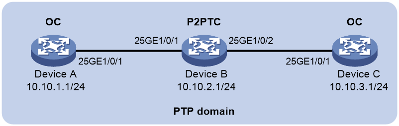

Example: Configuring PTP (IEEE 1588 version 2, IPv4 UDP transport, multicast transmission)
As shown in Figure 7, a PTP domain contains Device A, Device B, and Device C.
·     Configure the source IP address for multicast PTP messages transmitted over IPv4 UDP.
·     Specify the OC clock node type for Device A and Device C, and the P2PTC clock node type for Device B. All clock nodes elect a GM through BMC based on their respective default GM attributes.
·     Configure the peer delay measurement mechanism (p2p) for Device A and Device C.
Figure 7 Network diagram
# Configure the source IP address for multicast PTP messages transmitted over IPv4 UDP.
[DeviceA] ptp source 10.10.1.1
# On Twenty-FiveGigE 1/0/1, specify the IPv4 UDP transport protocol for PTP messages, specify the delay measurement mechanism as p2p, and enable PTP.
[DeviceA-Twenty-FiveGigE1/0/1] ptp transport-protocol udp [DeviceA-Twenty-FiveGigE1/0/1] ptp delay-mechanism p2p
# Specify the P2PTC clock node type.
[DeviceB] ptp mode p2ptc
# Configure the source IP address for multicast PTP messages transmitted over UDP.
[DeviceB] ptp source 10.10.2.1
# On Twenty-FiveGigE 1/0/1, specify the IPv4 UDP transport protocol for PTP messages and enable PTP.
DeviceB-Twenty-FiveGigE1/0/1] ptp transport-protocol udp
# On Twenty-FiveGigE 1/0/2, specify the IPv4 UDP transport protocol for PTP messages and enable PTP.
[DeviceB-Twenty-FiveGigE1/0/2] ptp transport-protocol udp
[DeviceC] ptp source 10.10.3.1
[DeviceC-Twenty-FiveGigE1/0/1] ptp transport-protocol udp [DeviceC-Twenty-FiveGigE1/0/1] ptp delay-mechanism p2p

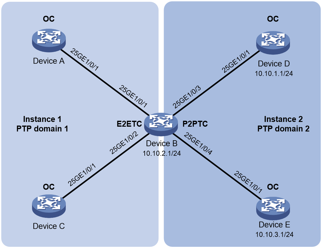

Example: Configuring multiple PTP instances (IEEE 1588 version 2, multicast transmission)
As shown in Figure 8, configure two PTP instances on a PTP network.
·     PTP instance 1: Assign Device A, Device B, and Device C to PTP instance 1.
¡     Specify the IEEE 1588 version 2 PTP profile and IEEE 802.3/Ethernet transport of PTP messages for the devices and assign the devices to PTP domain 1.
¡     Specify the OC clock node type for Device A and Device C and E2ETC clock node type for Device B. All these clock nodes elect a GM through BMC.
¡     Use the default Request_Response delay measurement mechanism on all clock nodes in PTP instance 1.
·     PTP instance 2: Assign Device D, Device B, and Device E to PTP instance 2.
¡     Specify the IEEE 1588 version 2 PTP profile and IPv4 UDP transport of PTP messages for the devices and assign the devices to PTP domain 2.
¡     Specify the OC clock node type for Device D and Device E and P2PTC clock node type for Device B. All the clock nodes elect a GM through BMC.
¡     Use the peer delay measurement mechanism on Device D and Device E.
Figure 8 Network diagram

2.     Verify the configuration of PTP instance 2.
When the network is stable, perform the following tasks to verify the configuration of PTP instance 2:
¡     Use the display ptp clock command to display PTP clock information.
¡     Use the display ptp interface brief command to display brief PTP running information for all PTP interfaces.
# Display PTP clock information for PTP instance 2 on Device D.
[DeviceD] display ptp clock instance 2
PTP global state    : Enabled
PTP profile         : IEEE 1588 Version 2
PTP mode            : OC
Slave only          : No
Sync uncertain      : Disabled
Clock state         : Disabled
Clock ID            : 000FE2-FFFE-FF0000
Clock type          : Local
Clock domain        : 2
Number of PTP ports : 1
Priority1     : 128
Priority2     : 128
Clock quality :
 Class                 : 248
 Accuracy              : 254
 Offset (log variance) : 65535
Offset from master : 0 (ns)
Mean path delay    : 0 (ns)
Steps removed      : 0
Local clock time   : Tue Jul 23 09:41:50 2019
Clock source info:
 Clock   Pri1 Pri2 Accuracy Class TimeSrc Direction In-Status Offset(log variance)
 Local   128  128  254      248   160     N/A       N/A       65535
 ToD0    128  128  32       6     32      N/A       Inactive  65535
 ToD1    128  128  32       6     32      N/A       Inactive  65535
# Display brief PTP running information for all PTP interfaces on Device D.
[DeviceD] display ptp interface brief
InstID     State         Delay mechanism  Clock step  Asymmetry correction  Name
2          Master        P2P              Two         0                     25GE1/0/1
# Display PTP clock information for PTP instance 2 on Device B.
[DeviceB] display ptp clock instance 2
PTP mode            : P2PTC
Slave only          : No
Clock ID            : 000FE2-FFFE-FF0001
Clock type          : Local
Clock domain        : 2
Number of PTP ports : 2
Priority1     : 128
Priority2     : 128
Clock quality :
 Class                 : 248
 Accuracy              : 254
Offset from master : N/A
Mean path delay    : N/A
Steps removed      : N/A
Clock source info:
# Display brief PTP running information for all PTP interfaces on Device B.
[DeviceB] display ptp interface brief
1          N/A           E2E              Two         0                     25GE1/0/1
1          N/A           E2E              Two         0                     25GE1/0/2
2          N/A           P2P              Two         0                     25GE1/0/3
2          N/A           P2P              Two         0                     25GE1/0/4
The command output shows that Device D is elected as the GM, and Twenty-FiveGigE1/0/1 on Device D sends time synchronization information to its downstreams as a master port.

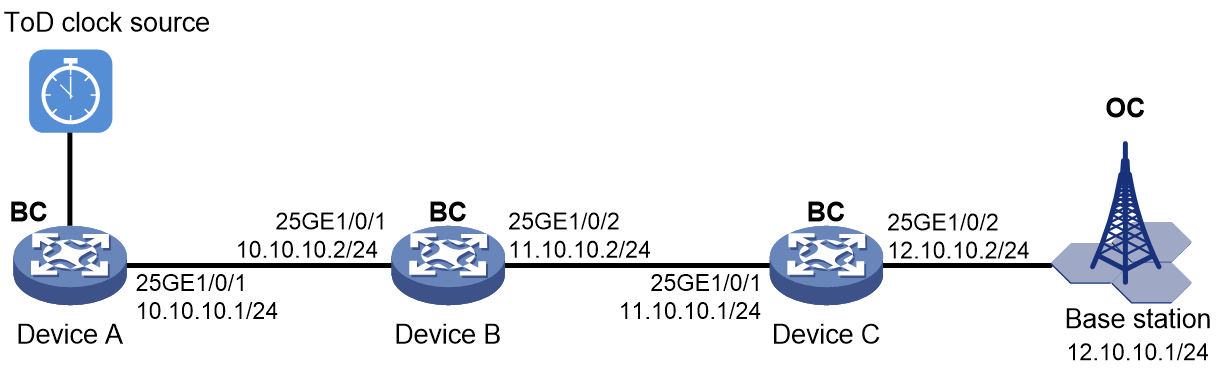

Example: Configuring PTP (IEEE 1588 version 2, IPv4 UDP transport, unicast transmission)
As shown in Figure 9, configure PTP (IEEE 1588 version 2, IPv4 UDP transport, unicast transmission) to enable Device A, Device B, Device C, and the base station to synchronize the time with the ToD clock source.
·     Specify the IEEE 1588 version 2 PTP profile and unicast IPv4 UDP transport of PTP messages for Device A, Device B, and Device C.
·     Assign Device A, Device B, Device C, and the base station to PTP domain 0. Specify the BC clock node type for Device A, Device B, and Device C.
·     Connect Device A to the ToD clock source and Device C to the base station.
·     Use the default Request_Response delay measurement mechanism on all clock nodes in the PTP domain.
Figure 9 Network diagram
1.     Assign IP addresses to the interfaces, and make sure the devices can reach each other, as shown in Figure 9. (Details not shown.)
2.     Configure Device A:
# Specify the BC clock node type.
[DeviceA] ptp mode bc
# Configure the delay time correction as 1000 nanoseconds for receiving ToD 0 clock signals.
[DeviceA] ptp tod0 input delay 1000
# Set priority 1 to 0 for the ToD 0 clock.
[DeviceA] ptp priority clock-source tod0 priority1 0
# On Twenty-FiveGigE 1/0/1, configure the destination IP address for unicast PTP messages transmitted over IPv4 UDP, and enable PTP.
[DeviceA-Twenty-FiveGigE1/0/1] ptp unicast-destination 10.10.10.2
3.     Configure Device B:
[DeviceB] ptp mode bc
[DeviceB-Twenty-FiveGigE1/0/1] ptp transport-protocol udp
[DeviceB-Twenty-FiveGigE1/0/1] ptp unicast-destination 10.10.10.1
# On Twenty-FiveGigE 1/0/2, configure the destination IP address for unicast PTP messages transmitted over IPv4 UDP, and enable PTP.
[DeviceB-Twenty-FiveGigE1/0/2] ptp unicast-destination 11.10.10.1
4.     Configure Device C:
[DeviceC] ptp mode bc
# Configure the delay time correction as 100 nanoseconds for sending ToD 0 clock signals.
[DeviceC] ptp tod0 output delay 100
[DeviceC-Twenty-FiveGigE1/0/1] ptp unicast-destination 11.10.10.2
# On Twenty-FiveGigE1/0/2, specify IPv4 UDP transport of PTP messages, configure the destination IP address for unicast PTP messages, and enable PTP.
[DeviceC] interface twenty-fivegige 1/0/2
[DeviceC-Twenty-FiveGigE1/0/2] ptp transport-protocol udp
[DeviceC-Twenty-FiveGigE1/0/2] ptp unicast-destination 12.10.10.1
[DeviceC-Twenty-FiveGigE1/0/2] ptp enable
[DeviceC-Twenty-FiveGigE1/0/2] quit
5.     Configure the base station.
# Specify PTP domain 0.
# Specify IPv4 UDP transport of PTP messages.
# Set the destination IP address of unicast PTP messages to 12.10.10.2.
# Specify the Request_Response delay measurement mechanism.
For more information, see the configuration guide for the base station.

Example: Configuring PTP (IEEE 802.1AS, IEEE 802.3/Ethernet transport, multicast transmission)
As shown in Figure 10, a PTP domain contains Device A, Device B, and Device C.
·     Configure all devices to use the IEEE 802.1AS PTP profile.
·     Use the default peer delay measurement mechanism on all clock nodes in the PTP domain.
Figure 10 Network diagram
IMPORTANT
IMPORTANT:
The IEEE 802.1AS PTP profile transports PTP messages over IEEE 802.3/Ethernet rather than IPv4 UDP and in multicast rather than unicast mode.
# Specify the IEEE 802.1AS PTP profile.
[DeviceA] ptp profile 802.1AS
[DeviceB] ptp profile 802.1AS
# Specify the IEEE 1588 802.1AS PTP profile.
[DeviceC] ptp profile 802.1AS

Example: Configuring PTP (SMPTE ST 2059-2, IPv4 UDP transport, multicast transmission)
As shown in Figure 11, Device A, Device B, and Device C are in a PTP domain. Configure PTP (SMPTE ST 2059-2, multicast transmission) on the three devices as follows for time synchronization:
·     Configure the devices to use the SMPTE ST 2059-2 PTP profile.
·     Use the peer delay measurement mechanism on all clock nodes in the PTP domain.
Figure 11 Network diagram
IMPORTANT
IMPORTANT:
The SMPTE ST 2059-2 PTP profile transports PTP messages over IPv4 UDP rather than IEEE 802.3/Ethernet and in multicast rather than unicast mode.
# Specify the SMPTE ST 2059-2 PTP profile.
[DeviceA] ptp profile st2059-2
# On Twenty-FiveGigE 1/0/1, specify the delay measurement mechanism as p2p and enable PTP.
[DeviceB] ptp profile st2059-2
# On Twenty-FiveGigE 1/0/1, enable PTP.
# On Twenty-FiveGigE 1/0/2, enable PTP.
[DeviceC] ptp profile st2059-2
When the network is stable, perform the following tasks to verify the PTP configuration:
[DeviceA] display ptp clock
PTP profile         : SMPTE ST 2059-2
PTP mode            : OC
Slave only          : No
Clock type          : Local
Clock domain        : 0
Priority1     : 128
Priority2     : 128
Clock quality :
 Class                 : 248
 Accuracy              : 254
Offset from master  : 106368539000 (ns)
Mean path delay     : 2791000 (ns)
Steps removed       : 1
Local clock time    : Sun Jan 15 20:57:29 2019
Clock source info:
# Display brief PTP running information for all PTP interfaces on Device A.
[DeviceA] display ptp interface brief
0          Master        P2P              Two         0                     25GE1/0/1
# Display PTP clock information on Device B.
PTP mode            : P2PTC
Slave only          : No
Clock type          : Local
Clock domain        : 0
Priority1     : 128
Priority2     : 128
Clock quality :
 Class                 : 248
 Accuracy              : 254
Steps removed       : N/A
Clock source info:
0          N/A           P2P              Two         0                     25GE1/0/1
0          N/A           P2P              Two         0                     25GE1/0/2
The output shows that Device A is elected as the GM and Twenty-FiveGigE1/0/1 on Device A is the master port.
Example: Configuring PTP (SMPTE ST 2059-2, IPv4 UDP transport, unicast transmission)
As shown in Figure 12, configure PTP (SMPTE ST 2059-2, IPv4 UDP transport, unicast transmission) to enable Device A, Device B, Device C, and the base station to synchronize time with the ToD clock source .
·     Specify the SMPTE ST 2059-2 PTP profile and unicast IPv4 UDP transport of PTP messages for Device A, Device B, and Device C.
Figure 12 Network diagram
IMPORTANT
IMPORTANT:
1.     Assign IP addresses to the interfaces, and make sure the devices can reach each other, as shown in Figure 12. (Details not shown.)
# Configure the device to receive ToD 0 clock signals and set the delay correction value to 1000 nanoseconds.
# On Twenty-FiveGigE 1/0/1, configure the destination IP address for unicast PTP messages and enable PTP. (The SMPTE ST 2059-2 PTP profile uses IPv4 UDP transport of PTP messages by default.)
# On Twenty-FiveGigE 1/0/2, configure the destination IP address for unicast PTP messages and enable PTP. (The SMPTE ST 2059-2 PTP profile uses IPv4 UDP transport of PTP messages by default.)
# On Twenty-FiveGigE1/0/2, configure the destination IP address for unicast PTP messages and enable PTP. (The SMPTE ST 2059-2 PTP profile uses IPv4 UDP transport of PTP messages by default.)

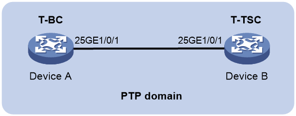

Example: Configuring PTP (ITU-T G.8275.1, IEEE 802.3/Ethernet encapsulation, multicast transmission)
As shown in Figure 10, Device A and Device B are in a PTP domain.
·     Specify the ITU-T G.8275.1 PTP profile for Device A and Device B.
·     Specify the T-BC clock node type for Device A and T-TSC clock node type for Device B.
·     Use the default Request_Response delay measurement mechanism on Device A and Device B.
Figure 13 Network diagram
IMPORTANT
IMPORTANT:
The ITU-T G.8275.1 PTP profile transports PTP messages over IEEE 802.3/Ethernet rather than IPv4 UDP and in multicast rather than unicast mode.
# Specify the ITU-T G.8275.1 PTP profile.
[DeviceA] ptp profile g8275.1
# Specify the T-BC clock node type.
[DeviceA] ptp mode t-bc
# Specify a PTP domain.
[DeviceA] ptp domain 24
[DeviceB] ptp profile g8275.1
# Specify the T-TSC clock node type.
[DeviceB] ptp mode t-tsc
[DeviceB] ptp domain 24
When the network is stable, perform the following tasks:
·     Use the display ptp interface brief command to display brief PTP running information for all interfaces.
PTP profile         : ITU-T G.8275.1
PTP mode            : T-BC
Slave only          : No
Clock ID            : 24881D-FFFE-F20100
Clock type          : Local
Clock domain        : 24
Priority1      : 128
Priority2      : 128
Local priority : 128
Clock quality :
 Class                 : 248
 Accuracy              : 254
Steps removed       : 0
Local clock time    : Fri Dec 7 00:59:44 2019
Clock source info:
 Clock   LP   Pri2 Accuracy Class TimeSrc Direction In-Status Offset(log variance)
 ToD0    128  128  32       6     32      In        Inactive  65535
# Display brief PTP running information for all interfaces on Device A.
0          Master        E2E              Two         0                     25GE1/0/1
PTP mode            : T-TSC
Slave only          : No
Clock ID            : 2461E3-FFFE-A20200
Clock type          : Local
Clock domain        : 24
Priority1      : 128
Priority2      : 255
Clock quality :
 Class                 : 255
 Accuracy              : 254
Offset from master  : 50 (ns)
Mean path delay     : 5000 (ns)
Steps removed       : 1
Local clock time    : Fri Dec 7 14:52:54 2019
Clock source info:
 Local   128  255  254      255   160     N/A       N/A       65535
 ToD0    128  255  254      255   32      In        Inactive  65535
 ToD1    128  255  254      255   32      N/A       Inactive  65535
# Display brief PTP running information for all interfaces on Device B.
0          Slave         E2E              Two         0                     25GE1/0/1
The output shows that Device A is elected as the GM, and Twenty-FiveGigE1/0/1 on Device A is the master port.
Example: Configuring PTP (ITU-T G.8275.2, IPv4 UDP encapsulation, unicast transmission)
As shown in Figure 14, Device A and Device B are in a PTP domain. The switch is a Layer 2 switch that does not support PTP. Configure PTP (ITU-T G.8275.2, IPv4 UDP encapsulation, unicast transmission) to enable Device B to synchronize with Device A.
·     Specify the ITU-T G.8275.2 PTP profile for Device A and Device B.
Figure 14 Network diagram
Configure IP addresses and routing protocols for the devices. Make sure the devices are reachable to each other.
IMPORTANT
IMPORTANT:
The ITU-T G.8275.2 PTP profile transports PTP messages over IPv4 UDP rather than IEEE 802.3/Ethernet and in unicast rather than multicast mode.
1.     Configure IP address and routing settings. Make sure the devices are reachable to each other.
# Specify the ITU-T G.8275.2 PTP profile.
[DeviceA] ptp profile g8275.2
# Specify the T-BC-P clock node type.
[DeviceA] ptp mode t-bc-p
[DeviceA] ptp domain 44
# Enable PTP and configure PTP parameters on Twenty-FiveGigE1/0/1.
[DeviceA-Twenty-FiveGigE1/0/1] ptp unicast-destination 1.1.1.2
[DeviceA-Twenty-FiveGigE1/0/1] ptp unicast-negotiate grant-port
[DeviceA-Twenty-FiveGigE1/0/1] ptp notslave disable
[DeviceB] ptp profile g8275.2
# Specify the T-TSC-P clock node type.
[DeviceB] ptp mode t-tsc-p
[DeviceB] ptp domain 44
# Enable PTP on Twenty-FiveGigE1/0/1.
[DeviceB-Twenty-FiveGigE1/0/1] ptp unicast-destination 1.1.1.1
[DeviceB-Twenty-FiveGigE1/0/1] ptp unicast-negotiate request-port
PTP profile         : ITU-T G.8275.2
PTP mode            : T-BC-P
Slave only          : No
Clock ID            : 140570-FFFE-930100
Clock type          : Local
Clock domain        : 44
Priority1      : 128
Priority2      : 128
Clock quality :
 Class                 : 248
 Accuracy              : 254
Steps removed       : 0
Local clock time    : Sat May 9 10:38:42 2020
Clock source info:
# Display brief PTP running information on Device A.
PTP mode            : T-TSC-P
Slave only          : No
Clock ID            : 147405-FFFE-E30200
Clock type          : Local
Clock domain        : 44
Priority1      : 128
Priority2      : 255
Clock quality :
 Class                 : 255
 Accuracy              : 254
Mean path delay     : 2169 (ns)
Steps removed       : 1
Local clock time    : Sat May 9 10:40:04 2020
Clock source info:
 ToD0    128  255  254      255   32      N/A       Inactive  65535
# Display brief PTP running information on Device B.
The output shows that Device A has been elected as the GM, and Twenty-FiveGigE1/0/1 on Device A is the master port.
