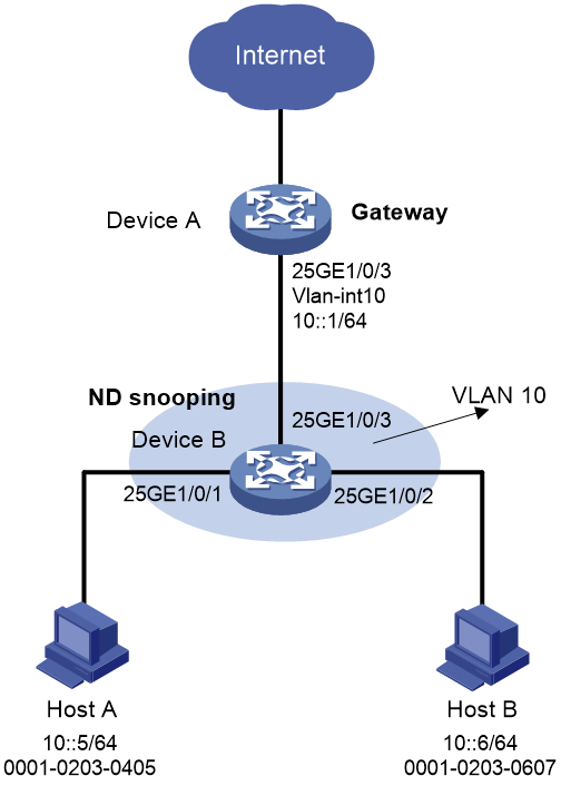

About ND attack defense
IPv6 Neighbor Discovery (ND) attack defense is able to identify forged ND messages to prevent ND attacks.
The IPv6 ND protocol does not provide any security mechanisms and is vulnerable to network attacks. As shown in Figure 1, an attacker can send the following forged ICMPv6 messages to perform ND attacks:
·     Forged NS/NA/RS messages with an IPv6 address of a victim host. The gateway and other hosts update the ND entry for the victim with incorrect address information. As a result, all packets intended for the victim are sent to the attacking terminal.
·     Forged RA messages with the IPv6 address of a victim gateway. As a result, all hosts attached to the victim gateway maintain incorrect IPv6 configuration parameters and ND entries.
Figure 1 ND attack diagram

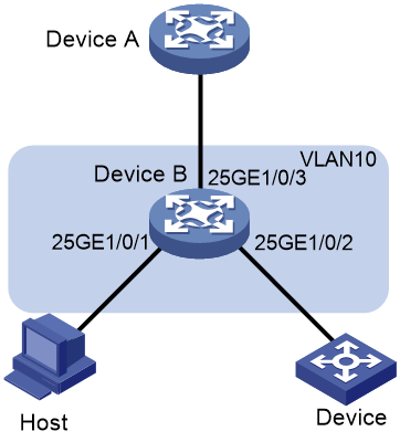

Example: Configuring ND attack detection
As shown in Figure 2, configure ND attack detection on Device B to check user validity for ND messages from Host A and Host B.
Figure 2 Network diagram
1.     Configure Device A:
# Create VLAN 10.
<DeviceA> system-view
[DeviceA] vlan 10
[DeviceA-vlan10] quit
# Configure Twenty-FiveGigE 1/0/3 to trunk VLAN 10.
[DeviceA] interface twenty-fivegige 1/0/3
[DeviceA-Twenty-FiveGigE1/0/3] port link-type trunk
[DeviceA-Twenty-FiveGigE1/0/3] port trunk permit vlan 10
[DeviceA-Twenty-FiveGigE1/0/3] quit
# Assign IPv6 address 10::1/64 to VLAN-interface 10.
[DeviceA] interface vlan-interface 10
[DeviceA-Vlan-interface10] ipv6 address 10::1/64
[DeviceA-Vlan-interface10] quit
2.     Configure Device B:
# Create VLAN 10.
<DeviceB> system-view
[DeviceB] vlan 10
[DeviceB-vlan10] quit
# Configure Twenty-FiveGigE 1/0/1, Twenty-FiveGigE 1/0/2, and Twenty-FiveGigE 1/0/3 to trunk VLAN 10.
[DeviceB] interface twenty-fivegige 1/0/1
[DeviceB-Twenty-FiveGigE1/0/1] port link-type access
[DeviceB-Twenty-FiveGigE1/0/1] port access vlan 10
[DeviceB-Twenty-FiveGigE1/0/1] quit
[DeviceB] interface twenty-fivegige 1/0/2
[DeviceB-Twenty-FiveGigE1/0/2] port link-type access
[DeviceB-Twenty-FiveGigE1/0/2] port access vlan 10
[DeviceB-Twenty-FiveGigE1/0/2] quit
[DeviceB] interface twenty-fivegige 1/0/3
[DeviceB-Twenty-FiveGigE1/0/3] port link-type trunk
[DeviceB-Twenty-FiveGigE1/0/3] port trunk permit vlan 10
[DeviceB-Twenty-FiveGigE1/0/3] quit
# Enable ND attack detection for VLAN 10.
[DeviceB] vlan 10
[DeviceB-vlan10] ipv6 nd detection enable
# Enable ND snooping for IPv6 global unicast addresses and ND snooping for IPv6 link-local addresses in VLAN 10.
[DeviceB-vlan10] ipv6 nd snooping enable global
[DeviceB-vlan10] ipv6 nd snooping enable link-local
# Configure Twenty-FiveGigE 1/0/3 as ND trusted interface.
[DeviceB-Twenty-FiveGigE1/0/3] ipv6 nd detection trust
Verify that Device B inspects all ND messages received by Twenty-FiveGigE 1/0/1 and Twenty-FiveGigE 1/0/2 based on the ND snooping entries. (Details not shown.)

Example: Configuring RA guard
As shown in Figure 3, Twenty-FiveGigE 1/0/1, Twenty-FiveGigE 1/0/2, and Twenty-FiveGigE 1/0/3 of Device B are in VLAN 10.
Configure RA guard on Device B to filter forged and unwanted RA messages.
·     Configure an RA policy in VLAN 10 for Twenty-FiveGigE 1/0/2 to filter all RA messages received from the unknown device.
·     Specify host as the role of the host. All RA messages received on Twenty-FiveGigE 1/0/1 are dropped.
·     Specify router as the role of the Device A. All RA messages received on Twenty-FiveGigE 1/0/3 are forwarded.
Figure 3 Network diagram
# Create an RA guard policy named policy1.
[DeviceB] ipv6 nd raguard policy policy1
# Set the maximum router preference to high for the RA guard policy.
[DeviceB-raguard-policy-policy1] if-match router-preference maximum high
# Specify on as the M flag match criterion for the RA guard policy.
[DeviceB-raguard-policy-policy1] if-match autoconfig managed-address-flag on
# Specify on as the O flag match criterion for the RA guard policy.
[DeviceB-raguard-policy-policy1] if-match autoconfig other-flag on
# Set the maximum advertised hop limit to 120 for the RA guard policy.
[DeviceB-raguard-policy-policy1] if-match hop-limit maximum 120
# Set the minimum advertised hop limit to 100 for the RA guard policy.
[DeviceB-raguard-policy-policy1] if-match hop-limit minimum 100
[DeviceB-raguard-policy-policy1] quit
# Assign Twenty-FiveGigE 1/0/1 and Twenty-FiveGigE 1/0/2 to VLAN 10.
# Apply the RA guard policy policy1 to VLAN 10.
[DeviceB] vlan 10
[DeviceB-vlan10] ipv6 nd raguard apply policy policy1
# Specify host as the role of the device attached to Twenty-FiveGigE 1/0/1.
[DeviceB-Twenty-FiveGigE1/0/1] ipv6 nd raguard role host
# Specify router as the role of the device attached to Twenty-FiveGigE 1/0/3.
[DeviceB-Twenty-FiveGigE1/0/3] ipv6 nd raguard role router
# Verify that the device forwards or drops RA messages received on Twenty-FiveGigE 1/0/2 based on the RA guard policy. (Details not shown.)
# Verify that the device drops RA messages received on Twenty-FiveGigE 1/0/1. (Details not shown.)
# Verify that the device forwards RA messages received on Twenty-FiveGigE 1/0/3 to other interfaces in VLAN 10. (Details not shown.)
