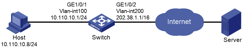

Basic NAT operating mechanism
Figure 1 shows the basic NAT operating mechanism.
1.     Upon receiving a request from the host to the server, NAT translates the private source address 192.168.1.3 to the public address 20.1.1.1 and forwards the NATed packet. NAT adds a mapping for the two addresses to its NAT table.
2.     Upon receiving a response from the server, NAT translates the destination public address to the private address, and forwards the packet to the host.
The NAT operation is transparent to the terminals (the host and the server). NAT hides the private network from the external users and shows that the IP address of the internal host is 20.1.1.1.

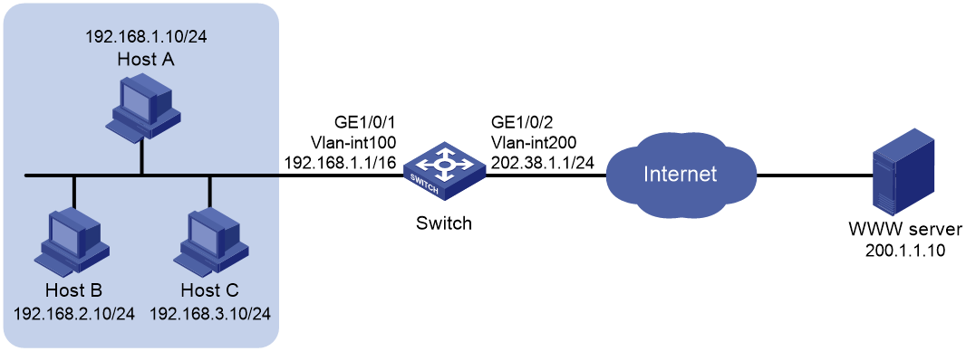

PAT
Port Address Translation (PAT) translates multiple private IP addresses to a single public IP address by mapping the private IP address and source port to the public IP address and a unique port. PAT supports TCP and UDP packets.
Figure 2 PAT operation
As shown in Figure 2, PAT translates the source IP addresses of the three packets to the same IP public address and translates their port numbers to different port numbers. Upon receiving a response, PAT translates the destination address and port number of the response, and forwards it to the target host.

Example: Configuring outbound one-to-one static NAT
Configure static NAT to allow the host at 10.110.10.8/24 to access the Internet.
Figure 3 Network diagram
# Specify IP addresses for the interfaces on the switch. (Details not shown.)
# Configure a one-to-one static NAT mapping between the private address 10.110.10.8 and the public address 202.38.1.100.
<Switch> system-view
[Switch] nat static outbound 10.110.10.8 202.38.1.100
# Enable static NAT on Vlan-interface 200.
[Switch] interface vlan-interface 200
[Switch-Vlan-interface200] nat static enable
[Switch-Vlan-interface200] quit
# Configure ACL 2000 to identify packets from subnet 10.110.10.0/24 to pass through.
[Switch] acl basic 2000
[Switch-acl-ipv4-basic-2000] rule permit source 10.110.10.0 0.0.0.255
[Switch-acl-ipv4-basic-2000] quit
# Configure traffic class nat to match advanced ACL 2000.
[Switch] traffic classifier nat
[Switch-classifier-nat] if-match acl 2000
[Switch-classifier-nat] quit
# Configure traffic behavior nat to redirect packets matching ACL 2000 to the CPU.
[Switch] traffic behavior nat
[Switch-behavior-nat] redirect cpu
[Switch-behavior-nat] quit
# Configure a QoS policy and associate the traffic class with the traffic behavior.
[Switch] qos policy p1
[Switch-qospolicy-p1] classifier nat behavior nat
[Switch-qospolicy-p1] quit
# Apply the QoS policy to the inbound traffic on GigabitEthernet 1/0/1.
[Switch] interface gigabitethernet 1/0/1
[Switch-GigabitEthernet1/0/1] qos apply policy p1 inbound
[Switch-GigabitEthernet1/0/1] quit
# Verify that the host at 10.110.10.8/24 can access the server on the Internet. (Details not shown.)
# Display static NAT configuration.
[Switch] display nat static
Static NAT mappings:
  Totally 1 outbound static NAT mappings.
  IP-to-IP:
    Local IP     : 10.110.10.8
    Global IP    : 202.38.1.100
    Config status: Active
Interfaces enabled with static NAT:
  Totally 1 interfaces enabled with static NAT.
  Interface: Vlan-interface200
# Display NAT session information.
[Switch] display nat session verbose
Initiator:
  Source      IP/port: 10.110.10.8/42496
  Destination IP/port: 202.38.1.111/2048
  DS-Lite tunnel peer: -
  VPN instance/VLAN ID/VLL ID: -/-/-
  Protocol: UDP(17)
  Inbound interface: Vlan-interface100
Responder:
  Source      IP/port: 202.38.1.111/42496
  Destination IP/port: 202.38.1.100/0
  Protocol: UDP(17)
  Inbound interface: Vlan-interface200
State: UDP_REPLY
Application: GENERAL_UDP
Start time: 2023-06-29 10:06:55  TTL: 27s
Initiator->Responder:            5 packets        420 bytes
Responder->Initiator:            5 packets        420 bytes
Total sessions found: 1
Example: Configuring outbound dynamic NAT
As shown in Figure 4, a company has a private address 192.168.0.0/16 and two public IP addresses 202.38.1.2 and 202.38.1.3. Configure outbound dynamic NAT to allow only internal users on subnet 192.168.1.0/24 to access the Internet.
Figure 4 Network diagram
# Configure address group 0 and add an address range from 202.38.1.2 to 202.38.1.3.
[Switch] nat address-group 0
[Switch-address-group-0] address 202.38.1.2 202.38.1.3
[Switch-address-group-0] quit
# Configure ACL 2000 to identify packets from subnet 192.168.1.0/24.
[Switch-acl-ipv4-basic-2000] rule permit source 192.168.1.0 0.0.0.255
# Enable outbound dynamic PAT on Vlan-interface 200. The source IP addresses of the packets permitted by ACL 2000 are translated into the addresses in address group 0.
[Switch-Vlan-interface200] nat outbound 2000 address-group 0
# Verify that Host A can access the WWW server, but Host B and Host C cannot. (Details not shown.)
# Display all NAT configuration information.
[Switch] display nat all
NAT address group information:
  Totally 1 NAT address groups.
  Address group 0:
    Port range: 1-65535
    Address information:
      Start address         End address
NAT outbound information:
  Totallu 1 NAT outbound rules.
    ACL: 2000         Address group: 0      Port-preserved: N
    NO-PAT: N         Reversible: N
NAT logging:
  Log enable          : Disabled
  Flow-begin          : Disabled
  Flow-end            : Disabled
  Flow-active         : Disabled
  Port-block-assign   : Disabled
  Port-block-withdraw : Disabled
  Alarm               : Disabled
NAT mapping behavior:
  Mapping mode : Address and Port-Dependent
  ACL          : ---
Static NAT load balancing:     Disabled
# Verify that Host A access to the WWW server generates NAT sessions.
Initiator:
  Source      IP/port: 192.168.1.10/52992
  Destination IP/port: 200.1.1.10/2048
  Protocol: UDP(17)
Responder:
  Source      IP/port: 200.1.1.10/4
  Destination IP/port: 202.38.1.3/0
  Protocol: UDP(17)
State: UDP_REPLY
Start time: 2023-06-29 10:39:49  TTL: 12s
Initiator->Responder:            1 packets         84 bytes
Responder->Initiator:            1 packets         84 bytes
