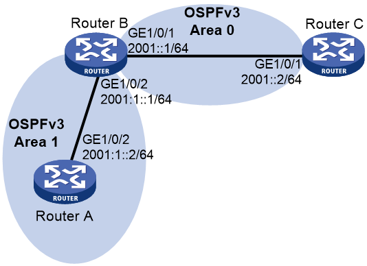

Configuring OSPFv3 FRR
About OSPFv3 FRR
A primary link failure can cause packet loss and even a routing loop until OSPFv3 completes routing convergence based on the new network topology. OSPFv3 FRR enables fast rerouting to minimize the failover time.
Figure 1 Network diagram for OSPFv3 FRR
As shown in Figure 1, configure FRR on Router B. OSPFv3 FRR automatically calculates a backup next hop or specifies a backup next hop by using a routing policy. When the primary link fails, OSPFv3 directs packets to the backup next hop. At the same time, OSPFv3 calculates the shortest path based on the new network topology. It forwards packets over the path after network convergence.
You can configure OSPFv3 FRR to calculate a backup next hop by using the loop free alternate (LFA) algorithm, or specify a backup next hop by using a routing policy.
Configuring OSPFv3 FRR to use the LFA algorithm to calculate a backup next hop
Do not use the fast-reroute lfa command together with the vlink-peer command.

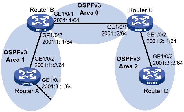

OSPFv3 configuration examples
Example: Configuring OSPFv3 stub area
As shown in Figure 2:
·     Enable OSPFv3 on all routers.
·     Split the AS into three areas.
·     Configure Router B and Router C as ABRs to forward routing information between areas.
·     Configure Area 2 as a stub area to reduce LSAs in the area without affecting route reachability.
Figure 2 Network diagram
1.     Configure IPv6 addresses for interfaces. (Details not shown.)

Example: Configuring OSPFv3 NSSA area
As shown in Figure 3:
·     Configure OSPFv3 on all routers and split the AS into three areas.
·     Configure Area 1 as an NSSA area and configure Router A as an ASBR to redistribute static routes into the AS.
Figure 3 Network diagram
2.     Configure basic OSPFv3 (see "Example: Configuring OSPFv3 stub area").

# Configure an IPv6 static route, and configure OSPFv3 to redistribute the static route on Router A.
[RouterA] ipv6 route-static 1234:: 64 null 0
[RouterA] ospfv3 1
[RouterA-ospfv3-1] import-route static
[RouterA-ospfv3-1] quit
# Display OSPFv3 routing information on Router D.
[RouterD] display ospfv3 1 routing
               OSPFv3 Process 1 with Router ID 4.4.4.4
 I  - Intra area route,  E1 - Type 1 external route,  N1 - Type 1 NSSA route
 IA - Inter area route,  E2 - Type 2 external route,  N2 - Type 2 NSSA route
 *  - Selected route
*Destination: 2001::/64
  Type       : IA                        Area       : 0.0.0.2
  AdvRouter  : 3.3.3.3                   Preference : 10
  NibID      : 0x23000002                Cost       : 2
  Interface  : GE1/0/2                   BkInterface: N/A
  Nexthop    : FE80::48C0:26FF:FEDA:305
  BkNexthop  : N/A
 *Destination: 2001:1::/64
  NibID      : 0x23000002                Cost       : 3
  BkNexthop  : N/A
 *Destination: 2001:2::/64
  Type       : I                         Area       : 0.0.0.2
  AdvRouter  : 4.4.4.4                   Preference : 10
  NibID      : 0x23000004                Cost       : 1
  Nexthop    : ::
  BkNexthop  : N/A
 *Destination: 2001:3::/64
  NibID      : 0x23000002                Cost       : 4
  BkNexthop  : N/A
 *Destination: 1234::/64
  Type       : E2                        Tag        : 1
  AdvRouter  : 2.2.2.2                   Preference : 150
  NibID      : 0x23000001                Cost       : 1
  BkNexthop  : N/A
 Total: 5
 Intra area: 1         Inter area: 3         ASE: 1         NSSA: 0
The output shows an AS external route imported from the NSSA area exists on Router D.

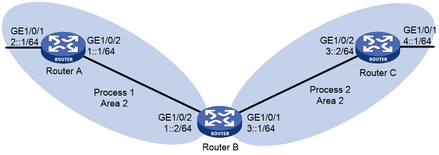

Example: Configuring OSPFv3 route redistribution
As shown in Figure 5:
·     Router A, Router B, and Router C are in Area 2.
·     OSPFv3 process 1 and OSPFv3 process 2 run on Router B. Router B communicates with Router A and Router C through OSPFv3 process 1 and OSPFv3 process 2.
·     Configure OSPFv3 process 2 to redistribute direct routes and the routes from OSPFv3 process 1 on Router B, and set the cost for redistributed routes to 3. Router C can then learn the routes destined for 1::0/64 and 2::0/64, and Router A cannot learn the routes destined for 3::0/64 or 4::0/64.
Figure 5 Network diagram
2.     Configure basic OSPFv3:
# Enable OSPFv3 process 1 on Router A.
<RouterA> system-view
[RouterA] ospfv3 1
[RouterA-ospfv3-1] router-id 1.1.1.1
[RouterA] interface gigabitethernet 1/0/2
[RouterA-GigabitEthernet1/0/2] ospfv3 1 area 2
[RouterA-GigabitEthernet1/0/2] quit
[RouterA] interface gigabitethernet 1/0/1
[RouterA-GigabitEthernet1/0/1] ospfv3 1 area 2
[RouterA-GigabitEthernet1/0/1] quit
# Enable OSPFv3 process 1 and OSPFv3 process 2 on Router B.
<RouterB> system-view
[RouterB] ospfv3 1
[RouterB-ospfv3-1] router-id 2.2.2.2
[RouterB-ospfv3-1] quit
[RouterB] interface gigabitethernet 1/0/2
[RouterB-GigabitEthernet1/0/2] ospfv3 1 area 2
[RouterB-GigabitEthernet1/0/2] quit
[RouterB] ospfv3 2
[RouterB-ospfv3-2] router-id 3.3.3.3
[RouterB-ospfv3-2] quit
[RouterB-GigabitEthernet1/0/1] ospfv3 2 area 2
[RouterB-GigabitEthernet1/0/1] quit
# Enable OSPFv3 process 2 on Router C.
<RouterC> system-view
[RouterC] ospfv3 2
[RouterC-ospfv3-2] router-id 4.4.4.4
[RouterC-ospfv3-2] quit
[RouterC] interface gigabitethernet 1/0/2
[RouterC-GigabitEthernet1/0/2] ospfv3 2 area 2
[RouterC-GigabitEthernet1/0/2] quit
[RouterC] interface gigabitethernet 1/0/1
[RouterC-GigabitEthernet1/0/1] ospfv3 2 area 2
[RouterC-GigabitEthernet1/0/1] quit
# Display the routing table on Router C.
[RouterC] display ipv6 routing-table
Destinations : 7 Routes : 7
Destination: ::1/128                                     Protocol  : Direct
NextHop    : ::1                                         Preference: 0
Interface  : InLoop0                                     Cost      : 0
Destination: 3::/64                                      Protocol  : Direct
NextHop    : ::                                          Preference: 0
Interface  : GE1/0/2                                     Cost      : 0
Destination: 3::2/128                                    Protocol  : Direct
Destination: 4::/64                                      Protocol  : Direct
Interface  : GE1/0/1                                     Cost      : 0
Destination: 4::1/128                                    Protocol  : Direct
Destination: FE80::/10                                   Protocol  : Direct
Interface  : NULL0                                       Cost      : 0
Destination: FF00::/8                                    Protocol  : Direct
3.     Configure OSPFv3 route redistribution:
# Configure OSPFv3 process 2 to redistribute direct routes and the routes from OSPFv3 process 1 on Router B, and set the cost for redistributed routes to 3.
[RouterB] ospfv3 2
[RouterB-ospfv3-2] import-route ospfv3 1 cost 3
[RouterB-ospfv3-2] import-route direct cost 3
Destinations : 9 Routes : 9
Destination: 1::/64                                      Protocol  : O_ASE2
NextHop    : FE80::200:CFF:FE01:1C03                     Preference: 150
Interface  : GE1/0/2                                     Cost      : 3
Destination: 2::/64                                      Protocol  : O_ASE2
Example: Configuring OSPFv3 route summarization
As shown in Figure 6:
·     OSPFv3 process 1 and OSPFv3 process 2 run on Router B. Router B communicates with Router A and Router C through OSPFv3 process 1 and OSPFv3 process 2, respectively.
·     On Router A, configure IPv6 addresses 2:1:1::1/64, 2:1:2::1/64, and 2:1:3::1/64 for GigabitEthernet 1/0/1.
·     On Router B, configure OSPFv3 process 2 to redistribute direct routes and the routes from OSPFv3 process 1. Router C can then learn the routes destined for 2::/64, 2:1:1::/64, 2:1:2::/64, and 2:1:3::/64.
·     On Router B, configure route summarization to advertise only summary route 2::/16 to Router C.
Figure 6 Network diagram

4.     Configure ASBR route summarization:
# On Router B, configure OSPFv3 process 2 to advertise a summary route 2::/16.
[RouterB] ospfv3 2
[RouterB-ospfv3-2] asbr-summary 2:: 16

Example: Configuring OSPFv3 FRR
As shown in Figure 10, Router A, Router B, and Router C reside in the same OSPFv3 domain. Configure OSPFv3 FRR so that when Link A fails, traffic is immediately switched to Link B.
Figure 10 Network diagram
