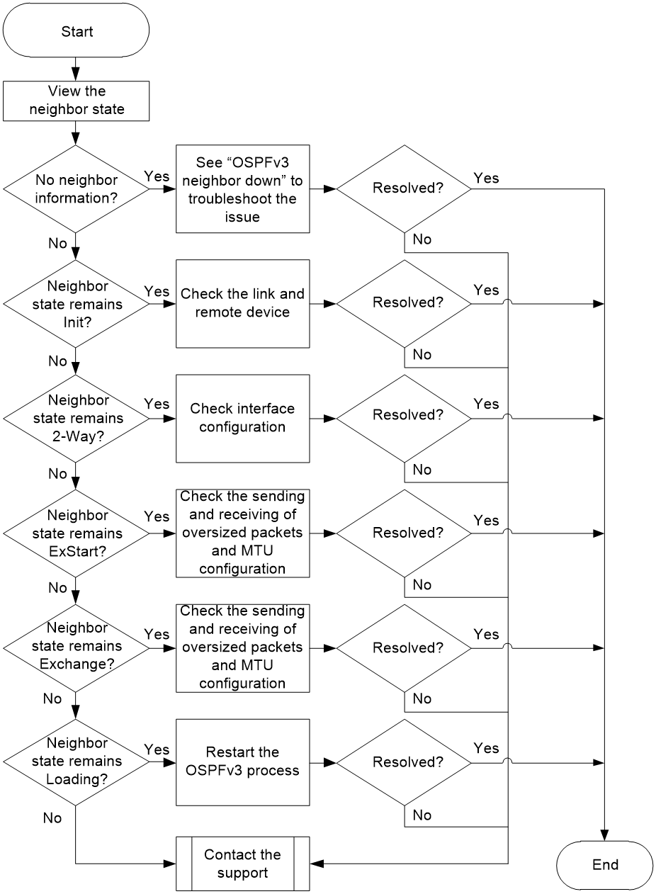

OSPFv3 neighbor unable to enter Full state
Symptom
The OSPFv3 neighbor state machine involves neighbor states of Down, Init, 2-way, ExStart, Exchange, Loading, and Full. Among them, the stable states are Down, 2-way, and Full.
·     Down—OSPFv3 is not enabled.
·     2-way—The neighbor relationship between DR Others.
·     Full—The local device and the neighbor are fully adjacent.
In networks using OSPFv3 for route calculation and forwarding, only 2-way and Full are normal neighbor states. If the neighbor state is neither 2-way nor Full, it indicates an abnormal neighbor relationship.
Common causes
The following are the common causes for this type of issue:
·     OSPFv3 packets are dropped due to link failures.
·     The DR priority configuration for the interfaces is not appropriate.
·     The two ends are configured with different MTU values.
Troubleshooting flow
Figure 2 shows the troubleshooting flowchart.
Figure 2 Flowchart for troubleshooting OSPFv3 neighbor unable to enter Full state
Solution
1.     Execute the display ospfv3 peer command to view OSPFv3 neighbor information, and perform different tasks based on the neighbor state.
¡     If no neighbor information exists:
Identify whether a Router ID is configured for the OSPFv3 process. If no Router ID is configured, the OSPFv3 process cannot operate. If a Router ID is configured, it indicates that the OSPFv3 neighbor goes down or neighbor flapping occurs. See "OSPFv3 neighbor down" to troubleshoot the issue.
¡     If the neighbor state remains Init:
It indicates that the remote device cannot receive Hello packets from the local end. In this case, identify whether the link or the remote device fails.
¡     If the neighbor state remains 2-Way:
Execute the display ospfv3 interface verbose command to identify whether the DR priority for OSPFv3 interface of the device is zero.
If the DR priority of the OSPFv3 interface is zero, no action is required.
If the DR priority of the OSPFv3 interface is not zero, proceed to step 2.
¡     If the neighbor state remains ExStart:
It indicates that the device is performing DD negotiation but cannot perform DD synchronization. The following are the common causes for this type of issue:
-     The interface cannot send and receive oversized packets correctly.
Execute the ping -s packet-size neighbor-address command multiple times and set 1500 or greater value for the packet-size argument to view the numbers of transmitted and received packets. If the remote end cannot be pinged, resolve the link issue first.
-     The two ends are configured with different MTU values.
If the OSPFv3 interface is not configured to ignore MTU check by using the ospfv3 mtu-ignore command, identify whether the two ends are configured with the same MTU value. If they are configured with different MTU values, edit the MTU setting to make sure they have the same MTU value.
If the issue persists, proceed to step 2.
¡     If the neighbor state remains Exchange:
It indicates that the device is performing DD packet exchange. Troubleshoot this issue in the same way as when the neighbor state remains ExStart.
¡     If the neighbor state remains Loading:
Execute the reset ospfv3 [ process-id ] process command to restart the OSPFv3 process.
2.     If the issue persists, collect the following information and contact Technical Support:
¡     Results of each step.
¡     The configuration file, log messages, and alarm messages.
