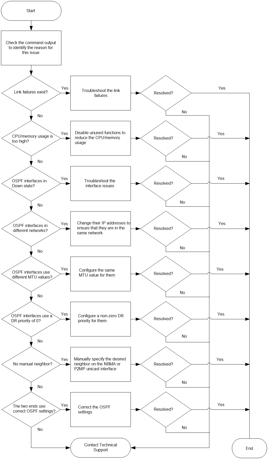

Troubleshooting flow
Figure 1 shows the troubleshooting flowchart.
Figure 1 Troubleshooting flowchart

1.     Identify the reason for the OSPF neighbor down issue through the CLI.
Execute the display ospf event-log peer command. The Reason field in the command output displays the reason for the neighbor state change. Common options include:
¡     DeadExpired
The device had not received any Hello packet before the dead timer expired, and the OSPF neighbor state became Down. In this case, proceed to step 2.
¡     BFDDown
The OSPF neighbor state became Down, because the BFD session went down. In this case, proceed to step 2.
¡     IntVliChange or Virtual link was deleted or the route it relies on was deleted
The neighbor relationship became Down, because the virtual link or its dependency route was deleted. In this case, proceed to step 2.
¡     1-Way
The OSPF state of the local device became Init, because the OSPF state of the remote device became Down and sent a 1-way Hello packet to the local device. In this case, perform troubleshooting on the remote device.
¡     IntPhyChange
The neighbor relationship became Down, because a related interface went down or its MTU changed. In this case, execute the display interface [ interface-type [ interface-number | interface-number.subnumber ] ] command to view the running state and related information about the interface, and then troubleshoot the interface faults. For other situations, proceed to 11.
2.     Check for link failures.
Execute the ping command to check for link failures. If the related links operate correctly, proceed to 3.
3.     Identify whether the CPU usage is too high.
Execute the display cpu-usage command to examine CPU usage. If the CPU usage of the device's MPU and interface modules is excessively high, OSPF might fail to receive or send protocol packets correctly, causing neighbor flapping. To resolve this issue, disable unnecessary functions. If the CPU usage is not high, proceed to step 5.
4.     Identify whether the memory usage exceeds the memory usage threshold.
Execute the display memory-threshold command. If the Current free-memory state field in the output, which represents the current memory usage of the system, displays Minor, Severe, or Critical, it indicates that the remaining free memory is relatively insufficient. In this case, the device might be unable to send or receive OSPF packets, or might process OSPF packets slowly. To resolve this issue, disable unnecessary functions. If the Current free-memory state field displays Normal, proceed to step 5.
5.     Identify whether the physical link state of each OSPF interface is in UP.
Execute the display interface [ interface-type [ interface-number | interface-number.subnumber ] ] command to identify whether the physical link state of each OSPF interface is UP.
¡     If the physical link state of an OSPF interface is DOWN, the interface has failed. First resolve this issue.
¡     If the physical link state of each OSPF interface is UP, execute the display ospf interface command to identify whether each OSPF interface is in a normal state.
-     If an OSPF interface is in DOWN state, identify whether the network command was executed in the related OSPF process to advertise the network segment to which that interface belongs. If OSPF did not advertise the network segment, identify whether OSPF is enabled on the interface. If OSPF is enabled, troubleshoot the interface issue on the network layer.
-     If the OSPF interfaces are in a normal state, including DR, BDR, DROther, and P-2-P, proceed to step 6.
6.     Identify whether the IP addresses of the two ends are in the same network segment.
Execute the display interface brief command to view IP addresses of the two neighboring interfaces.
¡     If the two interface IP addresses are not in the same network segment, execute the ip address command on either of the interfaces to change its IP address. Make sure IP addresses of the two neighboring interfaces are in the same network segment.
¡     If the two interface IP addresses are in the same network segment, proceed to step 7.
7.     Identify whether the related OSPF interfaces have the same MTU value.
If the ospf mtu-enable command was executed on the OSPF interfaces, those OSPF interfaces must add the same MTU value to DD packets. If this requirement is not met, the OSPF interfaces cannot be establish an OSPF neighbor relationship. By default, the MTU value in DD packets is 0. Execute the display interface [ interface-type [ interface-number | interface-number.subnumber ] ] command to view the MTU information of each interface.
¡     If the interfaces have different MTU values, execute the mtu size command in interface view to configure the same MTU value for the interfaces.
¡     If the interfaces have the same MTU value, proceed to step 8.
8.     Verify that the DR priority of each neighboring OSPF interface is not zero.
On a broadcast or NBMA network, to elect a DR correctly, make sure that a minimum of one OSPF interface has a non-zero DR priority. If the DR priority is 0 for both of the two neighboring OSPF interfaces, the highest neighbor states at both ends are 2-Way. Execute the display ospf interface command to view OSPF interface information. The Priority field in the command output displays the DR priority of an interface.
If the DR priority of each neighboring interface is not zero, proceed to step 9.
9.     Identify whether an NBMA or P2MP unicast neighbor has been manually specified.
When the network type of an OSPF interface is NBMA or P2MP unicast, you must use the peer command to specify a neighbor by its IP address. Execute the display this command in interface view. If the network type of an interface is NBMA or P2MP unicast, execute the peer command to manually specify a neighbor by its IP address.
If an NBMA or P2MP unicast neighbor has been manually specified, proceed to step 10.
10.     Identify whether the OSPF settings at the two ends are correct.
a.     Execute the display ospf command to view the OSPF router IDs of the two ends. If the two ends use the same router ID, edit the configuration to avoid the conflict. If the two ends use different router IDs, proceed to the next step.
b.     Execute the display ospf interface command to view the OSPF area IDs of the two ends. If the two ends use different area IDs, edit the configuration to ensure area ID consistency. If the two ends use the same area ID, proceed to the next step.
c.     Execute the display ospf interface command to view the network types of interfaces at the two ends. If the two interfaces are configured with different network types, edit the configuration to ensure network type consistency. If the network type is PTP for one end and Broadcast for the other, the neighbor relationship can reach Full state, but routing information cannot be calculated.
If the two ends are configured with the same network type, proceed to the next step.
d.     Execute the display ospf statistics error command every 10 seconds for 5 minutes to view OSPF error statistics. Pay attention to the following fields:
-     Bad authentication type: If the value of this field keeps increasing, the two OSPF neighbors are configured with different OSPF authentication modes. To resolve this issue, edit the authentication mode setting to make sure the two devices have the same authentication mode.
-     Hello-time mismatch: If the value of this field keeps increasing, the two neighboring interfaces are configured with different hello intervals. To resolve this issue, edit the hello interval setting to make sure the OSPF interfaces have the same hello interval value.
-     Dead-time mismatch: If the value of this field keeps increasing, the two neighboring interfaces are configured with different dead intervals. To resolve this issue, edit the dead interval setting to make sure the OSPF interfaces have the same dead interval value.
-     Ebit option mismatch: If the value of this field keeps increasing, the two neighbors are of different OSPF area types. (For example, one end is in a normal area and the other end is in a stub area.) To resolve this issue, edit the OSPF area setting to make sure the two ends have the same area type.
If the issue persists, proceed to step 11.
11.     If the issue persists, collect the following information and contact Technical Support:
¡     Results of each step.
¡     The configuration file, log messages, and alarm messages.

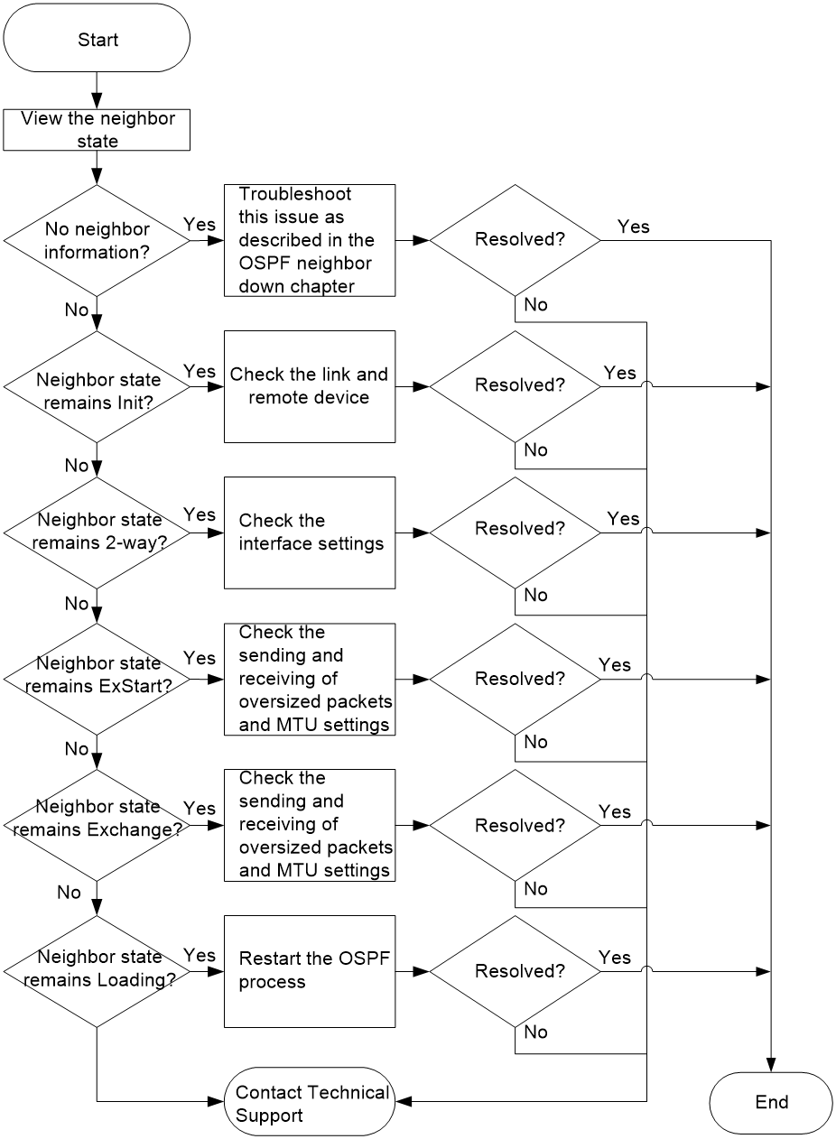

Figure 2 shows the troubleshooting flowchart:
Figure 2 Troubleshooting flowchart

1.     Execute the display ospf peer command to view OSPF neighbor information, and perform different tasks based on the neighbor state.
¡     If no neighbor information exists:
The OSPF neighbor went down or flapped. See "OSPF neighbor down" to troubleshoot the issue.
¡     If the neighbor state remains Init:
The remote device cannot receive Hello packets from the local device. In this case, identify whether the link or the remote device has failed.
¡     If the neighbor state remains 2-Way:
Execute the display ospf interface verbose command to identify whether the DR priority of the neighbor-facing OSPF interface is zero.
-     If the DR priority of the OSPF interface is zero, no action is required.
-     If the DR priority of the OSPF interface is not zero, proceed to step 2.
¡     If the neighbor state remains ExStart:
The device keeps performing DD negotiation but cannot perform DD synchronization. The following are the common causes for this issue:
-     The neighbor-facing interface cannot send and receive oversized packets correctly.
Repeat the ping -s packet-size neighbor-address command, set the value for the packet-size argument to 1500 or greater, and then view the transmission and reception of oversized packets. If the remote end still cannot be pinged, troubleshoot the link issue first.
-     The two ends use different MTU values.
If the ospf mtu-enable command was configured on the neighbor-facing OSPF interface, identify whether the two ends use the same MTU value. If they use different MTU values, configure the same MTU value for them.
If the issue persists, proceed to step 2.
¡     If the neighbor state remains Exchange:
The device is performing DD packet exchange. Troubleshoot this issue in the same way as when the neighbor state remains ExStart.
¡     If the neighbor state remains Loading:
Execute the reset ospf [ process-id ] process command to restart the OSPF process.
2.     If the issue persists, collect the following information and contact Technical Support:

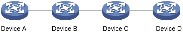

In this troubleshooting example, the network diagram is as shown in Figure 5. The troubleshooting methods for other networks are similar as that for this network.
Figure 5 Network diagram
2.     On each device in the OSPF network, execute the display ospf [ process-id ] lsdb command every second to view their OSPF LSDB information.
3.     Check for abnormal LSA aging.
If abnormal LSA aging exists, you can find the following symptoms:
¡     On Device A, the Age field of a Network LSA (Type-2) remains at the minimum value, but its Sequence field increases rapidly. For example, in the following command output, the Age of Network LSA 172.168.0.1 (LinkStateID) does not naturally increase, and the Sequence field grows from 8000002D to 8000002F in a short time.
<Sysname> display ospf 100 lsdb
         OSPF Process 100 with Router ID 10.1.1.1
                 Link State Database
                         Area: 0.0.0.0
 Type      LinkState ID    AdvRouter       Age  Len   Sequence  Metric
 Router    3.3.3.3         3.3.3.3         797  48    80000009  0
 Router    1.1.1.1         1.1.1.1         835  36    80000005  0
 Router    4.4.4.4         4.4.4.4         798  36    80000004  0
 Router    10.1.1.1        10.1.1.1        415  36    80000007  0
 Router    2.2.2.2         2.2.2.2         415  48    80000015  0
 Network   192.168.0.2     3.3.3.3         802  32    80000002  0
 Network   172.168.0.3     4.4.4.4         791  32    80000002  0
 Network   172.168.0.1     10.1.1.1        7    32    8000002D  0
                 Link State Database
                         Area: 0.0.0.0
 Router    3.3.3.3         3.3.3.3         810  48    80000009  0
 Router    1.1.1.1         1.1.1.1         848  36    80000005  0
 Router    4.4.4.4         4.4.4.4         811  36    80000004  0
 Router    10.1.1.1        10.1.1.1        428  36    80000007  0
 Router    2.2.2.2         2.2.2.2         428  48    80000015  0
 Network   192.168.0.2     3.3.3.3         815  32    80000002  0
 Network   172.168.0.3     4.4.4.4         804  32    80000002  0
 Network   172.168.0.1     10.1.1.1        4    32    8000002F  0
¡     On Device B, the Age field of the same Network LSA frequently switches between 3600 and other smaller values, and its Sequence field increases rapidly. For example, in the following command output, the Age of Network LSA 172.168.0.1 (LinkStateID) frequently switches between 3600 and other smaller values, and the Sequence field grows from 80000023 to 80000041 in a short time.
         OSPF Process 100 with Router ID 2.2.2.2
                 Link State Database
                         Area: 0.0.0.0
 Router    3.3.3.3         3.3.3.3         708  48    80000009  0
 Router    1.1.1.1         1.1.1.1         746  36    80000005  0
 Router    4.4.4.4         4.4.4.4         709  36    80000004  0
 Router    10.1.1.1        10.1.1.1        329  36    80000007  0
 Router    2.2.2.2         2.2.2.2         327  48    80000015  0
 Network   172.168.0.3     4.4.4.4         702  32    80000002  0
 Network   192.168.0.2     3.3.3.3         713  32    80000002  0
 Network   172.168.0.1     10.1.1.1        3600 32    80000023  0
                 Link State Database
                         Area: 0.0.0.0
 Router    3.3.3.3         3.3.3.3         748  48    80000009  0
 Router    1.1.1.1         1.1.1.1         786  36    80000005  0
 Router    4.4.4.4         4.4.4.4         749  36    80000004  0
 Router    10.1.1.1        10.1.1.1        369  36    80000007  0
 Router    2.2.2.2         2.2.2.2         367  48    80000015  0
 Network   172.168.0.3     4.4.4.4         742  32    80000002  0
 Network   192.168.0.2     3.3.3.3         753  32    80000002  0
 Network   172.168.0.1     10.1.1.1        7    32    80000041  0
¡     On Device C, the Age field of the same Network LSA remains at 3600 or the Network LSA occasionally disappears, and the Sequence field increases rapidly. For example, in the following command output, the Age of Network LSA 172.168.0.1 (LinkStateID) remains at 3600 or the Network LSA occasionally disappears. When the Network LSA exists, its Sequence field grows from 80000309 to 80000346 in a short time.
         OSPF Process 100 with Router ID 3.3.3.3
                 Link State Database
                         Area: 0.0.0.0
 Router    3.3.3.3         3.3.3.3         740  48    8000000D  0
 Router    4.4.4.4         4.4.4.4         759  36    80000008  0
 Router    10.1.1.1        10.1.1.1        364  36    8000000B  0
 Router    2.2.2.2         2.2.2.2         366  48    80000019  0
 Network   172.168.0.3     4.4.4.4         755  32    80000006  0
 Network   192.168.0.2     3.3.3.3         744  32    80000006  0
 Network   172.168.0.1     10.1.1.1        3600 32    80000309  0
                 Link State Database
                         Area: 0.0.0.0
 Router    3.3.3.3         3.3.3.3         745  48    8000000D  0
 Router    4.4.4.4         4.4.4.4         764  36    80000008  0
 Router    10.1.1.1        10.1.1.1        369  36    8000000B  0
 Router    2.2.2.2         2.2.2.2         371  48    80000019  0
 Network   172.168.0.3     4.4.4.4         760  32    80000006  0
 Network   192.168.0.2     3.3.3.3         749  32    80000006  0
                 Link State Database
                         Area: 0.0.0.0
 Router    3.3.3.3         3.3.3.3         1302 48    8000000D  0
 Router    4.4.4.4         4.4.4.4         1321 36    80000008  0
 Router    10.1.1.1        10.1.1.1        926  36    8000000B  0
 Router    2.2.2.2         2.2.2.2         928  48    80000019  0
 Network   172.168.0.3     4.4.4.4         1317 32    80000006  0
 Network   192.168.0.2     3.3.3.3         1306 32    80000006  0
 Network   172.168.0.1     10.1.1.1        3600 32    80000346  0
4.     Check for OSPF route flapping.
On Device B, execute the display ospf [ process-id ] routing command every second to check for route flapping.
<Sysname> display ospf 100 routing
                  Routing Table
 Routing for network
 Destination        Cost     Type    NextHop         AdvRouter       Area
 192.168.0.0/24     1        Transit 0.0.0.0         3.3.3.3         0.0.0.0
 172.168.0.0/24     1        Transit 0.0.0.0         10.1.1.1        0.0.0.0
 Total nets: 2
 Intra area: 2  Inter area: 0  ASE: 0  NSSA: 0
                  Routing Table
 Routing for network
 172.168.0.0/24     2        Transit 192.168.0.2     4.4.4.4         0.0.0.0
 Total nets: 2
If OSPF route flapping occurs, and multiple executions of the display ospf peer command show that the neighbor relationship is not flapping, an IP address conflict exists in the OSPF network. Meanwhile, this indicates that one of the conflicting devices is a DR, because Network LSAs (Type-2) are generated by DRs.
If two Network LSAs with the same LinkState ID exist and they are aging abnormally on any device, both of the conflicting devices are DRs.
                 Link State Database
                         Area: 0.0.0.0
 Router    3.3.3.3         3.3.3.3         367  48    80000021  0
 Router    4.4.4.4         4.4.4.4         369  36    80000013  0
 Router    10.1.1.1        10.1.1.1        477  36    80000012  0
 Router    2.2.2.2         2.2.2.2         403  48    8000002B  0
 Network   192.168.0.1     2.2.2.2         395  32    80000002  0
 Network   172.168.0.1     3.3.3.3         3600 32    8000002B  0
 Network   172.168.0.1     10.1.1.1        9    32    80000036  0
                 Link State Database
                         Area: 0.0.0.0
 Router    3.3.3.3         3.3.3.3         460  48    80000021  0
 Router    4.4.4.4         4.4.4.4         462  36    80000013  0
 Router    10.1.1.1        10.1.1.1        570  36    80000012  0
 Router    2.2.2.2         2.2.2.2         496  48    8000002B  0
 Network   192.168.0.1     2.2.2.2         488  32    80000002  0
 Network   172.168.0.1     3.3.3.3         3600 32    80000034  0
 Network   172.168.0.1     10.1.1.1        6    32    80000041  0
5.     Identify the conflicting devices.
You can use the output of the display ospf lsdb command to find the devices causing the IP address conflict.
If only one of the conflicting devices is a DR, perform the following task:
a.     Check the AdvRouter field of the abnormal Network LSA to find the router ID of the advertising DR.
b.     Check the LinkState ID field of the abnormal Network LSA to identify the interface that uses the conflicting IP address, and then find the IP address of the interface.
c.     Based on the obtained interface address and the IP address plan, identify another conflicting device.
In this example, the DR with Router ID 10.1.1.1 has an interface IP address conflict with another device, and the conflicting IP address is 172.168.0.1. Based on the IP address plan, you can find the other device causing the conflict.
If both of the conflicting devices are DRs, perform the following task:
d.     Check the AdvRouter field of each abnormal Network LSA to find the router IDs of the advertising DRs.
e.     Check the LinkState ID field of each abnormal Network LSA to identify the interfaces causing the IP address conflict.
6.     Change the IP address of a conflicting device, according to the network IP address plan.
7.     If the issue persists, collect the following information and contact Technical Support:
Related alarm and log messages
Alarm messages
N/A
Log messages
N/A
