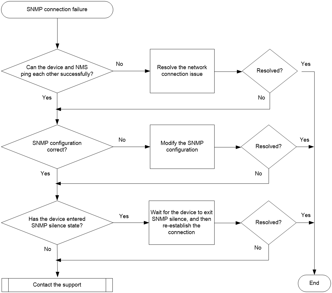

SNMP connection failure
Symptom
The Network Management System (NMS) cannot connect to the device successfully via SNMP.
Common causes
The following are the common causes of this type of issue:
·     Network connection failure between the device and NMS.
·     Authentication failure because of configuration errors.
·     The device is under an SNMP packet attack and enters SNMP silence mode.
Troubleshooting flow
Figure 1 shows the troubleshooting flowchart.
Figure 1 Flowchart for troubleshooting SNMP connection failure

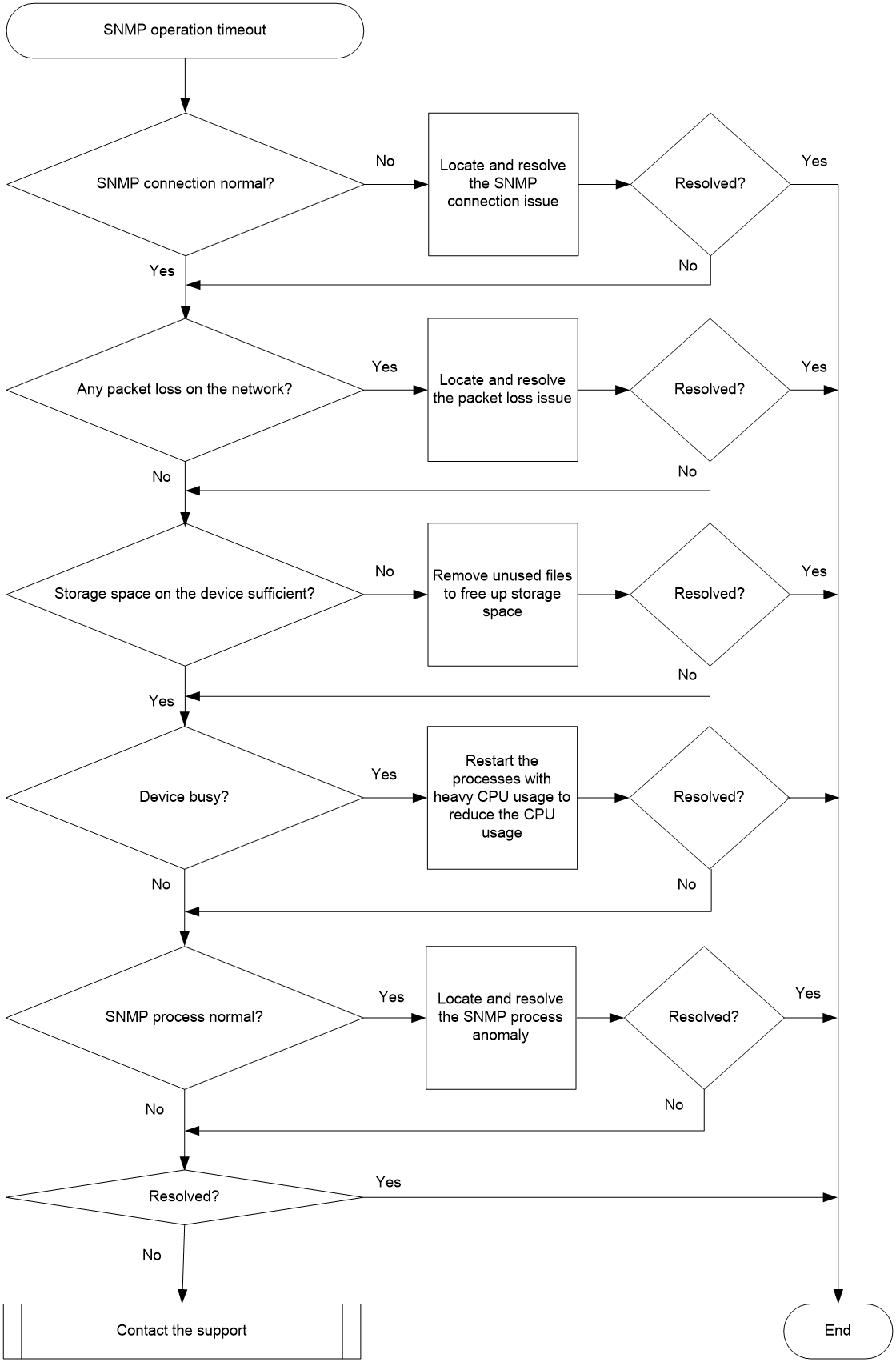

SNMP operation timeout
Symptom
The NMS performs an SNMP Get or Set operations on the device, but the operation times out.
Common causes
·     Interruption of the SNMP connection, causing failure of the NMS to access the device.
·     Packet loss on the network, causing failure of the device to receive the SNMP request.
·     Insufficient storage space on the storage medium of the device, causing the device to be unable to process the SNMP request.
·     The device is busy processing other tasks, which prevents it from processing the SNMP request.
·     The SNMP process (acting as an SNMP agent) is busy processing other SNMP requests, preventing it from responding to the current SNMP request.
·     An exception occurs while the SNMP process is handling the current SNMP request.
Figure 2 shows the troubleshooting flowchart.
Figure 2 Troubleshooting flowchart for SNMP operation timeout

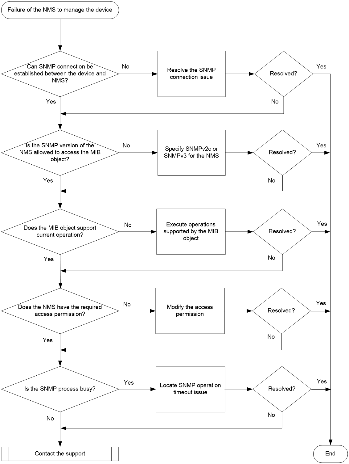

NMS failure to manage the device
Symptom
The NMS performs an SNMP Set or Get operation on the device, but the device does not respond or a prompt is displayed indicating that the operation has failed.
Common causes
·     The NMS cannot connect to the device via SNMP.
·     The SNMP version used by the NMS does not match that of the MIB object.
·     The NMS does not have access permission to the device.
·     The SNMP process on the device is busy, unable to respond to the current SNMP request.
Figure 3 shows the troubleshooting flowchart.
Figure 3 Troubleshooting flowchart for NMS failure to manage the device

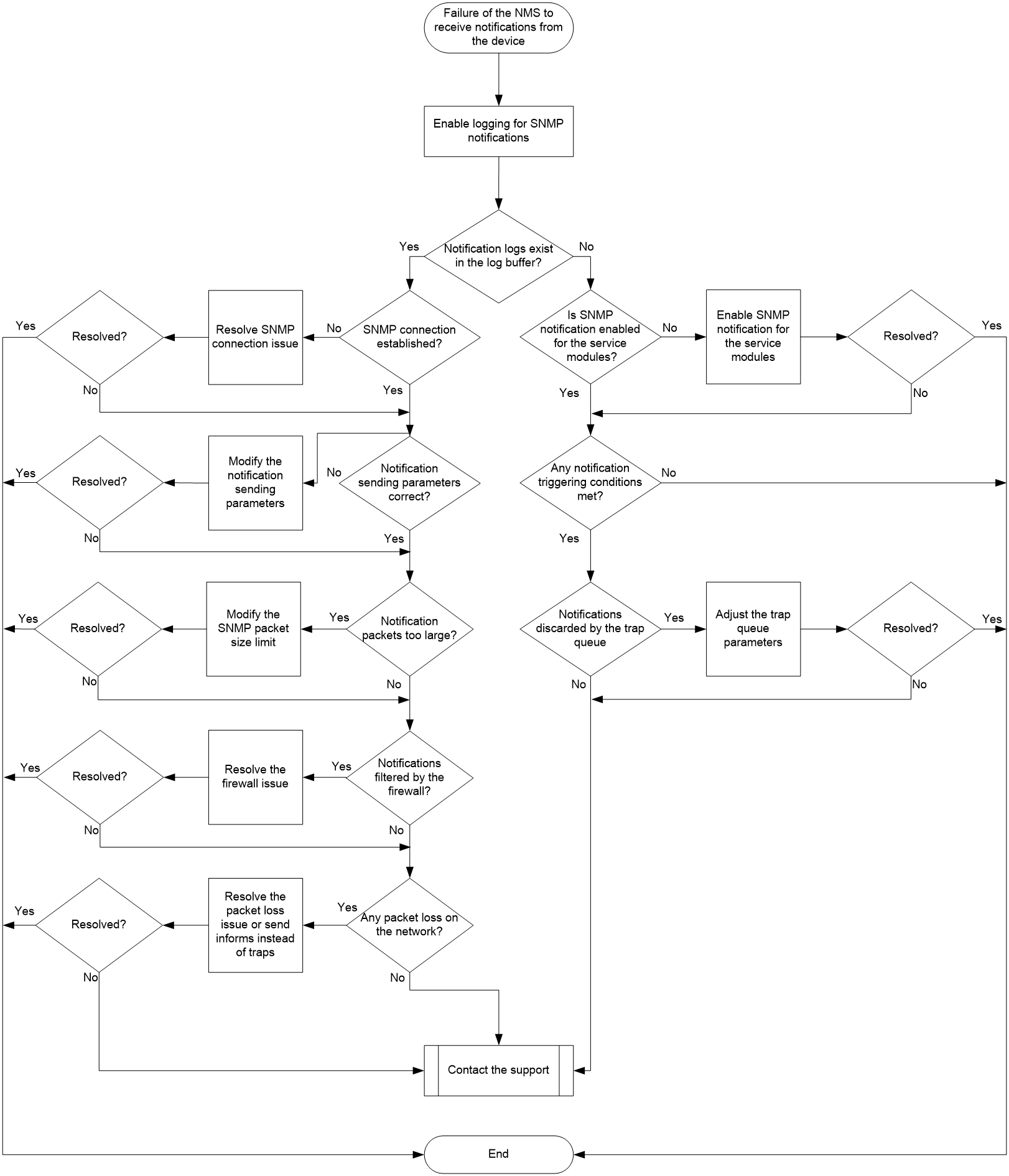

Failure of the NMS to receive SNMP notifications
Symptom
The NMS fails to receive SNMP notifications sent from the device.
Common causes
·     The device and NMS are unreachable to each other, or SNMP malfunctions, resulting in SNMP connection failure.
·     Configuration error on the device side or NMS side.
·     No notifications have been generated from the service modules on the device.
·     Loss of notifications.
·     The SNMP notification messages are too large, exceeding the notification message size that the SNMP module can process.
Figure 4 shows the troubleshooting flowchart.
Figure 4 Flowchart for troubleshooting failure of the NMS to receive SNMP notifications from the device

d.     Identify whether a firewall on the network filters the notifications.
If a firewall on the network filters the notifications, use the following method to resolve the issue:
-     If the firewall has filtered the notifications by source IP, use the snmp-agent trap source command to modify the source IP address of the notifications.
-     Modify the firewall rules to permit the notifications.
e.     Identify if the network is unstable and has packet loss.
If there is packet loss on the network, use the following methods to resolve the issue:
-     Check the network and resolve the packet loss issue on the network.
-     Configure the device to send informs instead of traps. Informs require acknowledge from the NMS, more reliable than traps. Informs are supported only in SNMPv2c and SNMPv3.
4.     Identify if the SNMP module has sent notifications to the NMS.
a.     Use the display snmp-agent trap-list command to identify whether SNMP notification has been enabled for the service modules. If not enabled, use the snmp-agent trap enable command to enable SNMP notification for the modules.
b.     Identify if the notification triggering conditions have been met. For example, the interface status change notification is generated when the status of an interface changes, and high CPU or memory usage notification is generated when the CPU or memory usage exceeds the threshold.
-     If no notification triggering conditions have been met, it is normal that no notification is generated.
-     If a notification triggering condition has been met but the device has not sent a notification, proceed to step c.
c.     Use the display snmp-agent trap queue command to identify if the notification buffer is full. If the Message number is greater than the Queue size, the notification buffer might be full, and newly generated notifications might be discarded. In this case, you can use the snmp-agent trap queue-size and snmp-agent trap life commands in system view to adjust the performance parameters of the notification buffer.
5.     If the issue persists, collect the following information and contact Technical Support:
¡     Results of each step.
¡     Configuration file, log messages, and alarm messages.
