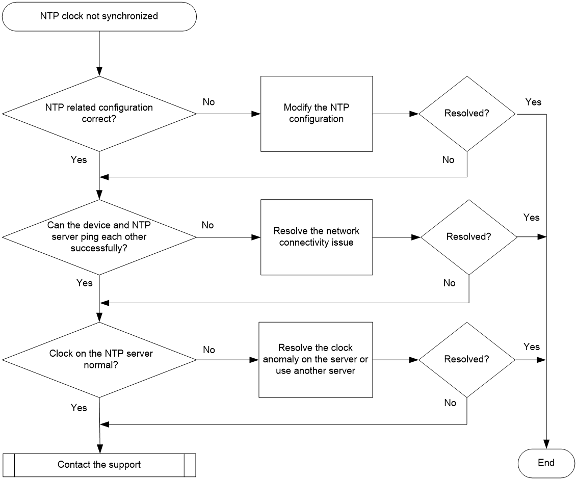

Troubleshooting flow
Figure 1 shows the troubleshooting flowchart.
Figure 1 Flowchart for troubleshooting NTP clock synchronization failure

The client/server mode, broadcast mode, and multicast mode all derive from the client/server (C/S) model. The following information is the troubleshooting procedure for NTP time synchronization failure in the C/S model. If you are synchronizing local time with a peer using the symmetric active/passive mode, you can also use this procedure by treating the local end as the client in the C/S model.
To resolve the issue:
1.     Execute the display ntp-service [ ipv6 ] sessions command on the device. If no information is output, NTP is not enabled on the device. Configure NTP settings by referring to the configuration guide for the device. If information is output from the command, locate the issue as follows:

2.     Identify if the NTP-related configuration is correct.
Determine the NTP association mode used by the device according to the network plan. Based on the NTP association mode, execute the display current-configuration | include ntp-service command on the device to view the NTP-related configuration and identify if the current NTP configuration is correct. For example, when the local end acts as a client for time synchronization in client/server mode, the NTP configuration must meet the following requirements:
¡     The ntp-service [ ipv6 ] unicast-server command has been configured in system view to specify the NTP server IP address correctly.
¡     The clock protocol ntp command has been configured in system view to specify NTP for obtaining the system time.
¡     If NTP authentication is required, make sure the authentication key configured on the device and the NTP server is the same, and the authentication key used on this device is trusted on the server. Verify that the ntp-service authentication-keyid  specify an authentication key) and ntp-service reliable authentication-keyid (configure the authentication key as a trust key) commands have been configured in system view correctly.
3.     Execute the ping command to verify the reachability between the device and the NTP server.
¡     If the ping is successful, the device and the NTP server are reachable to each other. Proceed to step 4.
¡     If the ping fails, see the ping failure troubleshooting procedure in "Troubleshooting network management and monitoring" to resolve the issue. Proceed to step 4 after the ping succeeds.
4.     Execute the debugging ntp-service all command in user view to enable NTP debugging and view NTP debugging information. The local end will not synchronize with the NTP server if the following conditions exist.
¡     If "The packet from ip-address failed the validity tests result" is displayed in the debugging information, the packets from the specified NTP server failed the validity check on the device. The device will not synchronize with the clock of that NTP server.
¡     if delay in rdel: delay > 16000, disper in rdsp: disper > 16000, or delay/2+disper > 16000, the clock provided by the NTP server has a too large offset, and the device will not synchronize the clock with that NTP server.
5.     If the issue persists, collect the following information and contact Technical Support:
