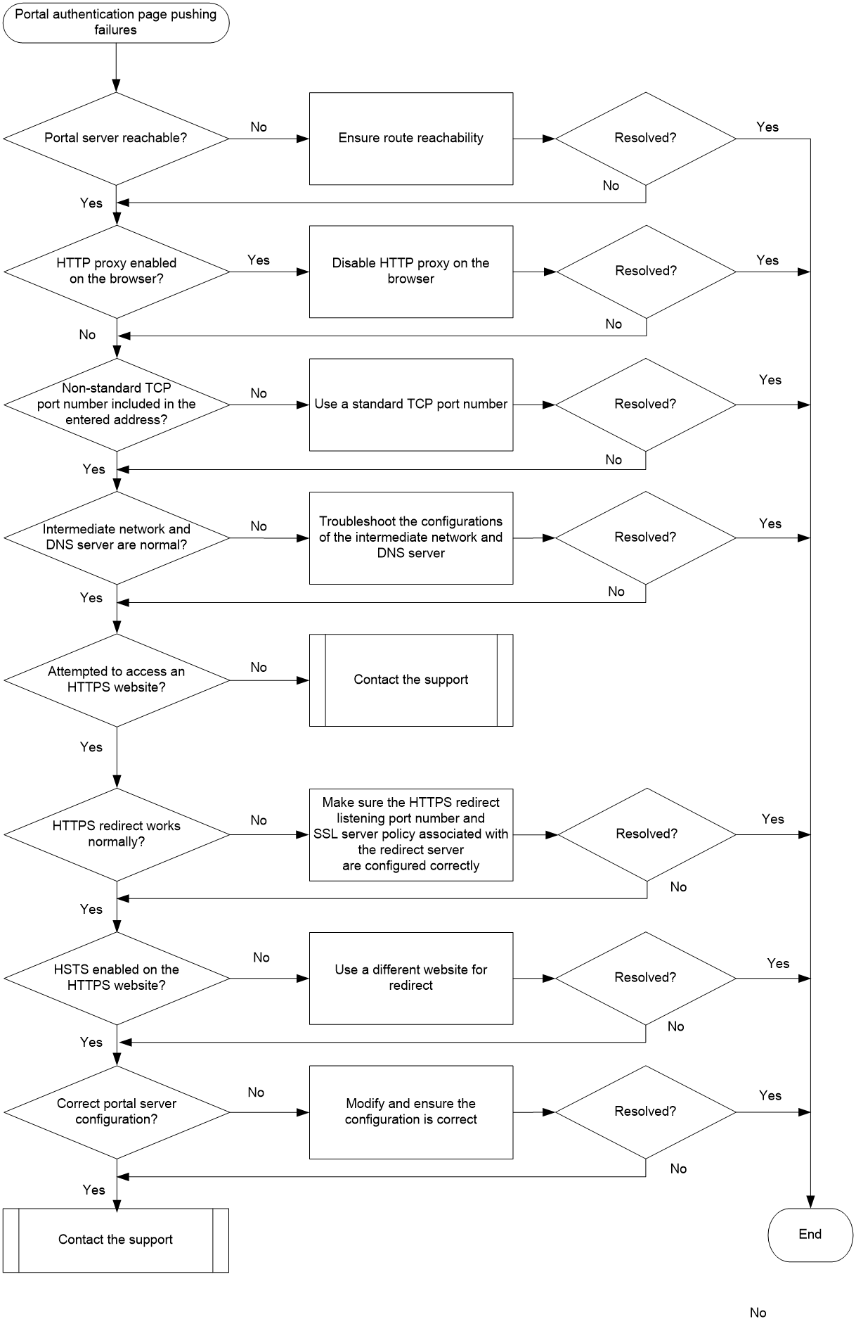

Figure 1 shows the troubleshooting flowchart.
Figure 1 Flowchart for troubleshooting portal authentication page pushing failures

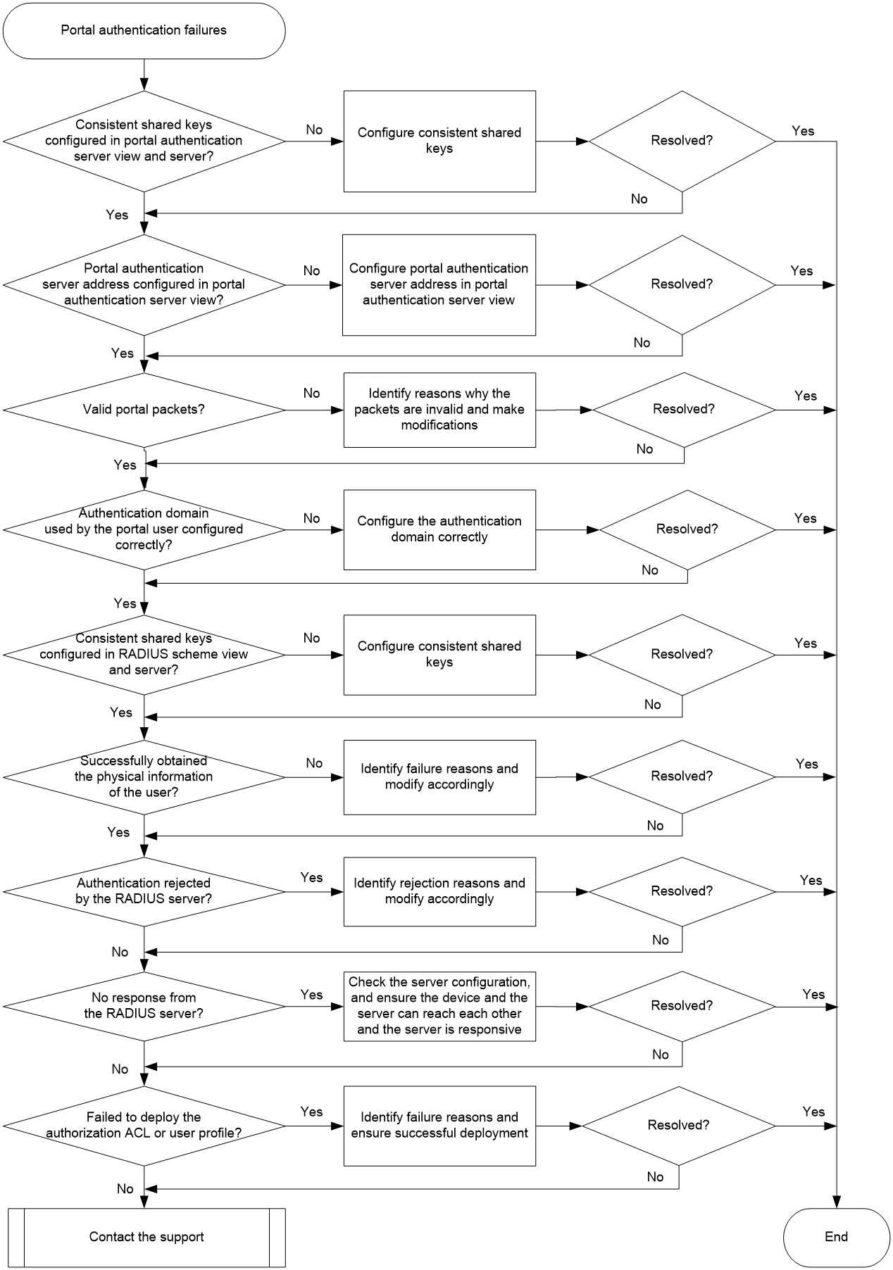

Figure 2 shows the troubleshooting flowchart.
Figure 2 Flowchart for troubleshooting portal authentication failures

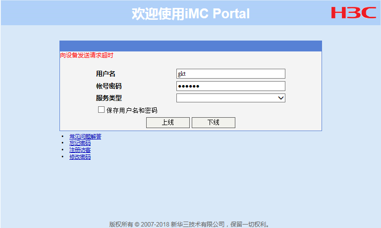

Figure 3 Error message on the portal login page (1)
You can troubleshoot using the following methods:
¡     Execute the debugging portal error command on the device to enable portal error debugging. If the following information is displayed on the device, it indicates that the shared key configured on the device is inconsistent with that configured on the portal server.
*Jul 28 17:51:20:774 2021 Sysname PORTAL/7/ERROR: -MDC=1; Packet validity check failed due to invalid key.
¡     Execute the display portal auth-error-record command to check whether the following information is displayed in the Auth error reason field of the command output: Packet validity check failed due to invalid authenticator.
If the shared keys are inconsistent, modify the shared key configured in portal authentication server view on the device or on the portal authentication server to ensure consistency.

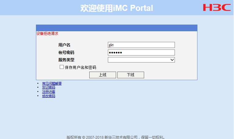

As shown in Figure 4, if the IMC server is used, enter the username and password and then click Log In, check whether a message indicating the request to the device timed out is prompted. If so, this indicates that the authentication server address configured in portal server view on the device might not exist.
Figure 4 Error message on the portal login page (2)
You can troubleshoot using the following method:
¡     Execute the debugging portal error command on the device to enable portal error debugging. If the following information is displayed on the device, it indicates that the IP address of the portal authentication server configured on the device is incorrect.
*Jul 28 19:15:10:665 2021 Sysname PORTAL/7/ERROR: -MDC=1;Packet source unknown. Server IP:192.168.161.188, VRF Index:0.
¡     Execute the display portal auth-error-record command to check whether the following information is displayed in the Auth error reason field of the command output: Packet source unknown. Server IP:X.X.X.X, VRF index:0.
If the address is incorrect, execute the ip command to modify the portal server's IP address in portal authentication sever view on the device.

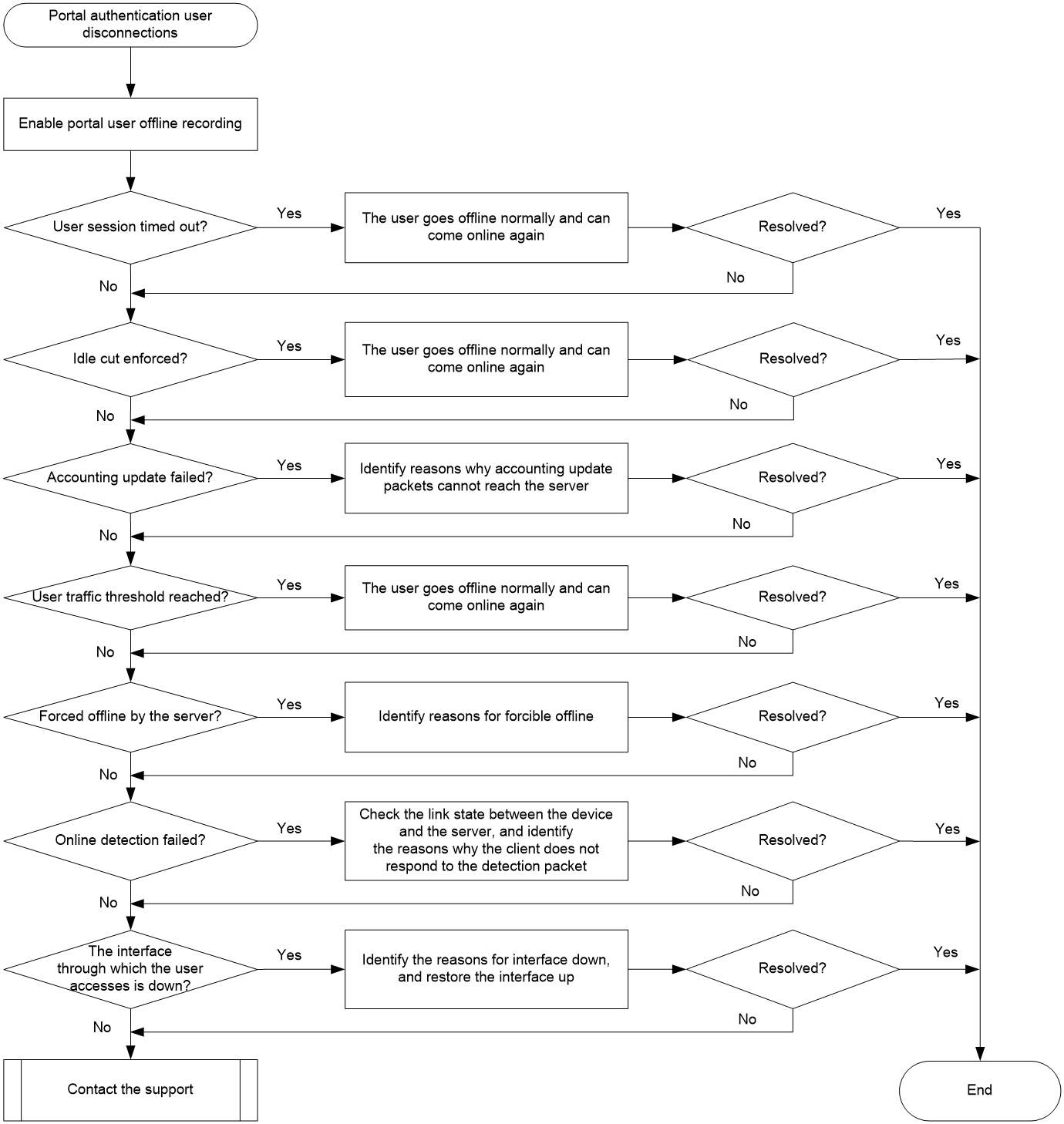

Portal authentication user disconnections
A portal user is disconnected after coming online for a period of time.
Common causes
The following are the common causes of this type of issue:
·     The user session has timed out.
·     User idle cut.
·     Accounting update failures.
·     User traffic reaches the threshold.
·     The server forces the user offline.
·     The user failed the online detection.
·     The interface where the user accesses is down.
Troubleshooting flow
Figure 7 shows the troubleshooting flowchart.
Figure 7 Flow chart for troubleshooting portal authentication user disconnections
Solution
1.     Execute the portal logout-record enable command to enable portal user offline recording.
2.     Check whether the user session has timed out.
If the AAA server has deployed the session timeout time (single online duration) to the portal user, once the user's online duration exceeds the timeout time, the device logs out the user.
Use the following methods to check whether the portal user goes offline because of session timeout:
¡     View the user offline records on the AAA server.
¡     Execute the display portal logout-record command to view the user logout reason.
<Sysname> display portal logout-record all
Total logout records: 1
User name              : gkt
User MAC               : 0800-2700-94ad
Interface              : Vlan-interface100
User IP address        : 21.0.0.20
AP                     : N/A
SSID                   : N/A
User login time        : 2021-07-29 11:05:58
User logout time       : 2021-07-29 11:05:58
Logout reason          : Session timeout
¡     Execute the debugging portal error command on the device to enable portal error debugging. If the following information is displayed on the device, it indicates that the portal user is logged out because of user session timeout.
*Jul 28 17:51:20:774 2021 Sysname PORTAL/7/ERROR: -MDC=1; Session timer timed out and the user will be logged off.
The user logout triggered by session timeout is a normal logout. The user can come online again.
3.     Check whether the user goes offline because of user idle cut.
With the idle cut feature configured, if the device or the AAA server has authorized an idle timeout period for the user, the device periodically checks the user's traffic after the user comes online. If the user's traffic generated within the specified idle timeout period is less than the specified data volume, the user will be forced offline.
You can use the following methods to check whether the portal user goes offline because of idle cut:
¡     View the user logout records on the AAA server.
¡     Execute the display portal logout-record command to view the user offline records.
User name              : gkt
AP                     : N/A
SSID                   : N/A
Logout reason          : Idle timeout
¡     Execute the debugging portal error command on the device to enable portal error debugging. If the following information is displayed on the device, it indicates that the portal user goes offline because of idle cut timer timeout.
*Jul 28 17:51:20:774 2021 Sysname PORTAL/7/ERROR: -MDC=1; Idle-cut timer timed out and the user will be logged off.
The logout triggered by idle timeout is a normal logout. The user can come online again.
4.     Check whether accounting update failures.
When a remote portal authentication user comes online, the device periodically sends accounting-update packets to the AAA server. If the link between the device and the AAA server is disconnected or the server fails, the device fails to send accounting-update packets. When the maximum number of retransmissions is reached, transmission of accounting-update packets fails and the accounting update failure policy has been configured on the device, the user will be triggered to go offline. The accounting update failure policy is configured by using the accounting update-fail offline command.
You can use the following methods to check whether the user goes offline because of accounting update failures:
User name              : gkt
AP                     : N/A
SSID                   : N/A
Logout reason          : Accounting update failure
¡     Execute the display interface command to check whether the port on the device connected to the AAA server has any changes, or whether the AAA server has any exception records. Or, execute the display radius scheme command to check whether Block is displayed in the State field (indicating the state of the server). If yes, the reason for the user logout might be accounting update failures.
¡     Execute the debugging portal error command on the device to enable portal error debugging. If the following information is displayed on the device, it indicates that the portal user goes offline because of accounting update failures.
*Jul 28 17:51:20:774 2021 Sysname PORTAL/7/ERROR: -MDC=1; Processed accounting-update failed and user logout.
If you confirm that the user goes offline because of accounting update failures, check the link state between the device and the server, and check whether the relevant accounting configurations on the device and the AAA server have changed.
5.     Check whether the user's traffic has reached the threshold.
When a user comes online, if the AAA server deploys a traffic threshold, the device will force the user offline once the user's traffic exceeds the deployed threshold.
You can use the following methods to check whether the user goes offline because traffic threshold reaching:
¡     Check the user offline records on the AAA server.
User name              : gkt
AP                     : N/A
SSID                   : N/A
Logout reason          : User traffic reached threshold
The user logout triggered by traffic threshold reaching is a normal logout. The user can come online again.
6.     Check whether the AAA server actively kicks the user offline.
After RADIUS session-control feature is enabled on the device (using the radius session-control enable command), the device immediately forces a user offline upon reception of a disconnection request from the AAA server. If the feature is enabled, you can use the following methods to check whether the user is forced offline by the AAA server:
User name              : gkt
AP                     : N/A
SSID                   : N/A
Logout reason          : Force logout by RADIUS server
For more information about the reasons for the forcible user logout, contact the server administrator.
7.     Check whether the user goes offline because of online detection failures.
If the portal user online detection feature is enabled on the device (using the portal user-detect command), the device periodically sends detection packets to the user client. If the device has not received a response from the client after the specified maximum number of attempts, it will force the user offline.
Check whether the portal user online detection feature is enabled on the device. If the feature is enabled, you can use the following methods to check whether the user goes offline because of user online detection failures:
User name              : gkt
AP                     : N/A
SSID                   : N/A
Logout reason          : User detection failure
After you confirm that the user goes offline because of user online detection failures, check the link state between the client and the device, and identify the reasons why the client does not respond to the detection packet.
8.     Check whether the interface through which the portal user accesses is down.
If the interface used by the portal user goes down for a period of time, the device forces all portal users accessing through this interface offline.
You can confirm use the following methods to check whether the user has gone offline because of interface down:
¡     Execute the display interface command to check whether the state of the interface changed. If the interface's state changed and the change time is close to the time when the user went offline, the reason for the user logout might be interface down.
¡     Execute the display portal logout-record command to view the user logout records
User name              : gkt
AP                     : N/A
SSID                   : N/A
Logout reason          : Interface down
If you confirm that the user goes offline because of the interface down, identify the reasons for interface down, such as loosely connected network cable.
9.     If the issue persists, collect the following information and contact Technical Support:
¡     Results of each step.
¡     The configuration file, log messages, and alarm messages.
¡     Screenshots of portal-related configurations on the portal server.
¡     User logout records on the AAA server.
¡     Files containing the packets captured between the device and the AAA server.
¡     Screenshots of the issue taken on the client's browser.
¡     Debugging information collected after you enable the debugging portal command.
Related alarm and log messages
Alarm messages
N/A
Log messages
N/A
