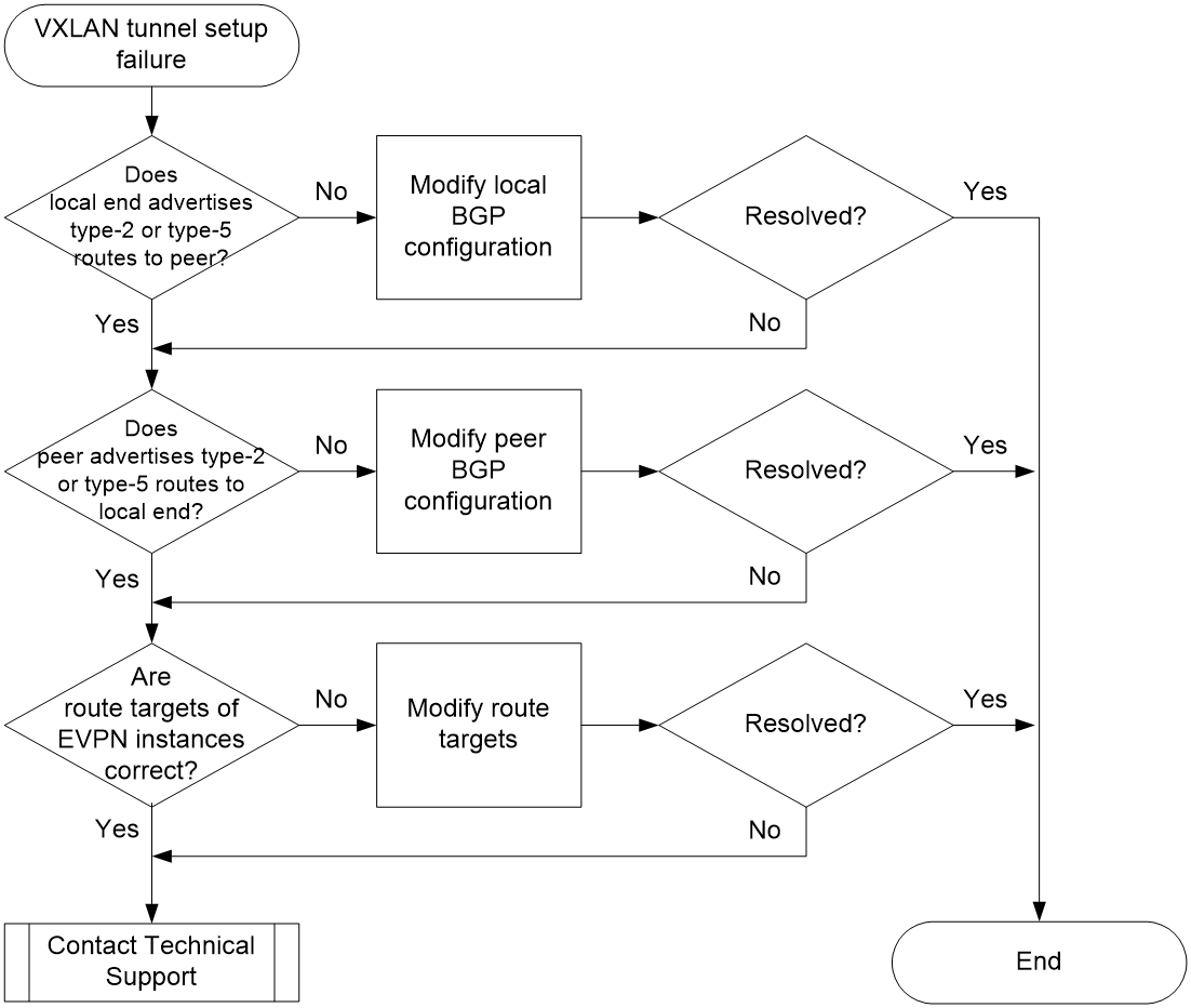

Inter-VXLAN tunnel setup failure in an EVPN VXLAN network with distributed gateways
Symptom
In an EVPN network with distributed gateways, tunnels cannot be established between VTEPs in different VXLANs.
Common causes
The following are the common causes of this type of issue:
·     Type-2 EVPN routes and type-5 EVPN routes (IP prefix advertisement routes) have not been received.
·     The RT configuration is incorrect on VPN instances.
Troubleshooting flow
Troubleshoot the issue by using the following process:
1.     Verify that type-2 routes have been received.
2.     Verify that type-5 routes have been received.
3.     Verify that the RT configuration for VPN instances is correct.
Figure 2 shows the troubleshooting process.
Figure 2 Flowchart for troubleshooting inter-VXLAN tunnel setup failure
Solution
To resolve the issue:
1.     Execute the display bgp l2vpn evpn command on the local end to check if the local end has advertised type-2 or type-5 routes to the peer end. For example, the following output indicates that the local end has advertised type-2 and type-5 routes to 4.4.4.4. If an RR exists in the network, specify the RR address when you execute the display bgp l2vpn evpn command. If not, specify the peer end's address.
<Sysname> display bgp l2vpn evpn peer 4.4.4.4 advertised-routes
 Total number of routes: 3
 BGP local router ID is 1.1.1.1
 Status codes: * - valid, > - best, d - dampened, h - history,
               s - suppressed, S - stale, i - internal, e - external,
               a - additional-path
               Origin: i - IGP, e - EGP, ? - incomplete
 Route distinguisher: 1:1
 Total number of routes: 1
     Network            NextHop         MED        LocPrf             Path/Ogn
* >  [5][0][24][10.1.1.0]/80
                        0.0.0.0         0          100                i
 Route distinguisher: 2:2
 Total number of routes: 2
* >  [2][0][48][0e86-19b6-0308][0][0.0.0.0]/104
                        0.0.0.0         0          100                i
* >  [3][0][32][1.1.1.1]/80
                        0.0.0.0         0          100                i
¡     If the local end has advertised type-2 or type-5 routes to the peer end, go to step 2.
¡     If the local end has not advertised type-2 and type-5 routes to the peer end, check if BGP is configured correctly for EVPN. For more information, see EVPN VXLAN configuration in EVPN Configuration Guide.
2.     Execute the display bgp l2vpn evpn command on the peer end to check if the peer end has advertised type-2 or type-5 routes to the local end. For example, the following output indicates that the peer end has advertised type-2 and type-5 routes to 4.4.4.4. If an RR exists in the network, specify the RR address when you execute the display bgp l2vpn evpn command. If not, specify the peer end's address.
 BGP local router ID is 3.3.3.3
               a - additional-path
* >  [2][0][48][0e86-23cf-0507][0][0.0.0.0]/104
                        0.0.0.0         0          100                i
* >  [3][0][32][3.3.3.3]/80
                        0.0.0.0         0          100                i
 Route distinguisher: 3:3
                        0.0.0.0         0          100                i
¡     If the peer end has advertised type-2 or type-5 routes to the local end, go to step 3.
¡     If the peer end has not advertised type-2 and type-5 routes to the local end, check if BGP is configured correctly for EVPN. For more information, see EVPN VXLAN configuration in EVPN Configuration Guide.
3.     Execute the display this command in L3VNI VPN instance view to check if export targets and import targets on both ends are correct.
[Sysname-vpn-instance-vpna] display this
ip vpn-instance vpna
 route-distinguisher 1:1
 address-family evpn
  vpn-target 1:1 import-extcommunity
  vpn-target 1:1 export-extcommunity
return
¡     If the route targets are inconsistent on the local and peer ends, execute the vpn-target command to modify the incorrect route targets.
¡     If the route targets are consistent on the local peer and ends, go to step 4.
4.     If the issue persists, collect the following information and contact Technical Support:
¡     Results of each step.
¡     The configuration file, log messages, and alarm messages.
¡     Diagnostic information collected by using the display diagnostic-information command.

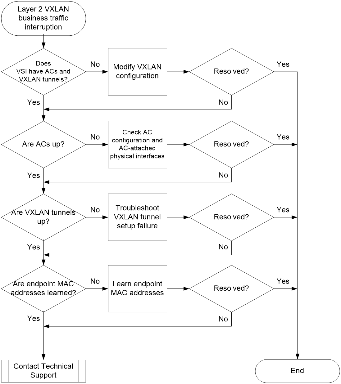

Layer 2 VXLAN business traffic interruption
Symptom
A VXLAN network cannot forward Layer 2 VXLAN business traffic.
Common causes
·     ACs or VXLAN tunnels are not established.
·     MAC addresses are not learned.
Figure 3 shows the troubleshooting flowchart.
Figure 3 Flowchart for troubleshooting Layer 2 VXLAN business traffic interruption
Solution
1.     Execute the display l2vpn vsi verbose command to view the VXLAN tunnels and ACs of the involved VSI.
<Sysname> display l2vpn vsi verbose
VSI Name: vpna
  VSI Index               : 0
  VSI State               : Up
  MTU                     : 1500
  Bandwidth               : Unlimited
  Broadcast Restrain      : Unlimited
  Multicast Restrain      : Unlimited
  Unknown Unicast Restrain: Unlimited
  MAC Learning            : Enabled
  MAC Table Limit         : -
  MAC Learning rate       : -
  Drop Unknown            : -
  Flooding                : Enabled
  Statistics              : Disabled
  VXLAN ID                : 10
  Tunnels:
    Tunnel Name          Link ID    State  Type      Flood proxy
    Tunnel1              0x5000001  Up     Manual    Disabled
  ACs:
    AC                               Link ID    State    Type
    GE0/0/1 srv1000                  0          Up       Manual
¡     If both the ACs and VXLAN tunnels are up, go to step 2.
¡     If an AC is down, modify the incorrect AC configuration.
¡     If a VXLAN tunnel is down, troubleshoot the issue as described in "Intra-VXLAN tunnel setup failure in an EVPN VXLAN network with distributed gateways."
2.     Execute the display l2vpn mac-address command to check the VSI MAC address table for the MAC addresses of endpoints in the network and the total number of learned MAC address entries.
<Sysname> display l2vpn mac-address
* - The output interface is issued to another VSI
MAC Address    State     VSI Name                        Link ID/Name   Aging
0001-0001-0001 Static    aaa                             Tunnel1        NotAging
52f6-bc1e-0d06 Dynamic   vpna                            GE0/0/1        Aging
--- 3 mac address(es) found  ---
¡     After you collect the preceding information, proceed with step 3.
3.     If the issue persists, collect the following information and contact Technical Support:

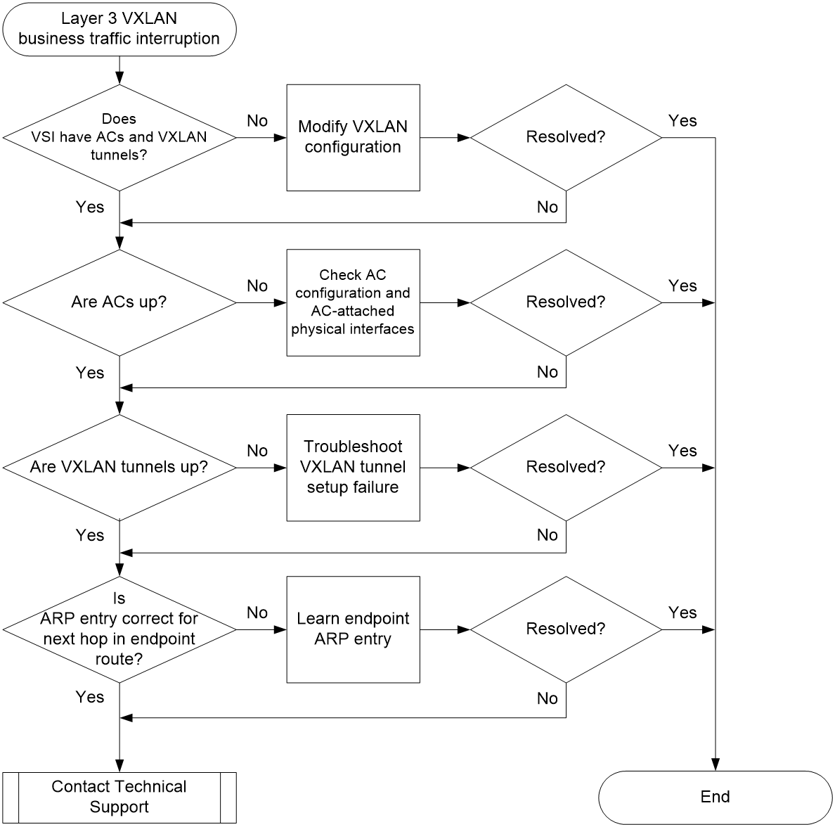

Layer 3 VXLAN business traffic interruption
Symptom
A VXLAN network cannot forward Layer 3 VXLAN business traffic.
Common causes
·     The device's router MAC address is incorrect.
Figure 4 shows the troubleshooting flowchart.
Figure 4 Flowchart for troubleshooting Layer 3 VXLAN business traffic interruption
Solution
VSI Name: vpna
  VSI Index               : 0
  VSI State               : Up
  MTU                     : 1500
  MAC Table Limit         : -
  Drop Unknown            : -
  Flooding                : Enabled
  VXLAN ID                : 10
  Tunnels:
  ACs:
¡     If a VXLAN tunnel is down, troubleshoot the issue as described in "Inter-VXLAN tunnel setup failure in an EVPN VXLAN network with distributed gateways."
2.     Execute the display evpn routing-table command, check the routing table of the L3VNI VPN instance, and record the nexthop address (Nexthop field) in the route for the target endpoint IP address (IP address field).
<Sysname> display evpn routing-table vpn-instance vpn1
Flags: E - with valid ESI   A – A-D ready   L - Local ES exists
VPN instance name: vpn1                             Local L3VNI: 7
IP address       Nexthop          Outgoing interface    NibID       Flags
10.1.1.11        1.1.1.1          Vsi-interface3        0x18000000  EAL
3.     Execute the display arp command to view the ARP information for the next hop.
<Sysname> display arp
  Type: S-Static   D-Dynamic   O-Openflow   R-Rule   M-Multiport  I-Invalid
IP address      MAC address    VLAN/VSI name Interface                Aging Type
1.1.1.1         00e0-fe50-6503 vsi1          Tunnel1                  960   D
¡     If the nexthop address is mapped to the router MAC address, go to step 4. Execute the display interface vsi-interface command to view the MAC address of the L3VNI VSI interface, which is also the router MAC address.
¡     If the nexthop address is not mapped to the router MAC address, restore consistency between the mapped MAC address and the MAC address of the L3VNI VSI interface. Alternatively, use the evpn global-mac command to configure an EVPN global MAC address.

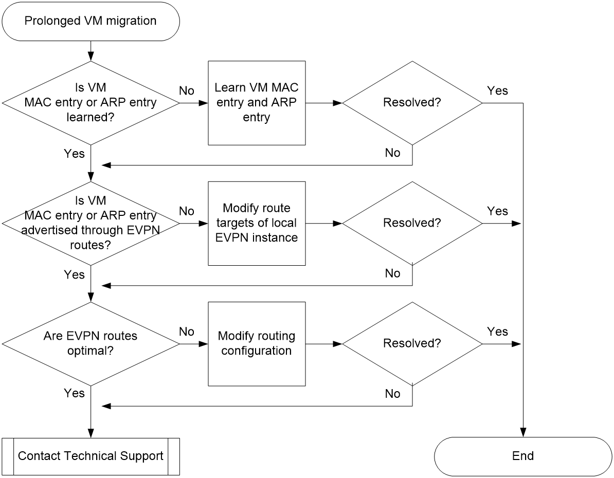

Prolonged VM migration
Symptom
In an EVPN network, a VTEP does not learn the MAC address or ARP information of a VM immediately after the VM migrates to the VTEP.
Common causes
·     The VTEP has not learned the MAC address or ARP entry for the migrated VM.
·     The VTEP has not learned the MAC address or ARP entry for the migrated VM through BGP EVPN route synchronization.
·     The BGP EVPN routes synchronized between VTEPs are not optimal ones.
Figure 5 shows the troubleshooting flowchart.
Figure 5 Flowchart for troubleshooting prolonged VM migration
Solution
1.     After the migration, check for the MAC address and ARP entry on the destination VTEP.
Execute the display l2vpn mac-address command and check the VSI MAC address table for the MAC address of the migrated VM.
52f6-bc1e-0d06 EVPN      aaa                             Tunnel10       NotAging
0001-0001-0001 Dynamic   vpna                            GE0/0/1        Aging
--- 2 mac address(es) found  ---
Execute the display arp command and check the VSI ARP table for the ARP entry of the migrated VM.
10.1.1.3        0001-0001-0001 vpna          GE0/0/1                  960   D
1.1.1.4         00e0-fe60-5000 vsi2          Tunnel1                  --    M
¡     If a MAC address or ARP entry exists for the migrated VM, go to step 2.
¡     If no MAC address or ARP entry exists for the migrated VM, the VTEP does not learn the MAC address or ARP information of the migrated VM. Bring up the VM on the VTEP for the VTEP to learn the MAC address and ARP information.
2.     Before migration, check on the VTEP whether the MAC address or ARP of the migrated VM has been synchronized through BGP EVPN routes.
Execute the display evpn route mac command to verify that the MAC address of the migrated VM has been learned from synchronized BGP EVPN routes.  The value B in the Flags field indicates that a MAC address entry is learned from BGP EVPN routes.
<Sysname> display evpn route mac
Flags: D - Dynamic   B - BGP      L - Local active
       G - Gateway   S - Static   M - Mapping        I - Invalid
VSI name: bbb
EVPN instance: -
MAC address     Link ID/Name   Flags   Encap           Next hop
0000-0000-000a  1              DL      VXLAN           -
0001-0001-0001  Tunnel1        B       VXLAN           2.2.2.2
Execute the display evpn route arp command to verify that the ARP information of the migrated VM has been learned from synchronized BGP EVPN routes.  The value B in the Flags field indicates that an ARP entry is learned from BGP EVPN routes.
<Sysname> display evpn route arp
VPN instance: vpn1                            Interface: Vsi-interface1
IP address      MAC address     Router MAC      VSI index   Flags
10.1.1.1        0001-0001-0001  a0ce-7e40-0400  0           B
10.1.1.11       0001-0001-0002  a0ce-7e40-0400  0           DL
10.1.1.101      0001-0011-0101  a0ce-7e40-0400  0           SL
10.1.1.102      0001-0011-0102  0011-9999-0000  0           BS
¡     If a MAC address entry or ARP entry has been learned through BGP EVPN route synchronization for the migrated VM, go to step 3.
¡     If no MAC address entry or ARP entry has been learned through BGP EVPN route synchronization for the migrated VM, execute the vpn-target command to modify the route targets of the local EVPN instance. Make sure the EVPN instance's route targets on the local and peer ends are consistent.
3.     Execute the display bgp l2vpn evpn command and verify that the MAC/IP advertisement route carrying the MAC address and ARP information of the migrated VM is optimal. Verify that the values in the State field include best. In the following output, the MAC/IP advertisement route advertises MAC address 0001-0203-0405 and IP address 5.5.5.5/32, and the route state values include best.
<Sysname> display bgp l2vpn evpn route-distinguisher 1.1.1.1:100 [2][5][48][0001-0203-0405][32][5.5.5.5] 136
 BGP local router ID: 172.16.250.133
 Local AS number: 100
 Route distinguisher: 1.1.1.1:100
 Paths:   1 available, 1 best
 BGP routing table information of [2][5][48][0001-0203-0405][32][5.5.5.5]/136:
 From            : 10.1.1.2 (192.168.56.17)
 Rely nexthop    : 10.1.1.2
 Original nexthop: 10.1.1.2
 OutLabel        : NULL
 Ext-Community   : <RT: 1:2>, <RT: 1:3>, <RT: 1:4>, <RT: 1:5>, <RT: 1:6>, <RT: 1:7
                   >, <Encapsulation Type: VXLAN>, <Router's Mac: 0006-0708-0910
                   >, <MAC Mobility: Flag 0, SeqNum 2>, <Default GateWay>
 RxPathID        : 0x0
 TxPathID        : 0x0
 AS-path         : 200
 Origin          : igp
 Attribute value : MED 0, pref-val 0
 State           : valid, external, best
 IP precedence   : N/A
 QoS local ID    : N/A
 Traffic index   : N/A
 EVPN route type : MAC/IP advertisement route
 ESI             : 0001.0203.0405.0607.0809
 Ethernet tag ID : 5
 MAC address     : 0001-0001-0001
 IP address      : 10.1.1.1/32
 MPLS label1     : 10
 MPLS label2     : 100
 Re-origination  : Enable
¡     If the MAC/IP advertisement route is an optimal route, go to step 4.
¡     If the MAC/IP advertisement route is an optimal route, modify routing configuration for the route to be an optimal one.
